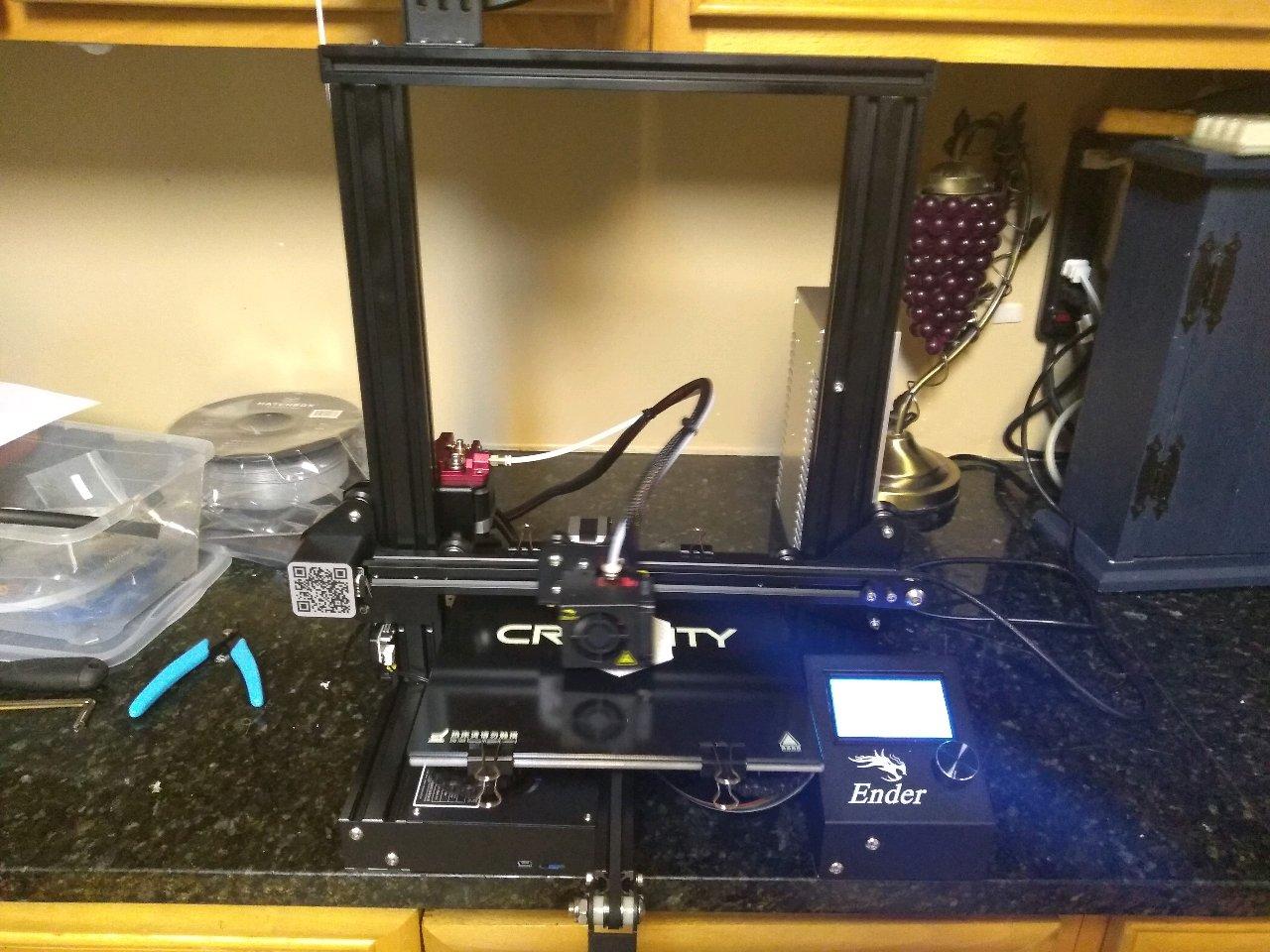

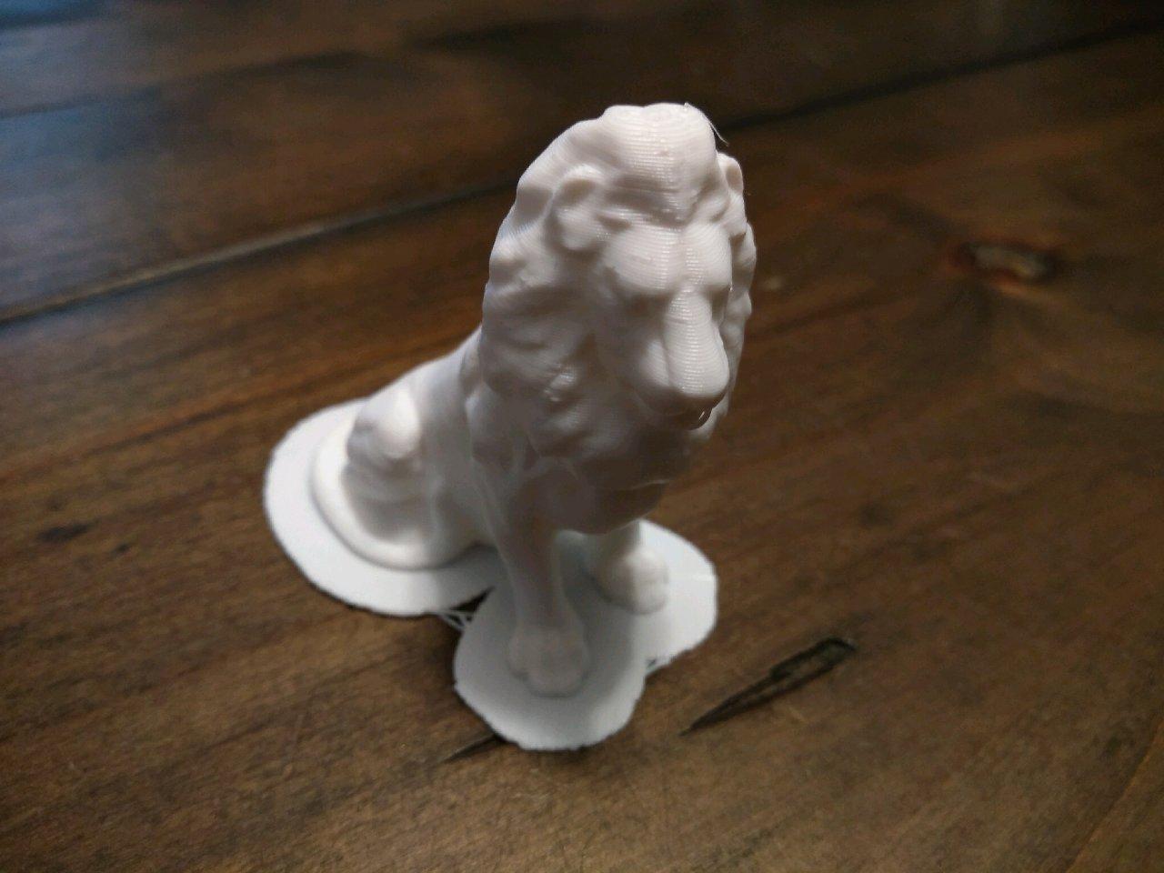

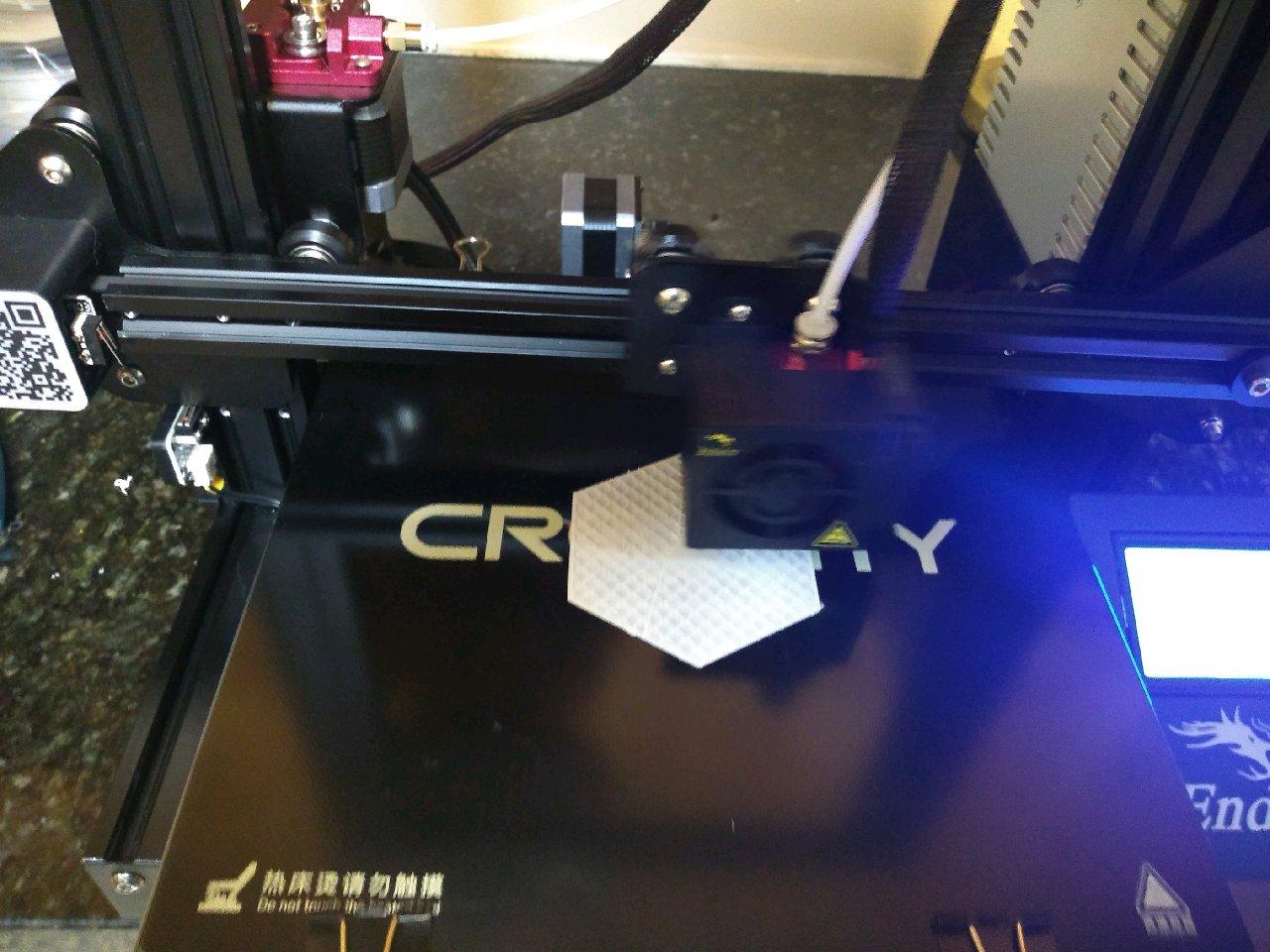

I ended up buying a 3D printer for my B-day this year. I have been looking at the prices of the Creality Ender 3 for awhile and took the bait. I ended up ordering the model with the glass plate bed and a few mods for it as well.
Assembly was pretty easy. Running the test prints included with the printer came out nice.
So, now I am playing around with slicers trying to figure out which seems to be the best to use. On the free side, there is Cura and Slic3R PE that a bunch of people like. Been hearing a lot about Simplify3D, but @ $150 us... is it worth it?

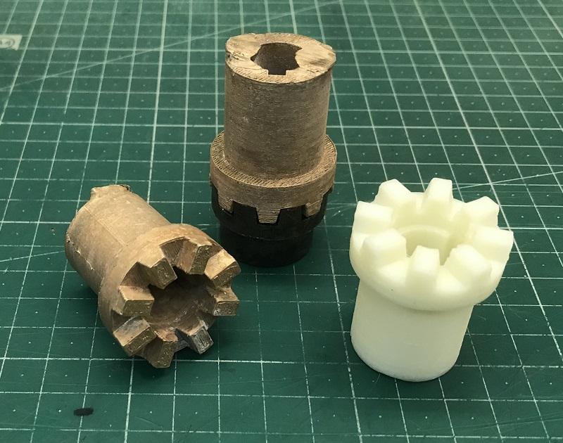

I think that the part that gave me the most pleasure was the 'lost PLA' pattern for the bronze drive dog on my Beaver CNC lathe

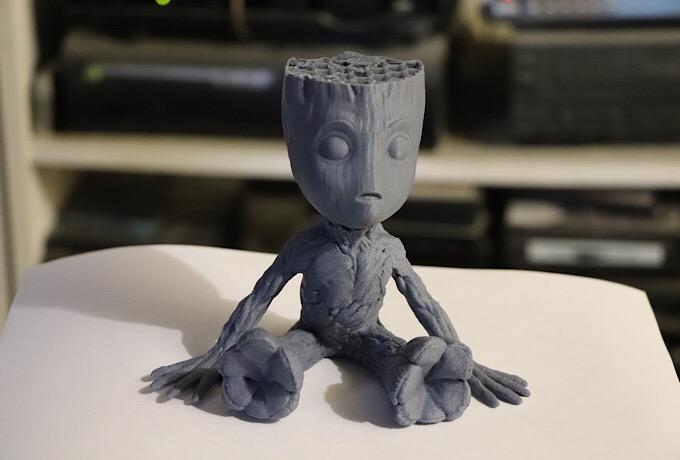

I’ve Been trying to make a Baby Groot for my granddaughter I’ve done the head twice now the last time it got down to the last 1/2 square before falling of its perch!
Baby Groots first haircut!
Now he is just someone’s Chia Pet!

Tom,
That still is pretty impressive. What are you using for a printer?

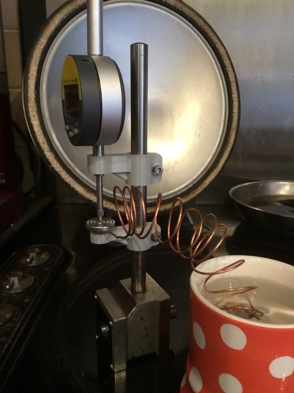

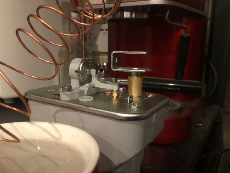

Here's a couple of examples from last years printing work.  Testing out an idea for a thermostatic valve control, using 3D printed parts for R&D.  Mapped the movement of the bellows, then create the mechanism that will operate the valve, based on movement available and dead band required.

I’m using a makerbot replicator 2x it has 2 print heads for different colours or support material.
This model was taken off Thingiverse and was a long print due to the small triangles used by the designer it did come out good though. I will try acetone on the build plate to see if it is causing the bonding problem or if it is a adhesion verses height thing.
