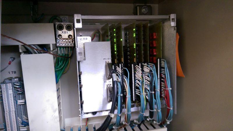

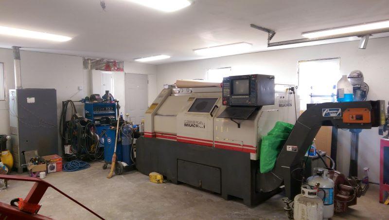

 We are having another go at fixing this, when we got it we could move all the axises but when we went to extend the tailstock we got a low oil message followed by a improper shut down  :zap: and it hasn't started up since. It stalls at initiating host and the hydraliics haven't worked since even though the oil was topped up the only contact that gets pulled in is the one for start.
here is a couple pics and a video thats aprox 3 minutes long (much like watching paint dry)  :doh:

I'd run along the back plane of that card cage looking for voltage rails with an Avo to see if the un-illumimated half is perhaps missing a supply

What’s a Avo? I did pull the cards could it be possibly I put it in the wrong slot?

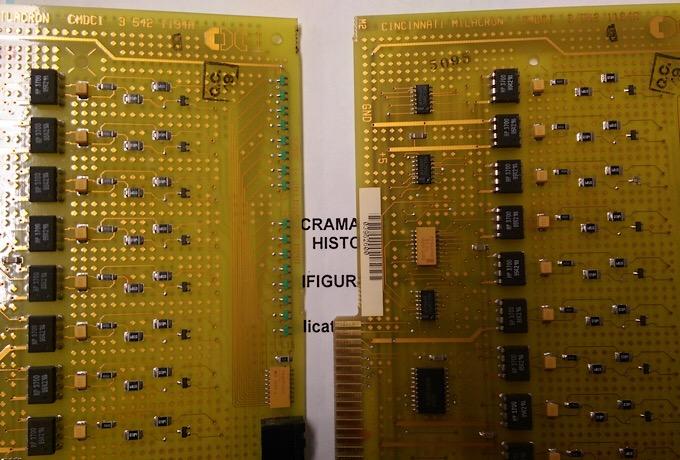

It’s been a while so just a very quick update I pulled the cards and found that one of three cards was missing a piece of electronics ( right side three down )
  • Posts: 9124
Re: cincinnati lathe sugestions
« Reply #10 on: June 06, 2019, 07:01:04 AM »
SMD transistor ?
Have you replaced it and is all now working?

SMD transistor ?
I just got back on this thing I’ll check ebay for another card. I’m hoping to get it at least far enough to see if I can bring up some parameters or functions it seems to cycle through some functions so the memory may be intact still.
One thing I have been wondering about is it is only grounded through the panels should I drive a stake in to ground it better?
