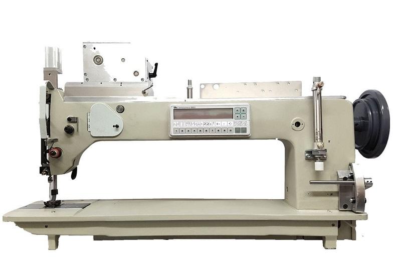

Be an awful lot easier just to buy a long reach machine such as a 'Sail Makers Sewing Machine'. They do pop up on eBay from time to time.
Offline S. Heslop
I was looking at them earlier but they tend to be pricey, have elaborate threading procedures (I guess for reliability at high speeds, while using such huge spools it doesn't matter as much), and the whole big clutch motor mounted under the table takes up alot of space. They're also generally not designed for quick access to the bobbin, having to tip the whole machine up. They also tend to be incredibly specialised to only one type of stitch, and I believe sailmaking stuff often goes for a 3 or 4 step zig-zag rather than a regular zig-zag but I could be wrong on that.
I do like the look of these Singer 457 ones though with rotary take up levers.
It's an option but i'm not a big fan of camping ebay hoping the right machine shows up at the right price.

Got 8 industrial sewers (at last count).  All walking foot.  Needle feed machines (bobbin accessable from top) don't require 1 to turn their wrist inside out to get to it.  Got both kinds.  Advantage of course with bobbin underneath is if you are working in the middle of something big, can load a fresh bobbin up and keep sewing.  No need to remove work.
Never used a zig zag machine, just plain lockstitch sewer, so cant offer anything there.
Once one has a long arm, wonder how you did without it. Picked up mine (twin needle) on the secondhand market.  But looking at the machines you are playing with, prob a bit on the heavy side.  Head alone is a bout 100Kg according to the specs.
As for servo motors, personally wouldn't go near one.  All my stuff is the clutch motor type.  Good thing is parts avail for these kinds of machines is still quite good and the gears are metal.
Contemplated doing what you are doing to one of my smaller machines, but it never got past a thought.
Good luck with it

Yeah I had some problems trying. I think it'd be entirely possible with a milling machine but all I managed to do was wreck a couple of machines.
I guess for an update, I spent a while trying to track down an industrial machine at a reasonable price. The best i've seen was a Singer 457 at around £200. I also went to a couple places dealing in 2nd hand ones and it sounds like I missed the boat on finding a machine for cheap, since there were alot more floating about 5 or so years ago when factories were still closing.
I've moved on to knitting machines since those are available for reasonable prices. Messing around with a Singer Memo 2 at the moment but i'm holding off posting about it till there's something worth showing, just in case I hit another wall like with sewing machines.
