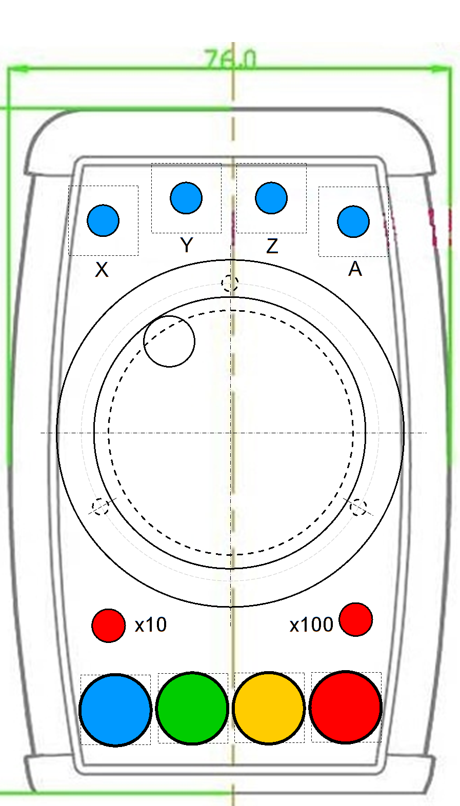

Looking into this a bit more, I think i have decided to redesign the pendant as well to make it more useful and user friendly.
Attached is a copy of my first attempt. The axis are selected by illuminated pushbuttons at the top, the speed multilplier leds will illuminate when the preset jog wheel speeds are exceeded, enabling the multipliers. The lower 4 buttons are home (axis selected by upper buttons), run, pause and estop.
At the moment I'm thinking of using two 328 arduinos for the logic work, which seems to indicate I would only need a six way cable, which would be light and cheap.
Any thoughts or comments appreciated.

Did you get anywhere with this.  I was just thinking you could use I2C comms between Arduinos, 4 wire + shield/GND from control box.

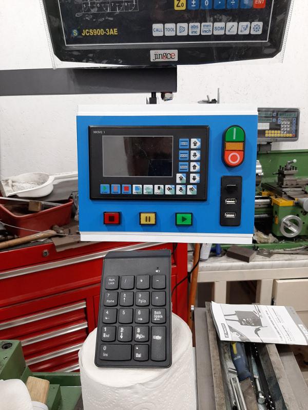

I fitted a cheapo hub to the DDCSV so that the usb ports are available from the panel. I then bought a wifi numeric keypad which pretty much does it all - if only I could figure out how to remember which key does what  :doh:. Being wireless there are no cables so it makes it very easy.
FWIW a better option is to use SPI if you go that route as its less prone to interference over long cables.
Best Regards
