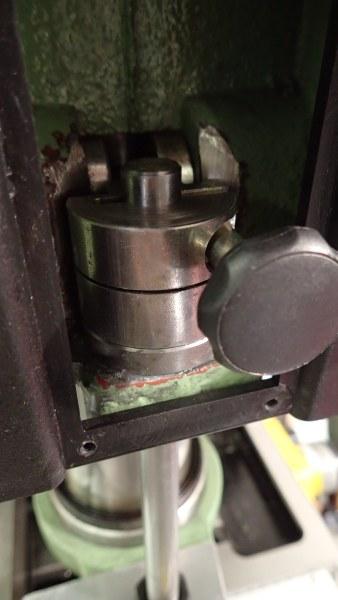

Got one of these popular drill/mill combo and quite like it.
https://www.warco.co.uk/1950-large_default/major-milling-drilling-machine.jpgMill/drill quil stop and postion measurement
Installed DRO and that is definate improvement. However spindle stop is not tha great and spindle depth measurement is next to useless.
http://uploads.tapatalk-cdn.com/20140613/hanuquja.jpgMill/drill quil stop and postion measurement
Saw this video, a little different mill, but very similar spindle construction.
Stop looks good and would be possible to make with only minimal changes. Good.
What about spindle postion measurement. I actually like the idea of local measurement display.
Any experience on this sort of scales:
https://www.machine-dro.co.uk/vertical-linear-digital-scale-150mm-6-inch.html
Or the type that has separate display.
I'm trying to find a model that has big and clear display.

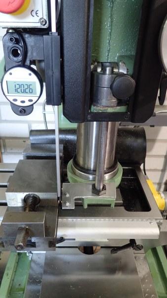

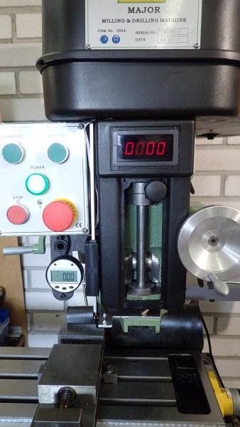

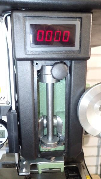

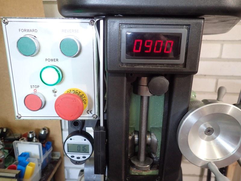

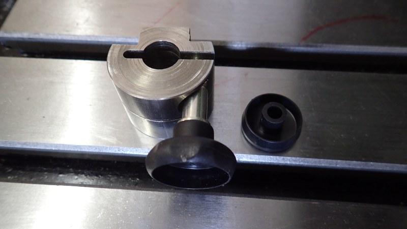

« Reply #4 on: April 27, 2019, 04:42:05 AM »
Build "prototype" some time ago, hence only "busines ends" of the parts are finished and rest of them looks garden engineering.
And because the cover was off I added RPM-display, big red LED display, but reading update is slow and program appears to writen by 3 years old using Basic.
My approach is slighty different compared to Sefan's construction, the mechanical idea is very much similar and rod/stop is almost 1:1 same construction - even with epoxy and release wax.
Difrerence comes in that my mill is diferent and there was even less space at the front of the spindle, I needed to make parts smaller and snag off 2 mm from casting.
Instead of DTI I put cheap scale on the side, seems to work fine.
