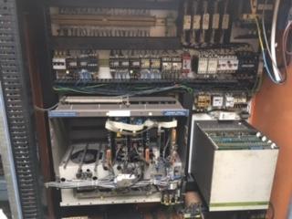

I have a generator for 3 -phase so duly wired it up thinking 'off we go!!!'  No such luck. Signs of life but that was about it.....
Time to start trawling the internet - where I came across MadModder and the Andrew Mawson Beaver epic. :clap:
I started to read and slowly realised maybe I had bitten off a bit too much here..... too late now !!! :doh:
Anyway I read somewhere changing the phasing might help so I did - and it did. Things started to come to life - but not quite as I had expected.
The statement ' it hasn't been used for a couple of years - but I've seen it turning' was a slight exageration.

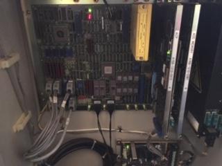

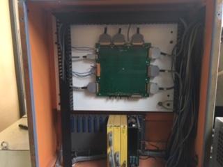

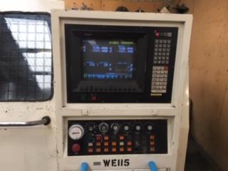

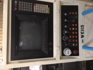

My Fanuc 10T sprang into action with a screen full of errors - so now begins the fun.....

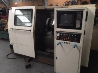

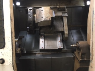

As a start I thought I would post a few photos so people can admire how much work Andrew put into his and see how far I have to go.....
As info is scarce on this machine if anyone recognises bit it would be great to get your opinions, good, bad or just plain ugly..... :thumbup:

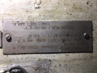

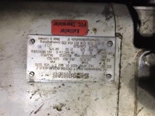

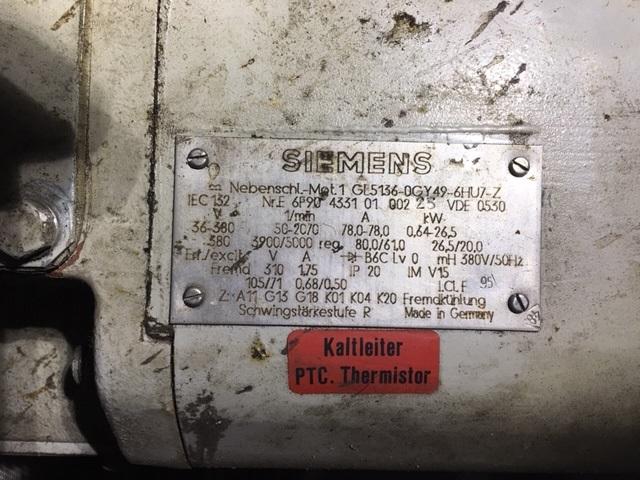

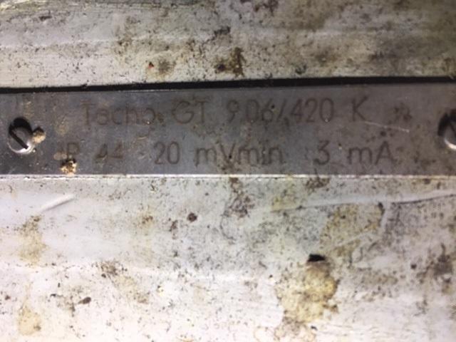

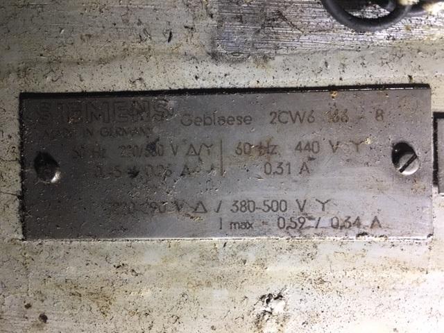

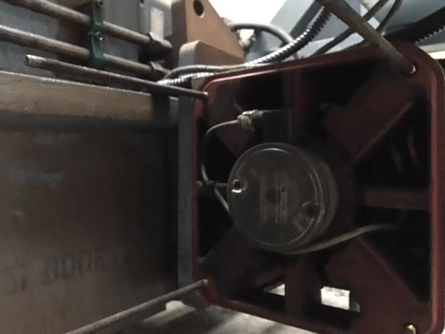

Good luck with this. The important photos to take are of the ID plates on the servos and their drives. Assuming the fault is not a simple one, I would recommend retrofitting with LinuxCNC. Post said photos on the linuxcnc forum and ask for help. You might be surprised with the outcome.
Mesa have an amazing array of electronic hardware http://www.mesanet.com/
And also Pico Systems has some Fanuc interfaces https://pico-systems.com/osc2.5/catalog/index.php
Both Jon from Pico and Peter from Mesa are active on that forum.
Its a bit outside my sphere but there are many people there who will help. I did see there was a Beaver mill retrofit on one thread.

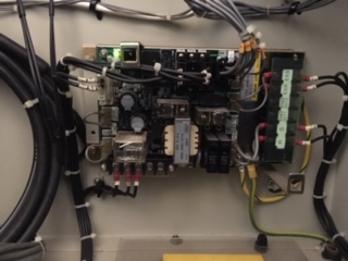

Thanks for the info as well Rod. At the moment I am trying to keep cost to a minimum and fix what is there.... call me cheap but I also like original.... :D
To continue where I left off - having read about the nightmare of backup batteries leaking everywhere I figured the first thing to find was the backup on mine.
I searched hi and low looking for something the size of a car battery to no avail. I opened more covers and hatches that the Queen Mary. Finally I found a small
cover on the door of the bolt on cabinet at the side of the machine that houses the PLC power supply and IO cards. To my surprise under the cover I found
3 Duracell size D batteries (dated 2012). Needless to say these were easily changed and I could breathe a sigh of relief that they were neither expensive
or leaking..... also rather well positioned where they couldn't damage anything if they did.....
On to the next error - axis field error...... more on that later....

I left off with an axis field fault. I hadn't a clue so set about prodding, poking and fiddling looking for loose wires and blown fuses. I did come across a thermal trip which looked far too new and was obviously a replacement for the original. It had dip switches and a current setting - all of which were set to maximum. I am a believer that things are designed to run mid range so this seemed wrong to me. I dived on the internet with make and model and emerged a half hour later non the wiser. I just decided to set everything to mid range and used a bit of logic with the dip switches and to my amazement when I fired the machine up again the error had gone!!! :thumbup: Not sure if this was the prodding or poking or the thermal trip setting - but I didn't really mind....

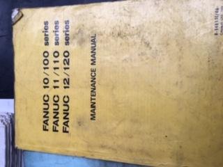

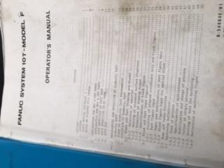

At this point it is worth mentioning the lathe did come with some manuals - pictured below. The more I delve into them the more I understand what is going on (or so I kid myself)
Re: Yet another Beaver resurection (TC20F)
« Reply #7 on: March 04, 2019, 02:50:10 PM »
Good progress  :thumbup:
Are you aware that your machine manual is the 'S' version for the Siemens control not your Fanuc one ?

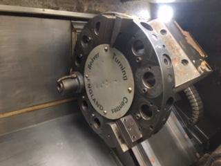

Next stop turret!!!
Well having followed the startup procedure as far as zeroing all I had to do was initialise the turret and the instructions said I was good to go.... but how?

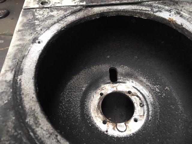

I pulled the turret open and as Andrew had said it seemed like I had a Baruffaldi turret. I should mention at this point that most of the ID plates on this machine have long since worn away so I am still not sure.... Anyway more poking and prodding then off to the internet. I managed to pull up a maintenance manual for a Baruffaldi turret - much newer than mine, but it included a wiring diagram - with wire colours!!!! It didn't get any easier than this as the  colours on the diagram match all of the colours in my machine.... I messed and prodded and poked a bit more - and added a multimeter into the mix and came up with a loose wire and a bad connection. tightened and cleaned up and try again. No joy.
At this point (today actually) I was leafing through the operation manual trying to figure out if I was just doing it wrong when the MDI command page fell open in front of me. It explained in some detail how to enter MDI commands.
On the Beaver instructions after zeroing it said ' switch to MDI and enter a tool number to initialise the turret eg T0200; I had tried to do this many times with no joy.
On reading the aforementioned page it said ' in MDI enter the program softkey, then input a word to the text program. Press execute then press program start'. I thought maybe I am doing it wrong so followed the Fanuc instructions rather than the Beaver instructions. Hey presto the turret sprang into action. Well once started there was no stopping me - the spindle spun up  to 2000rpm, the quill went in and out the turret was well and truly spun and everything sprang into life. I think I may be there!!! :clap: :clap:
All I need to do now is learn how to use the machine - which was the point of getting it in the first place.......

Hi Andrew - I have got both versions of the manual - Siemens and Fanuc. They are almost identical but the Siemens one has far more detail (and seems to have been written later). I was still writing when you sent your post as I have moved on significantly. I posted the pictures of the manual so that if anyone needs a reference I can help them out. Unfortunately the Fanuc manuals are a bit too big to just scan and post.
Anyway I am now up to date with the posts - if you read the last you will see where I have got to..... I have got to go away for a couple of weeks but will get back to the lathe when back in this country.... business unfortunately not pleasure....

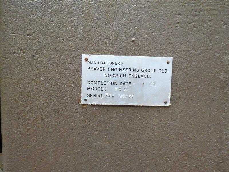

My name plate says made 6/89 but is definitely a Generation One machine and my manual also like yours says 2Ed.5.89. So your manual is definitely a Generation One but I'm not sure if your actual machine is a Gen1 or Gen2 - I suspect Gen2 as it has the Baruffaldi turret you say  :scratch:
Offline JeffK
  • Posts: 24
« Reply #14 on: March 05, 2019, 02:12:40 PM »

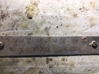

The only name plate on it that can still be read is at the back of the cabinet on the BeakBane concertina casing and that says 03/86 - though I'm sure they probably bought in the cabinets way earlier so the manufacturing date for that part could have been that early. The 20F manual is typed though versus the 20S manual which looks more word processed.....
« Reply #15 on: March 05, 2019, 02:24:19 PM »
Do you not have a date label inside the left hand front hydraulic cabinet below the headstock? Slide lathe cover closed to expose the door.

Had a look inside the cabinet - there was a plate with just a machine serial no. of 50164 but no date. The main ID plate is on the outside above this cabinet door but the sliding door has been rubbing on it and worn most of the numbers off it. You can just make out a few letters but nothing that makes sense.
Not sure if this serial number is before or after yours?
cheers
jeff
« Reply #17 on: March 06, 2019, 06:14:03 AM »
My s/n is 50255 so  91 machines after yours, so yours must be a generation one machine ! Odd with a Baruffaldi turret fitted, as I understood that they bought in the Baruffaldi ones as a cost cutting bean counter exercise as the banks started squeezing them.

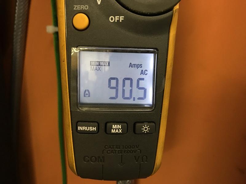

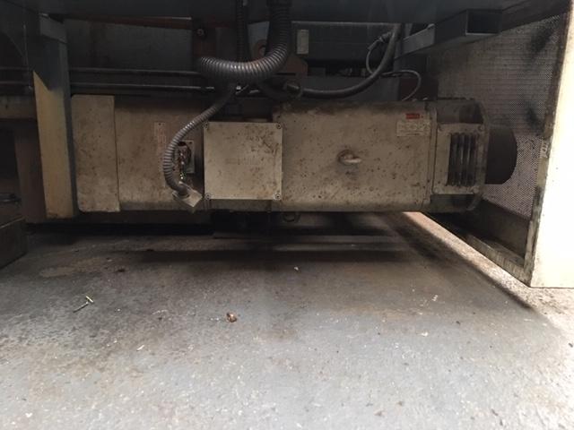

Managed to cut my first bit of nylon stock today....  :clap:then as the machine got to centre on constant surface speed it tripped the 64A breaker on the distribution board from my generator (surely shouldn't have drawn that much current with speed capped at 1000 rpm and a 1mm facing cut on nylon?). All went quiet and when I fired it back up again something tripped to give me the dreaded EMG with no indication of what is wrong. I guess I'll start searching prodding and poking again tomorrow. Any ideas would be welcome - either on the current draw or the software emergency stop. :doh:

What type of breaker is it?
I can never remember the types, but some can give false trips when powering switched mode supplies (aka Inverters/VFDs).
  • Posts: 853
« Reply #20 on: March 06, 2019, 03:26:51 PM »
Is the breaker RCD? could be a bit of earth leakage rather than overcurrent, 65A does seem massive draw for the light loading!
« Reply #21 on: March 06, 2019, 03:46:44 PM »
Instantaneous starting current on mine, which probably has a similar sized spindle motor, is over 100 amps. Needs a type C at least, but preferably a type D breaker.
(My spindle motor is a 27.5 kW Mawdsley DC motor with an appropriately large KTK-Mentor drive )

Its a 63A type C Schneider circuit breaker (not RCD) which I expected to do the job. Obviously not. I guess I should upgrade....
  • Posts: 853
« Reply #23 on: March 07, 2019, 07:49:49 AM »
Thats one hell of an inrush current!
« Reply #24 on: March 07, 2019, 08:11:46 AM »
I quite agree.
My lathe only has a 1.1 kW motor and it wouldn't notice a 10mm cut in nylon or acetal never mind a 1mm cut!
« Reply #25 on: March 07, 2019, 08:17:11 AM »
Andrew,
Doesn't the drive have adjustable ramp times? 100A just to start seems almost unbelievable. If that's the best it can do then I can only think it's a crap design!

I spent a bit of time this afternoon prodding and poking to try to find out what was causing the EMG. Turns out thermal overload switch 2 had tripped. I reset and tried again but same thing (several times). They say something about doing the same thing over and over expecting a different result means something don't they?
Anyway the overload switch feeds the hydraulic pump etc as well as the spindle drive field current. I finally disconnected the field current wires and tried again just running hydraulics and ancillaries. No problem with no thermal trip.... I am now making the assumption there is too much current draw on the spindle field circuit - something I know nothing about and sounds like it could be expensive. :bugeye:
The other option could be the overload switch faulty but I suspect not. I have attached a few photos of the spec plates on the motor and field drive. If anyone knows anything about what I now need to do I would certainly appreciate the help....  As you will see it is a Siemens motor.
cheers

« Reply #28 on: March 07, 2019, 11:27:02 AM »
Woops - just noticed I put the same (upside down) photo in twice :doh: One of those days....
Here's the right one.
« Reply #29 on: March 07, 2019, 12:16:05 PM »
Oops  :scratch:
Had it been a field drive for a Mawdsley I know where there is a spare, but yours seems to be a Siemens.
I don't often say this, but your pictures are too small to get the detail - I'm usually banging on asking people to make them smaller !!  If you load them up at 640x480 or 800x600 the writing becomes readable.

Offline JeffK
  • Posts: 24
« Reply #31 on: March 07, 2019, 12:41:49 PM »
Try these - the main plate does say the high running current is 78 amps but I didn't expect it to draw this for a low load cut.....I have got a couple of 63A type D breakers heading this way - if it needs more I will have to do something different with the distribution board....
Anyway got to fix the field current issue first. Hopefully the high draw is related to that.
cheers
« Reply #32 on: March 07, 2019, 02:06:24 PM »
Although obviously an AC 3 phase rather than DC motor, it's rating is (perhaps not surprisingly) very similar to mine  :thumbup:
My field driver gives about 160-170 V DC at about 7 amps so circa 1 kW so about 1/27 of the motor rating
Are you sure that the second plate you label as the field is not the cooling fan for the main motor ? Certainly a 2cw6-145-8 is a blower motor but a quick google doesn't show your 2cw6-166-8.  The first plate is giving the specs for the motor in-built tacho.

I've been working with American motors and their data plates for 40 years and I've got no clue what those data plates are trying to tell us.
Stupid question/s, does this spindle motor have a separate cooling fan motor and is that motor running?  It looks like your spindle motor has a thermistor/s to monitor winding temperatures.  Siemens will do that on a lot of motors as an option, on their "bigger" motors thermistors are pretty much standard equipment.  If the spindle motor has a separate motor for cooling, this motor should basically come on when you power up the system.  If the cooling fan wasn't running you'd get over-temp alarms.  Maybe not when the spindle motor is running no-load, but it would happen with a load on the motor.
You might get "lucky" and have a spindle cooling fan motor problem instead of a spindle motor problem.
« Last Edit: March 07, 2019, 02:43:41 PM by awemawson »

Offline JeffK
  • Posts: 24
« Reply #35 on: March 07, 2019, 03:33:57 PM »
I guess all 3 plates are mounted on the main spindle motor body, though 2 are together on one end and the other (main) is at the other end of the assembly. As I said I have very little knowledge of these type of motors so it may well be that one plate relates to the cooling fan (which is at the same end as what I call the field plates) and the other to the main motor.
I have been doing a bit of internet searching and realise that there are several different tacho's, encoders etc to monitor position etc on the main motor but am a bit lost with this.
My gut feel is pull the whole thing off, clean it and see what is worn out. That is ok with a V8 petrol engine but with servo motors I am afraid I might do more damage than good with settings etc for encoders.
I can certainly check in the morning if the motor fan runs but will be away from tomorrow night for 2 weeks so don't want to pull too much apart just now. The whole thing is pretty clagged up with gunge so a clean mat well do some good but....
Again thanks for all of the replies. I am a bit out of my depth here so don't want to mess too much up.....
cheers
« Reply #36 on: March 07, 2019, 03:46:41 PM »
Assumptions here Jeff, but I THINK what you have there is a fairly normal 3 phase motor driven by a probably pretty big inverter whose speed can be controlled. As it is needed to run fairly slowly at times it has a separate cooling fan. Embedded in the motor is a tacho to let the controller know what speed it's turning at.
At a pinch you could probably run that motor at a fixed speed directly off 3 phase so long as the voltage is ok

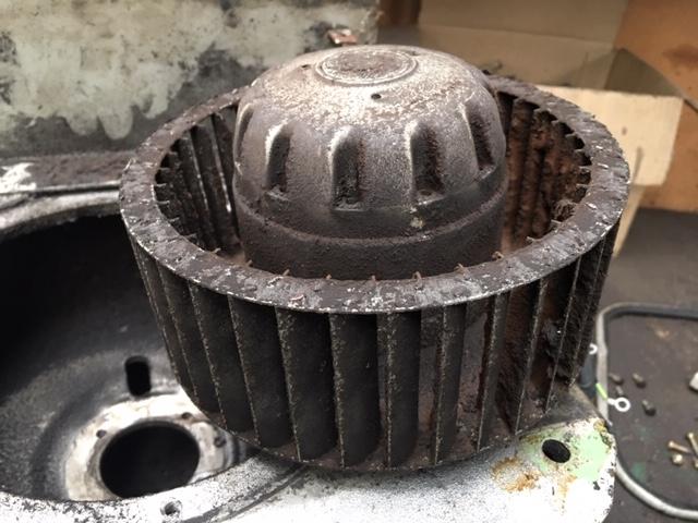

Well - I got back from my travels (eventually) and though time to dive into the lathe again....
Pulled off the fan motor at the back of the spindle motor (Andrew was right with his diagnosis of the spec plates) and found it totally choked up with caked on crudd. https://madmodder.net/Smileys/default/confused0068.gif I though this must be the problem - overloading the motor and causing the thermal switch to trip..... Once upon a
time there used to be a filter at the inlet to the cooling fan but that had long since gone....
After much solvent, scraping etc I relieved the fan blades and casing of a significant weight of sticky gunge. Tested the motor and all was well so re-assembled and put it
back on the machine confident I had fixed the problem. I even fabricated a new filter out of fishtank filter mesh.
Alas on starting up again the same thermal trip problem :doh:
More head scratching and chasing wiring revealed nothing new so I decided to get some new classD breakers and a new thermal switch. Off to ebay and picked up everything
at a bargain price.... Installed the new breaker and changed out the thermal switch - got to be it now.... Not a chance.
I was now getting really frustrated so thought back to basics. Lets do what I should have done at the start and get the multi-meter out.....
With power on I was getting strange voltage readings at the switch across phases.... 130V, 330V and 415V. Can't be right methinks.... Worked my way back to the main fuses
to find voltage ok upstream of them.... one 80amp fuse blown and the fan motor was trying to run on 2 phases..... this had not affected the PLC side of things or anything else
that was kicking in prior to the thermal switch tripping.... I thought I had better check all of the 5 main fuses and found 3 out of 5 had blown - obviously when the whole
main breaker thing had gone. Back to ebay and found 5 surplus used fuses (these are not cheap new...) so bought them all. They arrived middle of last week adn I duly installed
them and - hey presto all was working again...... :D
I guess the excercise was not all a waste of time as otherwise I would have kept running with a bad cooling fan with no filter so at least that got fixed but just shows sometimes it
is better not to jump to conclusions and to check the basics first.....

I have tried adding a G20 to the code but no difference. Checked the wiring and all seems good.
I think the answer must lie with parameters somewhere but just can't find the right one. At one stage
the diagnostic code 1000 showed a 1 on bit 3 which indicates an interlock or the start lock is on but
that has since stopped coming up. The status display on the bottom of the screen indicates that the
turret is moving but the position display shows no movement and the turret doesn't actually move.
More head scratching I think..... :scratch:
