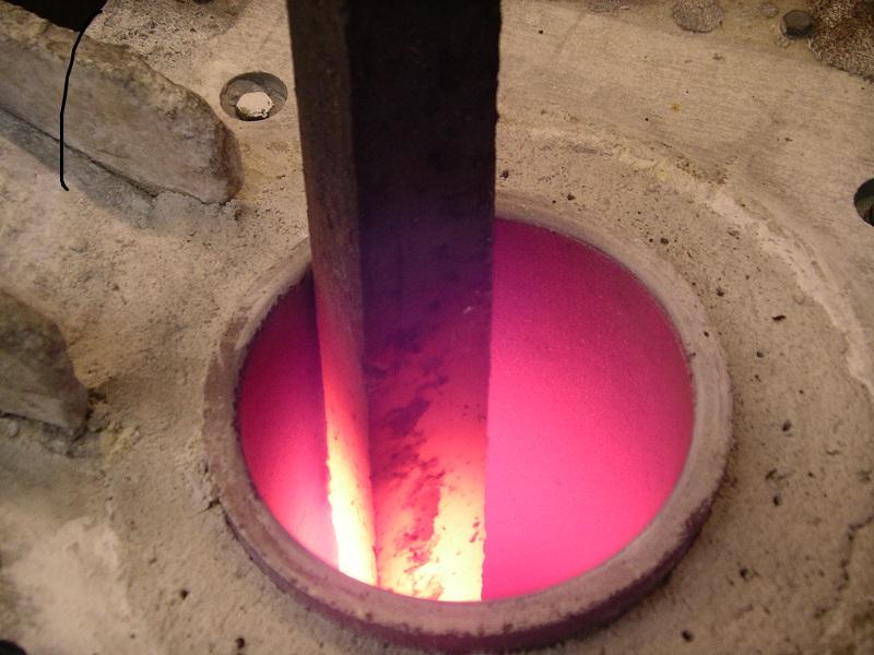

You can always soften them again, heat to white hot and cool slowly.
Here's a large square one glowing nicely in my 100 kw induction furnace when I had it set up back in  2007
(just had to manually ramp down the power setting so it cooled slowly rather like you would with a pottery kiln to avoid cracking, which was easy as it's a  big knob on the control panel!)

White heat? Uhhhh, nope, that's re-melting it. CI melts at 2200F.
For most gray irons, a ferritizing annealing temperature between 700 and 760°C (1300 and 1400°F) is recommended. If you're going by color that's dark red (see below).
You also don't have to keep it in a ramped powered furnace for cool down. just bury the piece in a bucket of wood ashes to cool slowly. In fact you can also do the heating to annealing temps in a wood fire in the brightly glowing embers with a little draft.
