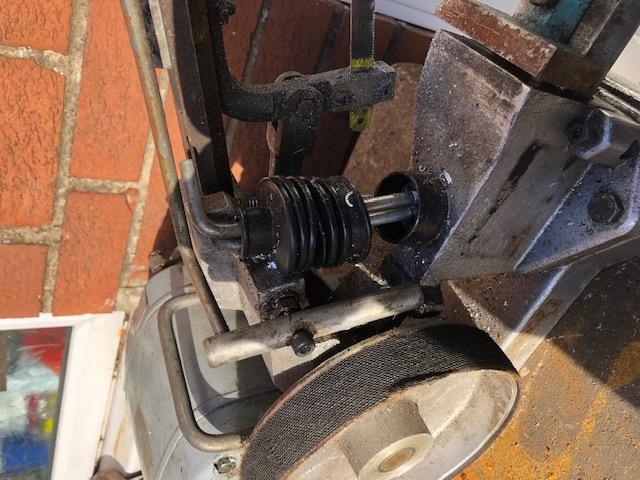

Hi I have a Kennedy Hexacut 60 power hacksaw I find it a good stablemate to my larger Rapidor. I should like to spruce the Hexacut up a bit, what I require is a replacement bellows for the damper.
I doubt you can buy them anymore, any old stock probably perished, has anybody done any modification or got any helpful ideas

How about a photo? Give us an idea about what your talking about!

Not the best picture but it shows the offending bellows riding up as they do,

Scrambler motorbike fork gaiter?

How about a brake master cylinder gaiter?

Steering rack gaiter ?

I'd go visit your local old time car parts store with the bellows in hand.
Mcmaster has a wide selection too.

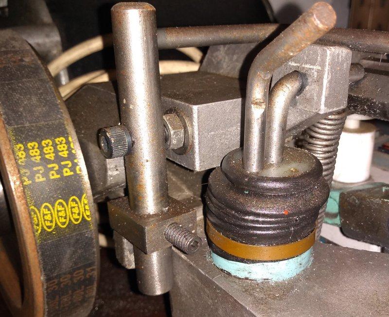

I'm fairly sure I used one off a clutch or brake master cylinder.  I needed to make a disc which the rod and adjusting screw went through.  I thought I even had a spare but I just checked and it's too large.
It might be worth hunting online for a Girling catalogue.

Thanks for that a picture of yours fitted would be helpful please, just trying to source a new belt, thinking of ribbed belt running inside out, thing is one size is too long, the next available size is way too small

I modified mine to use a poly-v belt - no more slippage or the belt climbing off.

Hi you say modified, I assume 2 new pulleys? What size belt did you use please? Is the mod on here?

I modified the large pulley. Just machined a flat and then added 4 or 5 grooves for a J section belt. I can't remember if I found a small pulley or made one.

OK. Here's a picture.  You may be able to see the white disc that the damper rod and adjusting screw go through.   I did that to give something for the gaiter to seal on at the top end.   As I recall there is a rib on the disc to fit a groove in the gaiter.
You may be able to see that mine is the model that came without a motor.  It originally had a V belt pulley and when I acquired it there was an enormously heavy gearmotor.  I wanted to change that as there's no point in such a small saw that I couldn't pick up. I couldn't get sufficient reduction from an ordinary induction motor with V belts so I have gone for a poly V belt drive with two new pulleys.

Thanks for that, I have ordered a toothed timing belt which hopefully I will run inside out, If that fails I will roll my sleeves up and machine some Serpentine pulleys, regarding the gator a trip to the local motor factors or the autoumble is in order
