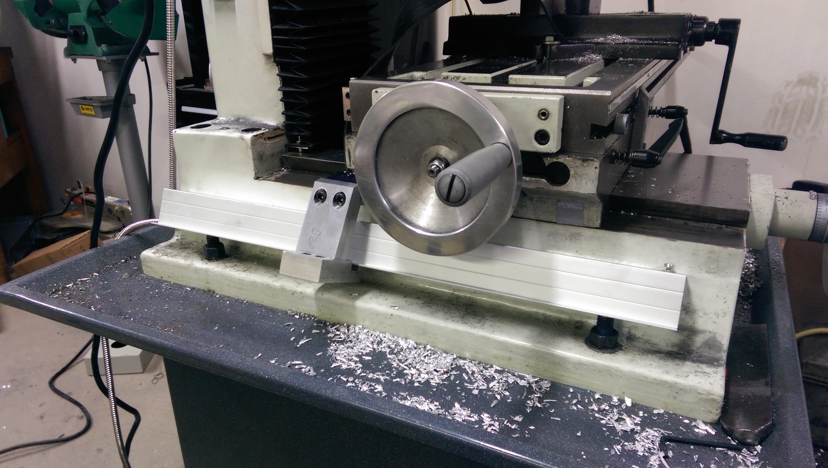

« Reply #4 on: December 30, 2018, 04:12:54 PM »

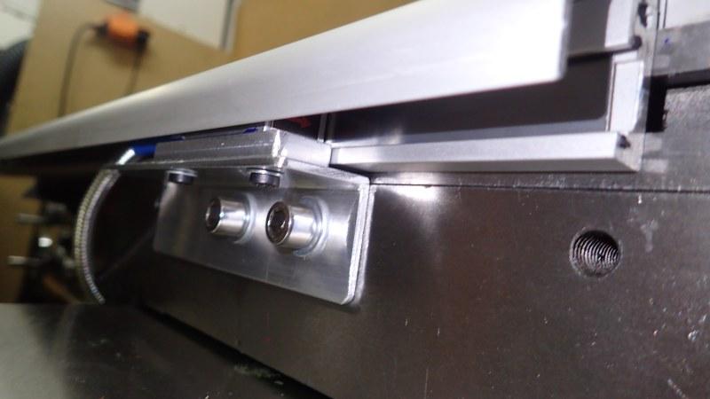

Here is a pic of the y axis.

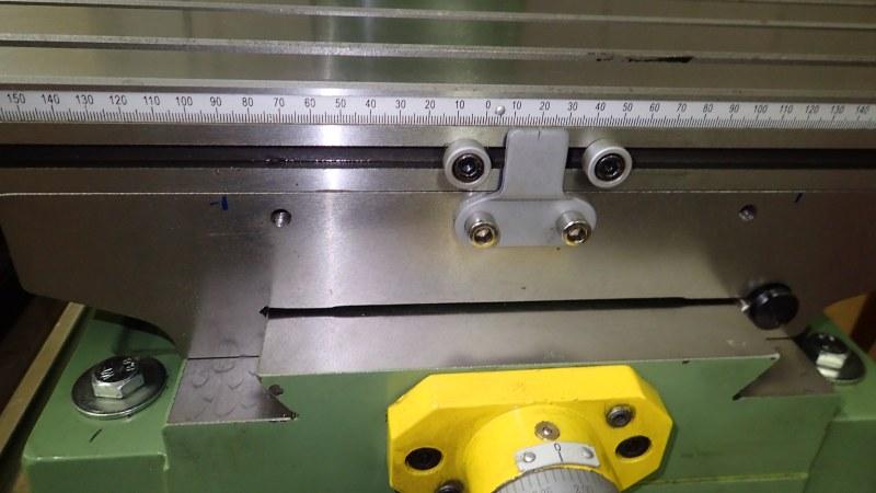

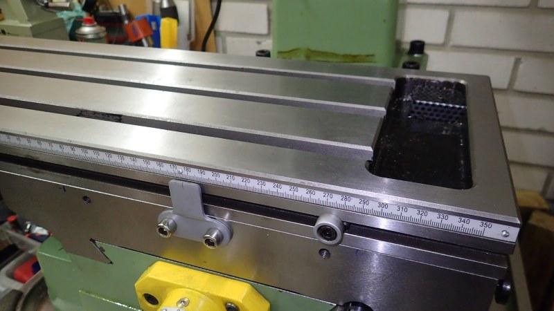

I like the mechanical table stops on X-axis, not extremely attractive mechanically, but seems to work. I was thinking of keeping it, because sometimes it is pretty handy (used it couple of times allready). This is the main reason I thought of putting the X-axis magnetic scale somewhere else than on front of the table.
The original tape rule "scale" on the front is pretty bad, barely adequate to verify while counting cranks of the handle.

I fitted dro's to my Warco minor by brackets on the end face of the table with clearance for the centre stop , and replacing the lock levers with grub screws , but still have the use of the adjustable end stops , the Z axis scale reads 92.5 thaow per revolution ( I have no idea how that works ) .

The x axis wasn’t bad installing as it’s all on a flat surface you do lose some machining area and it’s not just the scale but the way covers too in my case 1/8 rubber so when it folds up there’s a 1/4” added but hasn’t affected anything I do.
I’d put it on the back and try it and see what you think, worse case scenario you could change it which would take maybe 1 hour.

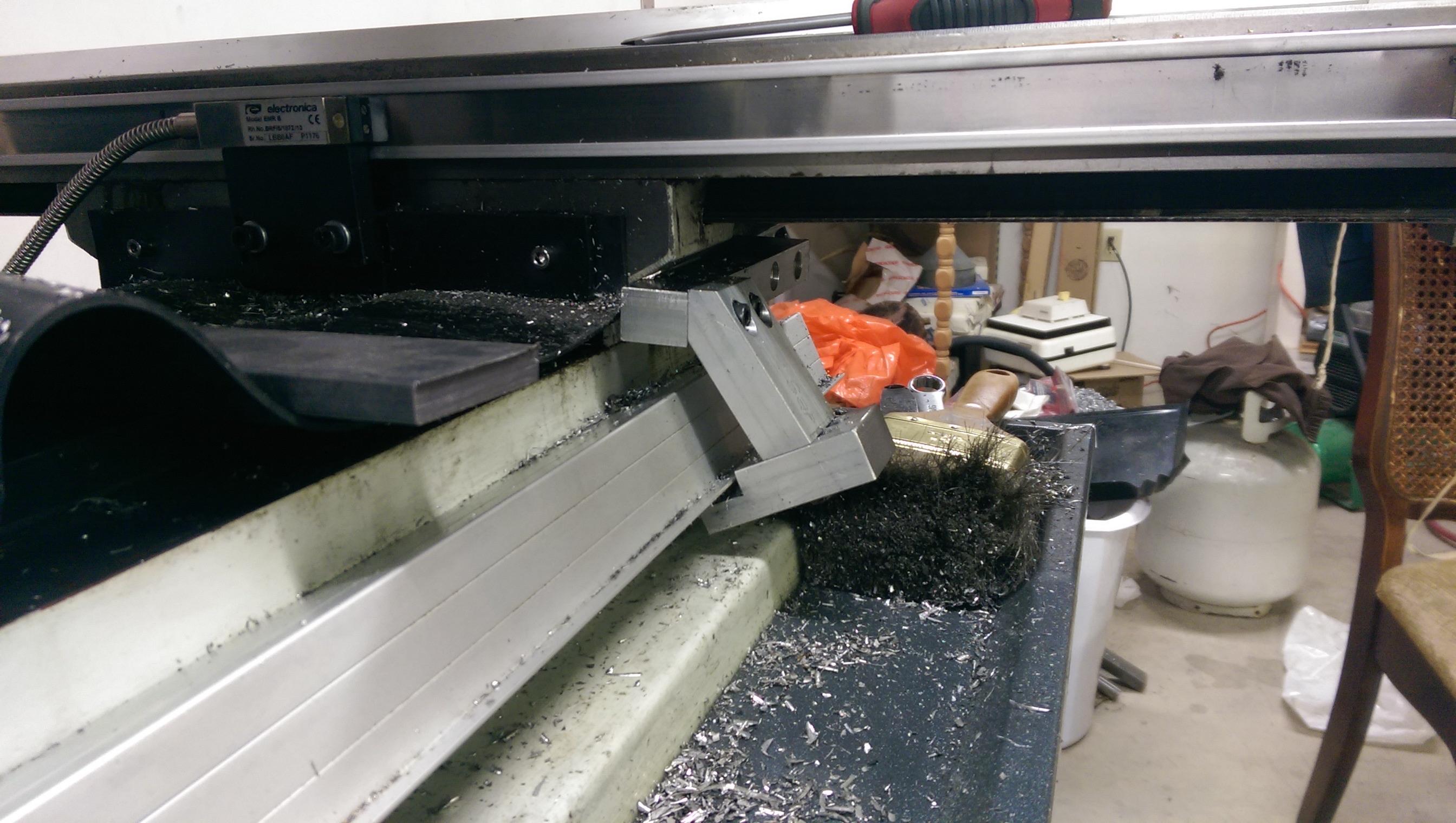

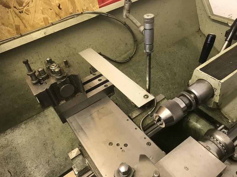

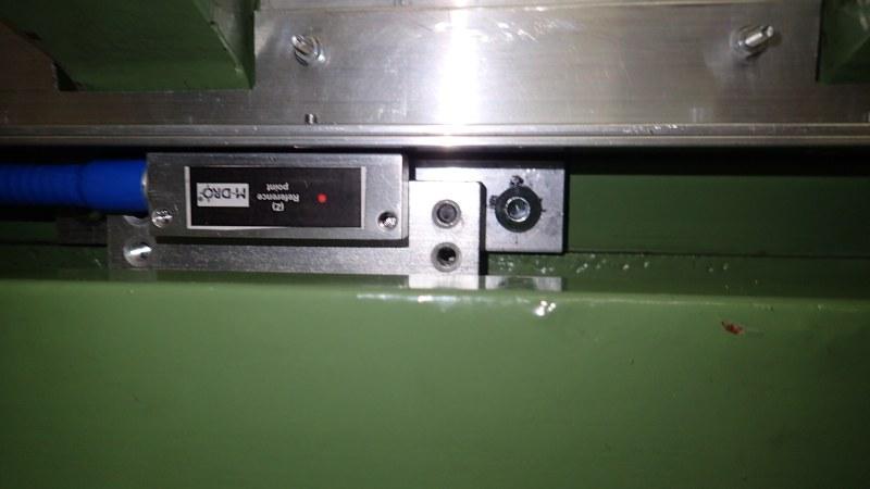

« Reply #9 on: January 01, 2019, 05:05:58 PM »

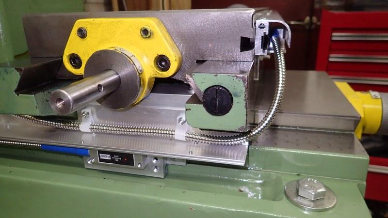

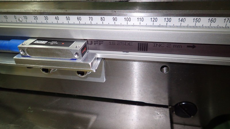

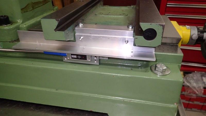

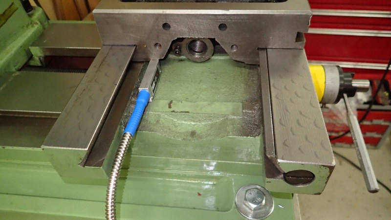

Here's a super compact magnetic tape installation on my hardinge cross slide.
Re: DRO for Warco Major mill
« Reply #10 on: January 02, 2019, 02:35:21 AM »
That surely is super compact and looks like read head has a cover that should keep the swarf away. Looks a little out in the wind location and you probably don't have a habit of putting a magnetic stand ant that side of the cross slide.

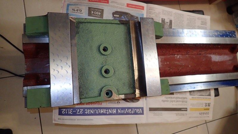

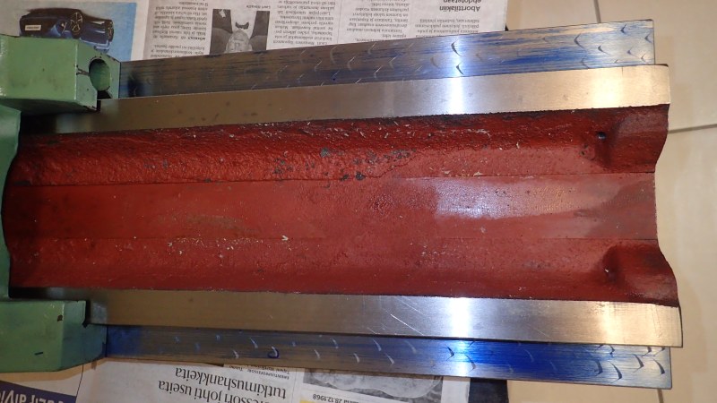

« Reply #11 on: January 03, 2019, 11:03:19 AM »

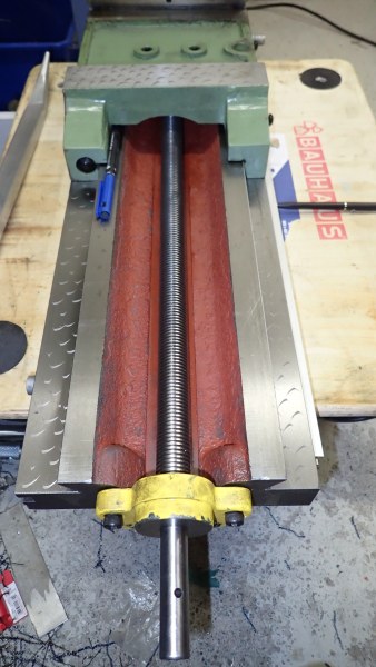

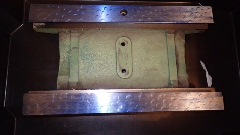

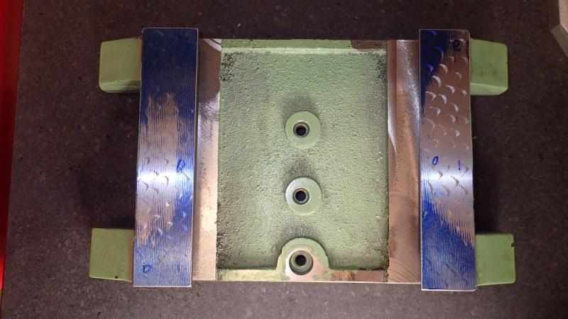

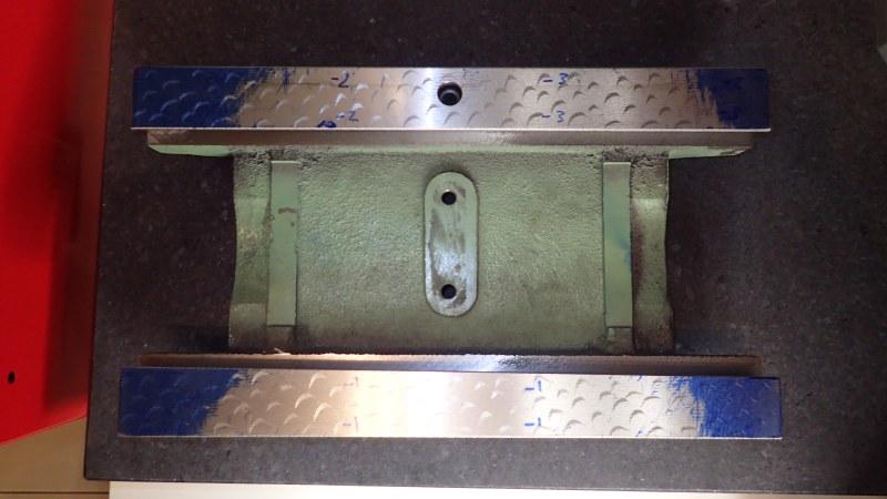

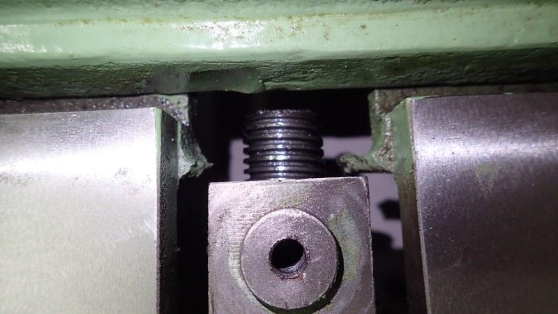

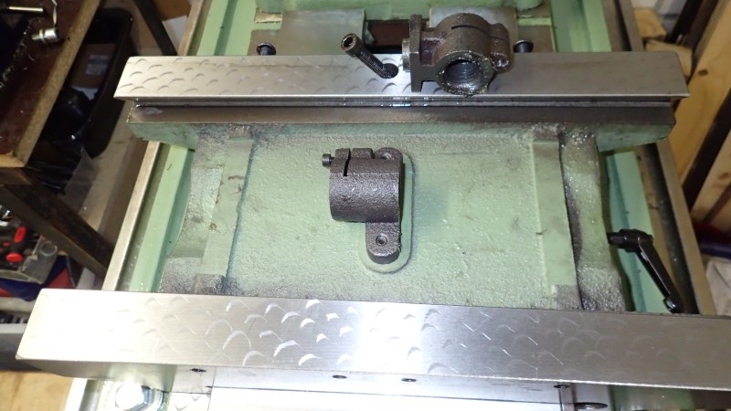

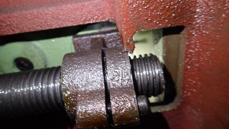

Disassembled the table and saddle. Taper gibs looks fine and threaded spindle nuts are cast iron.
Need to make some measurements to verify results, but looks like the easies way is to do hang the scales outside of the machine.
X-axis scale could fit right behind of the table.
Y-axis has more freedom and there are more possibilities. Several places, it could be fit nearly, or it almost could be hiden out of harm's way - and many places that it would be pretty crampped installation.
Traditional course of action would be to fit the magnetic tape onto plinth (cast, tapered side) and attach the read head into Y-slide (saddle). Mecahnically easy, but would need stand offs for the scale spar to keep it out of the plinth (and dripping oil, coolant, swarf) and the read head would be in the moving part.
Thinking of making a mount into saddle and hang the tape face down (i.e. attach the tape into moving part, under the table - mostly) and the read head mount into plinth. Need few more measurement to verify if this is a good plan.

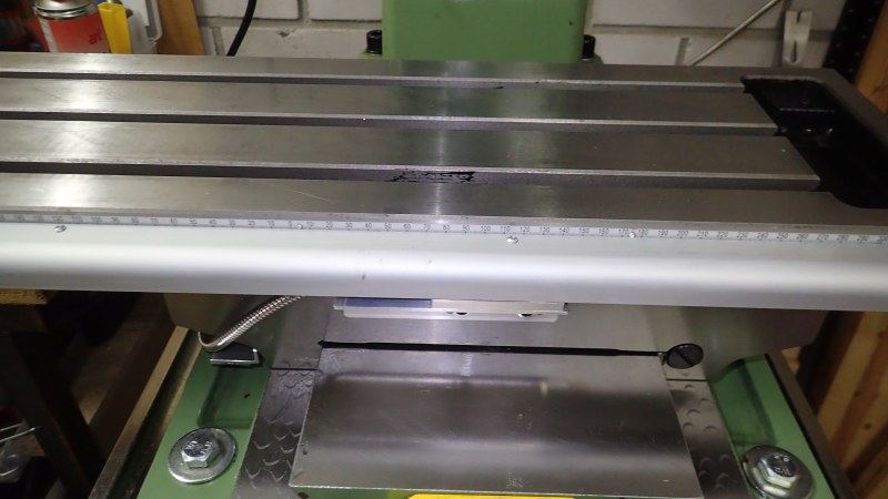

« Reply #12 on: January 03, 2019, 04:04:13 PM »

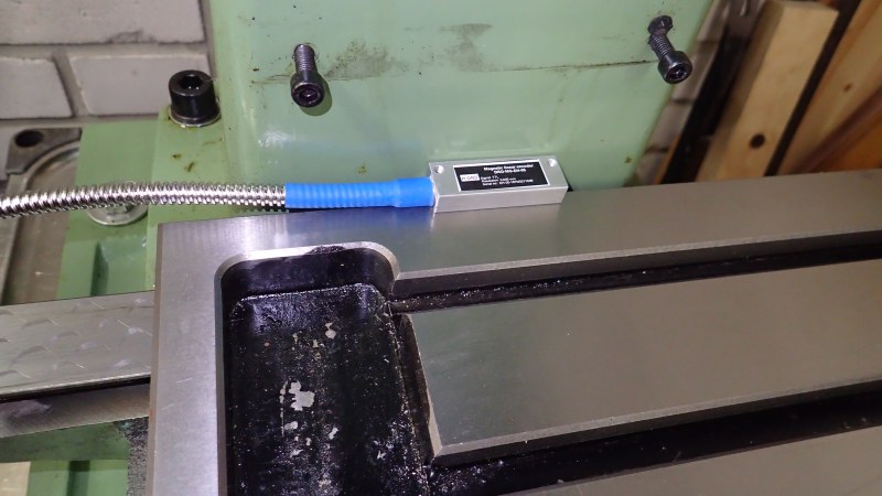

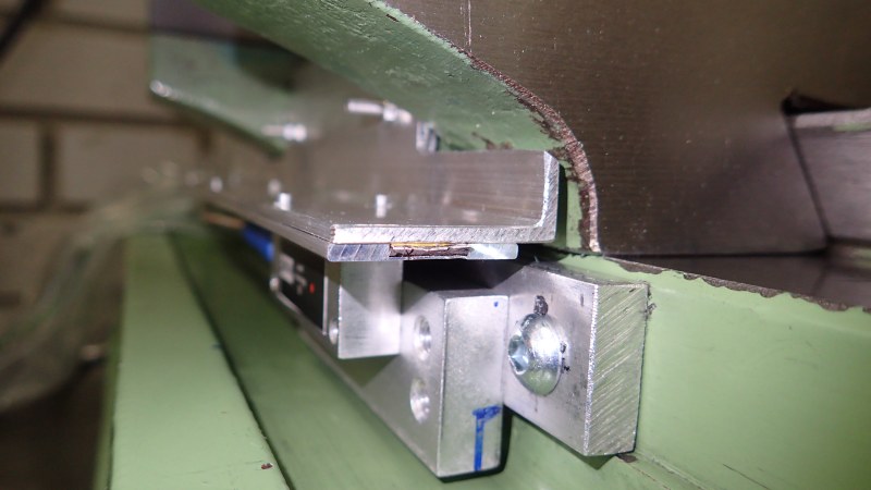

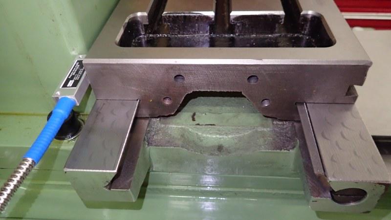

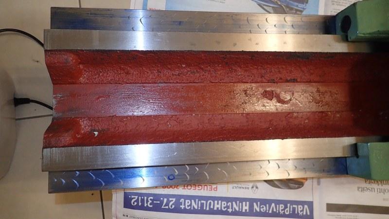

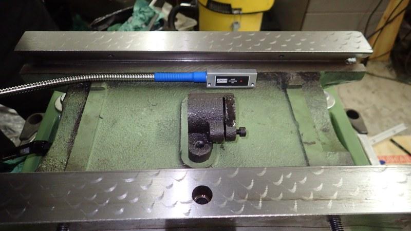

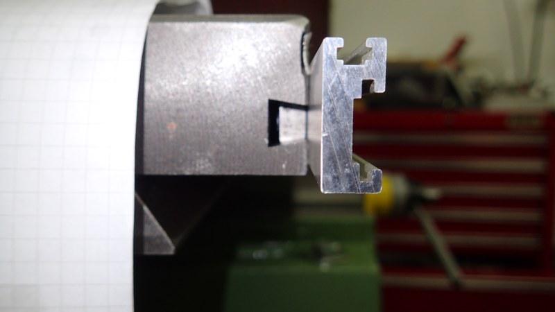

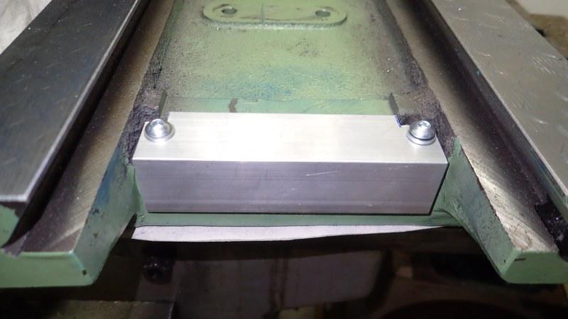

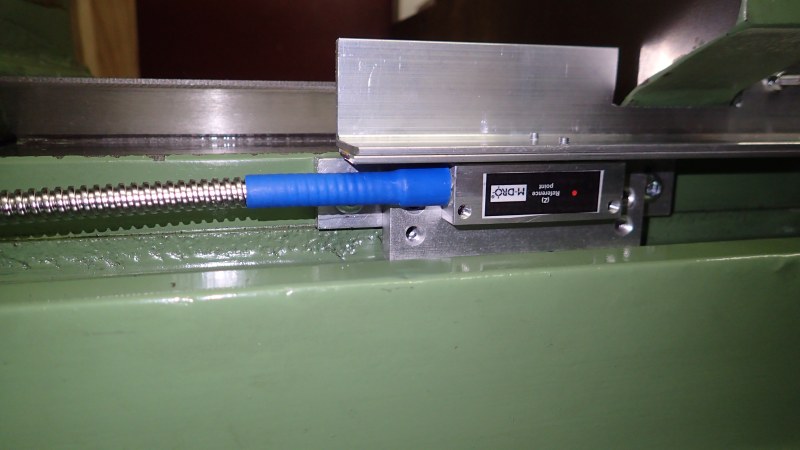

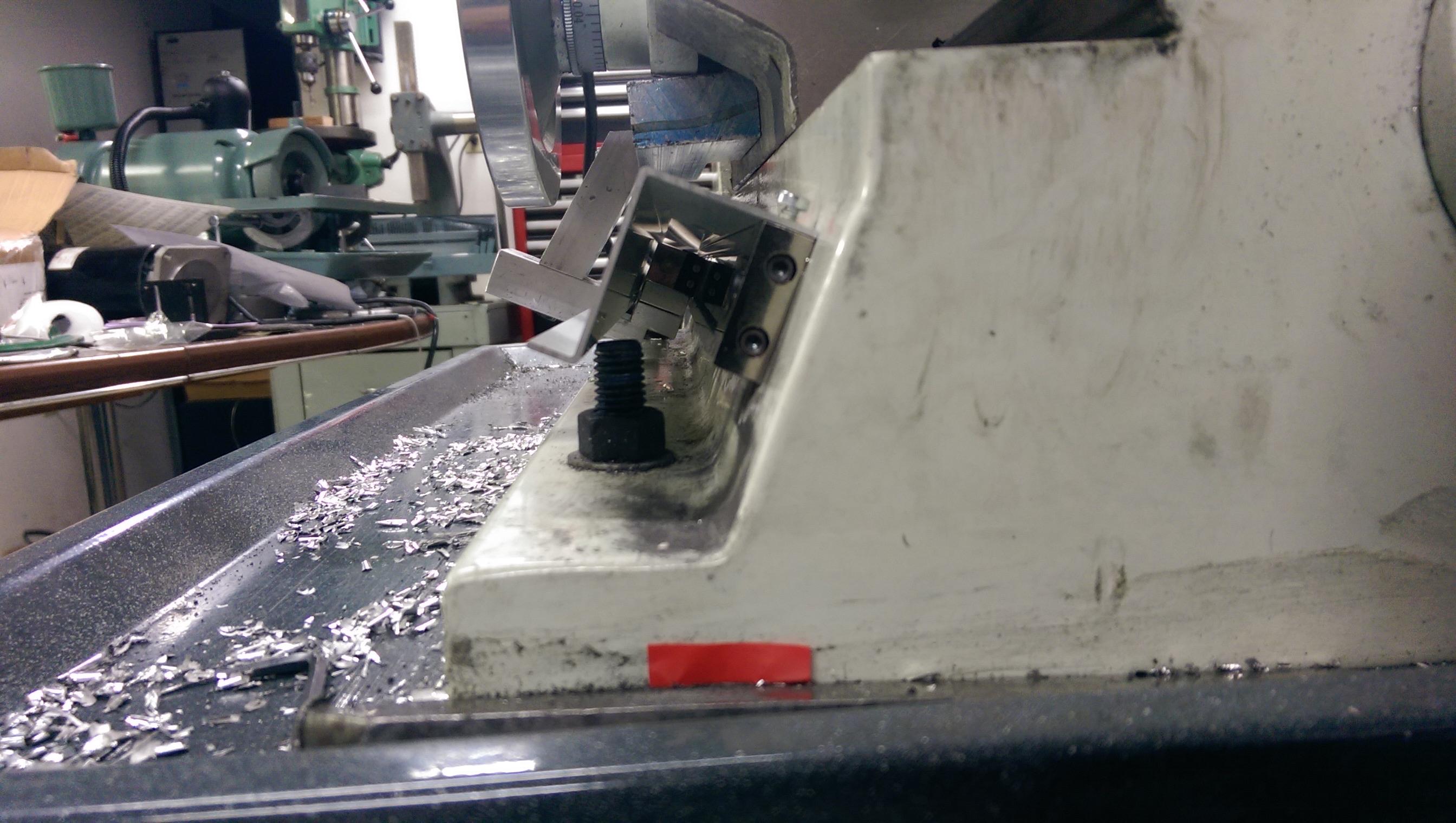

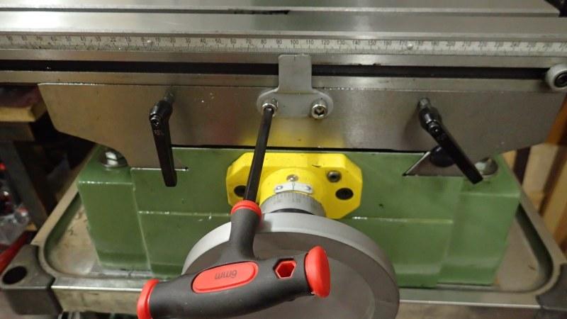

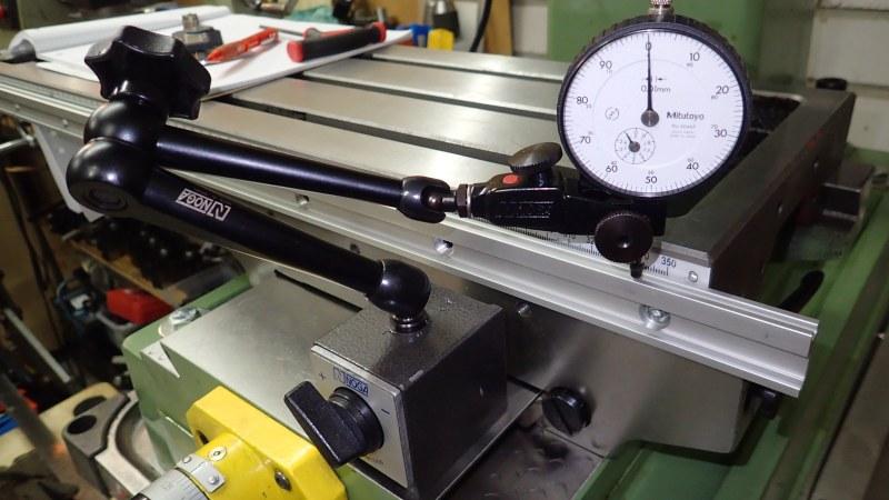

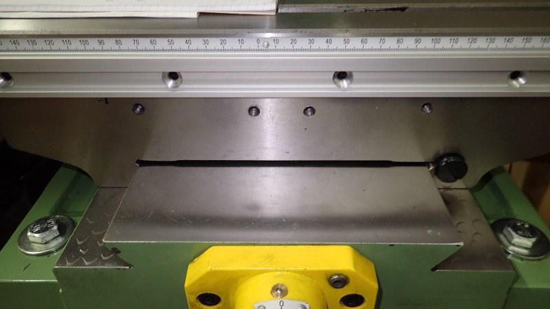

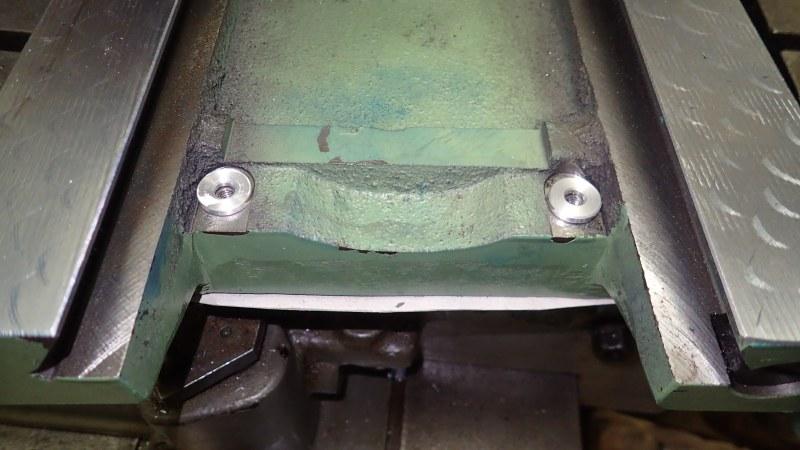

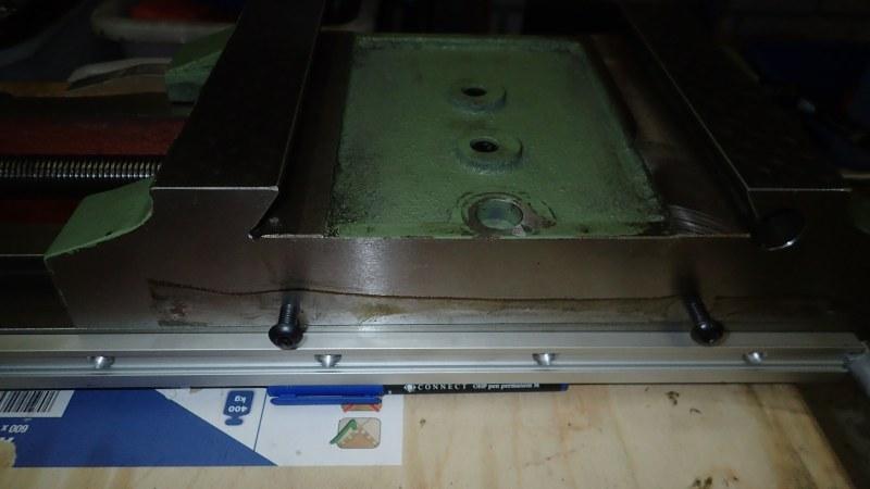

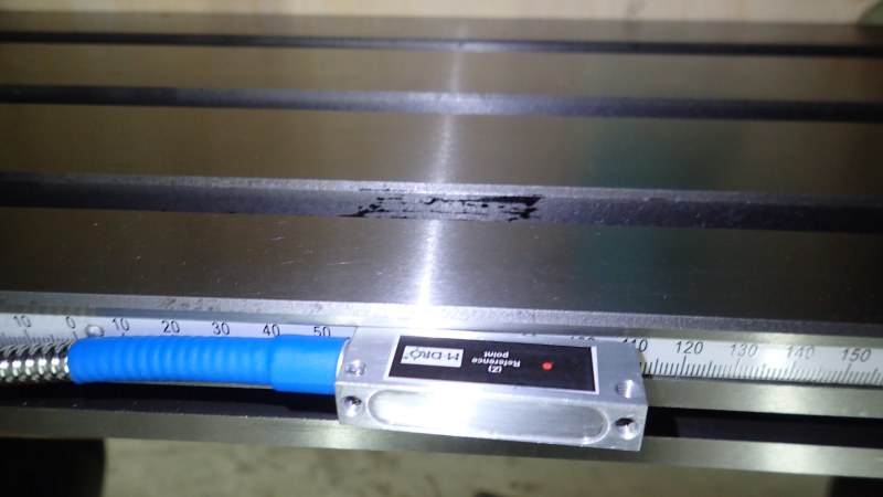

Did a little mockup for both X-axis tape options.
Pic 1: Permanent marker pen (left) where magnetic tape would come if I want it out of the way. Ballpoint pen (right) if I want to hang the tape behind of the table.
Pic2: This would be the easy option: Measurement behind of the table. Hardly any machining to Warco mill parts. Could use supplied parts to mount the magnetic scale. Mounting the reader head would be easy, could use supplied hardware or make simple mount.
Pic3: IF want to mount the magnetic scale inside the table (as in pic 1), the reader head needs to be recessed into saddle. Position needs to be 10 mm down and into machined surface from the place it is lying in the picture. Dove tail comes into way with straight endmill. This needs a bit special endmill with thinned shank or small T-grove end-mill make it. Therefore this will be not my prefered method, unless I need all the movement range in Y-axis (and therefore can't mount the scale behind the table).

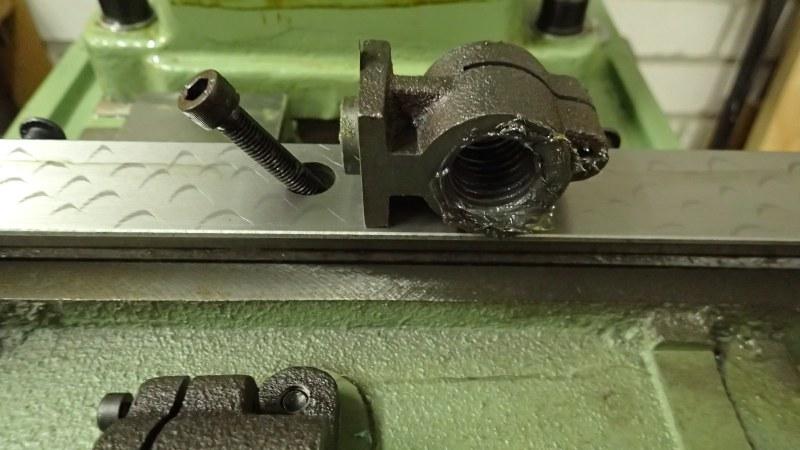

Pekka,
while you have the Yaxis apart, check the flatness and fit of the Y nut to the saddle  . I found that this interface was a source of backlash in my rollernut conversion.

Thank you. I will check that.

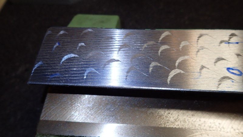

I noticed that all of the threaded spindle nuts and bearings are mounted onto painted cast iron. Not the normal industrial practice.
One thing that baffles me that that ground way surfaces are flaked lightly, probably to retain oil, but mounting surfaces are pretty rough. Also the taper gibs seems to be very agresively scraped on the way side (but that part of the way itself is not flaked....). The gibs are unfinished on the other other side, couple of deep scores, I flatten with file, just to knock burr off.
I am also eyeballing it to see if it would benefit from way lubrication points, way oil seems to stick onto surface, but I have used plenty. Maybe a little less would be more.

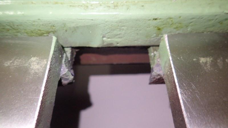

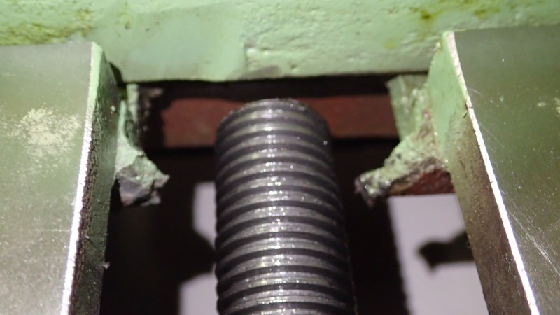

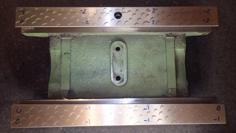

And while at it, I decided to check why my mill had only 180 mm of cross traverse instead of advertised 203 mm. Someone forgot to snag the cast iron plinth opening.
5 min with hack saw sorted it and now cross traverse (Y) is pretty much exactly 200 mm. But now there is no room for X-scale behind of the table with standard mounting hardware anymore.

Take a bit from the front and put a stop at the back .

« Reply #21 on: January 05, 2019, 08:54:21 AM »
The stop would have to be for the lead screw nut to hit , it's the nut that limits travel on my minor the casting was curved and angled the nut was flat , and only about 6mm thick just filed it square and got another 10mm .
« Reply #22 on: January 05, 2019, 11:11:28 AM »
Yesh, there is a curve at the front end of the plinth. Cuout is U-shaped and I was working on with pilar end. Need to chek if the spindle reaches far side of the table.

You could do like I did on my cross slide, and bond the magnetic tape directly to the machined back side of the table.  If you put the reader off center, you could get it on there with no loss of travel.
« Reply #24 on: January 05, 2019, 03:38:57 PM »
That is a pretty good option. Easy to make and maintain.

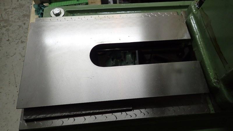

« Reply #25 on: January 07, 2019, 04:09:20 PM »

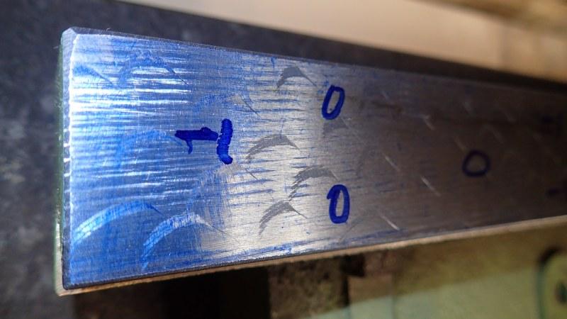

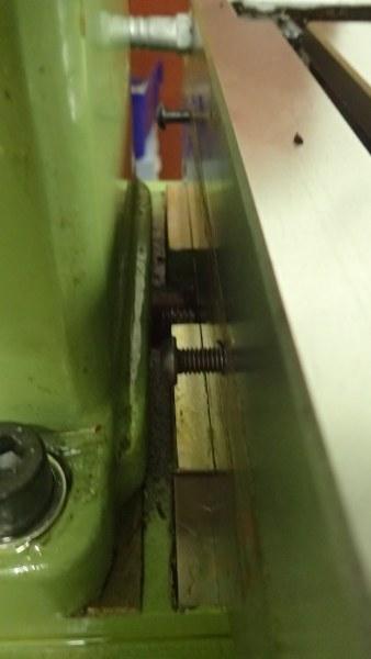

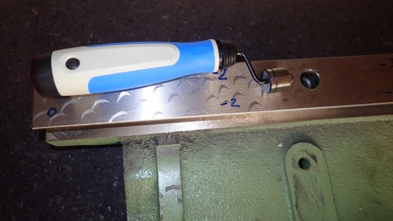

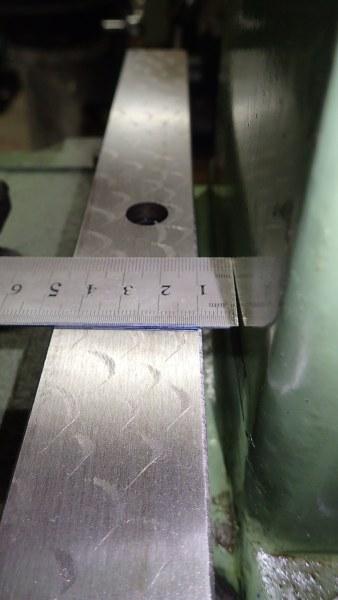

Checked this option at the far side of the table and there is a loss of travel or loss of measurement.
If the read head is put side of the pilar, it does not interfere with Y-axis travel, but does not read extreme right of X-axis direction.
If the read head is located to read all of X-axis travel, it will clip about 9 mm of Y-axis travel, does not sound much, but it is all located at the useful front part of the table.
So, did a mock up all three options and measured how much things change. No really easy and smart way to do it without any compromise.

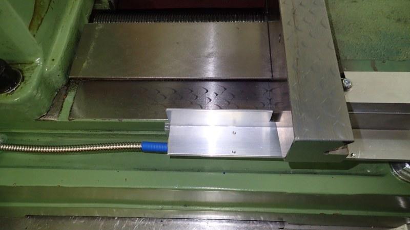

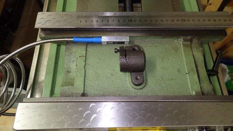

« Reply #26 on: January 09, 2019, 04:11:58 AM »
Still dragging my feets....

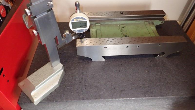

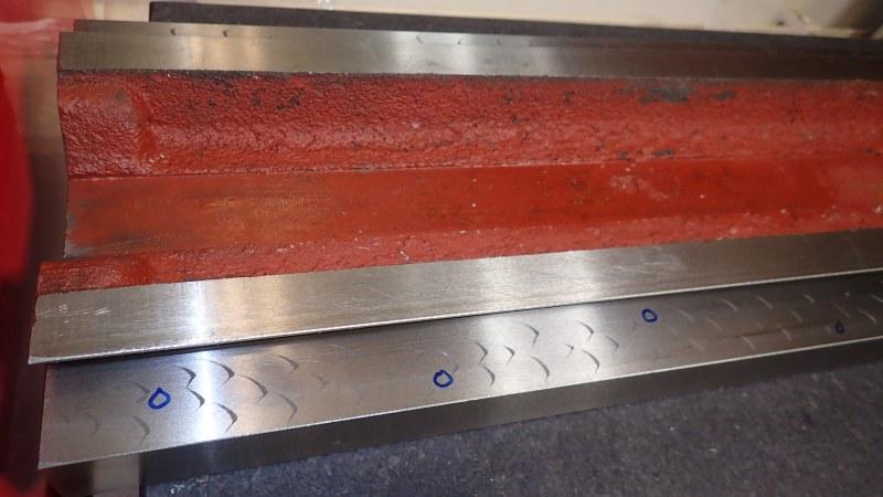

And got some piece of usefull information: Apparently castings of these cheap mills are not normalized! Amazing. Therefore milling them grooves or pockets is apparently a bad idea. I found one case that mill T-slot table was straight originally, but developed a warp after a pocket for ball screw nut and a grove for ball screw was milled. The warp was in order of 0,1 mm and the grove for the ball screw was 3 mm deep 30 mm wide. Therefore it looks like a bad idea to mill on cast surface. Bugger.

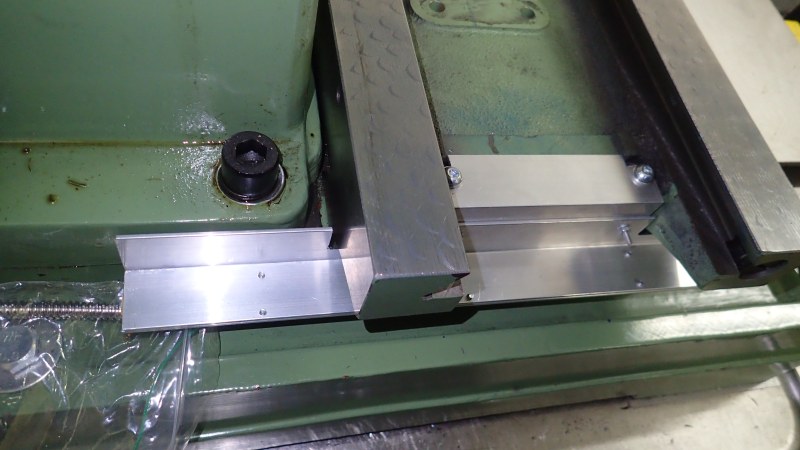

Plan A is to mount:
* X-axis scale behind the T-slot table and accept a 60-70 mm of lost travel distance. I very tempted to use supplied aluminium extrusion to mount the tape, it would provide some protection for the tape and inhibit only 1 mm of Y-axis movement.
* Y-axis is harder, I allready ordered the parts to mount the tape at the top of the table on flat channel - no problem there. But the read head mount would need a pocket milled right into virgin cast surface on the saddle - where it has a great potential to warp TWO axis movement.
« Reply #27 on: January 09, 2019, 05:32:28 AM »
The warping is obviously relieving stresses in the casting by removing a surface layer, in much the same way that cold rolled mild steel will warp if one side only is milled.
Sadly though if the castings are as bad as you suggest then there will be some warping over time even if not machined  :(

I was considering it, but it would bring the read head forward and fairly middle - to my work area.

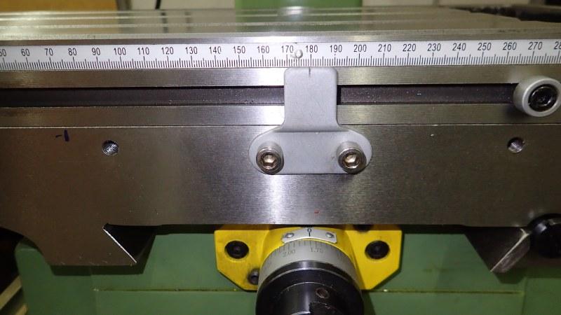

Easiest way to mount the tape on the front of the table would be to remove the measurement tape rule out of groove and replace it with the magnetic tape. Perfect fit. Then it would be possible to use mounting holes of the stationary top block and indicator and replace it with a foot that would double as stop block and read head mount.
But then the tape would be really front of the table, where I tend to use squares, tools, magnetic stand etc. And the read head would be pretty proud and non shielded location.
Second option would be to mount the tape below the current stop into more protected position. That would mean some machining for the magnetic tape (2x10mm grove for magnetic tape + 0,5x16 mm for 0,2 mm stainless steel protective strip. This machining would be into readily machined surface .... maybe minimal chance for warping?
OR bolt on rail for magnetic tape and wonky looking arm. for stopper to clear this.
Another hour or two lego play time on the milling machine :lol: Maybe all would just fit there and convincingly stay out of troubles way.

I am now considering seriously fitting the scale front/low in lieu to X-axis stops. Where is this world getting at?

« Reply #31 on: January 09, 2019, 04:55:53 PM »
Mount the scale to the front. then...
make a couple of stops that attach to the Table dovetail  and to the small area below the scale .  If you are using stops , then you are unlikely to be using the full range of the table , so the loss fo a few centimetres of 'stop' range wil not cause you a big problem ( nothing that could not be fixed 'on the day')
Make an electrical stop that bleeps with incresing rapidity as you approach the stop point.
Offline seacat
  • Posts: 3
« Reply #32 on: January 09, 2019, 06:23:55 PM »
The term "snagging" in the UK usually refers to correcting the defects in a project.  As a project progresses defects arise which need to be 'corrected'.  These are put on a "Snagging List".  Before the project can be said to be completed all the '"snaggs" on the list need to be corrected to the project managers satisfaction.  Amongst other things.
That's the theory anyway!   The practice may be different!
Chris
« Reply #33 on: January 10, 2019, 01:32:16 AM »
That is actually a very good idea!
I will not need them often (even less so with DRO) and mechanical stops right at guide ways must surely be most accurate. Pretty high on the list when making about hundred teeth and depth is is set by a end stop (done that). Now I need to check the details i.e. which surface to use as a stop, does it needs a taped stud or small flat or what. Would be easy to do now when it's in parts.
« Reply #34 on: January 10, 2019, 02:43:17 PM »
Jep, it would be pretty easy to mount the rail into table stopper rail.
Looks like should remove the tape rule from the table or least flatten the rivets.
Standard read head mountung hardware does not fit, but proper one is not too hard to make.

And because this is somewhat disasembled, might as well check how true parts are.
I measured horisontal plane in 0,01 mm resolution, checked first with thick blue, knock off some raised edges and burrs and then checked with very thin blue.
The surface looks a litle unusual.
Offline seadog
  • Posts: 223
  • NE London
« Reply #36 on: January 12, 2019, 08:58:13 AM »
I see a scraping project about to commence  :D
« Reply #37 on: January 12, 2019, 09:58:56 AM »
No no no...this is good enough now. I'll use it as it is until it starts acting up. There is still a possibility that castings start to warp or something.
Offline seadog
  • Posts: 223
  • NE London
« Reply #38 on: January 12, 2019, 10:42:04 AM »
I assume that you're hoping the castings will warp in the correct directions then, Pekka?  :lol:
« Reply #39 on: January 12, 2019, 12:39:52 PM »
I hope that castings will behave themselves.
The table looks pretty straight and contact between table/saddle is pretty civilized.
I don't have dovetail straight edge to check the guide ways properly, but looks ok.

« Reply #40 on: January 19, 2019, 05:38:59 PM »
Today I had few extra hours and plan was max. results with minimal effort.
I could not locate thick enenough aluminium for support, I mostly used 30x30 mm 2 mm thick L-profile.
Mechanically it appears fine, but I haven't tested it yet electrically.
Magnetic tape is now 2 mm off the sensor. Plan is to file 3 mm bolt holes oval just enough to bring the tape near the sensor but avoid physical contact.
Still two separate items left: X-axis and configutation.

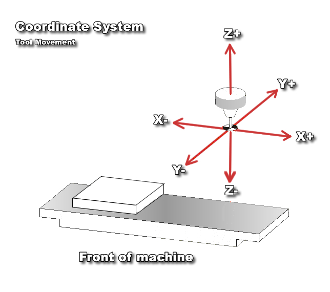

« Reply #41 on: January 19, 2019, 06:57:55 PM »

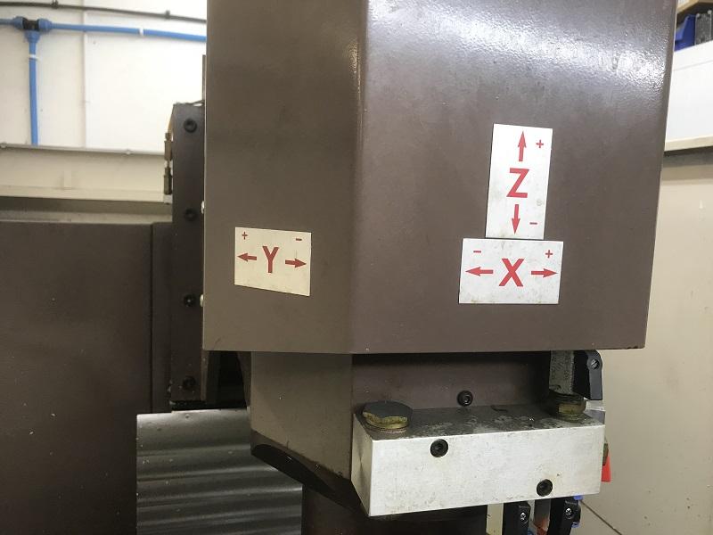

Now the interesting question. Which way should axis indication increase?
CNC easy, two views, same result...
https://www.researchgate.net/profile/Joseph_Flynn3/publication/305647139/figure/fig1/AS:390298015420416@1470065706279/Schematic-of-the-axis-configuration-found-on-the-XYZ-1020-VMC-machine-tool-used-for-the.pngDRO for Warco Major mill
[/quote]
BUT this is a manual machine
1: When I turn Y-axis wheel clockwise table will move away and numers on micrometer will increase.....it would be elegant if the numbers on DRO would increase as well.
2: Looks like it is rather popular to zero origo on fixed jaw of the vice. Obivious benefits.
Any takes?
« Reply #42 on: January 20, 2019, 04:45:34 AM »
You can configure each axis to read either positive or negative for a given movement.
« Reply #43 on: January 20, 2019, 05:30:47 AM »

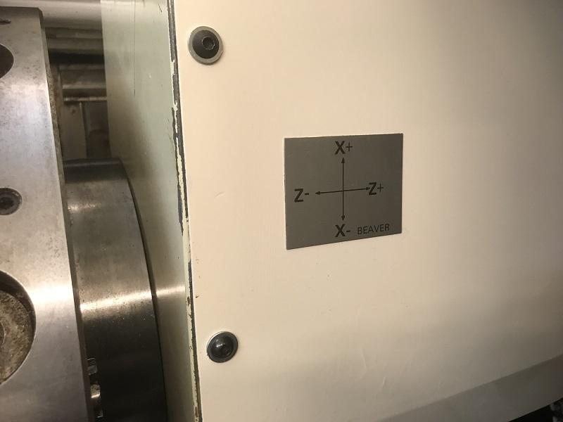

These are the axis designations on my Beaver Mill (Fixed table moving quill) and my Beaver Lathe (Moving Turret) if it helps:

Forgot to put few earlier pics on cast iron flats for mounting. 16 mm indexed mill, M6 threads and 3 mm spacer washers to raise the bracket off the rough cast surface.
There should a alrge mill in the darkest corner that is big enough to mount all parts of the other machines for modifications.... :scratch:
Tested the Y-axis, works fine and tape/head is in correct relation (both pulse count A/B, ref and direction).
« Reply #45 on: January 22, 2019, 05:04:44 PM »
Two hours on two days -each and X-axis measurement is ready.
Still left final cable routting, but this looks pretty compact.
Not as well hidden than my original plan, but better than I were afraind.
I tried to make all prts to hug as close to machine core as possible.

« Reply #46 on: January 22, 2019, 05:31:56 PM »
That is a nice way of doing it!
