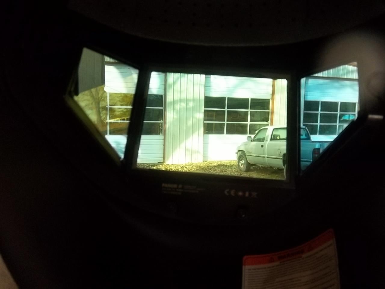

 I want to mention that I did get my true color welding hood yesterday and was out there this morning trying it out.... I can see!!!!!!!!!! My old Tig will only go down to 10 amps but for the first time ever I can actually see a puddle at that amperage.
   Thanks again John for the product mention. I got the wide view version.

 You put me in a bad spot Welding Rod. First I have to admit that this new windows 10 operating system-only a couple months since I got it-- is so different from what I am used to that I cant figure out how to link to another page.. I am sure it is quite easy but I am 6 months into Chemo Therapy (2 more years of chemo therapy is already scheduled so that my brain does not work 1/2 as good as it used to. Oncologist tells me that it will be 6 months until my brain gets back to normalcy, he also says that I have an 80% chance that the cancer will return within 5 years)....... Also, I am in the USA so my link will be no good to those in the UK and elsewhere.. I had hoped I could hang back and John would have linked to his unit.. I cant help you.

I'm in Texas, so the UK link isnt super helpful.  The pictures ARE!  OMG big dc difference if it's real!  Tempted to get helmet, um, #3...

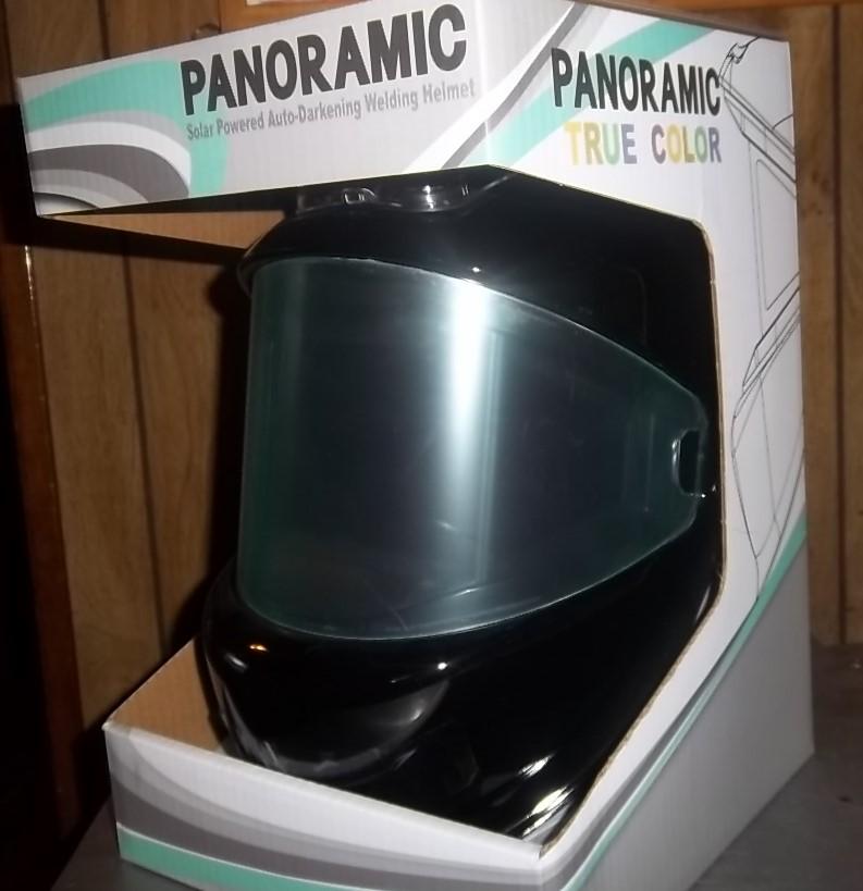

     I don't hate windows 10 as much as I did when I first got it. Still I keep several other computers for CAD and to operate my cnc mill and I like the older systems much better.
    Anyway , best I can tell you is the name on the box for this helmet marketed in the US is Panoramic True Color. I imagine the same Chinese company made my helmet and Vintageclassicrepairs helmet. They are not the same helmet but virtually the same specifications.... The Chinese will print any name that anybody wants. Last week I received some carbide indexible inserts from China that are labeled "Mitsubishi" and "Made in Japan" ..A complete lie. But the carbide inserts were dirt cheap and look great..
    Picture of my helmet while still in it's box. Easily found on Ebay. It is quite a helmet.
