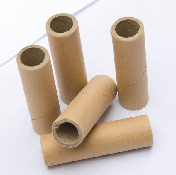

I want to be able to wind some 'cardboard' cores on which to wind some paper.
Those members with roll-fed labelling machines or who have worked in the paper and board industry will know immediately what I mean. Most tiolet rolls have a core.
I imagine a bar (brass or steel?) between centres on the lathe with a number of sectors fixed ( but adjustable diameter ) to the outer diameter but I am really lost on this!
The sizes I want to make are between 20 and 50 mm ID and up to 100 mm long.

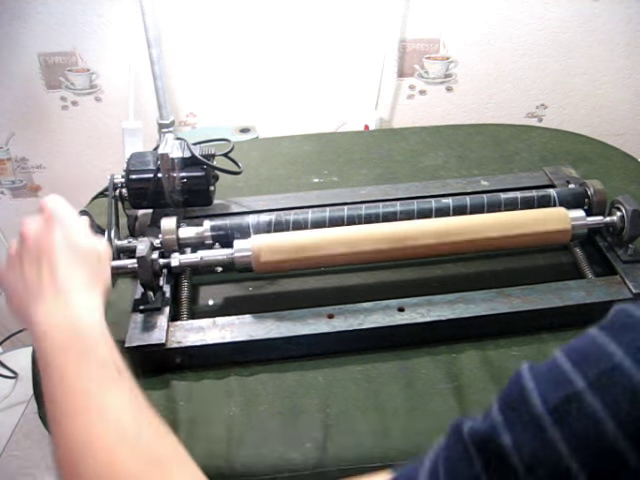

As Bill Todd mentioned in his reply I haveexamined the idea of a collapsible mandrel.  I am told this should not be necessary (I'm looking forward to proving this). It seems that with the correct adhesive, tension, nip pressure and attention to the condition of the mandrel that a core can be wound which needs minimal force to remove. First picture from the tube gives an idea and in the actual video he manages to remove the mandrel without brute force.
Making a spiral winding machine is much more challenging. I intend to spend some time drawing out how this might be done. Watch this space but don't hold your breath.  See the second attached picture from UT for the drive mechanism of this sort of machine. The mandrel in these machines does not rotate but the constant polishing of the paper against the steel keeps it in good slippery condition. Industrial machines need some considerable power to drive the belt rolls, typiccally 40-50 HP depending on the number of plies being combined,

I've just finished a spiral winder , on a somewhat different scale to the one in your picture , I had to deal with +/-1um tolerances and one dimension spec'd at 3.2um . Amazingly, there are parts of the above paper coil winder that are strangely familiar  :D

i was just amused by the similarity of the machine to wind paper and what I made to wind tungsten tape

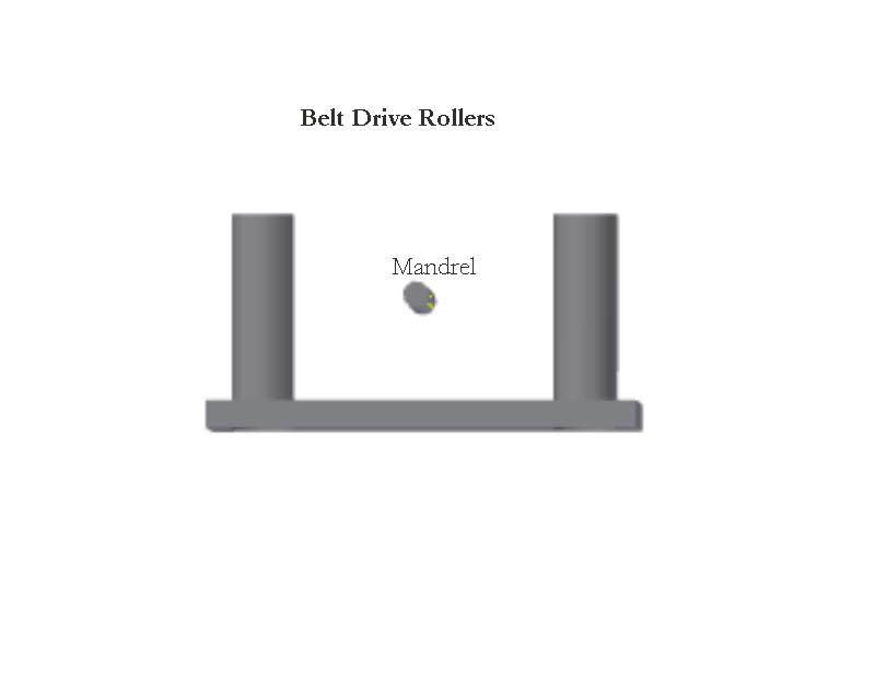

After a lot of cogitation and even more guesswork I've made a start on the drawings.
I have started on the most important part of the winder, the winding uinit itself. The components are shewn in the second picture and the proposed assembly iin the first. The relationship of the mandrel to the winding belt (not figured out how to draw this twisted thing in Inventor yet) is in any case and the first picture represents the view along the centre line of the two drive rollers and the end of the mandrel
This drawing is based on a mandrel diameter of 10mm for ease of doing the sums.
