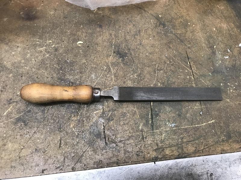

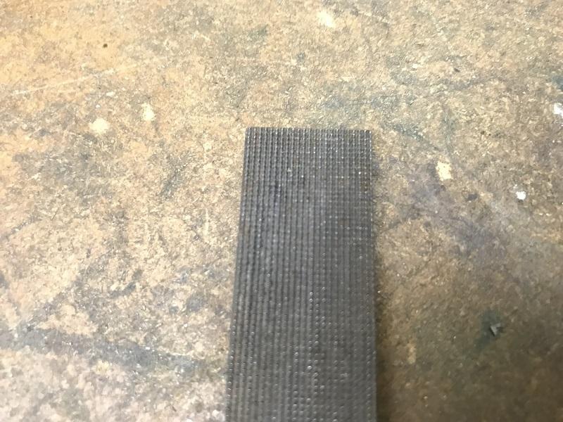

Well I've solved the problem and serrated my first knife  :ddb:
It's so simple it's silly, when you know how. You use a "Chequering File" which looks like a normal fine cut hand file, but has grooves cut along it's length, so as you gently file you leave a series of 'teeth'. Cutting wider than the file is no problem as you just locate the file in the previously cut teeth and carry on.
Pictures to follow, but I'm preparing for a dinner party so time's short (starter done, table laid, white wine chilling, red wine acclimatising  :thumbup:) - I'll do the other knives tomorrow and take pictures.
Chequering files are rare beasts, but I had a visit on Sunday from a friend who knew what they were and moreover had one of suitable pitch which I have on loan against my life as security.

What's the difference between that and a thread file  :scratch:

« Reply #19 on: November 14, 2018, 01:02:40 PM »
The price, probably  :lol:

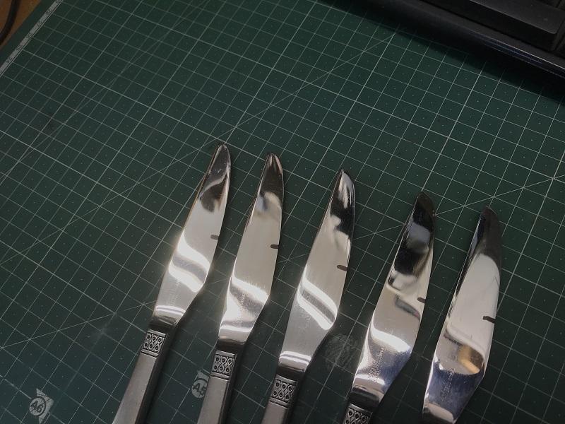

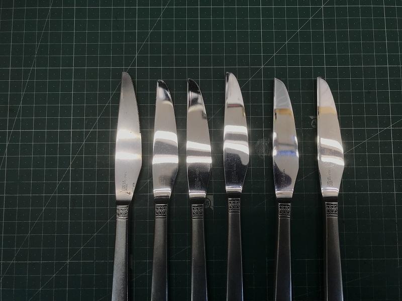

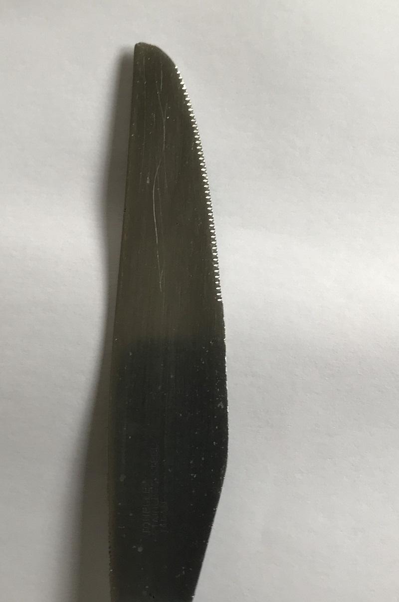

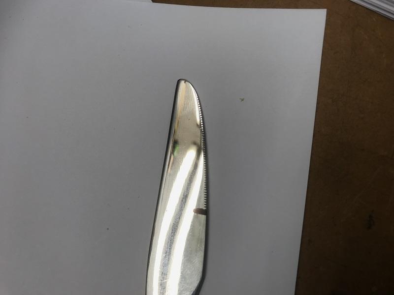

As promised, pictures of the Chequering File and the knives now serrated  :thumbup:

« Reply #21 on: November 15, 2018, 10:07:54 AM »
Well a song n dance about nowt.... :lol: Looks a mighty fine job from where I'm sitting...easy-peasy when you know how.. :dremel:
