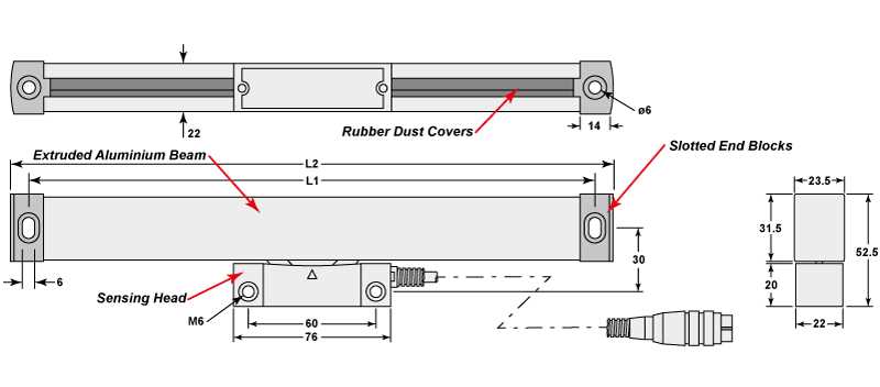

Im just about to order a Chinese set of  Dro scales and Display for a Sieg SX2 Plus its basically the sx1 with a larger table I think.
Anyway have measured up and wanted a 2nd opinion if i have gone wrong here in my sizing or idea.
The x travel is 280mm and the Bed size is left to right 400mm
The Y Travel is 150mm and the carriage size is front to back 220mm
The z Travel or height of complete column is 500mm.
Now the Scales are in 50mm increments...so in theory if you want a travel of 280mm you would choose a 300mm ? which then the Physical length is 300 + 150mm or thereabouts for mechanism. which in theory means its going to be longer than the Bed..
Have i Missed something obvious ?
Many thanks in advance also anyone bought from Aliexpress, bangood, Ebay etc with good results , and whats the deal with the Shipping duty thing does that kick in or do they generally say its worth a dollar to get out of it ?

Buell,
Sino do 16 x 16 section scales and do a 280 mm scale. The overall length is 383mm. The range is called KA200.

« Reply #2 on: October 13, 2018, 02:03:37 AM »
You need to add the size of the read head to the length plus clearance .

« Reply #3 on: October 13, 2018, 05:13:04 AM »
Thats what i thought so it will stick out 10 to 15mm at either end of the bed. So when i have seen most scales they all seem to be either shorter or the same length...thus they wouldn't have the Full travel of the machine ?

« Reply #4 on: October 13, 2018, 01:58:43 PM »
I would buy the long scales about the length of the table; makes mounting easier.
It they are the Aluminum/circuit board capacitive style, then they are easy to cut.

« Reply #5 on: October 13, 2018, 04:27:35 PM »
150mm for the reader head length seems excessive.
What scales are you looking at?
There are various options depending on how much space you have available.

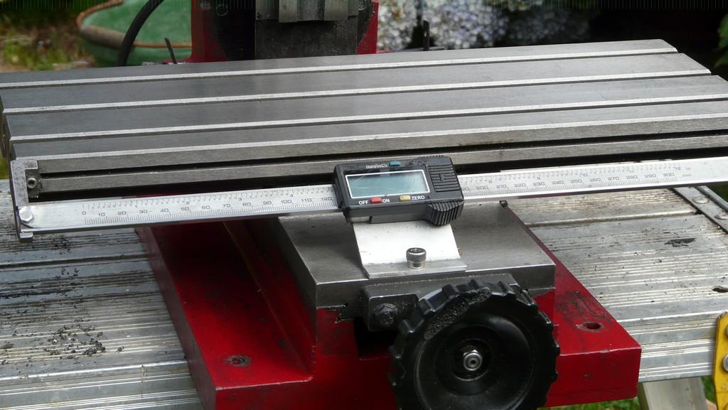

« Reply #6 on: October 14, 2018, 01:53:55 AM »
I made my mounts the same size as the table on my X1 that has the same table .

« Reply #9 on: October 14, 2018, 01:52:41 PM »
Those are the more common size of optical encoders, but you can also get a slimmer version, which can be handy especially on the Y-axis where mounting space can be at a premium.
I'll send you a PM with some details.

« Reply #10 on: October 14, 2018, 02:44:35 PM »
Does this help ?
