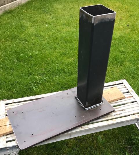

Its a sx2 plus and at the moment Im building a Column support and base to try and stiffen it up there, any info on Mods would be great ..I know its been a while since I was on here but the lathe is great now i got it all sorted.

Heres a stand Im trying to beef it up with..
