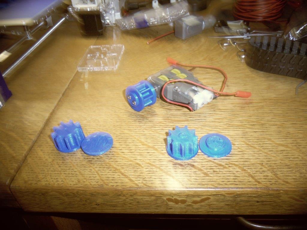

I printed the parts for the track drive sprockets.  They look real pretty and they're even a nice snug fit on the 2.6mm hex drive axles from the Tamiya gear box - unfortunately they don't fit the treads.  The treads are a flexible rubber band with hard plastic tread plates bonded to the inside of the band.  I measured the width of the plate at 6mm, I couldn't get an accurate measurement of the gaps between the plates so I measured the length of 5 plates and spaces by measuring from the leading edge of the 1st plate to the leading of the 6th plate, this measured 50mm.  So I've got a 10mm pitch between the links.  When I wrap the tread around the existing Bruder "drive sprocket" it looks like 9 "links" will fit.
So, 9 links at 10mm per link gives me a circumference of 90mm.  Dividing this value by Pi gave me the outside diameter of the "drive sprocket" with 9 teeth.  I used that value when 3D modeling the sprocket.  But when printed, the first version didn't fit.  I didn't allow enough clearance at the bottom of the pocket for the guide tabs and they bottomed out holding the track plate clear of the side plates of the drive sprocket.  I redesigned the pockets and reprinted the sprocket, it fit the track plate just like it was designed that way.  When I tried wrapping the tread around the sprocket to check the spacing it didn't fit.
WHAT THE F----!!!!  I re-measured everything and came up with just EXACTLY the numbers that I was expecting, so why doesn't this stinkin' thing fit.
Late yesterday I had an AHA moment.  I realized that the 4mm gap between the tread plates was not located where I was originally thinking it should be.  I was thinking that it was on the side of the plate that contacts the drive sprocket, it's not.  The contact point between the tread plate and the drive sprocket is at least 1mm closer, the thickness of the plastic plate, to the sprocket axis.  I modeled it again, this time using the brute force method.  This time the diameter to the contact point was about 28.5mm, as opposed to the 30mm-ish that I was using before.
This time I may just have a winner, I'm going to reprint this tonight and find out.  I'll take pictures of the before and after versions.

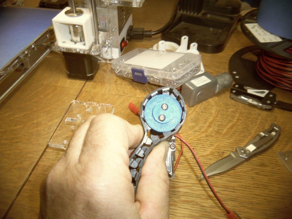

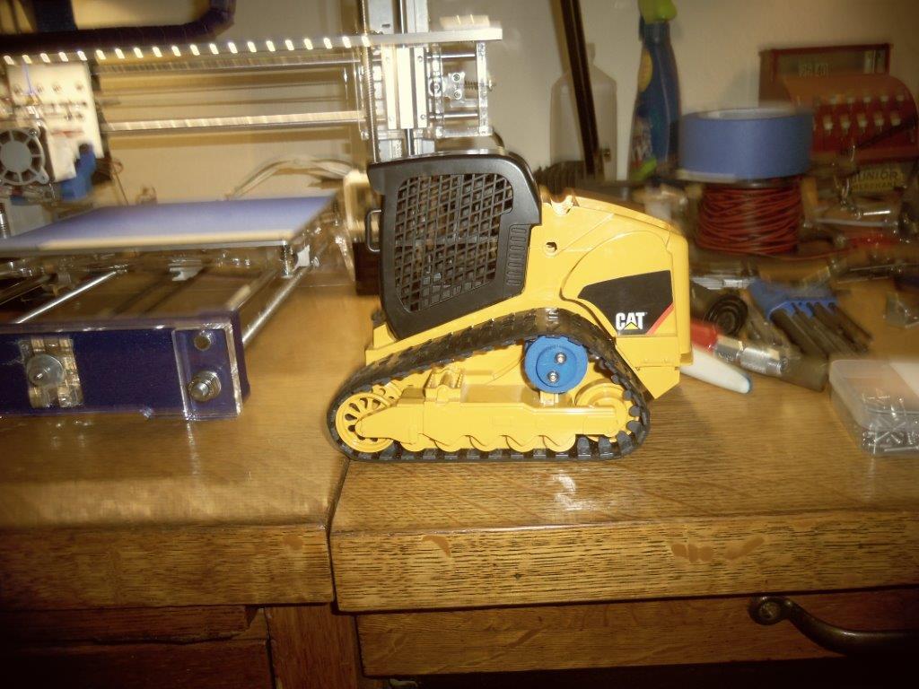

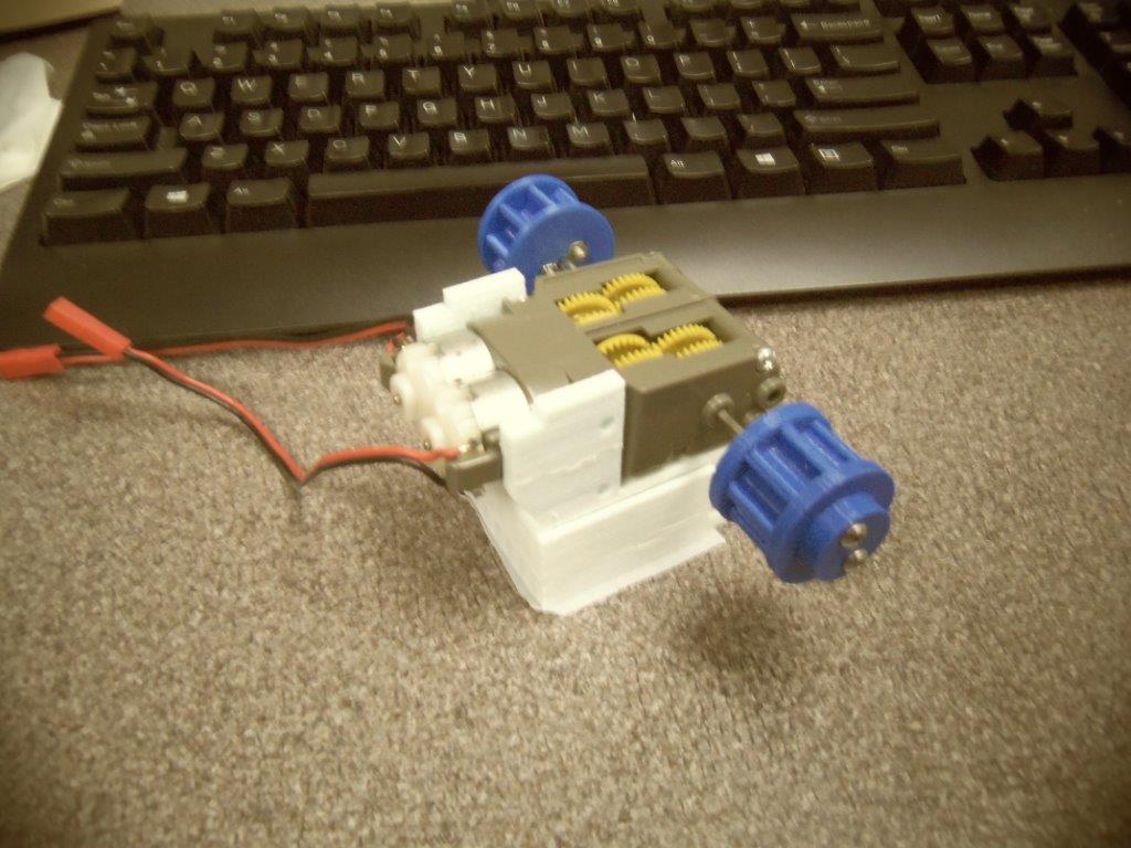

Since nobody believes you if you don't gots pictures, I GOTS PICTURES!
The first attachment shows the 1st, 2nd and 3rd failed attempts at making a usable drive sprocket for the tracks.  The group in the lower left was the 1st attempt.  The "sprocket" was SUPPOSED to fit into a pocket.  My printer doesn't make neat and reliable bridges - yet.  The group in the lower right is the 2nd attempt which eliminated the large pocket.  That part was a success but it didn't fit the tracks properly - not enough clearance at the bottom of the openings for the track plates.  In the 3rd attempt, that blue part on the gearbox axle I went from a 2 piece assembly that would be glued together to a 4 piece assembly that is bolted and glued together - still didn't fit as shown in the 2nd attachment.
The 4th try was the charm, not the 3rd, as shown in the 3rd attachment.  When I wrapped the track around the drive sprocket and it fit just like it was designed for it, I couldn't resist.  I had to put it on the skidsteer and see what it looked like.  I've got some clearance issues, 4th attachment, but that 's just a matter of getting rid of a little plastic.

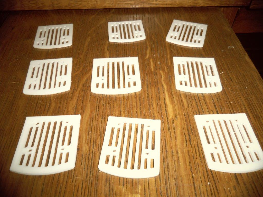

The part that gave me the most trouble was the replacement radiator grill.  On the original Bruder model this is a solid part.  I wanted to open this up and mount a cooling fan under the grill.  Partially just because I could, but also because it seems like I'm trying to fit 10 pounds of parts into a 5 pound sack and some of those parts have a tendency of getting a trifle warm.  Battery packs and drive motors for instance.  A cooling fan won't hurt anything and it just FEELS right.
The first time I printed it the grill ALMOST fit.  The width was a little too tight, so I took off 0.5mm and printed it again.  The curve where the angled grill meets the counterweight was not quite right, but it was acceptable.  However it was TOO long by at least a mm, maybe two.  So I took a mm off the length and printed it again.  IT STILL DIDN'T FIT - too long!  WTF, I cut it off twice and it's still too long?  This started an almost day long adventure into checking/verifying slicer and printer settings and calibration.  The most frustrating part was that everything checked out as being OK.
All right, what is going on here?  This part starts out at a 13.5° angle from the print bed.  I rotate it so that it builds flat and doesn't require support to print.  Is that rotation is causing the issue?  I'm going to take another 2mm out of the length, print it, and fix the fit with a file if I have to.  So I take 2mm out of the length, fix the hole size for the cooling fan mounting bolts and print it - again.  WTF???  It's 4mm too short?  How'd that happen?  I modified the 3D cad file and saved it, check? Check!  I saved the STL file after I modified the 3D file, check?  Ummm... awww-CRAP!!  I wasted most of a day because somebody forgot to save the stinkin' STL file?  It's obviously time to hire some competent help around here.  Crueby gets shop elves that work for cookies, and all I get are stinkin' shop gnomes that sit around claiming they're on their break and threatening to file grievances with the union?  I guess you get what you pay for huh?
Pictures will follow.

Since "It didn't happen without pictures", I brung pictures.
The first attachment is the radiator grill/cooling fan fiasco.  I don't wanna talk about it.  Let's just say that when I screw up, I don't do it in half measures.
The cooling fan that is mounted to the radiator grill will blow air down over the TREX board, onto the drive motors, across the battery pack and out the opening cut in the floor of the cab.

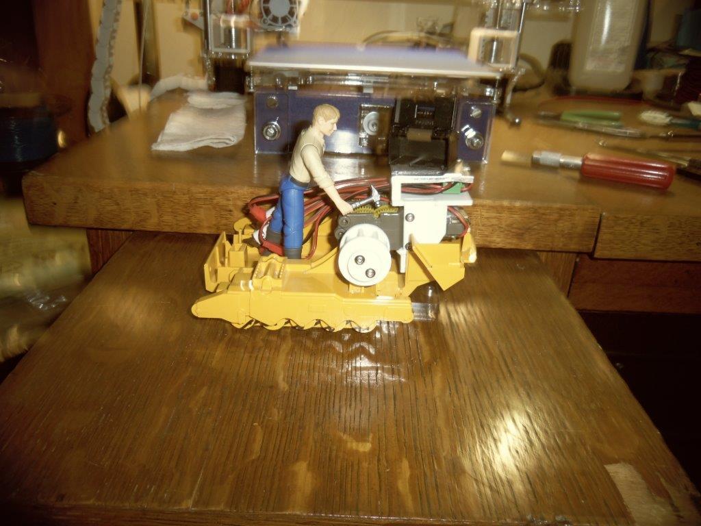

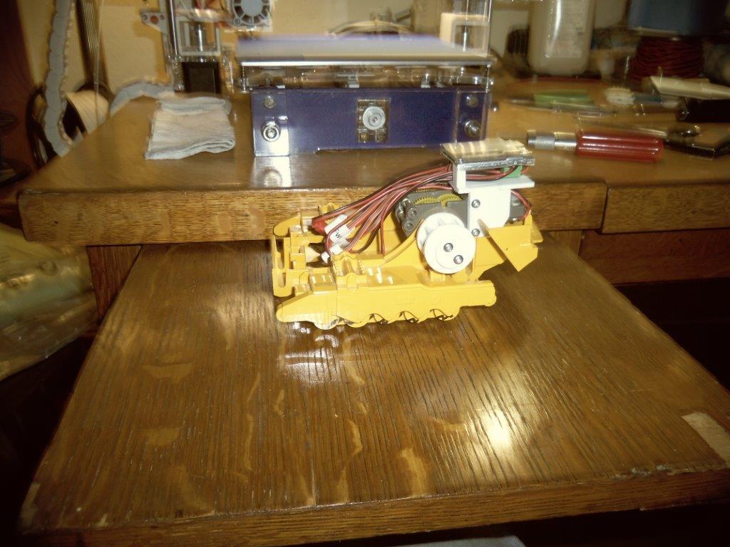

The third attachment is the transmission mount, transmission/motors, TREX driver board mount, and TREX board in what will be their permanent homes.  With the re-designed transmission mount I've got room to slide in just about any capacity 2S Lipo battery pack that I want to use.
The fourth attachment is my "helpful" shop gnome doing what he considers to be helping.  I guess it really is true, if the only tool you have in your toolbox is a hammer then every problem looks like a nail.

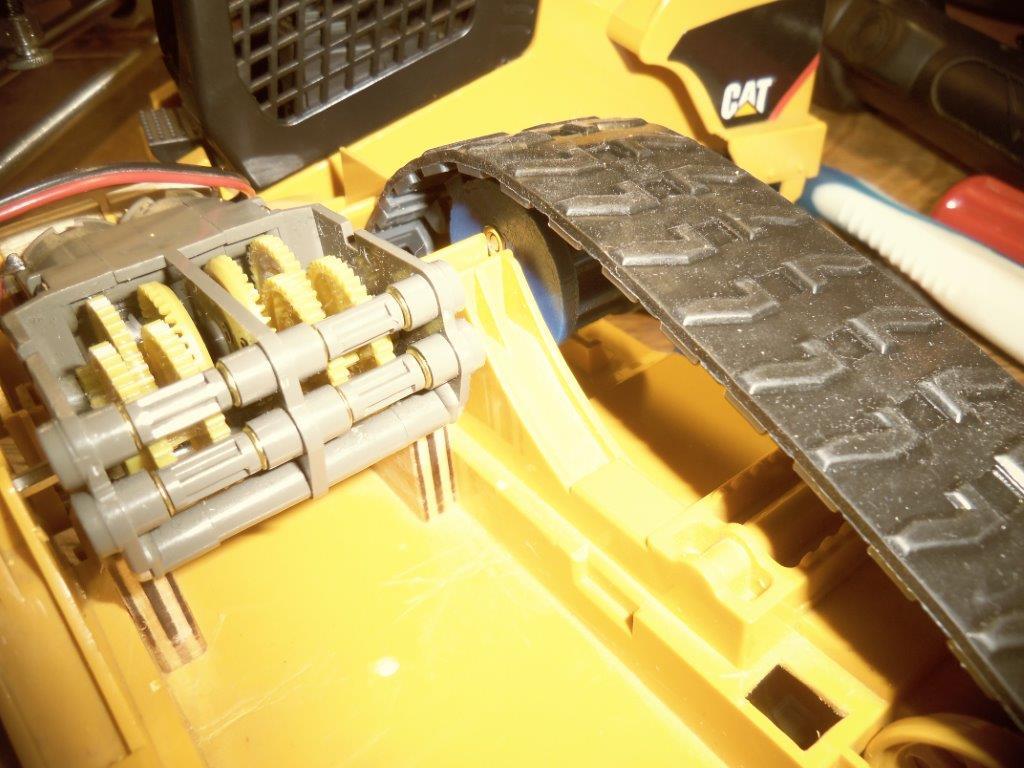

Pololu lists the gear ratios of my gearbox at 204:1 and 58:1, my numbers don't jive with that.  Counting the teeth on my gearbox, I get ratios of 209:1 and 63:1.  A 6V series 130 motor has an 11,000rpm no load speed.  Using my ratios I get output speeds of either 53rpm or 175rpm.
As a sanity check I decided to work it the other way around and see what the output speed should be for a realistic scale speed.  The speeds I found suggest that a tracked skidsteer will have a top speed of 10-12mph.  [Insert RANT here.]  No I'm not going to convert it to metric for you.  You guys can convert to metric measurements just as easily as I can convert to Imperial measurements. [End RANT.]  This scale 12mph converts to a linear speed of 66 feet/minute. The tracks on my Bruder skidsteer have a 10mm pitch and my drive sprocket has 10 teeth, so this means the tracks will move 100mm per revolution of the sprocket - close enough to 4 inches for me.  Crunching the numbers... drum roll please, we get a total of 198rpm of the drive axle to move at 66 feet/minute.  That's close to my 175 calculated rpm for the 63:1 reduction ratio.  The 175rpm works out to a scale 10.6mph, right about where it should be.  I guess the 63:1 ratio isn't way too fast after all.
Looks like I may have to buy another copy of this gearbox, I've already got 2 of them, one in the model and another in a parts box.  Unfortunately I haven't been able to locate the 12 tooth pinion gears or the additional 3mm shafts that I'll need for the 63:1 ratio output.  The 3mm shaft I'm not worried about, but that 12 tooth pinion needs to be a press fit on the hex output shaft.  I've still got a couple of parts boxes that I need to look in yet, if I can't find them I'll need to get ANOTHER gearbox.  The 2400mAH Lipo pack arrived Monday, the smaller physical size will make finding a new home for it much easier.
