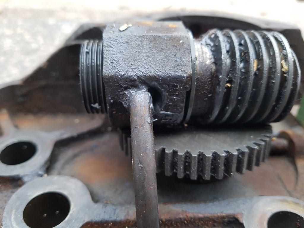

I have some wear on my boxford / southbend apron worm drive and would like to make a new one. The issue i have is what material do i go for? (not my field)
I statred out with some research but got lost in the maze of numbers altough one thing i can rule out is copper. I know i can purchse a new one but i have a lathe and could do with another project to squeeze into my 28 hour day.

Coldrolled  --  Mechanical wear (as opposed to corrosive wear) is usually governed by surface hardness and smoothness.  Thus, material that is easily hardened is one property you are looking for.  Being easily polished for maximum smoothness would be the nexy.  Do you have any experience with case hardening?

I dont see an issue with polishing but case hardening and keeping it within tolerences is a whole new ball game. In the past i have hardened bits of steel to make sockets etc in the automotive industry but it was never by the book just a grease monkey with a torch and whatever was wet to throw it in. when researching, i did look at some 4140 (Blame Mr Fenner). I can not remeber the Uk equilvlent.

Cold drawn 4140, 4130 are both reasonable to machine and quite strong as-is.  They can be oil quenched and tempered if you need really hard.  If you need really strong and still machinable, find some ETD150 or "stressproof" (which I think is the same stuff).  150ksi yield, but still tough, and machinable.  Normal cold rolled/drawn stuff is pretty good too, just machine it symmetrically, or round bar to round part wise.
If you need corrosion resistant then that's another post ;-)
