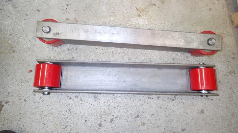

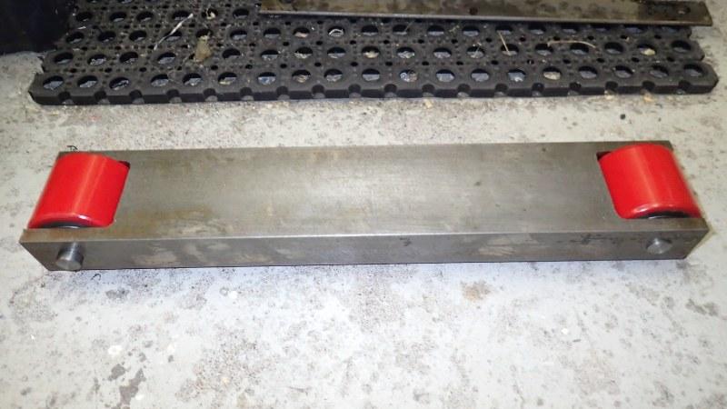

I need to move 1 metric ton and bit heavier or lighter machines ocassionally.
I build a toe jack probably two years ago, now I got impulse to build a skates.

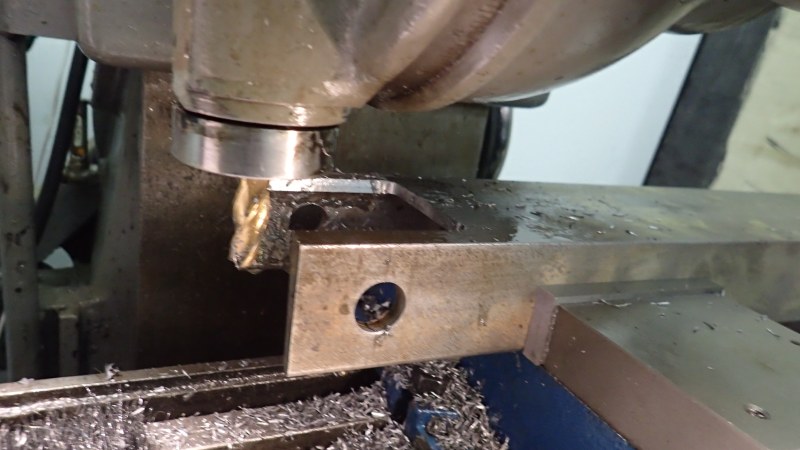

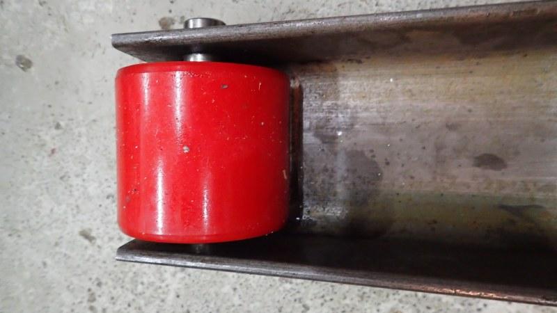

I decided to build longer kickbike types and lowest practical. I am using truck wheels and UPE beam, I had a about one metre pice ling around, I cut it half. Due height of the beams does not allow wheel to clear the web, it must have a cutout.
Soaked the parts two days in food grade vinegar to remove rust and scale. Then I used rotabroach cutter to drill holes for the wheel axles.
Rest is easier, just needed holes to clear the wheels. I don't have a plasma cutter. I drilled 18 mm holes into corners and used bandsaw to cut the excess and 12 mm mill to clean them up.
I still need to turn spacers both sides of the the wheels and turn grooves for circlips or something to keep the axles from falling off. Fit is bit tighter than sliding fit, it needs securing

Thank you. I need four more wheels. I'm not going to bother with castors if that structure works. Probably the secret is to place wheels as close as possible to each others as possible to ease turning.
Just took the beams out of vinegar, washed them and turned grooves into axles. I used standard washers and circlips.

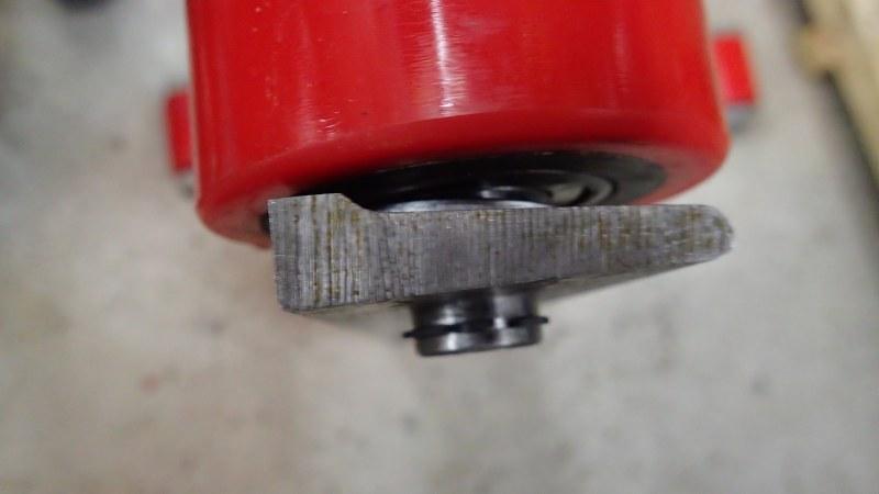

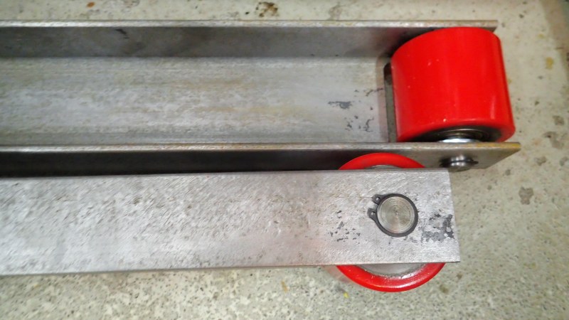

Re: Simple machine skates
« Reply #11 on: August 24, 2018, 03:15:59 PM »
I was not sure if standard washers would work with tapered sides. Looks bad, but works fine. Plan "B" was to mill pockets.
One axle needed press, others went with few taps by soft hammer.
