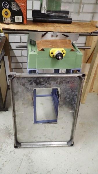

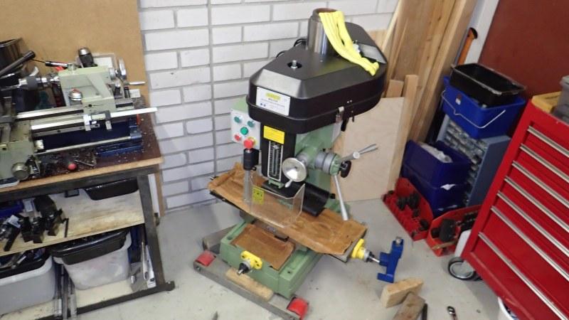

Bought the mill and thinkking appropriate stand/table/toolchest for it.
There are some sheet metals stands, but they have limited storage quality.
Toolchest would have excelent storage quality, but needs external support for the mill (dry weight around 300 kg). Wondering if the swarf and such would find easily it's way into drawers. My first instinct is to make separate skeleton stand that supports the machine and toolchest can be rolled uder it it or out. But 70 kg tool chest would add pretty nice torsional stiffness to simple table structure.
Any good ideas or pointers?

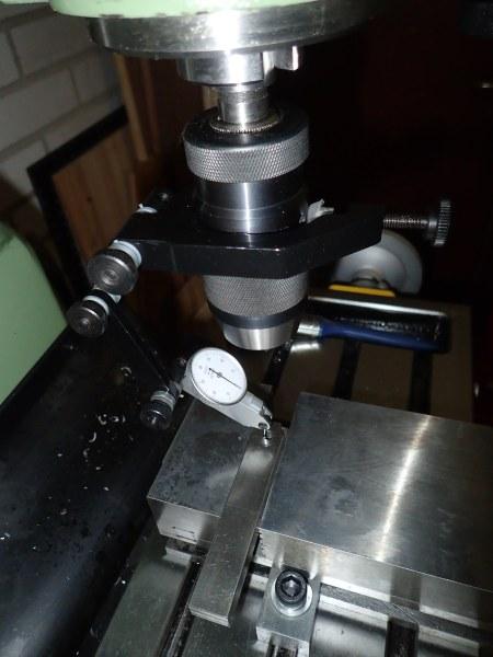

Best trick for a round column mill I ever saw was a laser pointer on the head pointing at the far wall.
Column was vertical and there was a vertical line on the wall...
Neat and well and truly accurate enough...

I thought the same thing, PK, but with further reading most who actually have tried that found it both inaccurate (several thou off) and inconvenient.
Here are two videos contrasting the indicator method and the laser pointer method.
Most people who also have constructed mechanical guide devices find an error of several thou. I haven't seen anything which looks as simple, or is as accurate as the indicator method.
indicator:
laser:

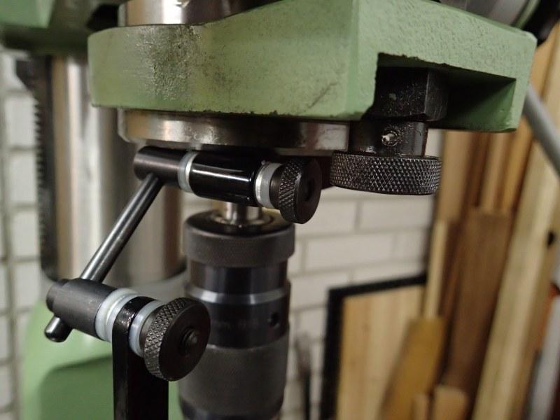

Re: Mill/drill stand for Warco Major mill
« Reply #6 on: August 03, 2018, 12:45:14 PM »
Thank you
I have been reading long time about the round column vs. dovetail column mill conondrum.
Phenomenon is true and relevant.
Most views seem to be somewhat flawed. This is actually pretty analytical and incidently it is "same" mill that I have:
beef is here (long tool priciple), the video is long, and he is explaining several things there
https://youtu.be/wy9N-jg1AE0?t=487

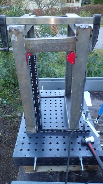

I am thinkking now the size and depth of the tray under the machine.
Pretty conviced I'll find reasonable size tool chest or drawer module under the mill table.

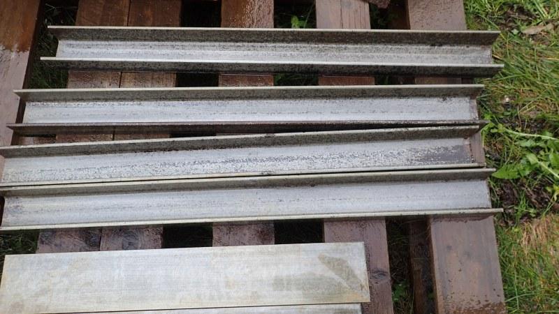

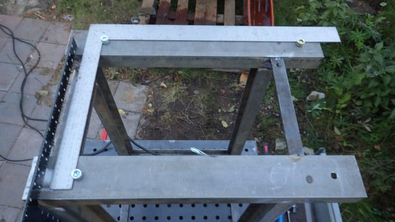

« Reply #7 on: August 03, 2018, 02:46:26 PM »
I have a Warco minor and the club has a major both on stands made from 2" box steel , no drawers underneath but open plastic storage boxes and are swarf free so far .
« Reply #8 on: August 03, 2018, 03:05:55 PM »
How is the club Major stand in practical use? Does it has a swarf tray?
« Reply #9 on: August 03, 2018, 03:18:13 PM »
Yes it has the Warco tray on a 19mm ply top , the top overhangs the frame by 75mm , still to rig up coolant for the Major but I use mist on mine as it has no tray , the Major has no drain to the table yet just a mater of drilling and taping for a hose connector .

Thinkking something like this?
https://gordsgarage.files.wordpress.com/2011/01/toolbox-test-fit.jpgMill/drill stand for Warco Major mill
https://gordsgarage.files.wordpress.com/2011/01/in-place.jpgMill/drill stand for Warco Major mill
https://gordsgarage.wordpress.com/2011/01/10/off-with-their-heads/
https://gordsgarage.wordpress.com/tag/square-column-mill/

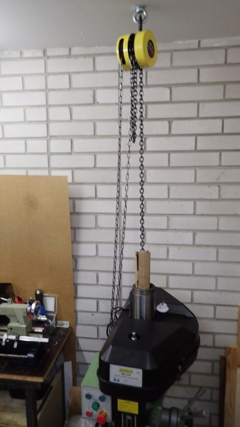

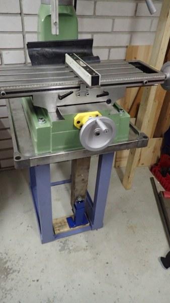

I am getting older and learned that machine base is pretty importat. When I got my first lathe I just lifted it onto table and used it. Not ideal.
Now, I need to plan a little ahead or I would just goblle together something when it arrives and then probably leave it there to annoy me for next 10 years.

Don't forget 'Toe Space'. When you are standing in front of a machine for any length of  time it gets mighty uncomfortable unless your toes can go under, otherwise you are too far back and end up with back ache from leaning over.
. . . . or maybe it's just me with my size 13 feet  :scratch:
« Reply #14 on: August 04, 2018, 06:34:22 AM »
No, it's not only you!
I am 178 cm tall (5'10") and I have noticed the same...however this mill has hand crank sticking out and on milling machines you are hardly never at straight front of the machine, that is consideration - least for front side of the table.

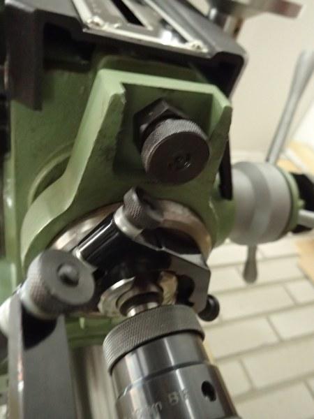

Thank you Bill. Those were good links. You have done excelent work.
 I have seen the wishbone stabilizer long time ago and I like the idea. However it does not look very straightforward get it "perfect". You state "better than +/- 10thou" for radial accuracy , which translates +/-0,254 mm, sounds reasonable for drilling.
https://www.cnczone.com/forums/uncategorised-metalworking-machines/70099-wishbone-stabiliser-round-post-drill-mill-4.html
I really don't know yet if this loss of register is real problem to me or not.

[quote author=PekkaNF link=topic=12667.msg151382#msg151382 date=1533420635
[/quote]
If I were to remake it, I would place the upper and lower pivots in front of or behind the post , so that they could be linked by a straight rod . That way ,as long as the arms are all the same length it track accurately. The one i built was too adjustable.
In use , the verticle alignment was always good enough for drilling . the machines are not really rigid enough for accurate milling without a great deal of care.
if you use er collets , the spindle brake is indispensable.

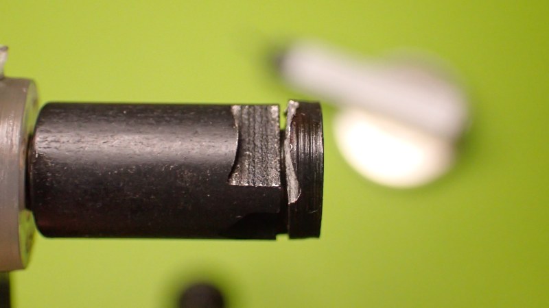

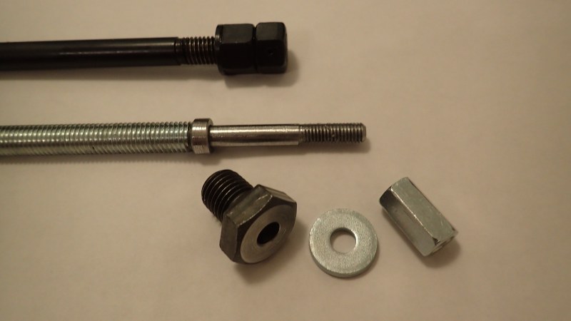

I have ER collets and arbors, I use dedicated spanner to hold the arbor and ER-key to use them. I use many of them on lathe tail stock too, both have MT3 taper.
I have a lot MT3 taper tooling, most of it M12 thread, few 3/8" Whit and many tang end drills.

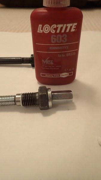

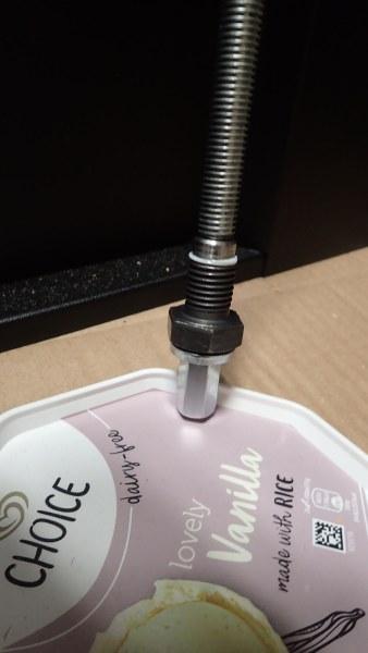

This brings me to drawbar tooling ejection. My current machine has plain taper bearings and giving a whak to it fine, but this mill has rolling bearings and I really dislike idea of brinneling the bearings. I have seen some differential thread or retainers to make it possible to use drawbar to release the taper from spindle. Looks like there is enough meat at the end of spindle for thread (differential thread or bushing to retain the drawbar).
The threaded retainer bushing would be very straightforward if I only would use tooling without tangs, but drills tend to have tangs.
Have to see first which tooling is essential, count them, check drabar thread and "gage length" and then I can make educated guess.
  • Posts: 1222
« Reply #20 on: August 05, 2018, 08:01:31 AM »
Yeah, ejecting a morse taper is a PITA. (even the R8 is annoying). Not doing it up too tight helps.
I had a quick look at an ejector mechanism; the biggest pain is having to thread or otherwise fix the part to the spindle. Only the inside bore is accessible  (because its spline drops down into the drive spline at full extension) and there isn't much room between the hole and the draw-bar .  Couple that with the need to swap drawbar threads and it makes it a tricky mod.

« Reply #21 on: August 05, 2018, 08:51:06 AM »
Something like this:
https://madmodder.net/index.php/topic,6371.msg67905.html#msg67905
I've been trying to find the time to reorganise my workshop and I have two better mills, so my drill-mill's days are numbered :-)

Mine was bored 7/16" so I taped 1/2" X 32 tpi and made a draw bar 10mm corse , hold the draw bar stationary and screw the toolholder or collet in then tighten the draw bar , tang tooling is removed by the slot in the spindle with a wedge and lifting the spindle if not to tight .

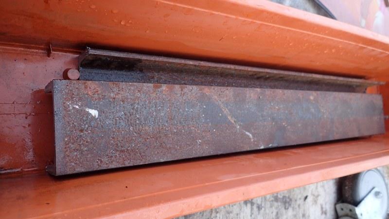

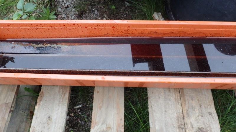

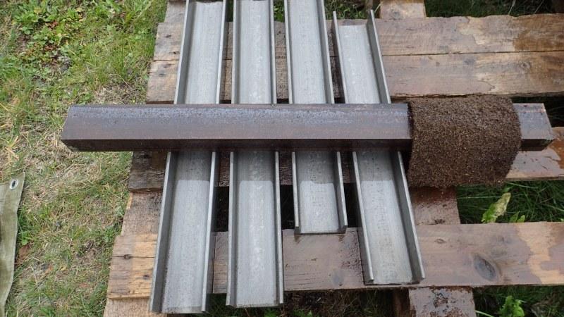

Last night I cut some C-channel (80x45 mm and 65x40 mm). Four 740 mm pieces for legs (because that is the maximum size that fits into my flower pot that is filled with vinegar to remove rust and slag). And four 500/600 pieces for table apron and stretchers.
Flower pots are perfect size, almost 750 mm internal lengt, but still about 10 liter volume. Drawbacks are missing lid (opening means streching new clingafilm) and material should be thicker all over.
Not cruicial on this one, but sometimes it would be really nice how to weld together pipe/plate/channel to to produce strogest joint. I know some priciples, but there is more. Wonder if there is a siple guide to layman?

Draw bar.
First I was thinkking if differential screw. It needs certain ration and at the taper end is tandard, that leaves tail end to play with. Hole trough the spindle is pretty good for M16x2 thread and was easy to tap. Therefore I made alternative design.
Drilled 8,5 mm hole trough  M16 20 mm long screw.
M8 thread at tail end of draw bar and long nut to fit.
Greased the rotaing parts and used bearing retainer glue to glue M8 long nut into draw bar. Left it upright for glue to harden and prevent it running to wrong places.

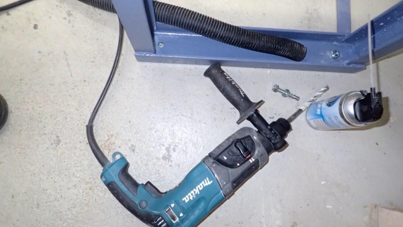

I have been bussy lately, but put hour now and then to this.
Decided to  make it minimum size (base size for the drill mill and a little extra to put the mount holes iddle of the C_channels results in outer size of base is 400x600 mm. Height 750 mm.
Welding and paintin was easy. Came out pretty heavy.
Used best part of the day putting the lifting eye on the roof joist. Build it from two 2x4" upright atop of roof joists. Spend some time questimating would that bee good enough. It was. Used M16 8.8 all thread and lifting eye, big washer upper end trough hole on one 2x4" laying flat.
I bought cheap chanin block and I am not sure if the markings are right on the box. Promise is for one metric ton, but maybe for them metric and imperial ton is the same. It was a little sticky with 1/3 of metric ton.
Got it lifted, put in the tray and proceeded to shim (my day off).

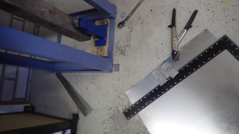

« Reply #33 on: October 14, 2018, 05:54:13 AM »
uhuh
Shimming it straight was not easy (nor completely over) :Doh:
I think that not only the floor is skewed but the welded fame has a set and something flexes on 0,1 mm /m scale when bolts are tightened.
The big idea was to nip the frame reasonably straight and true on mill base (it is ribbed cast iron frame with some rigidy) and then shim it level and relaxed on the floor. That did not give consistent results.
Plan "B" now it is reasonably level, but not completely straight. I bolted it down, let it settle and if it has big issues I shim again the base. If it stays on level, I will shim the mill straight betwen mill plinth and table frame.
Next time I'll design adjustment on the floor pads.
After I bolted the frame on the ground i cut the bilical cord - took away the hoisting equipment. Now it has to stand on it's own.

« Reply #34 on: October 14, 2018, 07:36:16 PM »
Looks good but I’d be worried a little the machine base is bigger than the stand and once the table is moved to the end of travel supporting any weight the leverage just might tip it! I see it’s bolted down I’m just saying!
« Reply #35 on: October 15, 2018, 03:05:39 AM »
Pretty convinced that M10 achor bolts will keep it tied properly on floor.
I was first considering buidling a frame over a toolbox. I could not find a tool cart of proper size (I actually bought one). But with wheels and/or table support frame it would have brought the many mill controls too high and I would have left behind it 100% empty space - they are not that deep and this mill is about one metre deep. The tool cart will be repurposed to it's original function as a tool cart to store some measurement tools and such
Then I checked smallet tool chests and boxes and I felt that I would be designing in a unnecessary complication with a very little gain. All resulted in wasted space and reduced flexibility. Therefore I decided to build funcional frame and later fit in few selves or drawers and maybe mount something on the frame.
This is build way too thick materials (6-8 mm wall thickness) but that is what I had in hand. And It won't break. I was considering a 3 mm sheet metal shell and putting three drawers in. Would have looked more professional, but harder to build anything in after mounting the milling machine.

Two basic ways to mount centring indicator
A) Stub that mounts into chuck: Dowside = you need to take off the drill or tool and replace it with indicator.
https://5.imimg.com/data5/VW/RN/MY-3954405/dial-test-indicator-centering-holder-500x500.jpgMill/drill stand for Warco Major mill
http://www.jlmtools.com.au/image/cache/data/Products/Noga/nf1015-noga-test-indicator-holder-8mm-diameter-stem-381-600x600.JPGMill/drill stand for Warco Major mill
Coaxial is nicer, but takes more daylight.
B) Threepoint moount that mounts to spindle ot chuck.
https://www.arceurotrade.co.uk/imagecache/8970a27c-daa4-40c9-adf4-a77700aa9eea_600x700.jpgMill/drill stand for Warco Major mill
Might be nicer to centre multiple holes and use one centre drill.
« Reply #38 on: November 21, 2018, 04:42:21 PM »
Next thing next:
CENTERING! :lol:
B) Three-point mount that mounts to spindle ot chuck.
Got today ne about 11£ job.
Glad I bought it. It is sort of 3D model for what I need.
Construction is pretty sloppy and it has pretty inconsistent adjustment. It has a lot of nylon washers and some aluminium spacers, but adjustment tries to open/close thumb nuts and that affects adjustment "feel" also the arms are pretty thin and every part flexes.
The three point fixture mounts nice on spindle nose (but has no space to turn there) and mounts pretty nice to drill chuck.
Some pictures...
