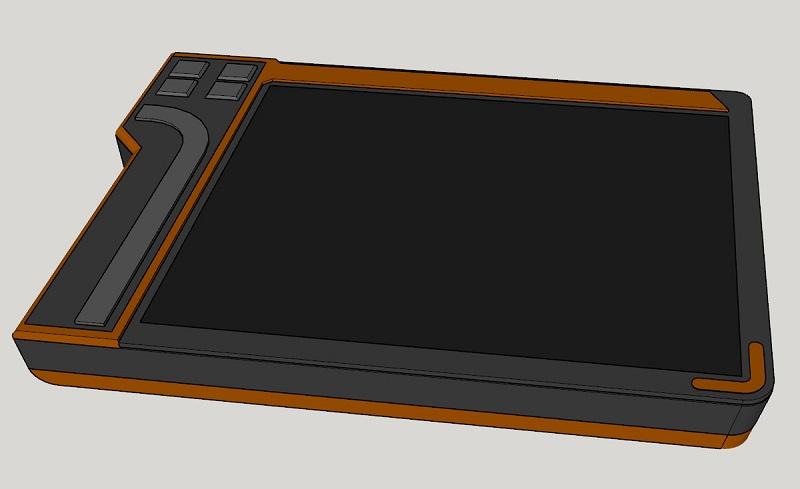

Here's a concept. Dimensions are about 400x270x40mm so it's quite a big thing.
The general idea though is to have an aluminium or maybe steel plate for the top, an aluminium or steel band bent around into a kinda squareish shape for the sides, wooden bottom, then some kinda grip thing on the left with buttons. The idea is that there'll be some buttons arranged in a fan to match the arc of your thumb when holding the left. It'd probably end up so heavy and off to the side that picking it up one handed wouldn't be feasible, but resting it on your lap or on a table you'd likely still be holding it with a hand to steady it.
I got carried away a bit though and those tapered edges would be hard to build. Tapered sides are a classic feature of chunky electronics, they've been doing that for years to give the illusion it's thinner than it really is, and I think it's a vital part of making this look 'semi-professional'. But I could try out a stepped side, which is visible in some of those early tablets in the OP and looks more interesting

It's starting to look a little Star Trek. I think its the button arrangement.
Still considering if this is the ideal way to go about it. I figure it'd be best if the plate glass is supported all around on a ledge that it's glued into, and the easiest way for me to make that would be with two layers of... perhaps aluminium. Prices might put me off when I check! Then the screen itself is just screwed on behind, saving it from taking any of the pen pressure.
Question is - how do I stick the two plates together. Welding would distort. It'd be too thin to hide screws. Loctite is expensive and I don't have a whole lot of faith in adhesives... maybe I could stick rivets in, ground flush, and paint the aluminium rather than anodize it. For starters I've never anodized before and that's a whole art from what i've seen, and paint/ filler could hide the seam.
Y'know I could probably make it at least 30mm narrower but I need that decorative strip! If I could rely on some kind of adhesive then I could replace the top plate entirely with the glass plate, but then i'd need to ditch that strip.

I think i've got it. If I move the black dots a few mm towards the screen then they line up with the band that goes around the edge, and that'd give load of engagement for some long countersunk screws and sandwich all 3 parts together. Then I can loctite those in and fill the holes with bodyfiller.

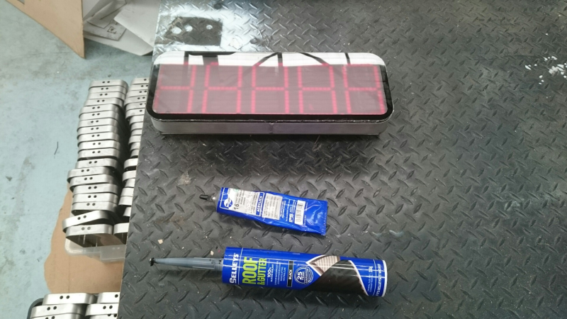

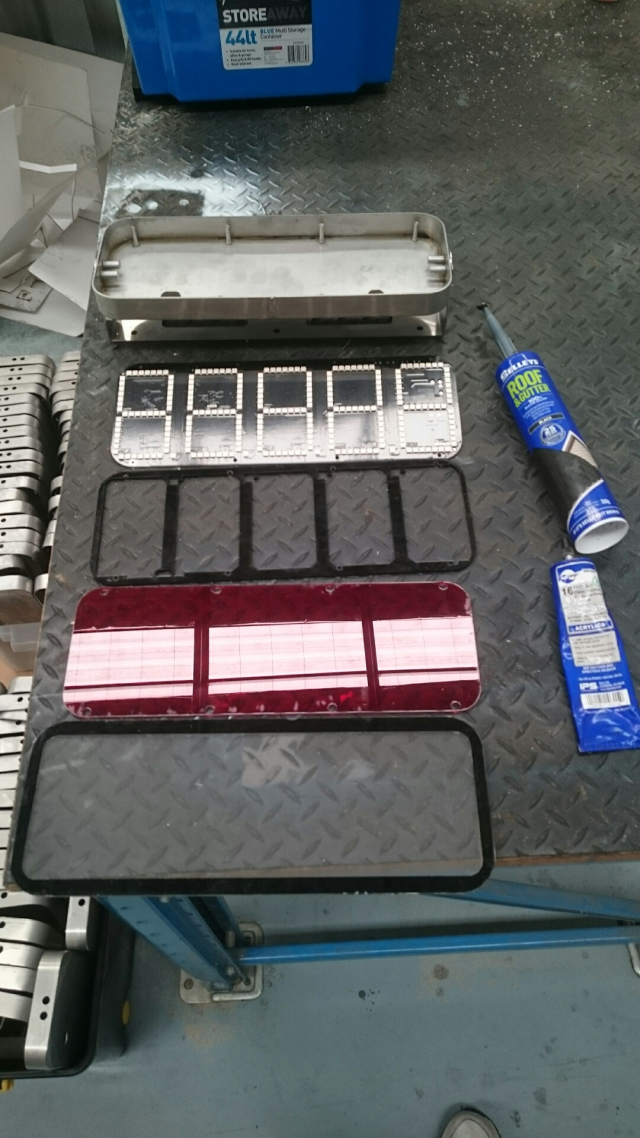

Offline PK
  • Posts: 369
Re: DIY tablet computer, maybe.
« Reply #15 on: July 14, 2018, 01:55:06 AM »
I may be able to assist.
We make this product:http://www.soledigital.com.au/hibeam.html
on top of the LED board are three layers of acrylic of varying colour, opacity and thickness
They are (for the most part) held together with Weldon #16 glue, the exception being the front screen with it's border mask. The mask is created by just lasering through the cover paper, peeling off the outside part, sand blasting and 4 coats of Krylon fusion paint.
Once this is cured, we glue it into the stainless case with some neutral cure silicone.
