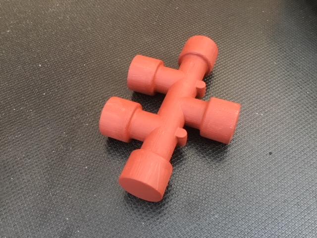

I'm thinking of building a minnie traction engine on a budget, like NormanV's thread. The price of castings is pretty high so I thought I might investigate 3d printing the parts then have a go at casting them. I have quite a lot of scrap aluminium, brass and copper which could be used. Possibly bronze using very old non magnetic 1 and 2p pieces (pre 1993 ?)
Most of the parts just really need an impression in the plaster(?) rather than the full double sided casting process. I figured I would subject the plaster to vacuum to get rid of the bubbles then remove the pla using some form of mould release.
For the rear wheels I thought I would try an alloy of aluminium with 5% copper as Wikipedia indicates its not a bad idea.
Any thoughts or advice on this much appreciated as I have yet to cast anything in metal.

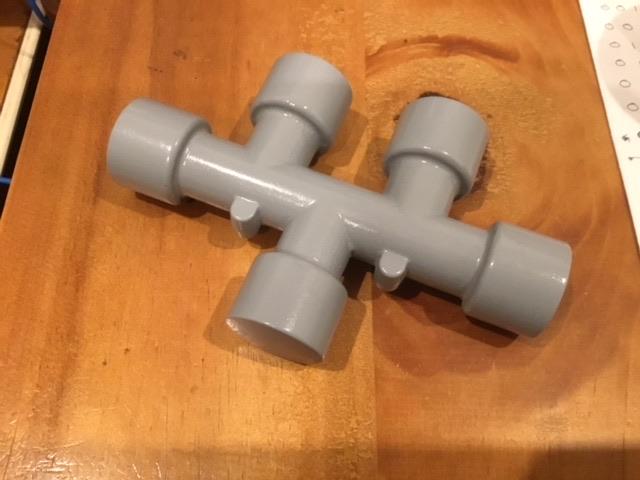

Wet sand the PLA parts, use sanding sealer on them and wet sand again.  For release agent you can use Vaseline.

I suggest trying a small simple part first with your chosen method, cast in straight aluminum, without 5% copper.
You can melt that in even an open wood fire pit, after it produces glowing coals at the bottom. Put your crucible in there with the coals, and no need for draught.
It will melt, it will only take a few minutes longer than a furnace lined with $200 worth of refractory, plus gas burner, plus draught blower, and all the techno-wonder gear, etc.
This experiment will tell you everything about what needs improving or revision in your chosen molding method, with little expense or waste. Gradually work those details out before investing in anything else, like a furnace.
Furnaces do nothing but heat metal. Molding process is everything -- and that has to be learned through experience.

Why? My 3d prints come out really smooth. Vaseline for release agent I can understand. I thought that I would make some impressions in plaster of paris then when its set off remove the pattern and fill the hole with Aluminium or whatever.

Prints can still be porous and you have the fine layer lines that can also trap the plaster, don’t assume prints to be water tight is my experience.

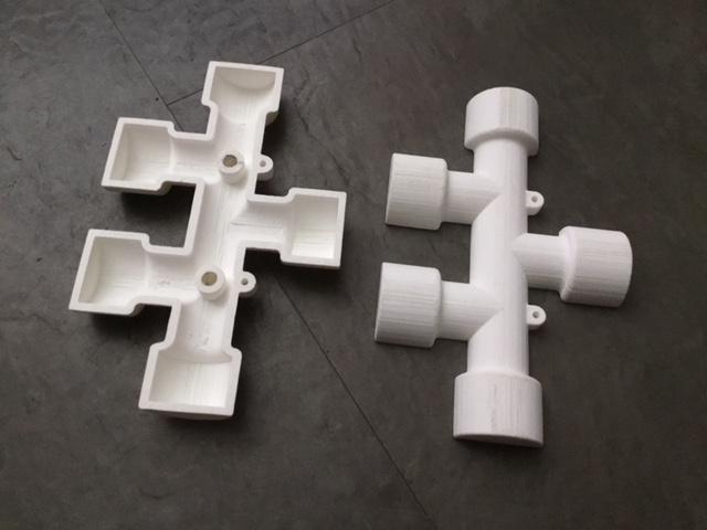

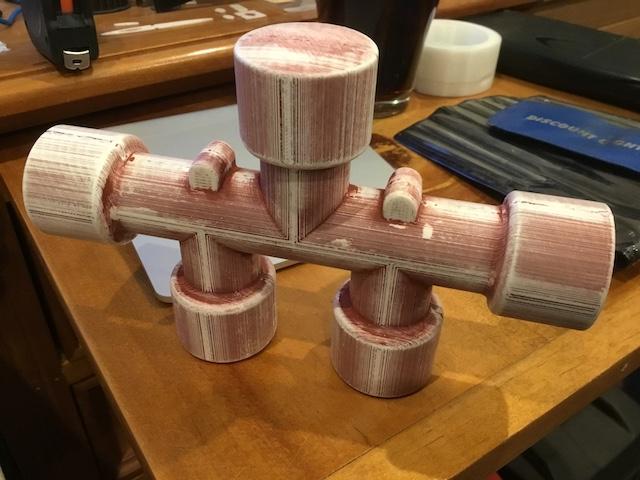

I am just finishing up some patterns for sand casting.  Generally a solid parts warps more than a shell print.  Not shell as in single layer, but in this case 3mm thick walls.  The two parts are printed flat then welded together, dowels locate the two halves.  The edges get filled and smoothed off.  My example below has primer for the first rub down to see where the voids are as the print is quite course at 0.15mm layer.

For casting the wheels you could try two part moulds, If it was me I would exaggerate the band for the treads and machine them afterwards.  In fact you probably want to think quite bit about including extra material for machining and shrinkage.  The oxide painted pattern above has domed ends on the bosses, these are 5 degree taper at the edges, same with the lugs for mounting.  Yeah, don't forget draft and this will exacerbate the layer problem, hence my comment about wet sanding, filling and sanding again to get a smooth finish.
I still have a lot of sealing and sanding to do, this won't be ready for Friday  :(

My bad, I should have said rims, not wheels and it would be three part mould to get the gap in the rims.  Steel treads on ally rims makes far more sence.

  • Posts: 1320
Re: lost pla/pattern castings ?
« Reply #34 on: July 28, 2018, 08:09:46 PM »
The finished pattern got delivered to company, not sure if they will be cast in iron or brass.
