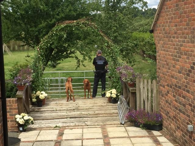

Steve, we have a wooden decked bridge crossing a small stream by our back door. It's ten foot wide and spans maybe twenty feet. Formed on a pair of heavy RSJ's that I had curved slightly (12 inch rise in the middle) for added strength and aesthetics. It's rated for four tons.
The deck is made from oak railway 'crossing sleepers' as ordinary sleepers (ties, USA speak?) weren't long enough. At certain times of the year you cannot walk over it without holding the hand rail, as even that slight arch has you skidding a over t .
It's probably a reflection on our different climates. External woodwork can suffer very badly from mosses and microscopic slimes.
Here is a picture of it being decked out for my youngest daughters wedding, interrupted by the Emu incident !

Seen that in UK!. Beautiful pier or bridge covered with ugly metal net, after one person plunges into pond.
Re: Building a Bridge
« Reply #54 on: August 17, 2018, 07:29:59 AM »
Mosses and slimes would mean little or no vehicular traffic -- Yours seems to be a footbridge, I see flower vases on yours. and a 1 in 10 incline (1 foot at center, 20; long) is not a minor slope. No dirt road lead-ins to add grit.
As I said there are many wooden surfaced town road bridges here in regular use. And our wooden covered bridges are famous. We have a large network of dirt roads here. I think problems may arise when people pave up to older wooden bridges. It may also be that the wood chosen has something to do with it. Softwoods absorb grit and fray differently than hardwoods.
