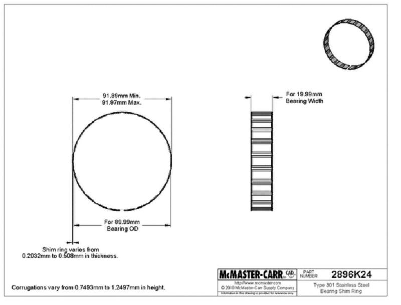

That looks to be a major discrepancy in the bearing size. It's rather important that the quill bearings are very rigidly supported.
There are commercially available press fit sleeves to fix this situation but my google foo is letting me down finding a link. They are basically a tightly corrugated sleeve that distorts evenly as the undersized bearing is pressed into it
Yeh, that's been playing on my mind too. I didn't know about the sleeves so thanks for bringing them to my attention, I shall look into them forth with :)

Also called 'tolerance sleeves' - sad how these things come back to you in dribs and drabs  :clap:

I'll have to come up with a plan b for bearing shims as McMaster don't do them in the size I need. Largest imperial they have is 1.1/8" and my bearings are 2.24" OD.
  • Posts: 6870
Re: Dore Westbury Mk1 Mill Restoration, finishing and one or two mods.
« Reply #12 on: June 30, 2018, 07:05:01 PM »
Canobi, what is the difference in diameters that you have?
Seems to me if they are the right thickness, and uniform in thickness, that multiple shims are no less secure than a corrugated whatzit.
The main thing is that the bearing is central to the quill and aligned with its couterpart, that its face hits a proper register, that the outer ring won't spin, that it is supported enough not to distort from pressure of the rollers.
I don't see anything wrong with your multiple shim idea, except that I would suggest more of them so the gaps between them are minimal -- so the rollers won't distort the outer ring.
The face register should align the bearing (if proper itself), the shims if sized right and uniform thickness should prevent spinning and should keep the bearing centrally located.

The OD of old bearings is 2.25", new ones are 2.24".

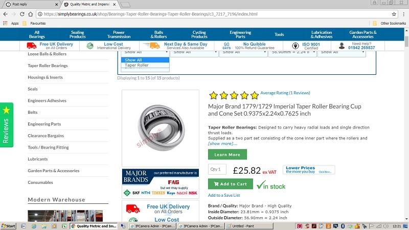

If they are sold as 2.25" bearings and are in fact 10 thou under size they are faulty and should be replaced by your supplier
I'd assumed that it was the housing that was the problem. Bearing outer diameters should be within tenths of a thou of nominal

Looking at the list of bearing sizes on the Simply Bearings site, 2.24 IS one standard as is 2.25 so I reckon you've been supplied with the wrong size

The fault lies with me, they were indeed touted as 2.24" (from simply bearings in fact) and being a noob I just assumed they would be the same as the old ones.
Took a fair bit of searching last night and this morning but I finally found and acquired a pair of tolerance rings that were the correct size for my bearings, so I'll be carefully extracting the new races from the quill later.

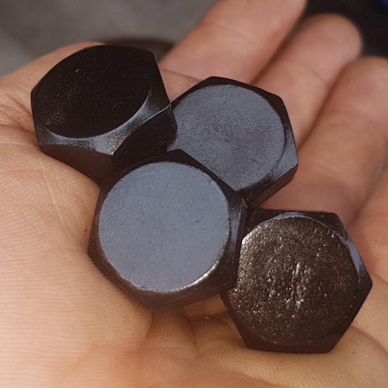

I heat blacked the column support casting bolts today and my rig turned out to be very useful.
Wasn't too happy with the results of the first try though, was more dirty brown than solid black. I changed it for a fresh silver one and this time I brushed off a dirty white looking oxide layer that develops as it gets hot.
I also sunk more heat into it, this time I waited till the bolt head went from turning a dark straw to just touching the blue zone temps, then hit it with the oil cloth and then the torch to scorch dry the oil in an alternating pattern.
The black built up relatively quickly after that and I found the first sign of a good take is that as the oil dries, it develops a matt finish and dries really quick, then after a short while, dries to a nice gloss finish.
At this point the blacking is essentially done, but for a deep black and slightly more enduring coat, I added a further 15 wipe overs and then dropped it in the water to cool off.
They turned out exactly as I'd hoped, which is a fair achivement on a first try:
0
Here's how they will look once the column is fully assembled:
Next step is to brass and black the levers, gotta feed the myself and the sprogs now, of there's time after dinner, I'll be back with more this evening  :thumbup:

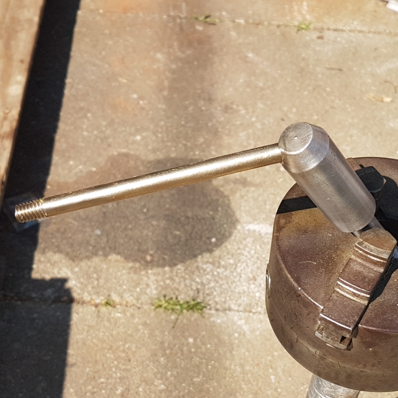

Thank you for the info regarding heating iron castings vtsteam, I didn't realise I'd dodged a bullet there. I don't think I'll be doing that to cast iron again, well maybe not until the cold season at least, where I have a ready supply of hot coal ash to bury the hot parts in.
Steel on the other hand is fair game any time and I got round to brassing the arms on a couple of the levers:
I then experimented with a followup heat black session but it was a total fail, so fine sanded the terrible coating off and opted to paint the bolt half instead, which I did along with the aluminium motor mount brackets:
The fail was due to a combination of things. Firstly, there's no way to mask off areas you want to leave untouched , unlike when painting a part. The second was an unknown factor, the steel just didn't want to take the black. I had to use a scotch bright to buff off a light amount of flash rusting before I started heating and coating it so my initial thought was that it was mild steel but could it be a form of stainless perhaps?
