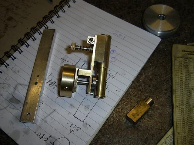

When drilling the steam ports from personnel experience and lacking the ability to mark out and drill the holes where I want them I use a simple jig that canbe seen to the left in the pic.This engine is to power a gauge1 loco single acting
when the piston cover the port a tdc or bdc it shouldnt be a problem if it is then drill the passage ways as per the Duval I gave the link for on another channel .
