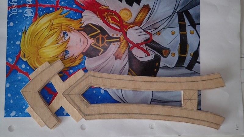

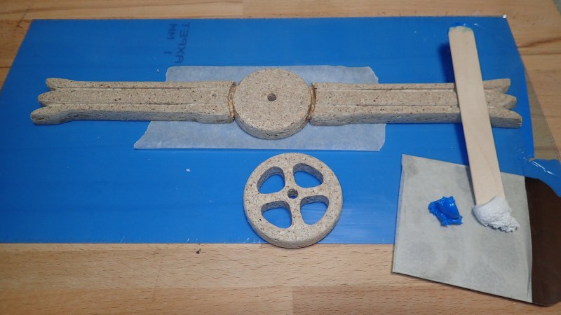

My daughter needs a anime prop: about 1200 mm long sword that has opaque blade. Tried to mould that from PC, but it turned out pretty damn difficult.
Pretty much like on this picture:
https://www.pinterest.nz/pin/598556606695462033
Plan "B" is to use two layers 160 g/m2 glass fibre cloth and clear laminating epoxy to make two halves and then glue them together.
I'm making a practice run with another sword, that essentially is a katana blade. Plug is made from two halves, split, glued on the MDF board, finished and coated with two componenet acryllic paint. Covered it with six coats of release wax yesterday.
I was planning to make the mould with polyester resin (first gel coat brushed and then resin and glass mat), but I read that it the mould would take up two weeks to harden. Is that true?
https://www.ecfibreglasssupplies.co.uk/images/mouldmaking.pdf
"Leave the mould to cure up to two weeks at room temperature is desirable, post curing the mould is desirable but not sometimes practical, less if using low shrinkage tooling resin ( 2 – 3 days), releasing a mould too early can cause distortion to the mould."
Sounds pretty long....My mould would be about 1200 mm long (blade differently and handle separately) protrusions are small (specially with katana, it's only 3 mm for half thickness and planning to use only one thin mat and then two 400 g/m2 mats.
Tempted to use the better laminating epoxy to save least week, but I don't have compatible gel coat for that.
I keep on reading about tooling gel coat and that sort of stuf. They don't have them on the local shop and those materials are hazmat, when it comes shipping them. Aargh.

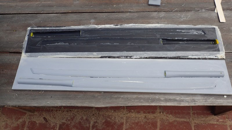

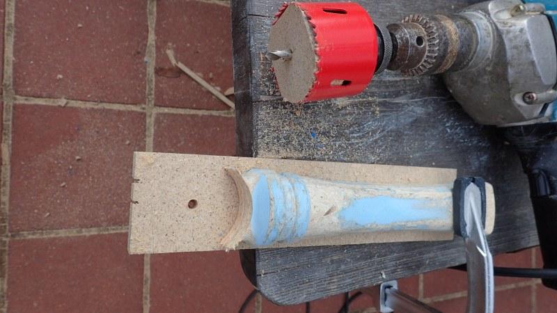

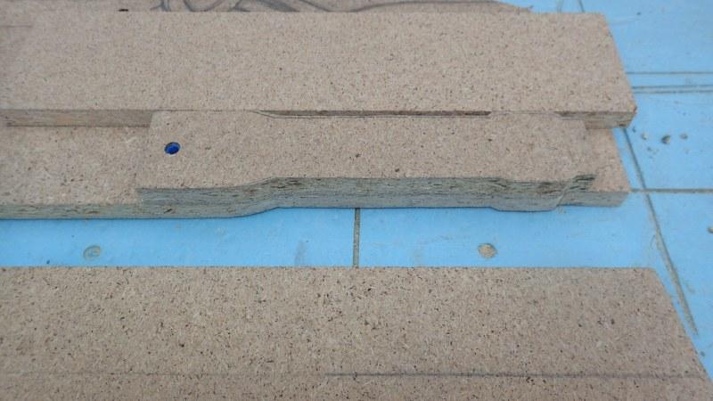

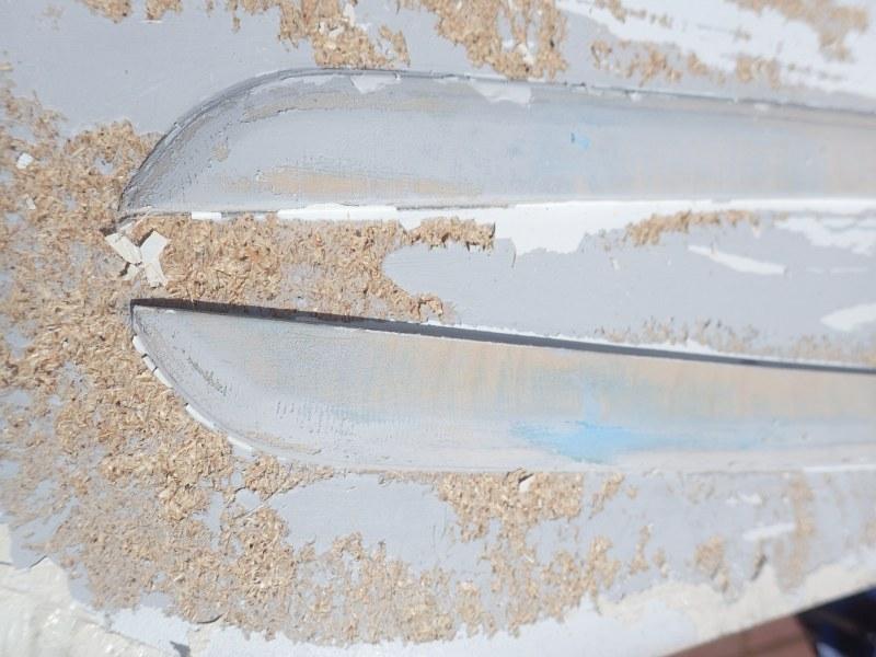

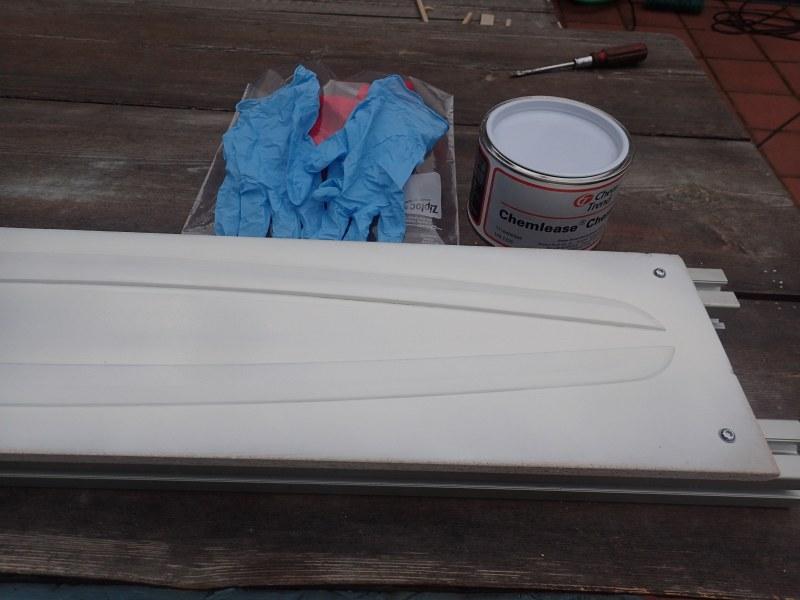

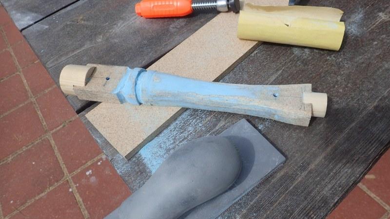

Two more coats of wax. This is Katana type sword that will be for her friend. This is the practice piece and I'm considering mouldin process for this one.

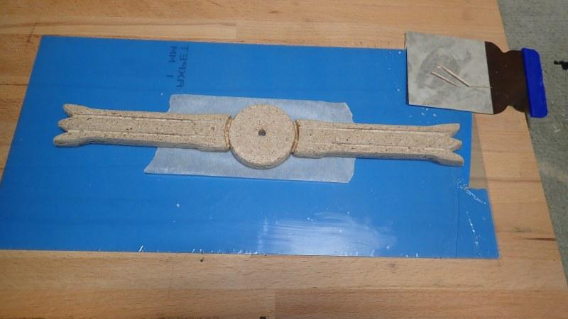

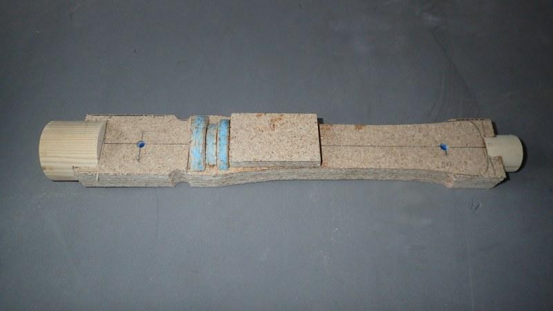

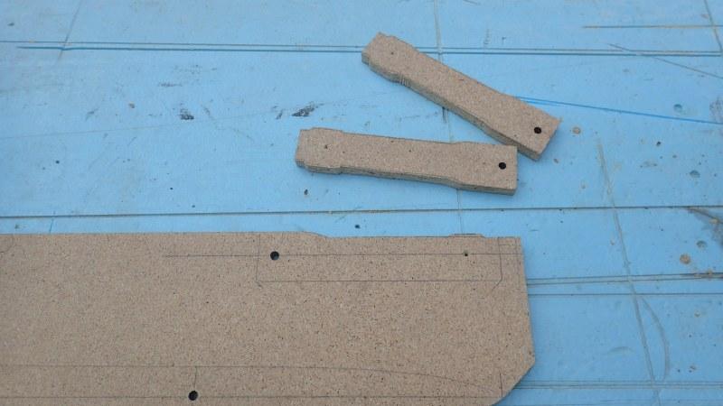

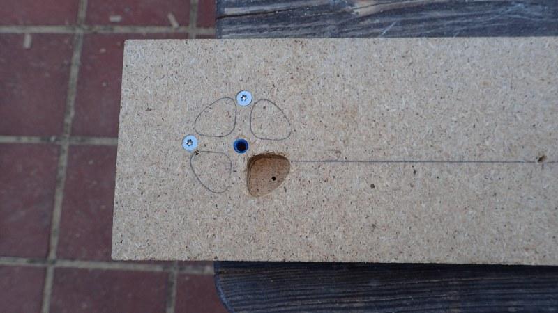

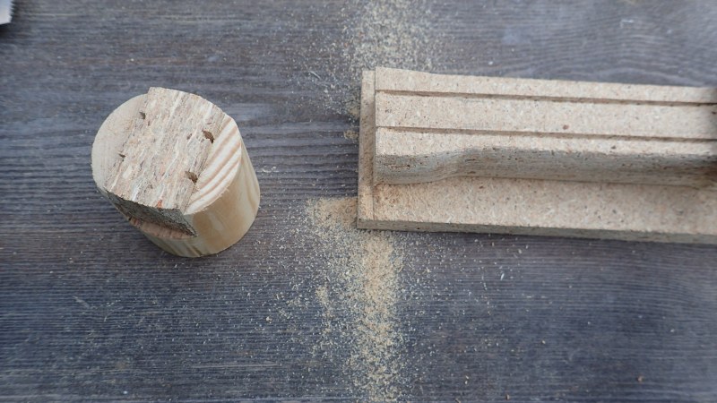

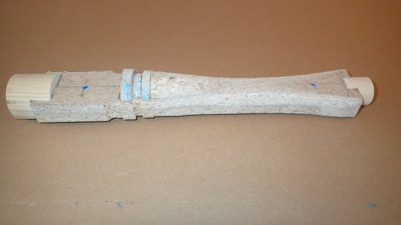

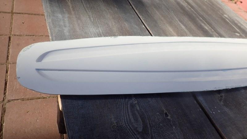

And the somewhat transparent sword has few more tricky parts and I finally made my mind how to make it. Took three prototypes :Doh:
So the blade is symmetrical, plan is to make only one mould for blade and use it for both sides. Because that will require pretty good symmetry I made a single sided jig to use router and bearing/copy bit to make both sides of the plug symmetrical.
Now the blade plug is ready for final coats and to mount on parting board.
Drat, the pictures are on the other laptop....I'll update them when I have it back.
Basically I'm trying to find faster way of making the mold than two weeks.

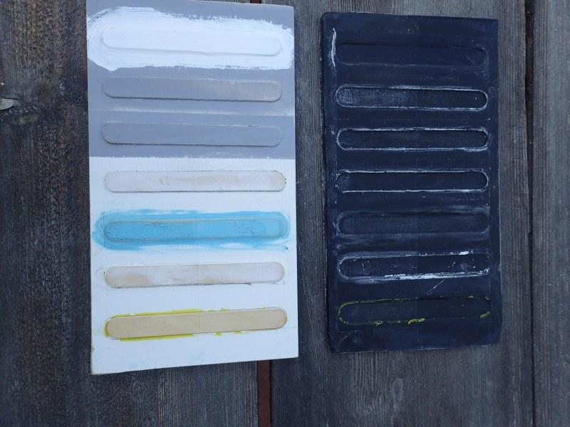

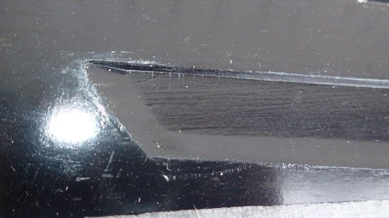

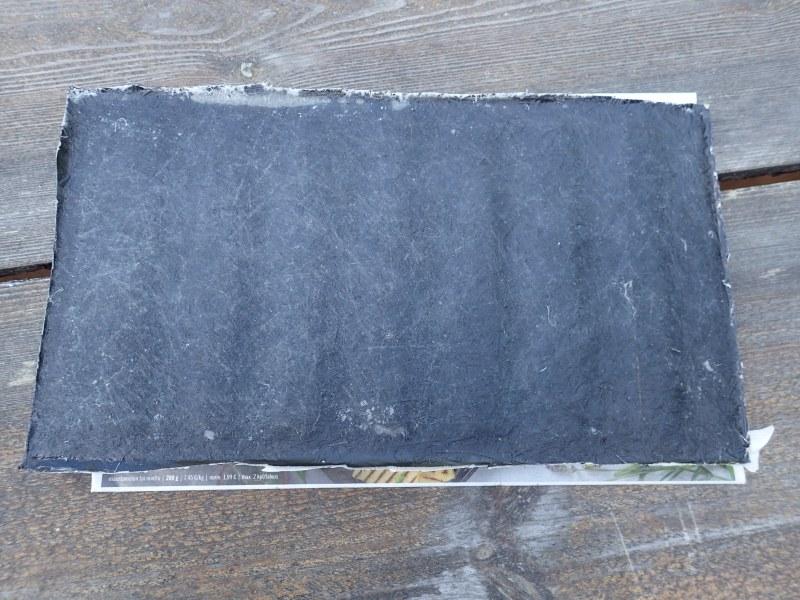

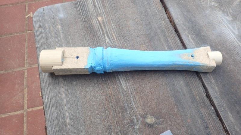

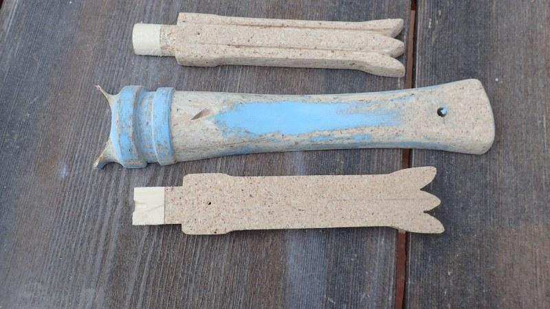

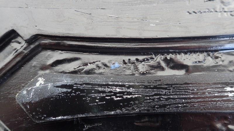

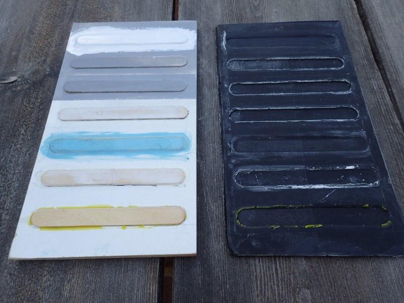

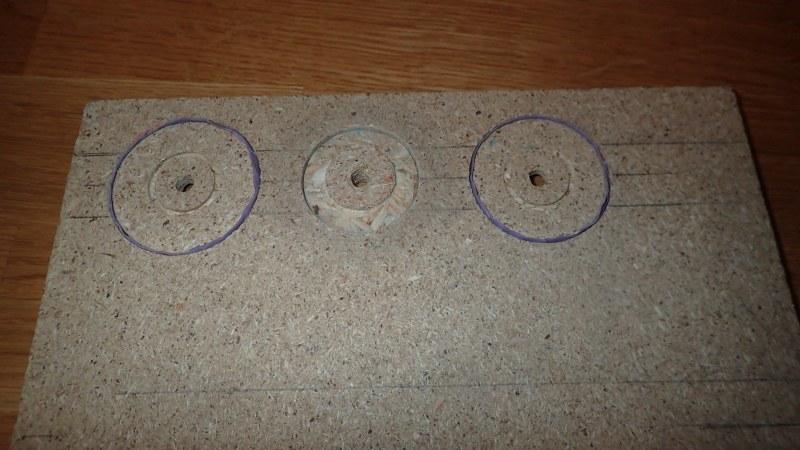

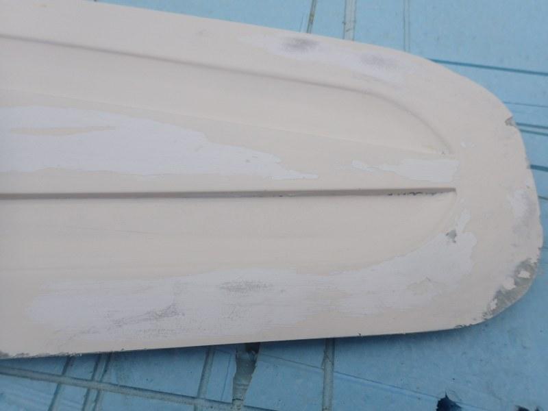

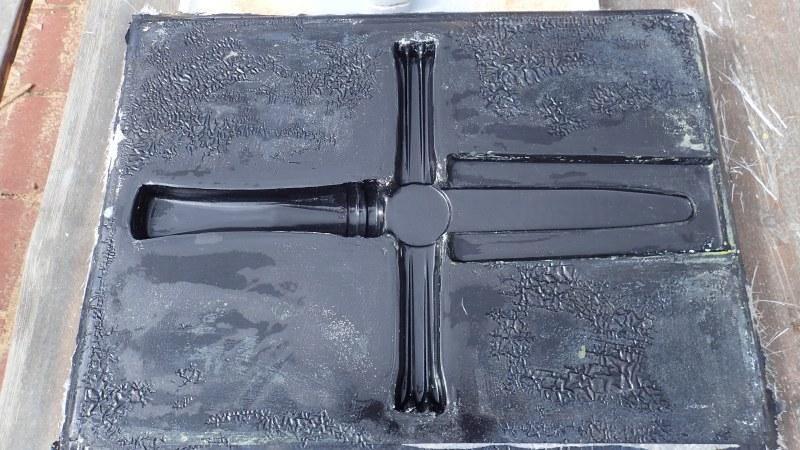

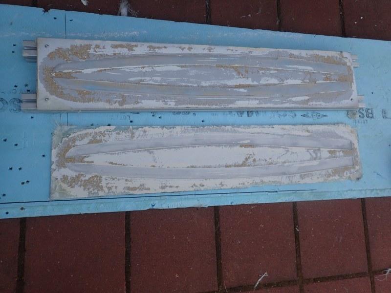

So....my big mistake: Went techno and tried new one can 2K paint to cover the plug.
All went initially well....mould popped open easy, but from filler. Not from separation wax layer....damnhik!
Called the wax manufacturer and they were rally helppfull, All should have been fine.
Then called paint manufacurer and explained the situation. We had a really nice chat. It perspired that in order to keep that paint from setting in the can they have mixed the acid hardener in water. Therefore the after spraying the water has to evaporate off the paint layer before it hardens and it might take 7 days and has to be open all that time....a chemist is going to call me on moday and explain it fully.
Re: Glass fibre mould from the slender plug
« Reply #13 on: June 15, 2018, 04:46:19 PM »

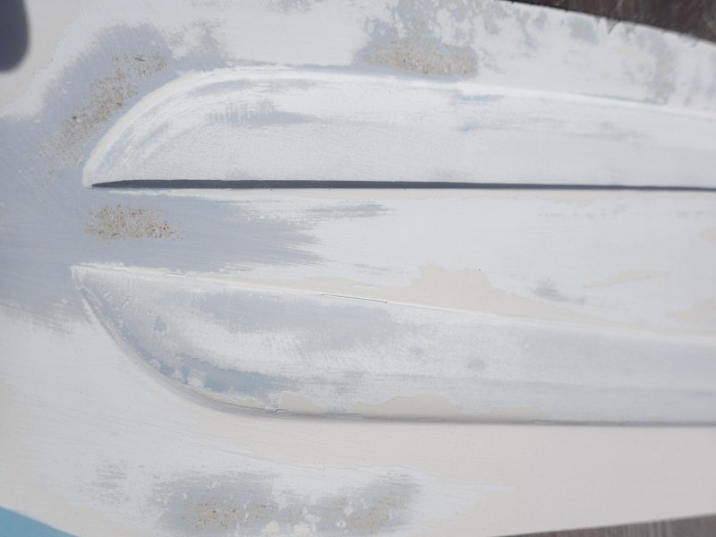

Anyway, because the chemical reaction did not finnish in three days, layers separated on competely wrong place and there was not end to my fustration.. I used some sanding paper to remove MDF, then acetone and wood spatula to remove the unhardened 2K paint and all started to look better.
After a little more polishing pad all started to look pretty good, found one hairline fracture and few little pores. Easy to fill with epoxy/microbaloons.
To be continued tomorow...
« Reply #14 on: June 16, 2018, 08:23:58 AM »

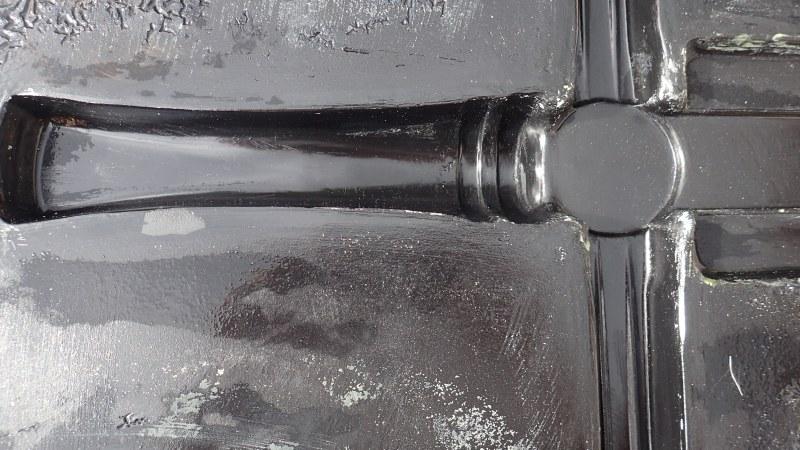

Sanded down to gelcoat and then polished the mould.

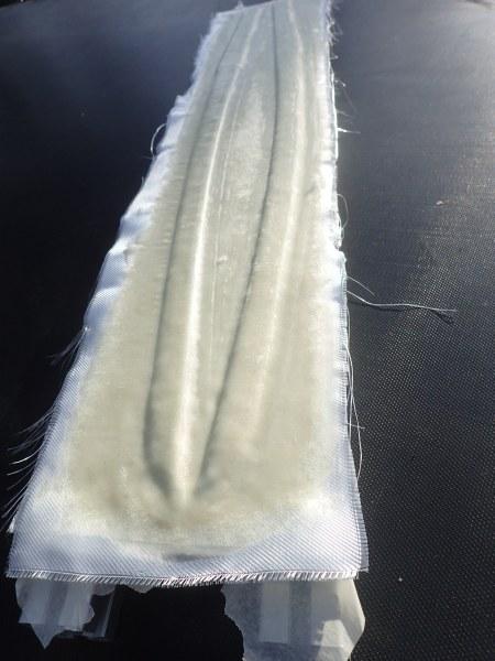

« Reply #15 on: June 16, 2018, 02:57:09 PM »

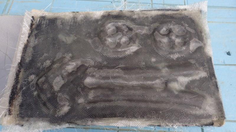

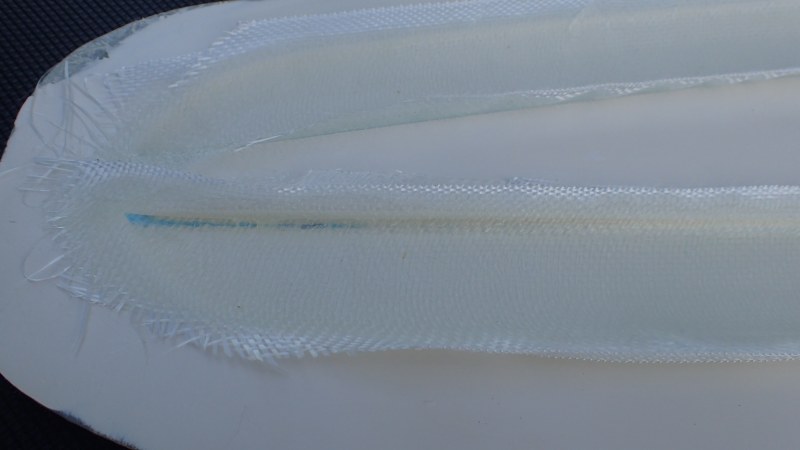

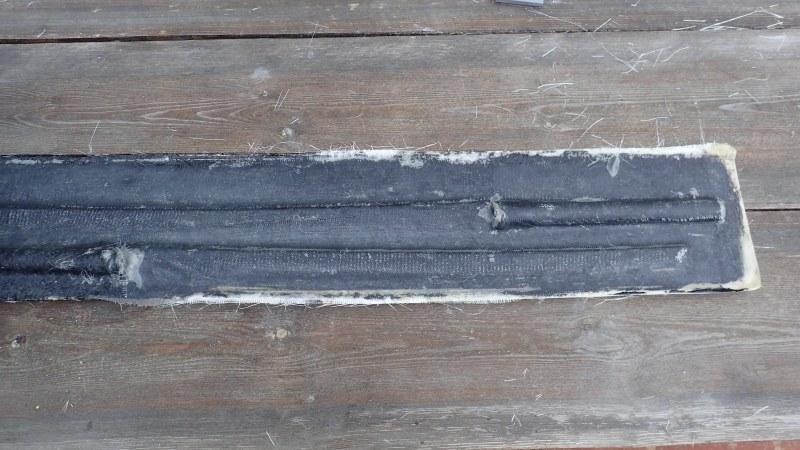

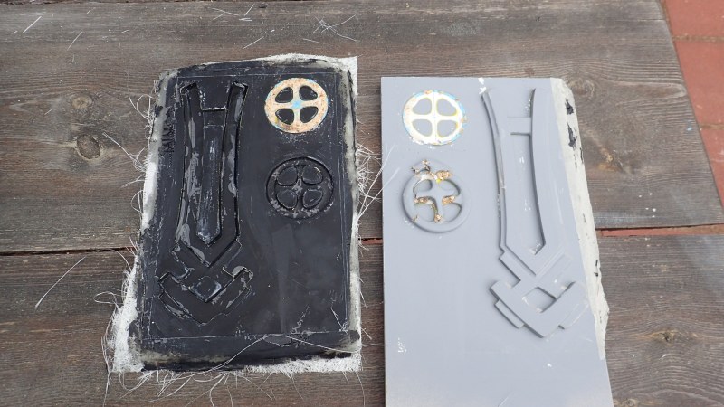

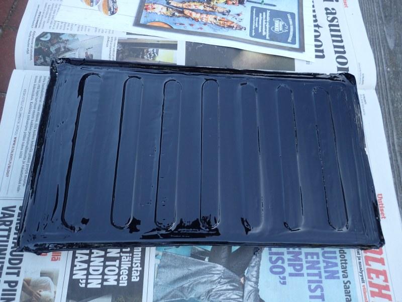

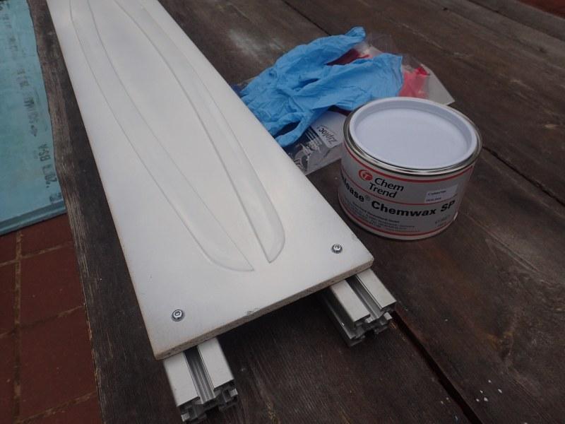

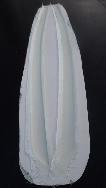

6 coats of release wax + layer of PVA release film
2 layers of 160  g/m2 twil and SP106 laminating epoxy. Hope it works, but it did not go around the corners that great. Hope it does not have exsessive amount of voids.
« Reply #16 on: June 18, 2018, 04:15:59 AM »
All went pretty ok, but:
1: I don't use gelcoat to keep the whole thing translucent, therefore back of blade side corner was not crisp. probably have to laminate veil and think of using a perforated separation film and pressurepad or slight pressure or vacuum on it.
2: Turns out that two layers of 160 g/m2 twill is thinner than I anticipated. Anyway, glued them together on the mould to see if can be done and keeps straight.
The release wax and PVA works, it even gives an early release....now went to other end of the extreme...look and learn I guess. Maybe just a dab of film on the nearly vertical feature of the mould (back of the blade).
Think that I'm going to put just a little mictoballoon or silica thickened resin at the very back of the blade section before veil, to keep it in shape, also very tempted to add some of that micture at the very blade edge to give more surface for gluing it. Might even need to make it two steps.
I got pictures, but they are boring and they donät actually show much....paper thin one meter katana type blade at this point.

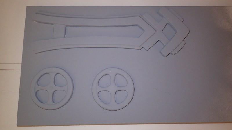

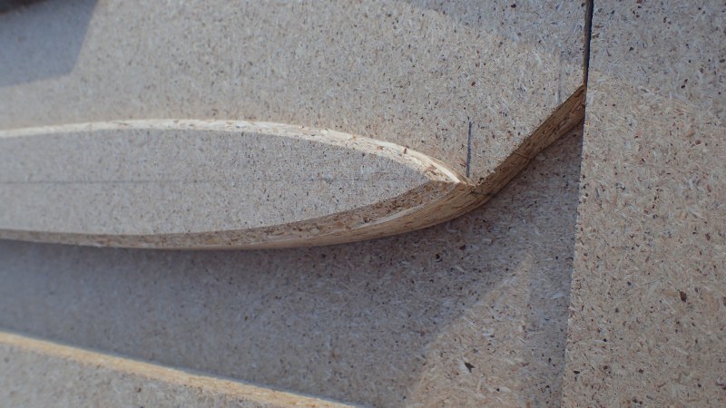

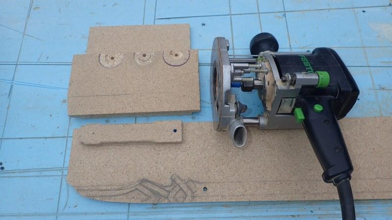

« Reply #17 on: June 23, 2018, 04:50:41 PM »

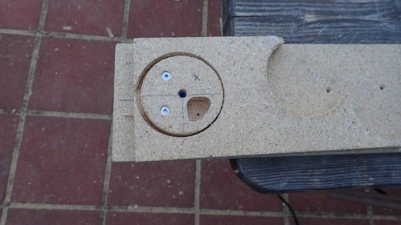

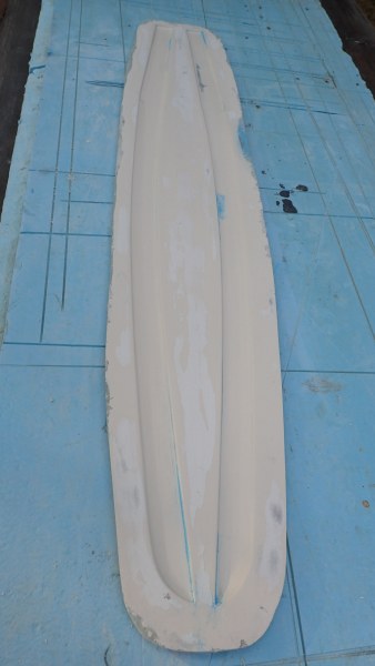

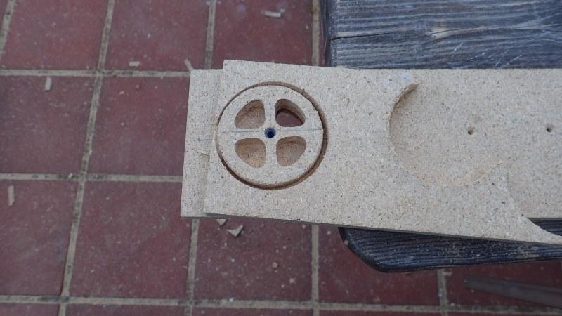

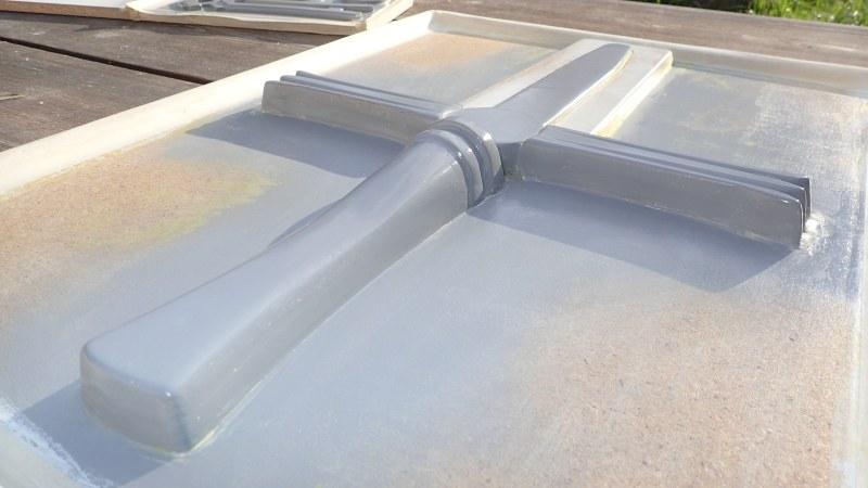

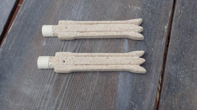

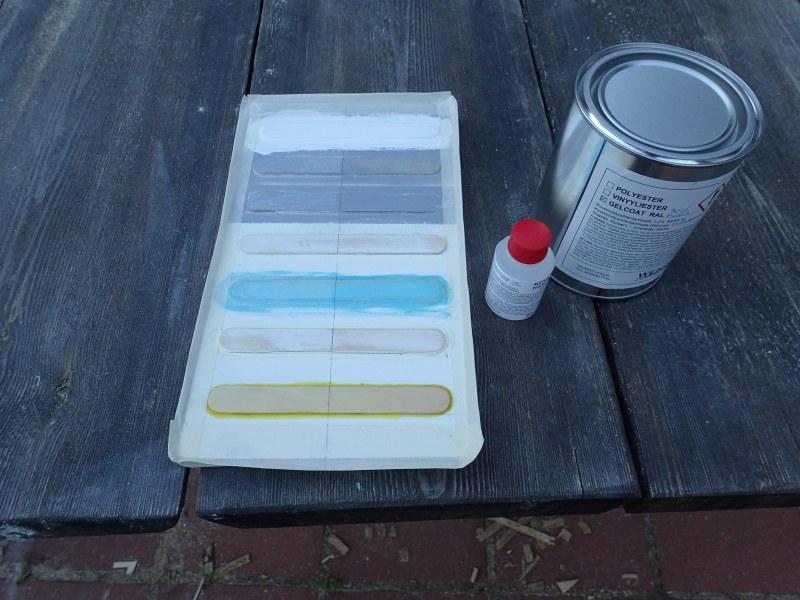

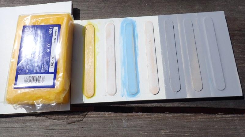

Started working on another sword mold. Can't get my head around it, but think I'm going to build it in two part and need two moulds: blade/handle and cross piece.
Now the interesting part is that I am not very familiar with polyester resin. Information I read is a little confliking.
One major thing is: Some information emphasis putting a veil over gelcoat, let it dry (to various harness, often completely dry and then continue with structural layer. Some videos people seem to build pretty much (or least seemingly) the whole mould laminate on one go.
Which way it is and why? I never build that thich laminate, taht it will heat up.
I get that adding stiffeners to wet laminate will shine trough, but those I could add day later.
Any advice on mould laminiation sequence?
  • Posts: 6929
« Reply #18 on: June 23, 2018, 07:58:42 PM »
Pekka, general purpose polyester resin (also sometimes called "finishing resin") generally has wax in it so that it will cure hard on the surface. Wax floats to the surface before cure, insulating it from air. Best for all-at-one-go type work, or as a final coat on a molded part IF you don't plan on attaching anything else to it, since a wax surface isn't good to adhere to. Polyester resin is a poor glue to any hard surface or material. Epoxy resin can be used to glue to polyester, if any surface wax is removed. But polyester itself will not work well with an already cured polyester surface, even after wax removal.
Laminating resin doesn't have wax in it, so that it can be added to by subsequent polyester layers or attachments in a mold. Even cured, it is still tacky on the exposed-to-air-surface, so subsequent layers of polyester WILL stick to and and cure it. Polyester without wax is an air-inhibited cure resin.
Gel coat also is air-inhibited cure, for the same reasons. subsequent layers need to adhere to it. However it does cure (harden) against the mold surface, since that side is not exposed to air.
Because laminating resin stays tacky on the surface, even when cured, you can add subsequent layers without having to rush it or build up too much thickness all at once. If too much thickness is built up all at once, all the resin will cure at the same time and get hot and cause other problems.
Is that any help?

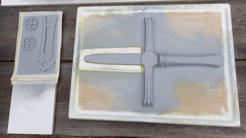

« Reply #22 on: June 26, 2018, 12:21:58 PM »
Interestingly some seemingly large shops don't know or recognize that little difference on wether their resin has wax ot not. Laminating resin seems to be elusive. But found a palce to order black ot red gelcoat for moulds.

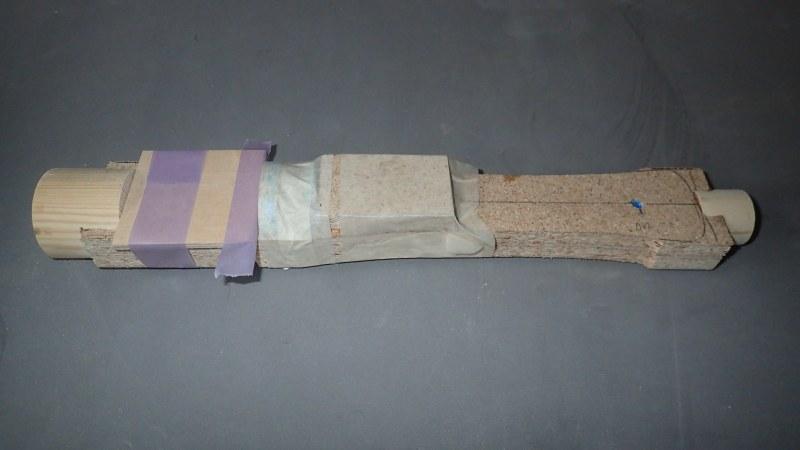

Ordered one small sheet of 2 mm acryllic sheet to have plan "B" for the almost transparent blade.

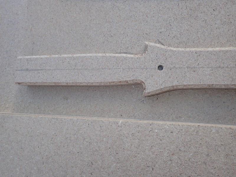

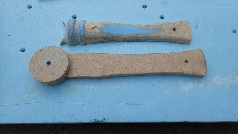

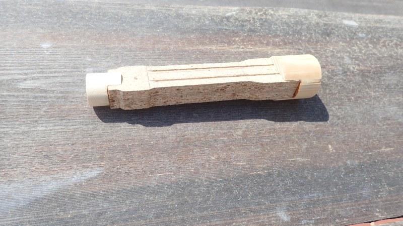

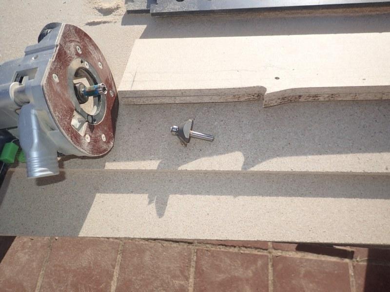

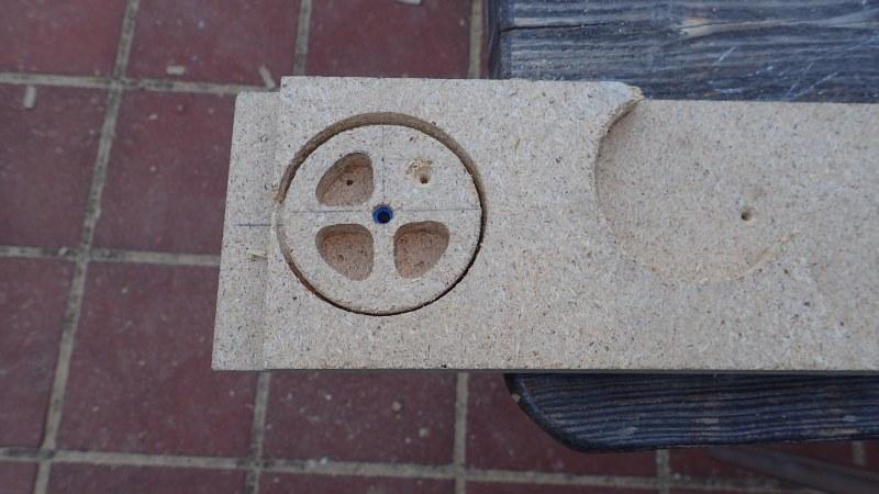

Today I have been making more plugs...need to find out what paint to used to make the MDF plugs smooth and non porous.

Pekka, re finishing MDF (or wood, as I do for patterns) try hand brushing lacquer with a few spoonfulls of baby talcum powder mixed into a pint (not the cornstarch type, but the real talc type). Uhh, I mean into a half liter. You have to keep it stirred if it sits too long.

I put some pictures to enertain. I am big fan of router, even drill holes with it.
« Reply #29 on: June 27, 2018, 05:07:47 PM »
Cross guard plug
« Reply #30 on: June 27, 2018, 05:14:11 PM »
Did I mention that I like router copy bits, specially bearing type. And closely followed by one that you can use to drill hole and then copy.

You do great work with a router, Pekka.  :bow: Routers and I just don't do well together.  :zap:
« Reply #32 on: June 28, 2018, 03:15:31 AM »
Thank you Steve. Means a lot coming from you. I always admired the patterns you make for sand casting and somehow they look always more demanding than my doodlings.
Routers and mixing .... I remember when I was learning to use router (pre internet -hard way), probably made all the mistakes on the book and pretty sure I invented some of my own. I learned not to route free hand - after the router run amok, me hanging on it. I learned not to hog - after the router caught a piece of wood and splinters flying every direction and learned to follw the grain and importance of the routing direction, when I got spintters more than moulding....but now I can make jig fast and use that to make joints or symmetrical parts fairly consistently.
Put on those parts some epoxy/filler putty and will sand them on the evening. Where I were with the filler? Have to have a call to local paint shop on the evening.

Testing
« Reply #38 on: July 07, 2018, 05:25:31 PM »
6 coats of release wax and half of it coated with PVA. Then I applied top coat (all black), but it would not gel in one hour and temperature was 23C. Odd...then I check the amount of hardener. Crap, i was suposed to use 1,8% but I used 1%. Excess of the gelcoat hardened on the can, but not on the sample piece. Double crap. Put it in the garage overnight and hope gelcoat is sticky on the morning.
Noob mistake.
  • Posts: 6929
« Reply #39 on: July 07, 2018, 10:11:59 PM »
Maybe try exposing it to sunlight, Pekka? Don't overheat it, but try a short period? Besides the warmth, the UV might catalyze the cure somewhat.
Wait -- is this gelcoat supposed to remain tacky for good bonding to the glass above?
Or is this a topcoat type gelcoat that goes over everything, and you already have done your laminations under it?
« Reply #40 on: July 08, 2018, 04:26:39 AM »
It is a real gelcoat and it is sopposed to be tacky before lamination, but not mark finger when you touch it. You know the drill. I forgot that gelcoat needs somewhat more hardener than polyester resin...they all are between 1-2%, but mfg. reccomedations varies and they are suposed to give a table that has corrections on air temperature and laminate thikness etc.
Anyway, could not sleep right away and gave a last check to it at 0100....it was perfect. Laminated two chopped strand mats to it with 100g of polyester resin, tooks shower and slept really well.
This morning it was all good, cut out strands, ground edges and ripped it open. It released just normal.
I got the results I wanted.
« Reply #41 on: July 08, 2018, 04:42:48 AM »
Bottom plate is high peressure laminate over MDF, samples are tongue presser spatulas glued with epoxy.
Different paints and different drying times.
Six layers of release wax and half of the sample plate was covered with very thin layer of PVA.
Interesting notifications:
1: yellow strip, was just normal Pelikan Nakiplast, play dough (much beeswax?), soft and stcks to laminate, but releases fine and renders the shape pretty nice. Fastest.
2: Filler paste, the type that is used indoors to cover dents and holes on the walls before painting. Sandings easy on shapes, but shrinks - needs many layers. Porous and definately benefits from PVA.
3: Blue epoxy filler is expensive but nice. Dries few hours, but shrinks very little, sands just perfect and keeps the shape well. Only filler that is not porous and does not stick to mould.
other were different paints and drying times. I found one 1k epoxy base paint that dries fast, sands well and works out fine when let dry more than 24 hours. 12 hours you need PVA, shows on one sample.
Last sample was the traditional epoxy filler, primer, 2K urethane (dried 6 hours, which 2 hours in 90C in powder coating oven curing) and it worked out perfect ocourse. Looks horible, because I spread it with brush (5 ml of paint and 1 ml of hardener, hassle with sprayer). But the mould repeats the brush strokes beatiful.
Now I have the system (1k base paint, sanded fine, two days of drying (small samples faster when dried in oven) and wax + thin PVA) if I need waster, then beeswax and if I need better results, then 2K urethane, but that adds work and time.
Happy with test results, I actually got results.
« Reply #46 on: July 09, 2018, 10:40:44 AM »
This is sword #3, katana size fantasy sword that is higly impractila in any material. I had a comics drawingis to go, so I break o pieces that can be made.
The plug was easy to make and this is the first mould I made last night, Black gelcoat (used for the next item from the same pot). When gelcoat was coldilocs tacky, I patted precut pieces of twill woven fabrics, stiipled resin with brush and added a layer of mat, rolled it down and then final layer of twill. Pretty thin mould but I need only one piece out of it.
It did work out fine, has few air inclusions and few plug under runs. Nothing too severe thoug.
The last picture of the blade tip is about 1" wide, kept the shape pretty good. Mould is washed but not sanded or finished.
« Reply #47 on: July 09, 2018, 10:57:12 AM »
And this is sword #2 handle that I laminated in stages (used leftovers to smaller parts).
It is rather deep and large mould. This is the mould I had most trouble with in every step on the way.
Used the gelcoat from the same batch that previous one, this is the first time the gelcoat started to gel in the mixing mug and when it happened I rejected the rest and made new batch.
I covered the critical parts of this mould with the pieces of twill woven glass cloth, patted them down and proceed with mat, which I run out of and used leftover fabrics, because I had no idea how to pause at this stage: a) leave the gelcoat to dry 6-8 hours and continue as nothing happened b) put one layer of cloth/mat, laminate it with resin and then wait 6-8 hours before shops opens. Option b is tricky, because I have not been able to get toolin/laminating polyester resin, it is all finishing resin (wax in it, has to be ground off to continue).
Anyway, I had all the trouble during lamination: gelcoat that starts to set, resin that does not wet mat well, deep structures that I had hell of the time trying to press down and remove air. It was getting dark too and my worklight was a streetlight 50 meters away.
Next time I will not rush things.
But those wrinkles on the flat part of the panel. What I did wrong?
Ugly, huh?

« Reply #48 on: July 09, 2018, 11:03:42 AM »
Okay, I see, you're using mat to bulk up the female mold after first laying on cloth.
As a suggestion, it would be easiest then if the mat is laid in as narrow strips of reinforcing after your first layers of cloth -- maybe three of the mat strips -- two for the two edges to reinforce the mold flanges and a narrow one down the center to reinforce the bottom of the mold. These three don't have to touch. In fact it would be harder to get them in place and saturated if they did. The thing you want to avoid is trying to bridge an inside corner with any mat strip. It just won't want to stay there easily, or without bubbles.
There will be spaces between the separate strips. That's okay. As long as the flange strips come in all the way to the edge of the sword without turning 90 degrees onto the blade. After the mat is in, you could lay in your backing cloth or more mat or whatever. From  that point out, voids don't matter much, you are just building thickness and stiffness in the mold.
The handle area will be different -- I'd be tempted to just build that up as cloth only.  It will be hard to make mat lay down there.
I'd still use 45 degree cut cloth strips to do the layers against the gel coat, to get the best conformity without air bubbles or voids. Actually I'd use it throughout -- even the final reinforcement over the mat. It just lays down so much easier.
« Reply #49 on: July 09, 2018, 11:04:19 AM »
What did I do wrong here? Parts are about 2" wide and longest part is 5"? long.
  • Posts: 6929
« Reply #50 on: July 09, 2018, 11:21:54 AM »
Looks like you just had adhesion problems -- gel coat was bonded more strongly to the mold (release) than to the laminate. So it broke the particle board mold and also separated off of the laminate.
Maybe it just didn't cure. That would leave it adhered glue-like to the mold, and not firmly attached to the laminate -- that's just a guess. Maybe something inhibited full cure?
For separating parts, have you tried compressed air?
I have to say that I don't use particle board or MDF for patterns of any kind -- I know others do, but I don't like it. I think it's too easily damaged, and also subject to moisture attack. I like wood.
If you're going to stick with particle board or chipboard or MDF, I would guess you really need a deep coating of finish and it needs to be a very glossy and strong finish that is well cured.
Just another suggestion.... when applying glass to a mold inside corners or a small female mold, use a small stiff disposable paintbrush and push the cloth into place with the tip -- like stippling paint -- kind of tapping it in. Don't try to brush the resin in like you would paint with it. That will just move the cloth and shred fibers from edges, or pull the cloth from somewhere else and make bubbles and voids. Maybe you already know this, just adding my own experiences here.
« Reply #51 on: July 09, 2018, 11:37:13 AM »
Thnk you,
The gelcoat held ont mould everywhere, but not on the undercuts, where it had wedged. Waxing and separation here was not issue, only on the "decoration" part that had practically undercut, not draft, or what is that taper that enables separation. The wrinkles were real....googling says that often they are product of laying too thin gelcoat...I never seen that problem before and i never had it before, but problems seem to be ofthen (but not always) on the places that had litle gel coat.
I popped open the mold #4, that was made in dark, I literally had to pat down the twill over the gelcoat to see where it was. i tried new to me special foam/fabric I got small sample here. it builds 2 mm on one layer.
This mould is all wrong but for some reason the most important parts seem to be ready for lamination. This plug was way too deep and it has unpractical features, because the whole part was designed to come out at certain "deck height" to fit all parts together. Out of 11 mm of depth only 3-4 mm is used, the yellow wax made it possible to separate mould from plug,
pretty ugly, don't you think
« Reply #52 on: July 09, 2018, 11:49:17 AM »
Oh, okay, undercuts. That would be a definite problem, and the more you reinforce the mold the worse the problem because you can't stretch it at all to clear the undercuts.
And I take your word for it re, the gel coat being too thin.
Yes, a learning curve for sure! But you seem willing to persevere which is the best way to become expert at anything. I'm sure you will win this battle, Pekka!  :smart:

I did sort of postmortem to the worst part (decoration):
1) no matter how much I tried to put gelcoat on top, it flow to bottom...the smallest pits were around half a inch diameter and bottom was filled thick and rim was starved. I have sometimes brushed very thin layer of gelcoat and then mix glass spheres and silica gel to gelcoat and brush that over it. Now I skipped it, thought that those don't have that sharp edge. Big mistake.
2: This was made worse by delaminated fabric, it did not adhere on thight corners. I was thinkking of this and tried to get milled glass fibre to sprinkle there.  Wonder if polyester putty would have worked here?
3: I used half an inch wide strips to laminate it, but it did not work here. I tried to push cloth into corners with stiff brush and even with finger (clove). This might have been last mistake....think that when I pushed one void down, it pulled next out?
i have been waching some videos, but sometimes one hour hands on training with a mentor might be more efficient than 100 hours of videos.
