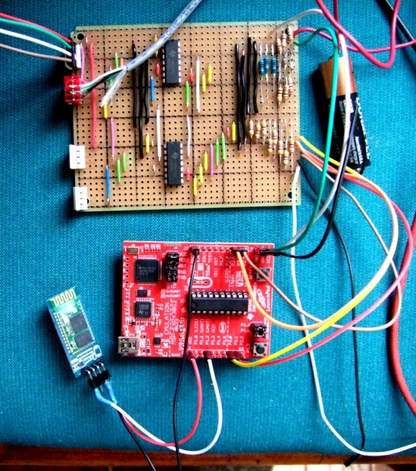

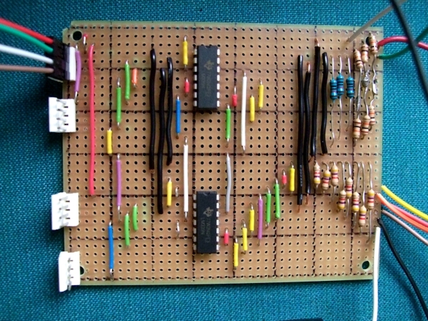

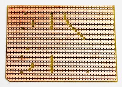

The boards:
Notes:
The top connector, left side of board is the Igaging scale input. In the photo the clock and data line (white and green respectively) are reversed. I've tried it both ways. Unfortunately the web instructions don't specify. Power and ground (red and black) are correct (3.5V for this scale).
Next connector down is the caliper input. That has wires in correct order in this photo. And power to that scale is 1.5V.
Third connector (not connected) also has a 1.5V power pin -- I was going to use another caliper type scale.
I'd like to concentrate in troubleshooting the topmost circuit -- if it's at fault. It is difficult to do this without a schematic. I do know that the topmost LM339 should have half the connector voltage on pin 6 -- and it does (1.7V). And that pin 3 should have 3.5V -- it does.

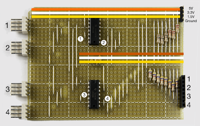

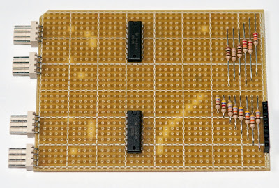

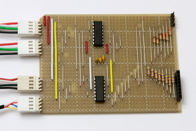

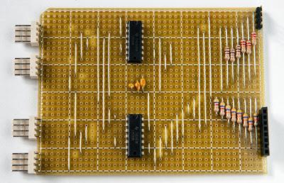

And here are some photos from Yuriy's website (URL in first post per CC license) of how things should look for comparison, in case someone has a sharper pair of eyes than I do (pretty likely):
The top photo shows the main connections, minus the power connections that bring the different voltages needed by various brands and types of scales.
The second photo shows the Power rails (stripes at top), and the "virtual grounds" (stripes mid card). also marked are the locations on the LM339 comparator for virtual ground connections - numbered by scale#.
The next photo shows the power connections set up for a different set of scales than mine (Yuriy's own mix of glass scales, igaging and caliper).
These should be jumpered, per your own mix of scales, to the appropriate pins on the scale connectors. In my case the top scale connector is an Igaging scale and needs 3.5V.
In my case, I need 1.5V on the second scale (Connector # 2) for a caliper scale.
Also the "virtual grounds" should be jumpered to the LM339, again, per your own mix of scales.
If you refer back to my board photo, in the post above this one,  I need 3.5 V on the top scale connector (Igaging scale), so there is a power jumper to the second row on my board (uppermost left, short, red).
Since I also need 1.5V  on the second connector (caliper scale), there is a power jumper to the third row on my board (upper left medium length, violet)
For virtual ground jumpers I have:
Scale #1 a jumper from pin 6 of the LM339 to the "3.5V/2" "virtual ground" - Blue jumper
Scale #2 a jumper from pin 8 of the LM339 to the "1.5V/2" "virtual ground" - Green jumper

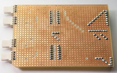

View of the board "traces" and population (from Yuriy's website):

Steve I can contribute little on the Iguaging or PIC part of your project - never been there, however when I was a callow youth back in the mid/late 1960's I was a Technical Assistant in the Mullard IR devices Application Lab (Multi-element liquid nitrogen cooled arrays for satellite surveillance) . One of my duties was to give physical reality to the circuit designs dreamt up by the clever senior engineers. Usually ultra low noise signal amplifiers.
Most first prototypes were on Vero 'strip board' and like you I used a drill to form breaks in the track. The number of times odd behaviour was eventually tracked down to a hair or whisker of copper still connecting tracks was legion.
I've looked at your pictures and nothing leaps out at me, but I would advise checking each and every break with an ohm meter
