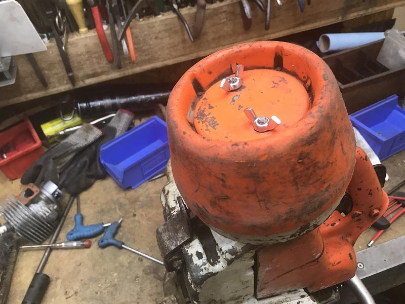

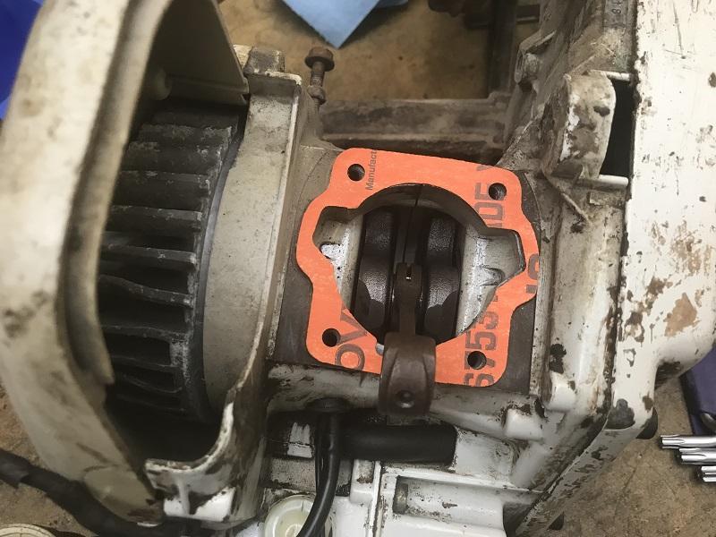

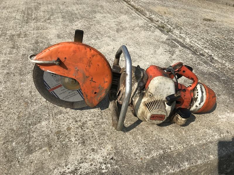

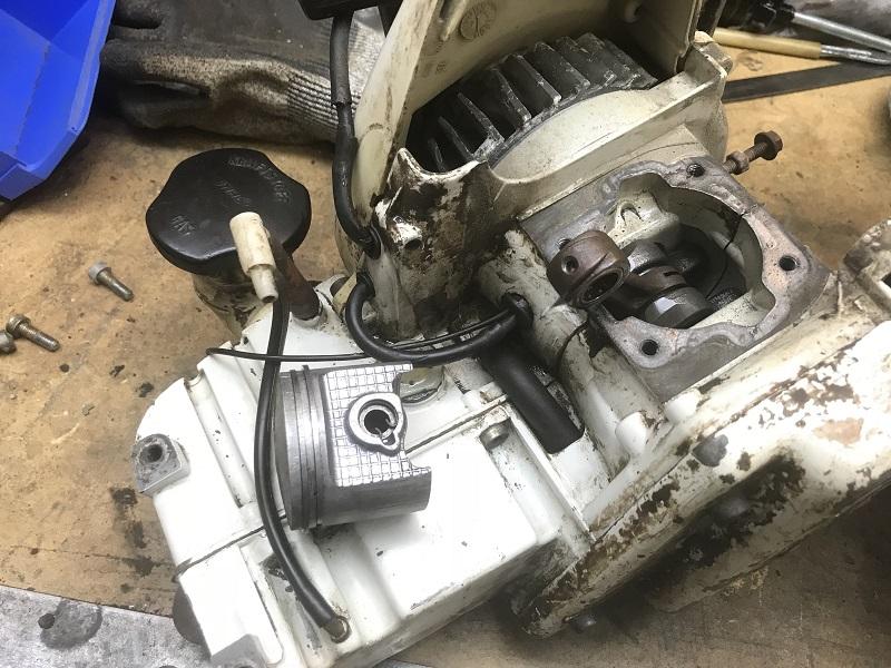

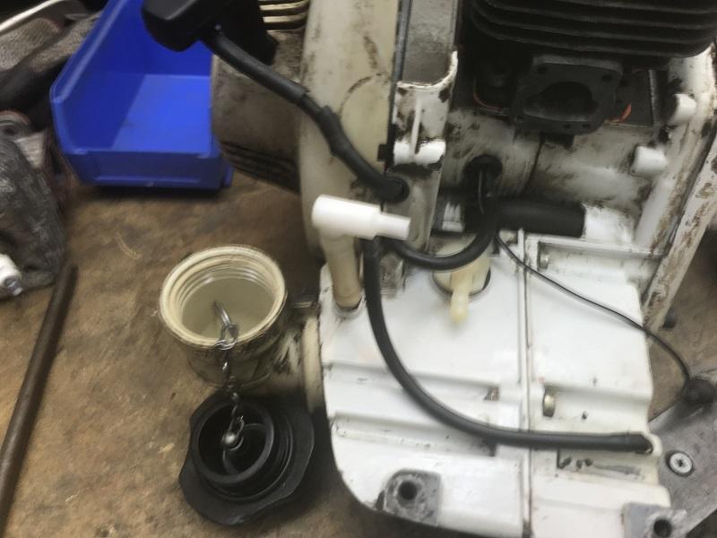

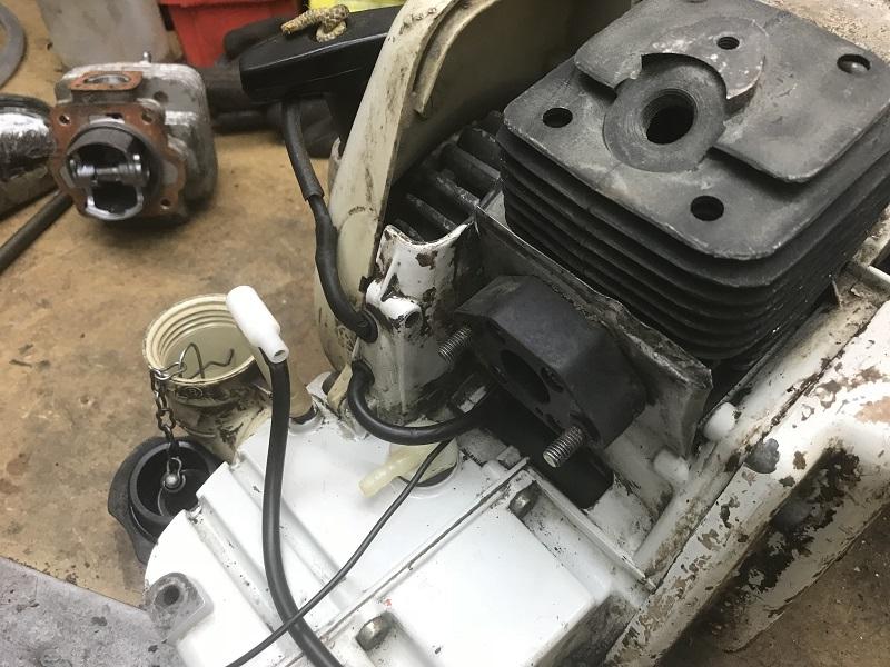

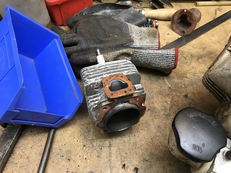

I've had this Stihl TS350 petrol saw for ages - it's done good work particularly when I was rebuilding my house and barn, but it has got increasingly hard to start, with low compression.
I was given an almost identical one that I thought I could use for parts, but it's compression also was pretty dire. Nowadays clone parts are coming out of China, and I was able to buy a pattern piston, rings, gudgeon pin, cylinder barrel, and gasket for the princely sum of £32.50 including postage !
They arrived by this mornings post, so I thought I'd get on changing it before the new big CNC lathe arrives and takes all my attention.

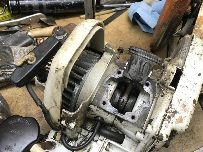

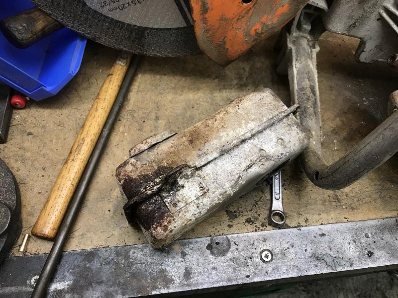

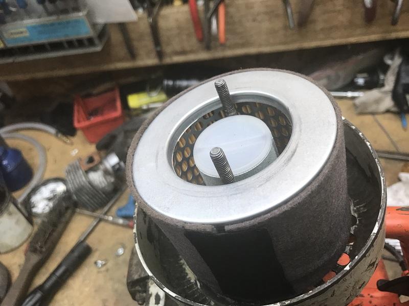

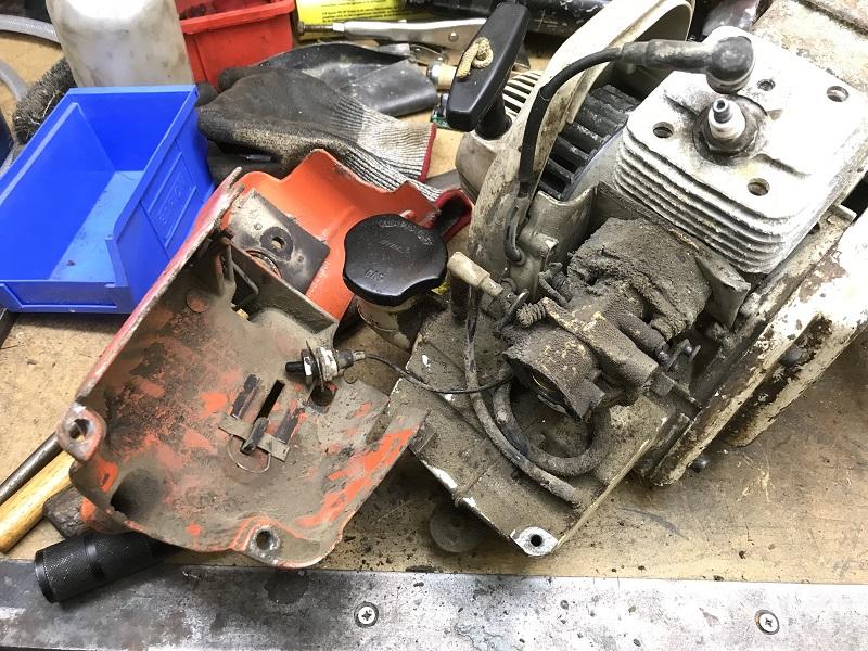

So firstly strip out the old:
Online awemawson
  • Posts: 9071
Re: New Cylinder and Piston for TS350 Petrol Saw
« Reply #1 on: May 23, 2018, 08:36:48 AM »

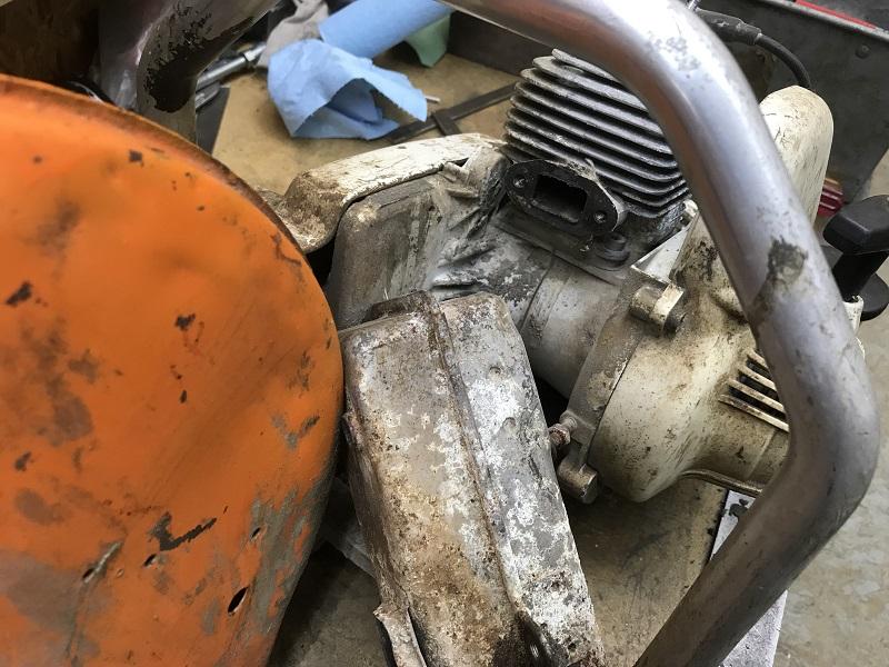

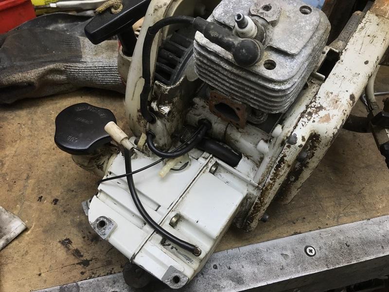

So far going quite well, I even had the correct long series Torx keys

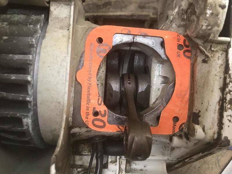

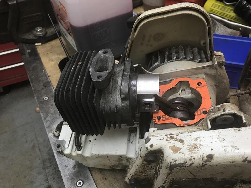

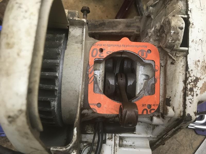

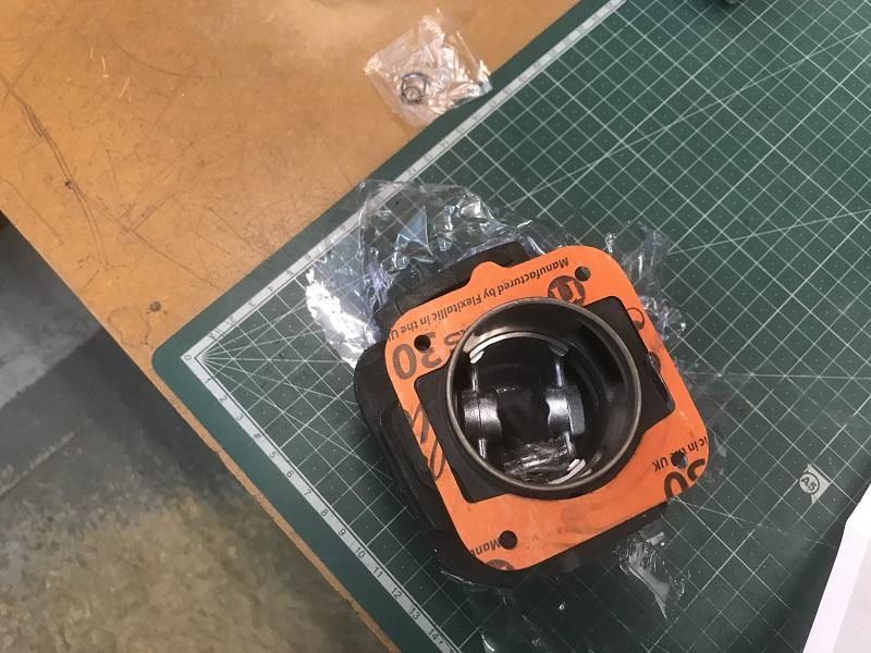

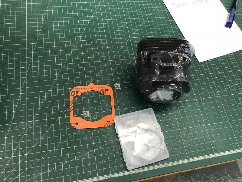

So first thing to go back - the barrel lower gasket - fine they supplied one  :thumbup:
Ah - well no - WRONG SIZE  :bang:
I suddenly had that sinking feeling - did I order the wrong barrel and piston? But no, they are the same as the original and the supplied gasket doesn't match the supplied barrel  :bugeye:
A phone call ensued, and OK the replacement is in the post, but meanwhile the bench is covered in dismantled petrol saw. I hate leaving things in bits - hopefully play can resume shortly.

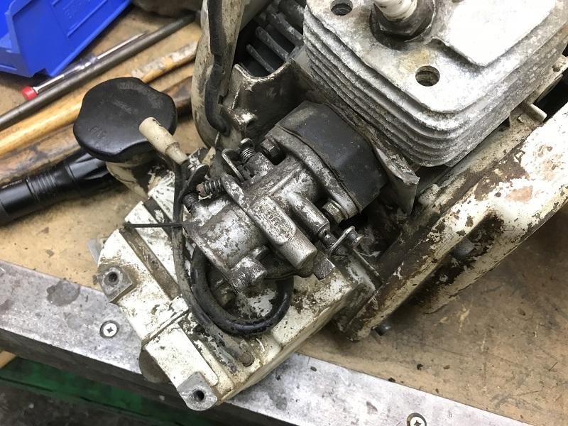

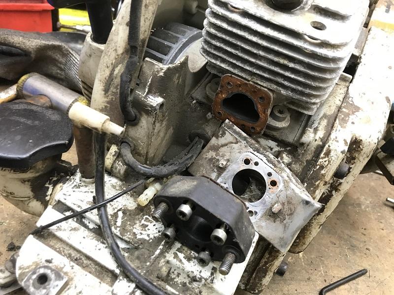

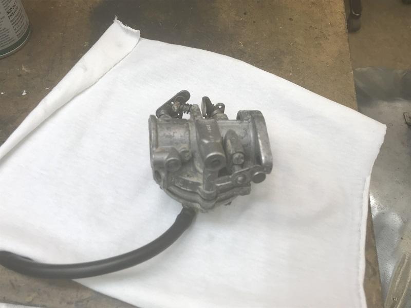

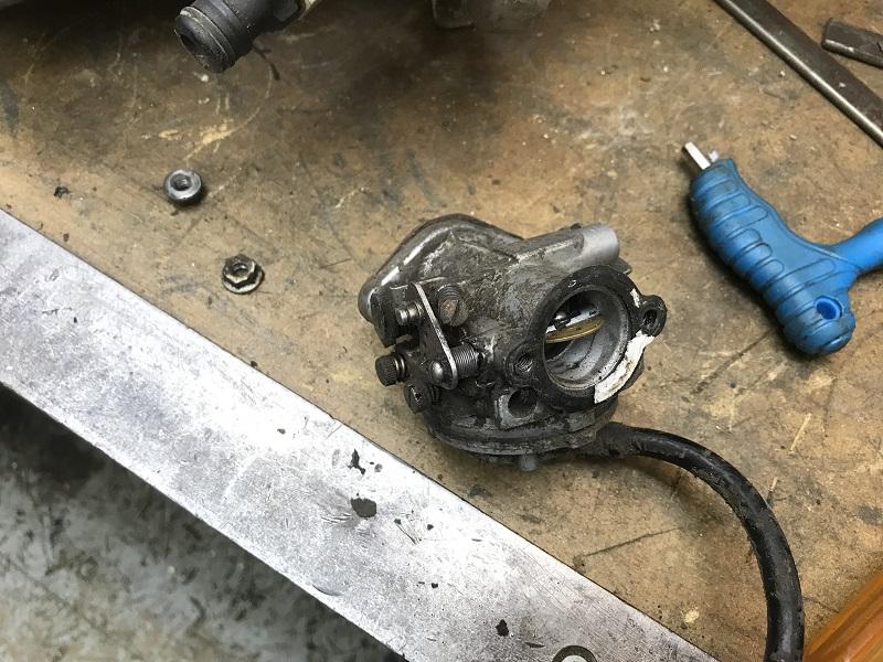

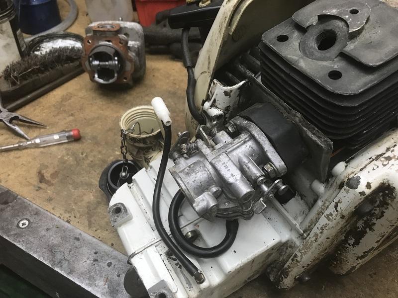

I took the opportunity of the enforced hiatus to clean up the carburettor. Only externally, though it's passages got a liberal dose of carburettor cleaner.
I won't pull it apart unless I still get starting difficulties - this isn't supposed to be a full rebuild !

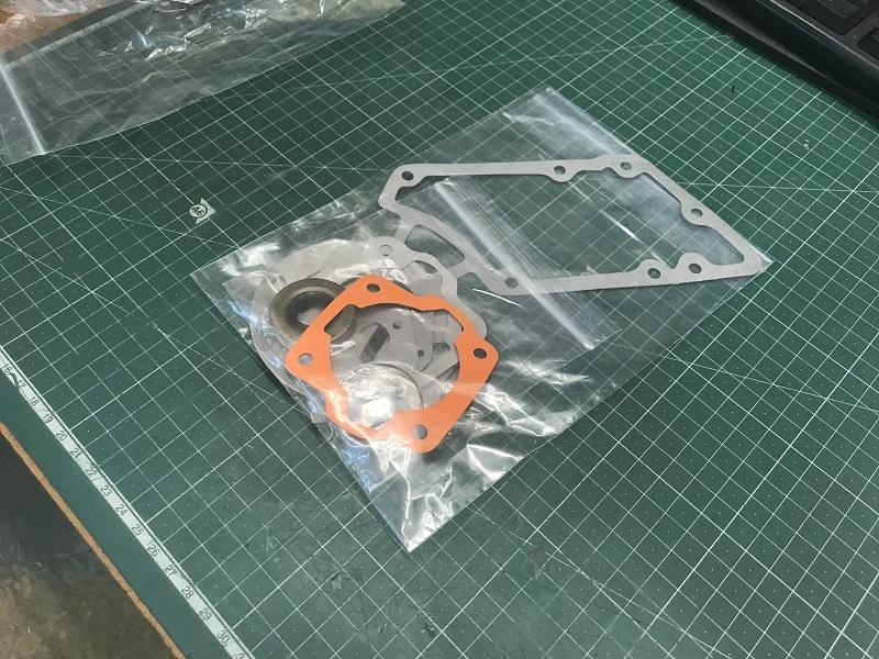

New gaskets set arrived this morning by post - not bad - only ordered yesterday at 16:30  :thumbup:

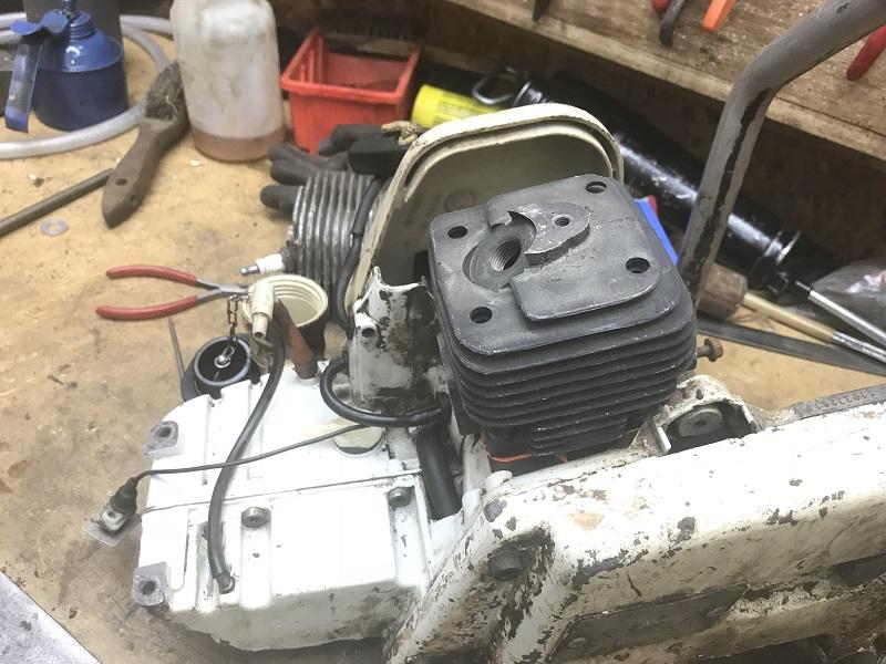

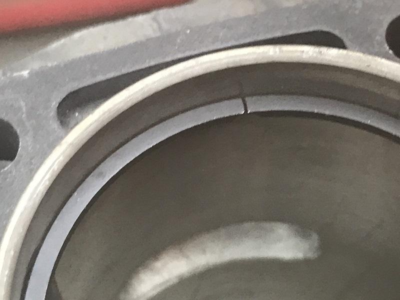

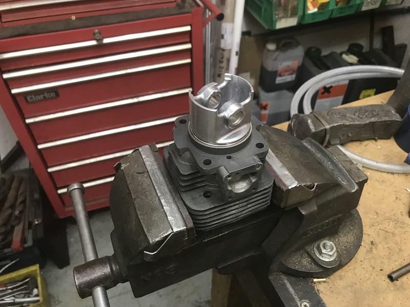

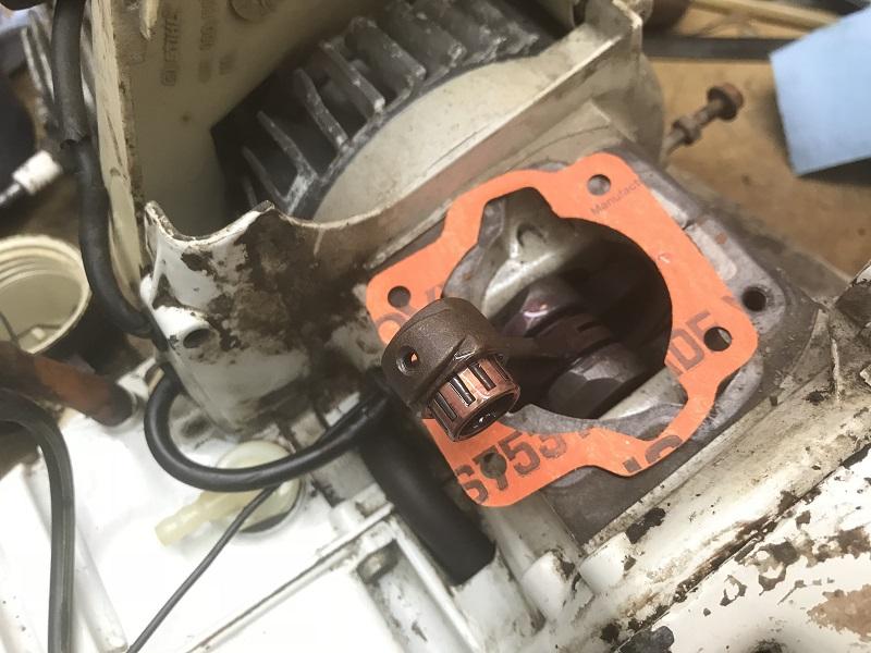

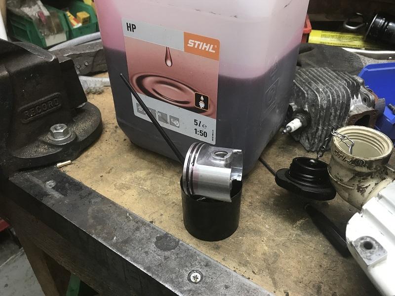

So just a bit of 're-mantling' - only clever bits being gaping the rings and sloshing two stroke oil on the slidy bits before putting it all together. To gap the rings they need to be set in the bore exactly perpendicular - I do this by placing them in the bore then squaring them up with the piston. Supposed to be pre-gapped and indeed they were both 0.35 mm which is in spec

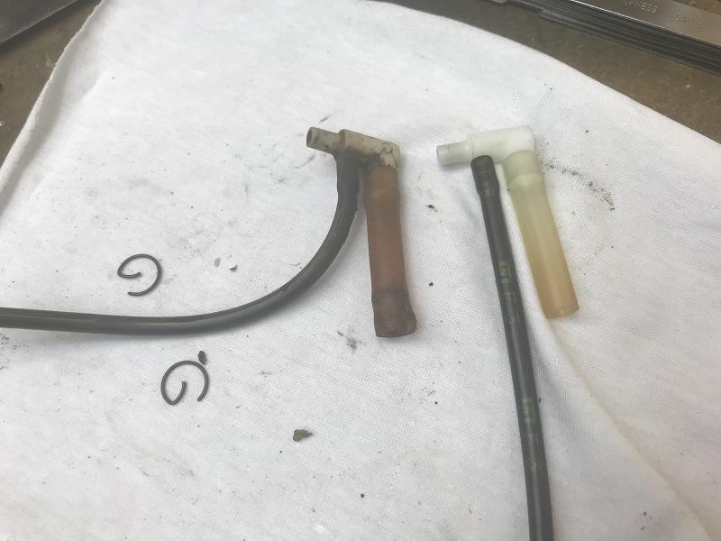

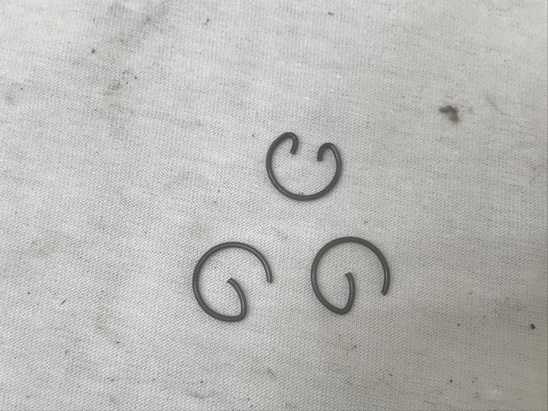

The gudgeon pin circlips supplied looked as though a 5 year old had been twisting wire, so I re-used the originals

« Reply #5 on: May 24, 2018, 10:02:42 AM »

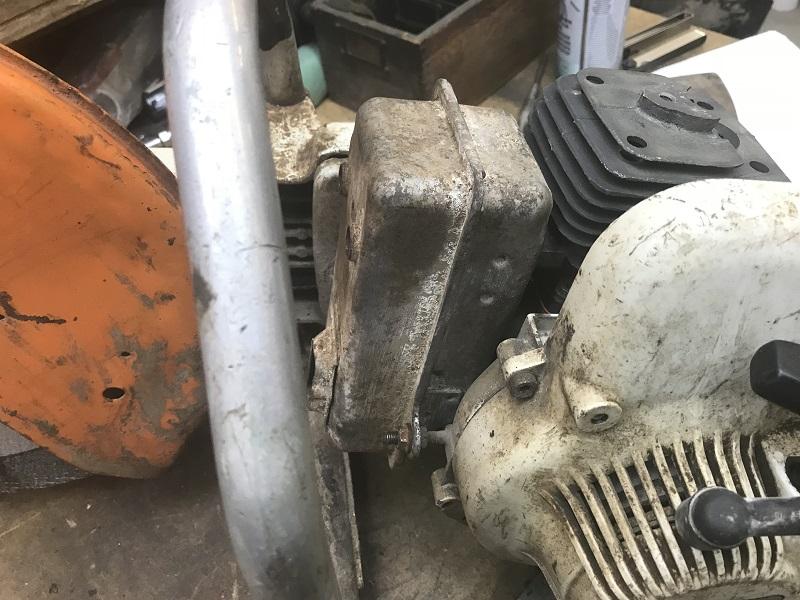

It was pretty tricky getting the throttle and choke linkages to line up when the top cover was re-fitted but I got there in the end !

Another thing to watch out for ,is the in tank fuel pick up its like a clunck fuel pick up as used in model aircraft. The tube is a specially moulded affair which is made of a very flexible neoprene/silicone type rubber over time and allow air to seep in.
Did you fit a new carb gasket/s these have port holes which connect the crankcase to the pumper carburettor. Lastly are the carb spindles badly worn, they often are on disc cutters because of the "grinding compound"

looks like virtually the same engine as on my venerable Stihl chainsaw, completely agree with you on the circlips, those bends are far too tight, and you can imagine the mess if one of those broke off!

Had to rebuild some carbs long time ago....some diagraph/gasoline combos seem to work better than others. Remember changing the fuel line and the clunker in the tank.

After clening the carb and installing new membranes I would start with the basic adjustment for this carb (H = 1
L = 1 turn from closed).
Are the crankshaft seals still airtight? Leaks might show more now that your piston is new.

The seals are very important for a predictable and stable tick-over. When they leak air you never get a constant carburation in tick-over and it will be impossible to adjust the carb. The seals are just ordinary Simmerrings. There is an impulse connection between crankcase and carburator. This might be a hose or a fixed connection with gaskets. This could also be the problem.
You can test the hose and the seals by spraying it with brake cleaner while the saw/cutter runs. It this changes the idle speed the seals are shot. An indicator towards shot seals is also when the saw changes idle speed when turning it to the side. The seals can be changed without splitting the crankcase, but you have to remove the clutch and the flywheel. There are left hand threads around. An impact wrench is useful to loosen screws without locking the piston.

Carburettor gasket and diaphragm kit arrived yesterday, so I pulled it all apart again, and rebuilt the carb. Turns out that a previous person had assembled it in the wrong order, the gasket for the pump diaphragm being on the wrong side. Also the tiny 'o' rings on the low and high speed jet needles were missing - these seal the thread of the needle to the carb body. Fortunately I had suitable O rings, but had to make their backing washers by turning down standard 4 mm ones as the o/d was too large.

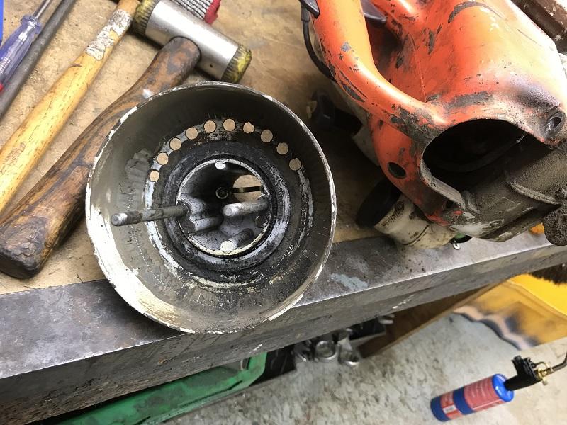

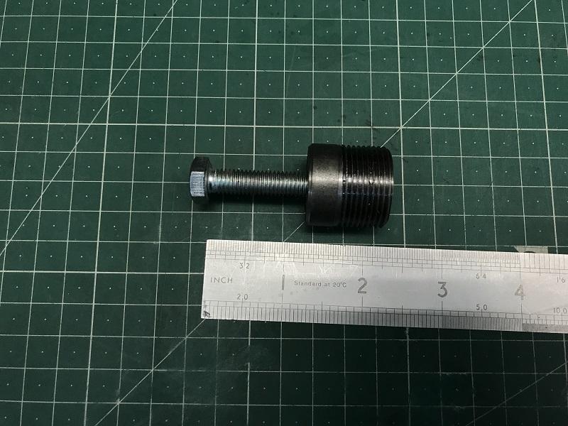

Then having made a flywheel puller (M25 by 1.5 mm pitch for future reference) I set too and replaced the crank case seals
