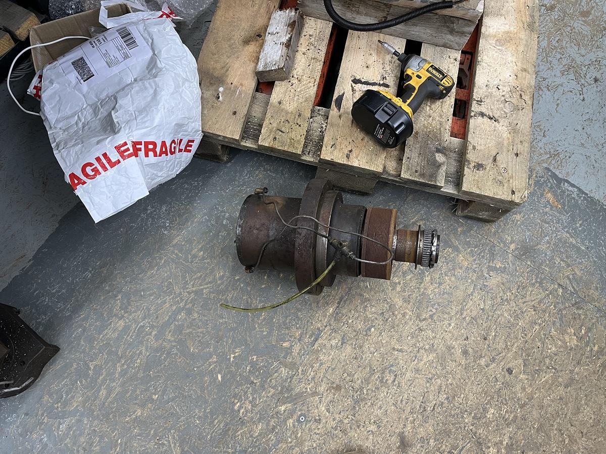

Then came a spindle assembly for a Beaver Partmaster that he had scraped complete with tool gripper:
These can sit on the shelf hopefully never to be needed as my Partmaster CNC Mill is ok (another jinx !!)

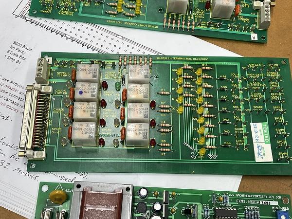

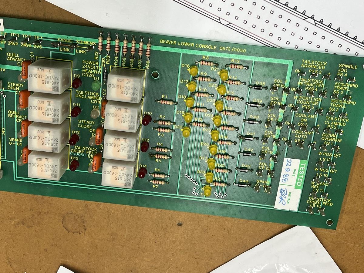

Then a few interface electronics from the TC20 lathe that one hope I'll not need but better to have them than not:
Turret Logic:
Tailstock Logic:
Chuck Logic:

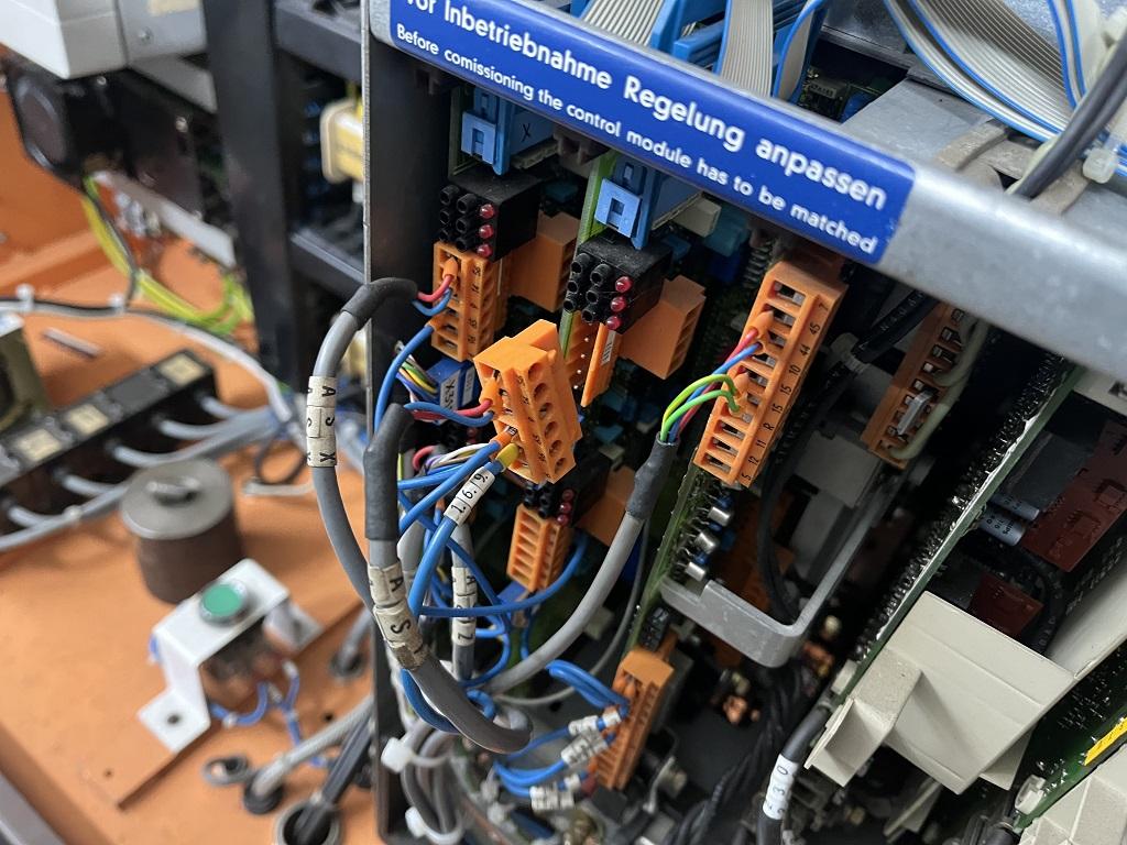

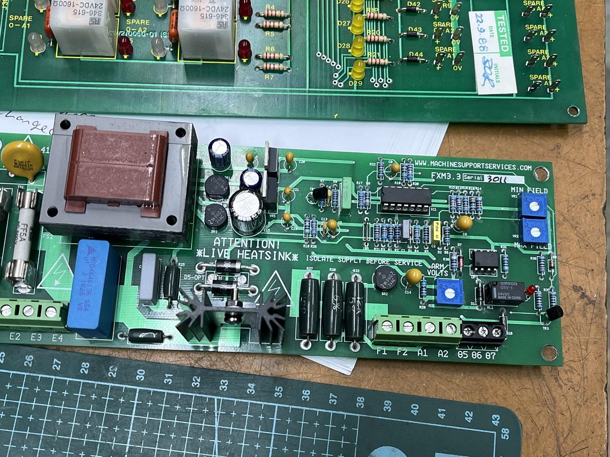

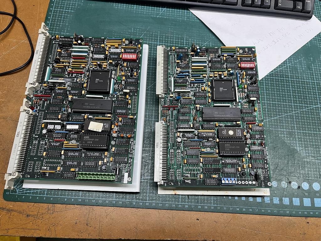

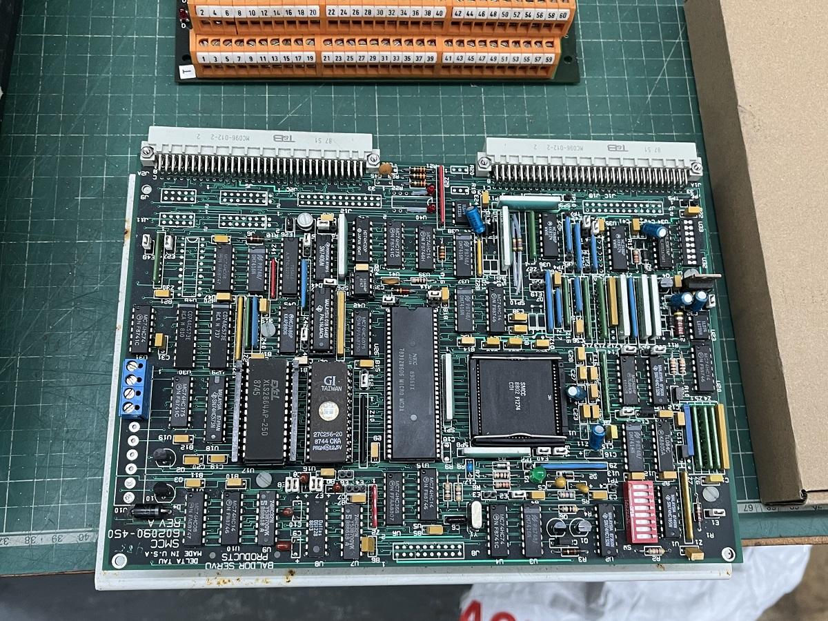

Now for the important bit - the SMCC servo logic controller that I THINK is the source of my issues:
Also he has returned the Field Coil Drive Card that I let him have as an aid to his diagnosis.

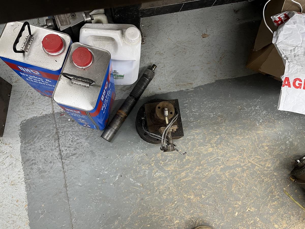

Disappointingly the Tool Turret Assembly is missing it's servo motor and is a bit knocked about - I had had ideas to set it up as a test rig but not without the motor :(

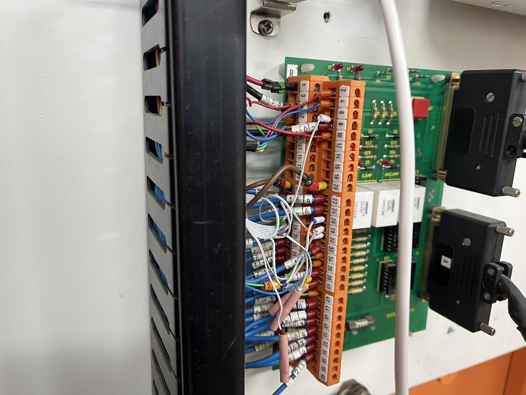

Having cogitated the best way of isolating the Turret Servo #motor drive it came to me in a flash - the analogue +10-0-1-10 drive signal is on it's own plug with a few associated control signals, so it can just be unplugged - simples :(
This then allowed me to turn the servo motor by hand without fighting the drive, and I was able to detect the 'Index Notch' by monitoring it's proximity sensor, getting a decent signal of 19.1 volts when off the notch and 0v when on it.
As I was monitoring on a terminal strip up behind the turret (gymnastics involved!) I thought it bast to prove it all the way through to the SMCC card as quite a bit of chassis wiring is involved to get it there. The SMCC card is isolated by an adjacent PCB holding opto-isolators and relays - terminal 34 being the Turret Zero Ref signal. Sure enough it's working.

Now I've long suspected that this problem basically is an erroneous slight offset on the analogue output of the SMCC servo computer card - very difficult to measure anything as it all happens a bit fast but the result (I think!) is a bias on the tool disk so when the front curvic coupling needs to mesh after a tool disk move it cannot lock into position as the fixed and moving teeth clash.
Certainly as a case in point this morning although I can hydraulically drive to tool disk forward to unlock, it would not return to locked until I disabled the servo drive (X111 plug out) and manually gave it a slight turn.
So heart in mouth I decided to install the replacement second hand SMCC card. It was complete with it's mounting bracket which is slightly rusty. If I fix this fault I'll swap the bracket.
The result is that I can move the tool disk to apparently any position and it will return to the locked position (so far!) every time. However the 6000 error message calling for a turret reset still won't clear so more investigations called for.

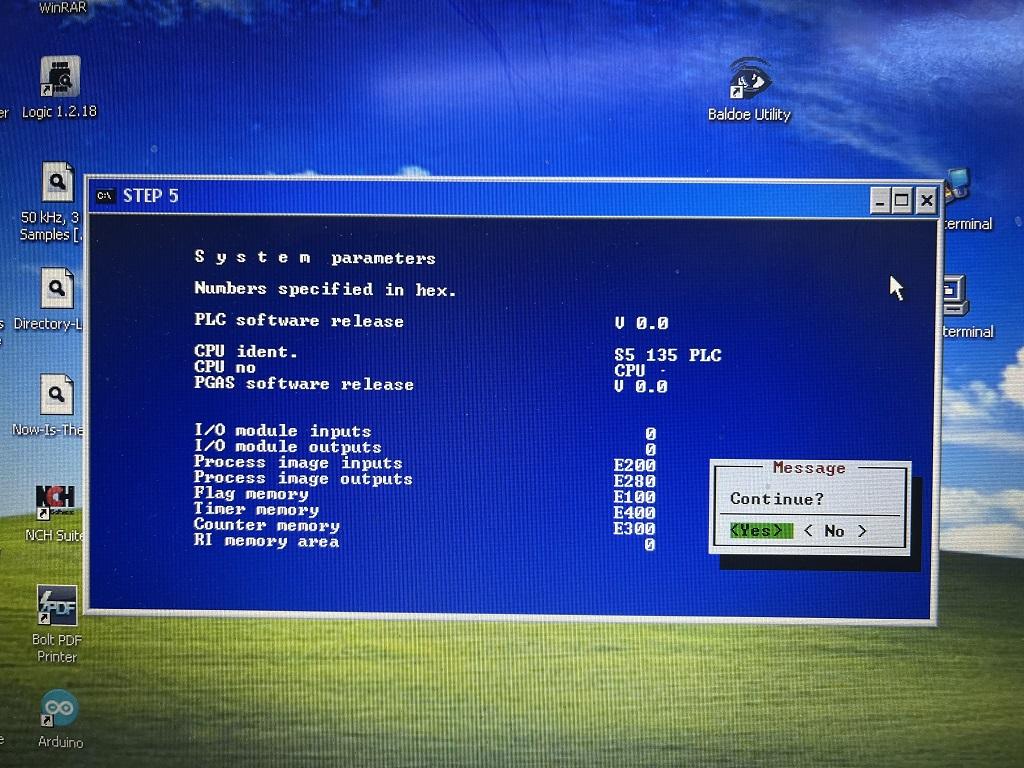

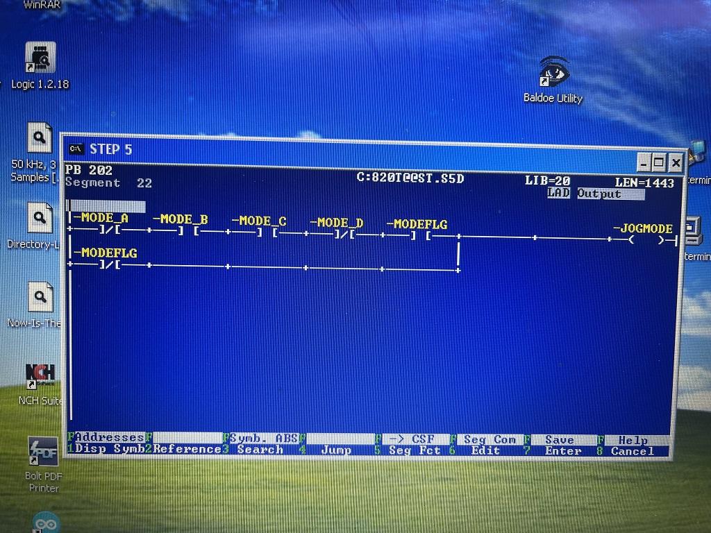

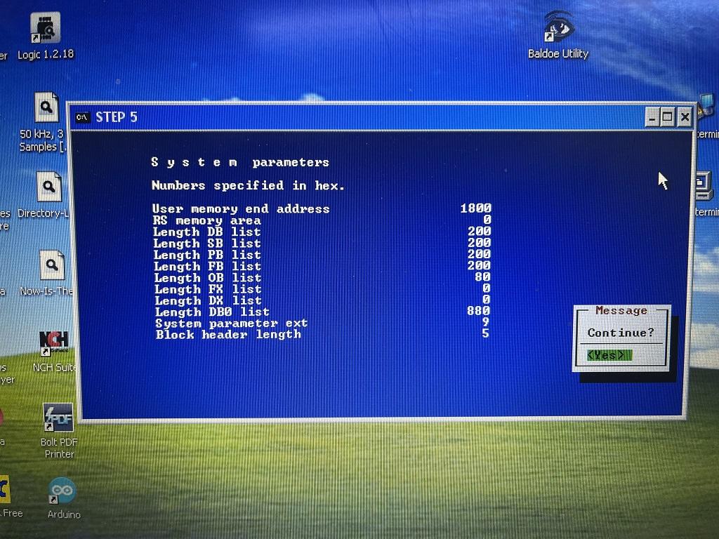

But objective today is to power up the old ToughBook lap top with Step5 (Siemens PLC support program) that runs under Windows XT.
A lot of faffing about and trawling through grey matter and eventually I got there - we are CONNECTED to the internal PLC that runs within the Siemens Sinumerik 820T control that controls this lathe.
A few screen shots just to prove it:
It reports the correct PLC type:
I can read internal parameters
I can see PLC Ladder Logic in real time
Now I need to go and warm up and refresh my memory of what is where in the PLC logic that's relevant to the current issue but my brain's a bit numb at the moment :)

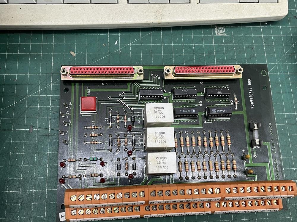

However a nifty 37 way Sub D break out board turned up on eBay with male and female connectors and a terminal strip allowing me far better access.
« Reply #1268 on: July 10, 2025, 09:54:40 AM »
So over the last few days I have checked all 96 input lines by temporarily connecting them one by one to 24 volts and using the PLC inbuilt diagnostic tools to display them on the monitor.
Still a bit of a pain, and involves a lot of walking as the terminations are on one side of the machine with the control panel on the other - and yes it's a long way walking round it that gets 'old' very quickly. Still two days spent and I've convinced myself the ALL the input are working fine - now there are several unused inputs but I decided to test them all:

So now I need to devise a way of testing the outputs. Presented as two cables again terminated in 37 pin D Sub connectors so compatible with the break out board. And again the PLC diagnostic allows me to see what it thinks that it's outputting (it's a Q word) :
However the way (I think) that the PLC works is that it maintains a table of these bits that is updated by the PLC program and every cycle of the program the table is copied to the Q outputs.
This means that if the PLC program is running anything I write to the outputs will be overwritten in milliseconds and if the PLC program is NOT running I can't access the diagnostic facilities so a bit of a catch 22 situation.
I can do a somewhat less stringent test by reading a particular Q word and checking what is actually set but I'm not convinced that that's good enough?
Off to scratch my head a bit !

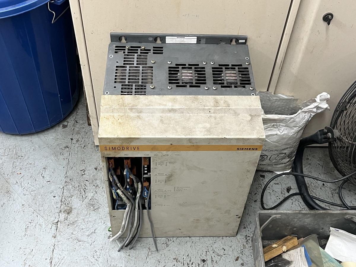

However I HAVE found that the drive circuit for the main spindle drive is reporting an error - it also has a tell tale red LED that should be 'on' but it isn't. Fortunately I do have a spare so I'll install it when time permits - ATM waiting to meet and greet two sets of cottage guests whose arrival is imminent. (sounds of thumbs twiddling!)
« Reply #1274 on: July 12, 2025, 06:28:33 AM »
More positive progress this morning. Yesterday late on I found that the red 'I'm OK' LED on the main spindle drive for it's field windings was 'off'. Fully expecting to have to change the card - I have spares - I did a bit more research. That LED isn't going to glow when the card has no power  :ddb:
Tracing it through I ended up at manual contactor 'MBS' (a Telemecanique GV1-M07) which is as thermal trip. It wasn't latching on properly. With the power off a few cycles of exercising it got it to latch.
Ebay has provided a reasonably priced 'new' one so I've ordered it just in case.
This got things moving - well it did when I remembered that the console 'Keyswitch' needed to be vertical to allow input !
