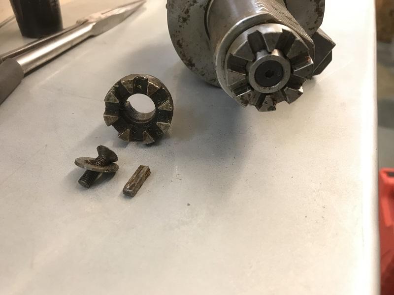

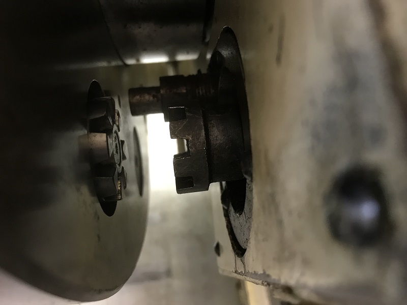

So on to the powered tooling. There are two issues:
A/ The Baruffaldi Powered tools have a different dog clutch shape than the machine drive spindle
B/ When a Powered tool is mounted, the faces of the two dog clutches are separated by 15 mm so wont drive anyway.
I had expected to have to dismantle the bearing housing for the drive spindle to remove the dog clutch and spindle, and make a complete new assembly, but it turns out that the machine dog clutch is just keyed to it's shaft and retained by a countersunk hex bolt, and I was able to withdraw it though an empty tool position.
Now the new dog clutch needs obviously to engage with the Baruffaldi ones, and be 15 mm longer (plus engagement depth). It would be a nice exercise to make on this lathe if the powered tooling was working, but that's a rather circular argument  :lol:
Have some pictures

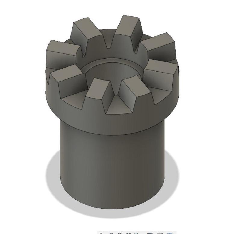

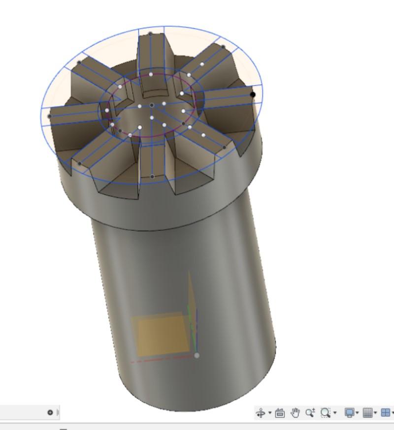

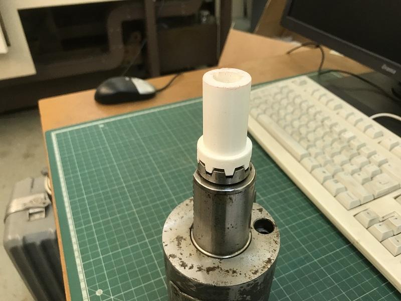

So embryo replacement drive dog drawn up in Fusion 360 and now printing on the Cetus 3D printer. This is just to let me better visualise what I need before I start machining - be nice if a 3D printed part could just be used as is !
  • Posts: 9071
« Reply #588 on: November 17, 2018, 03:05:03 PM »
So the 3D Printing has finished, and I've been able to use the model to measure how long it needs to be to engage, and yet have clearance when the tool disk rotates.
At the moment the drive dog is installed with it's shaft key but no retaining screw as I need to find a longer one. Amazingly it works. I suspect I could even do a  bit of light milling with it, but probably won't.
Next task is to work out how to make a metal one. The teeth have a 12.5 degree taper when in lies the machining problem.
Two options spring to mind:
1) Tapered end-mills.... if you can get one with the right taper.
2) Do it on a manual machine with a rotary table, and have the head tipped over by the correct angle.
3) Mill the bulk of it with straight sides, then use a die eroder to make the tapers (if they can do that sort of thing?)
I'll stop there before someone does a Spanish Inquisition joke...
  • Posts: 9071
« Reply #590 on: November 17, 2018, 04:18:00 PM »
I'm tempted to make a 'D-Bit' to a 12.5 degree taper. The real problem is that the 'root' of the gash at the inner (narrow) end is only 2 mm wide, so any cutter will be fairly delicate.
The alternative but slightly more complicated way is to make a tapered slitting saw which would be more robust.
As a compromise I could make the protrusions slightly shorter radially thus increasing the gash root width.
. . . all suggestions welcome  :clap:
. . . of course a 3D printer that prints in Bronze would work nicely  :ddb:

I'm sure that the original Baruffaldi drive dog was steel, and machined. But of course I have never seen one, as my lathe was fitted with the dog to fit 'hens teeth rare' Beaver powered tools. So my 3D model is entirely guesswork but must be close. The dog shaft actually slides and is spring loaded into contact.
I've simplified and re-drawn the model this morning - hopefully this view will give a better idea of the tooth shape. I rather like the idea of lost wax casting it in bronze.
However it does occur to me that a plastic 3D printed one actually forms a useful safety 'mechanical fuse' in the case of jam ups, and it's dead easy to make another and re-fit it.
. . . I'm off now researching wax 3D printer filaments . . . . :coffee: :coffee:
