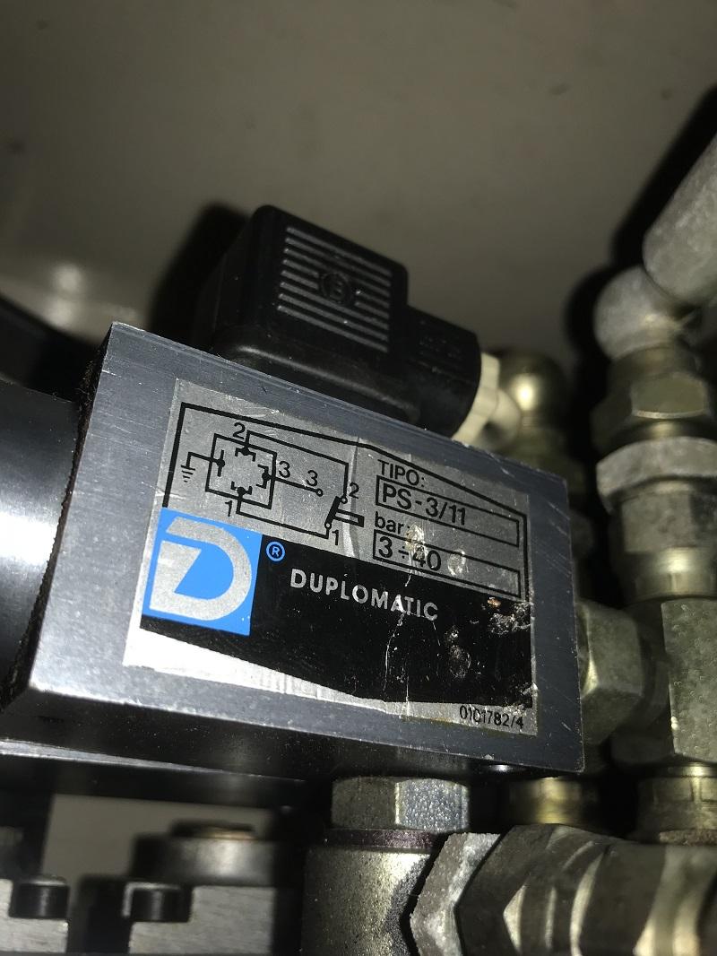

Using the (new to me) PLC ladder testing approach is both swift in some ways, and mighty frustrating in others. Although I reckon that I have the majority of the logic 'nodes' (ie inputs outputs and flags) named so that I can find my way around, inevitably I end up in a bit of logic where I've not yet been able to plant signposts  :scratch: I reckon I've still 102 out of 490 nodes to name and identify the purpose of
Today I found out that one of the pressure switches that monitors chuck clamping was permanently 'made' - entirely by following the ladder logic, but the frustrating thing is that either they have been wired wrongly, or the circuit diagram is wrong. They are pretty well impossible to get at and determine which is which - certainly can't at the moment as still in Sunday Best  :palm: - a job for tomorrow slackening a hydraulic fitting and see if  clamp or unclamp covers me in oil !
Hopefully I can pull it out and re-work it as I very much doubt that they are a shelf item any more - have a picture.
I'm also attaching the latest .pdf  version of the annotated PLC program for those of you that can't get to sleep at night  :lol:

Ugh.  I hate pressure switches!  Just a time bomb ticking off till failure.

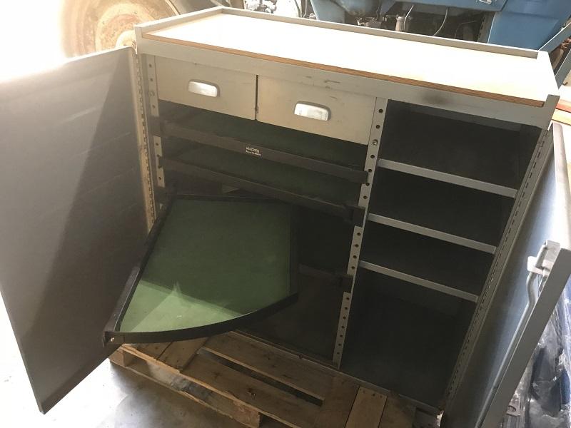

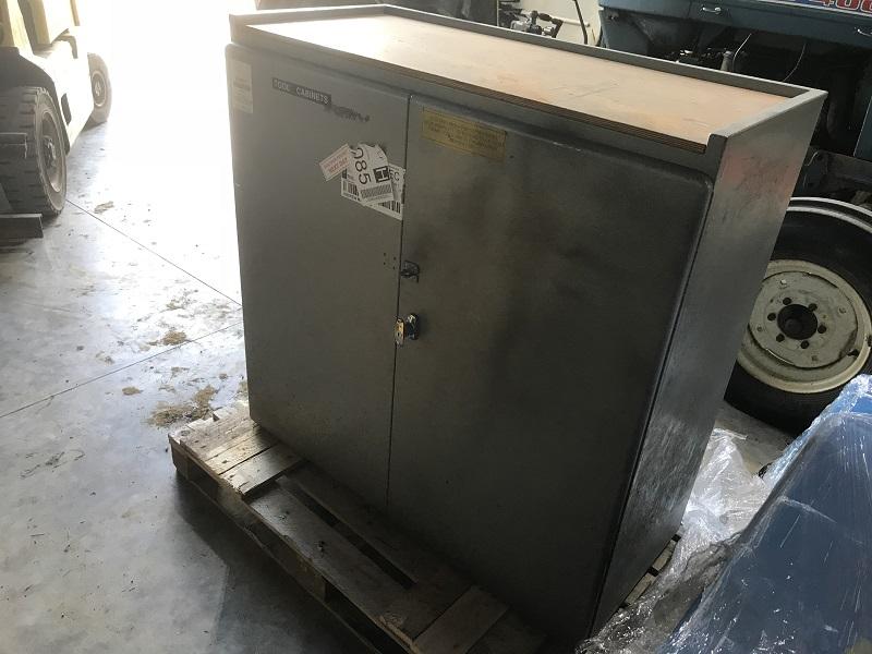

Taken a bit of time off to sort out some tooling cabinets for the Beaver TC-20 lathe - Versatool ones like I used for the Traub - details here:
https://madmodder.net/index.php/topic,8741.msg152687.html#msg152687

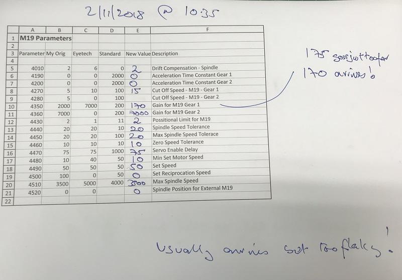

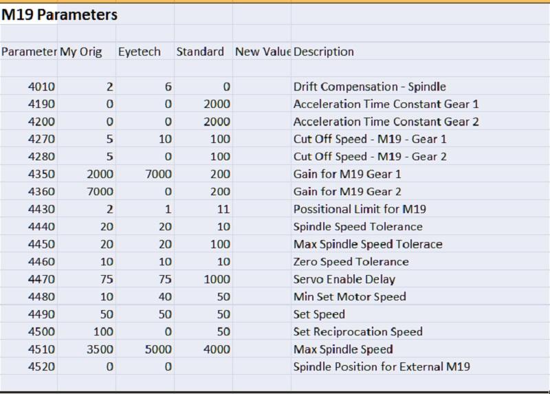

Major break through today in the hunt for the M19  Oriented Spindle Stop problem that has been eluding me for ages.
In desperation I have typed into the 'Machine Data' for the controller the values of parameters for Spindle Data from the TC-10 back up that I obtained, where they differ from mine. And guess what, the servo loop IS closed, and the spindle rotates to approximately the programmed position but then oscillates around that position never completing the command. Parameters changed are:
#4010 Drift Compensation (Spindle) was 2 now 6
#4270 Cut Off Speed M19 Gear 1 was 5 now 10
#4350 Gain for M19 Gear 1 was 2000 now 7000
#4430 Positional Limit for M19 was 2 now 1
#4500 Set Reciprocation Speed was 100 now 0
So I conclude that the spindle positioning servo loop parameters need tuning. I have tweaked all these values up and down a bit  but not yet found any one that stops the hunting.
Bear in mind that the other lathe is different. It only has one gear whereas mine has two, so parameter #4350 for instance where the servo gain is very different (7000 as opposed to 2000), in fact mine was originally 7000 for Gear 2. Also my main spindle motor is significantly bigger than the TC-10 one.
Need to research servo tuning, but what amazes me is that with my original values there was no apparent servo action on the spindle at all - very odd.
But this IS another major step forwards  :clap:

« Reply #529 on: November 01, 2018, 11:28:08 AM »
The gain would be the obvious choice to prevent hunting. I can just about recall this was fairly critical when I was playing with feedback on RF frequency synthesizers.
Perhaps the drift compensation is damping. (Then again, perhaps it isn't)
Well done!

Ooooh!  Tool (cabinet) lust!  Love the swing out shelves!  My Hardinge does that for collets.  I _might_ have made my own custom "board" out of Aluminum...

Meanwhile I've made up an Excel spreadsheet of the 17 parameters that I 'think' are involved so that I can keep track of what I've changed - I've been printing out a copy after each 'session' and time and data stamping it !

Monitoring the analogue drive to the Mentor DC Spindle Drive when being driven by the controller it seems believable, about 3.5 volts at 1000 rpm and 9.99 at 3500. 3500 is maximum speed so sensible that that is 10 volts ie full range. I've not tried yet driving it from my little servo battery box  as a last minute booking for the holidays cottages threw us into a bit of a panic  :bugeye: I have however managed to find the little box and check that it's batteries are still alive.
Before 'the phone call' I did however have another play adjusting the M19 parameters and have found a setting that achieves 'lock' in that it arrives at set point. By adjusting the gain and seeing if the spindle under shoots or over shoots I was able to arrive at a compromise setting, but it is rather 'soft' and I think it is drifting as things warm up (not surprising). The gain setting is dramatically lower than my original parameters (170 as opposed to 2000) so I'm sure something is adrift elsewhere.
One handy feature is that I can send it to a particular angle, then using the PLC inbuilt monitoring facility find what angle it has actually achieved to let me know if undershoot or over shoot.
Complications this week end due to friends staying so little will probably be done, but it does provide another set of muscles to turn those cupboard over even if he is a septuagenarian like me  :lol:

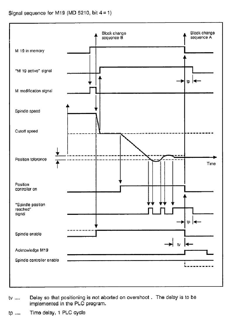

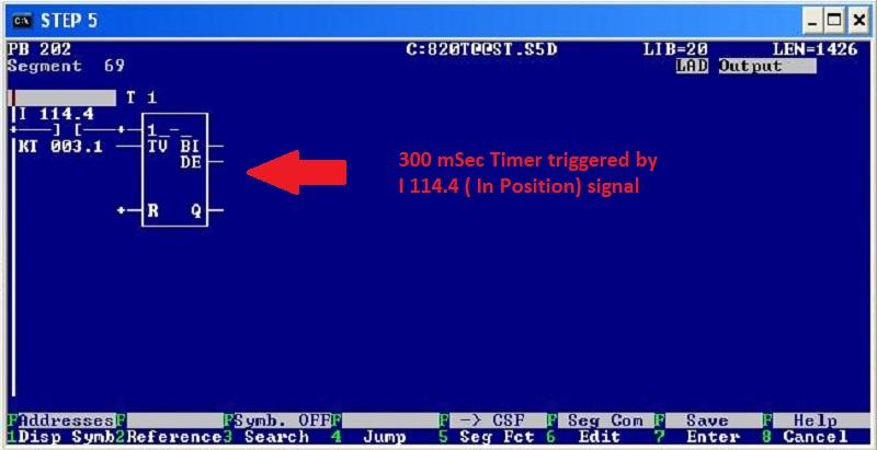

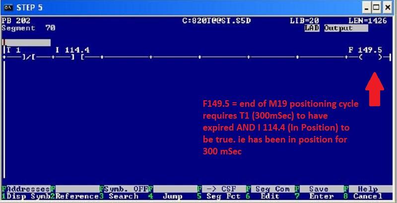

I have wired my Fluke DVM to the analogue drive signal from the 'measuring circuit' to the Mentor DC drive, and sure enough as the gain is increased the magnitude of the position error signal increases and the 'dead band' decreases, but if the gain is set high enough for the spindle to be positioned crisply then the system oscillates. Backing off the gain so that the oscillations  cease but we are not at set point, I can manually rotate the chuck through set point and if going slowly enough the system will 'lock on'
Doing a bit more investigation, and armed with the recently obtained PLC program I can see a bit more of what is happening. A signal (I 114 bit 4) from the NC control, presumably derived from the 'measuring card' is provided to the PLC, where it triggers a 300 Milli-Second  timer (T1) . If the 'in position' signal is still asserted when T1 expires the PLC acknowledges the end of the M19 cycle and applies the spindle brake.
As the servo system is in fact oscillating wildly either side of set point, and never 'on set point' for 300 mSec it carries on ad infinitum. Juggling all the various parameters previously detailed has failed to find a compromise setting. For all the world it is as though there is no damping on the system. I have also examined the acceleration parameters in the Mentor drive, and more than doubled the accelerate and decelerate ramp times with no effect on the symptoms.
I've shot a video to illustrate the point - note that as the updating of the PLC is 'sampled' the camera misses many of the brief bit changes for I 114.4
Also attached are screen shots of the relevant  bits of the PLC program
[youtube]wqfEjbjTkDU[/youtube]

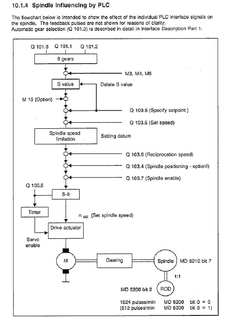

Now looking at the manual for the 810T (mine is an 820T but running the same GA2 program) there are flow charts for how the servo system is controlled and how M19 is implemented, but none of it so far has triggered that 'lightbulb moment' for me to say what's wrong here!
Assuming this machine was working when the back ups I'm using were taken then it's very odd that a parameter would need to be changed as they should be as they were previously, and one parameter (4270 Cut Off Speed for Gear 1) is set to it's original value of 5 the M19 system won't move at all ! Logically I would assume that some hardware has failed / drifted what ever but the bits involved as far as I can tell have been exchanged and then returned to no alteration in symptoms.

On the positive side, the issue I was having with the pressure switch for clutch open / closed a few days ago seems to be solved by tweaking the pre-set for PS/5 on the closed side. Previously it wasn't changing state so would say both 'open' and 'closed' at the same time when actually open but now it does  :thumbup:
