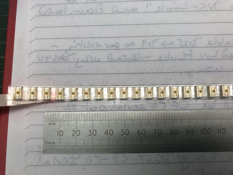

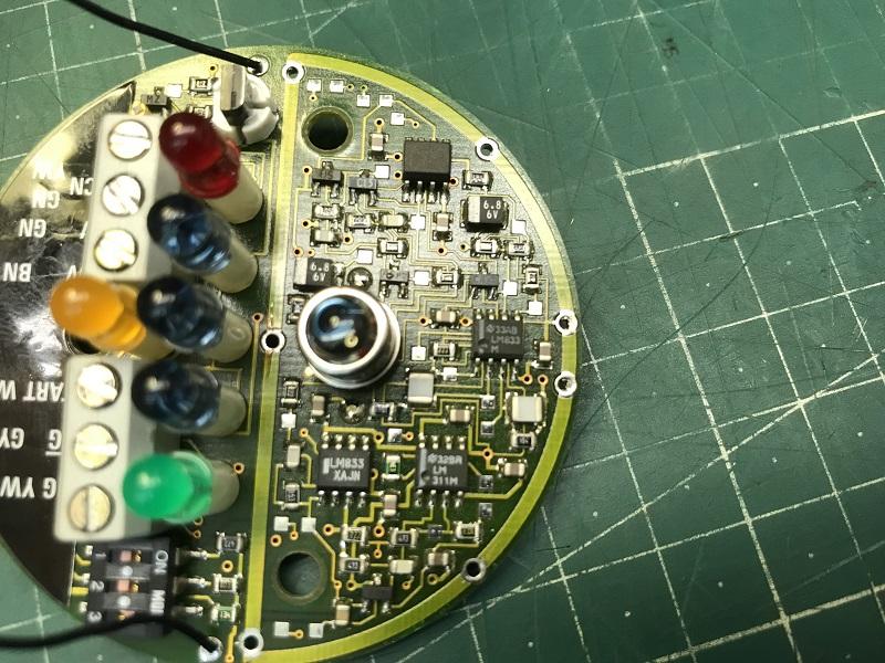

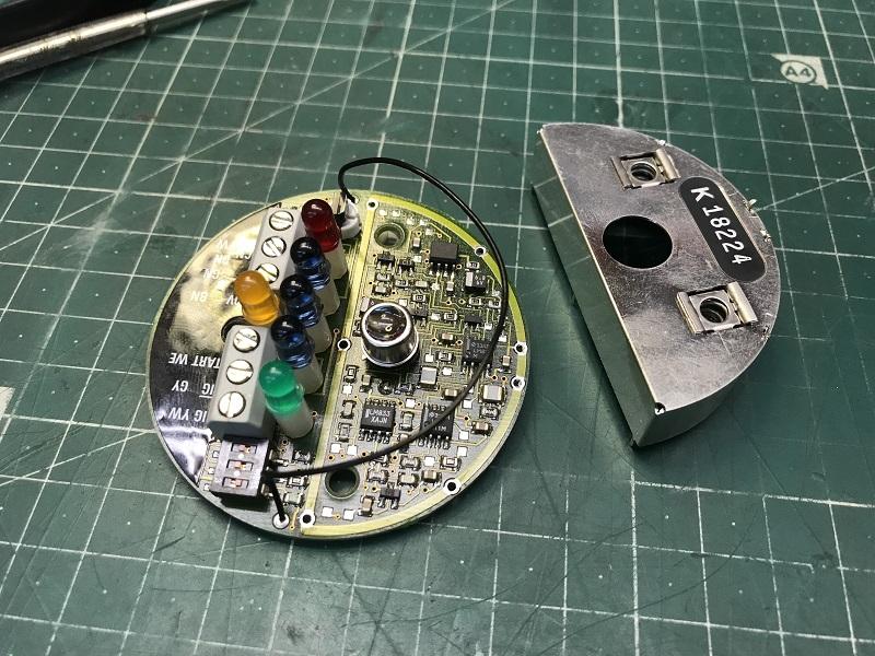

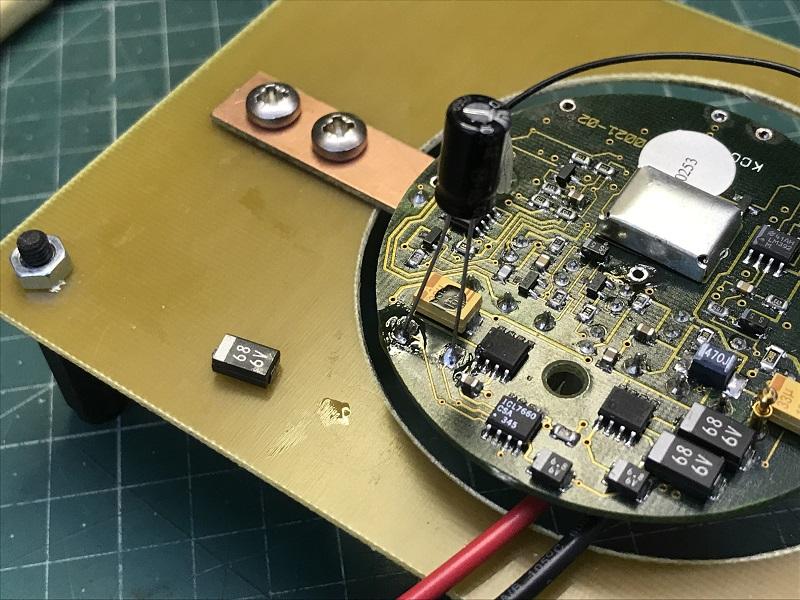

In anticipation of the correct capacitor arriving, I made up an extension cable, in order that the OMM could be be driven by the MI12 on my desk for testing purposes.
Capacitors arrived and sure enough they are the right size this time, so I removed the OMM from the machine, dismantled it and removed the circular PCB. Hey guess what  that's NOT an exploded capacitor - it's a blob of paint  :bang: :bang: :bang:
Never mind, couple it up to a 10 volt bench supply and do some more testing. PK's tip about the ICL 7660 chip is very interesting. It takes in +5 volts and apparently should 'mirror' this to provide a -5 volt rail, whereas it's producing -3.5 volts.
I identified the two capacitors that it uses to perform this magic (68 uF @ 6 volts), and following PK's tip that they might be low capacitance tried paralleling them one by one with a 22 uF capacitor - it made not a jot of difference. So probably PK's other suggestion of  it being over loaded is the case  :scratch:

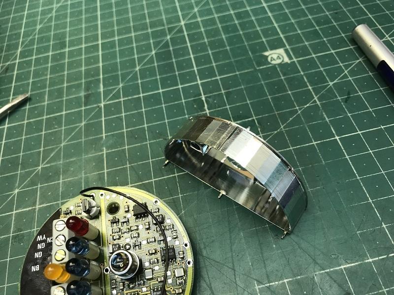

Now much of the circuitry of this PCB is hidden under a screening can, and to progress it's going to have to come off. Only held down by seven through PCB tags neatly soldered on a very crowded small PCB  :bugeye:
Digging out my 'electric pump' de-soldering sucker it looked ridiculously big compared to the PCB, but with a delicate touch, a bit of flux, and adding some low melting point solder to the last persistent lug eventually got it off with no apparent damage.
Now I was rather fearful that the cover might conceal some encoding / decoding logic but in fact it all seems to be analogue OP Amps comparators etc so the full chip count is as follows:
Reverse Side:
LM78L05 (2 off): +5 volt regulator
ICL 7660 : Negative rail generator (should be -5 is -3.5)
LM393M  : Op Amp / Voltage comparator
DS8921M : Differential output driver (gives SIGNAL and SIGNAL
Plus 3 off SMD transistors
On the Front Side (under the screen):
OSD 15-3TRB : IR receiver
LM833 (2 off)  : Audio Op Amp
LM311M          : Voltage Comparator
AD848             : High Speed Op Amp
Plus 4 off SMD transistors
On the front side (not under the screen) ZTX 450 discrete transistor

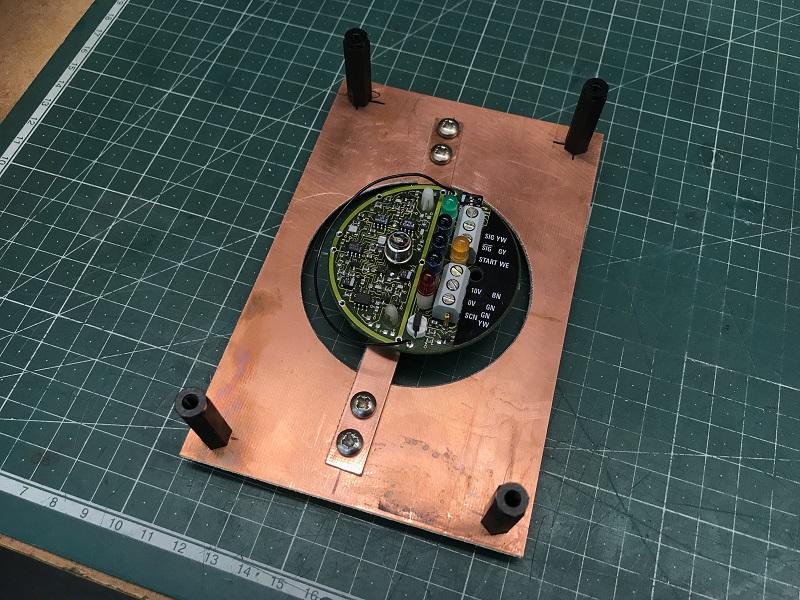

To go much further I'm going to have to make a rig to mount the circuit so that I can safely probe it without doing damage, and also to make up an IR transmitter that sends a train of pulses so I can trace through the circuit.
If indeed one of the circuits is pulling down the -5 v it's going to be a pain to find as the LM833's, the LM311, The AD848 and the LM392 all take the negative rail voltage.
Won't be much more progress today as I have to play host to some guests arriving this afternoon.

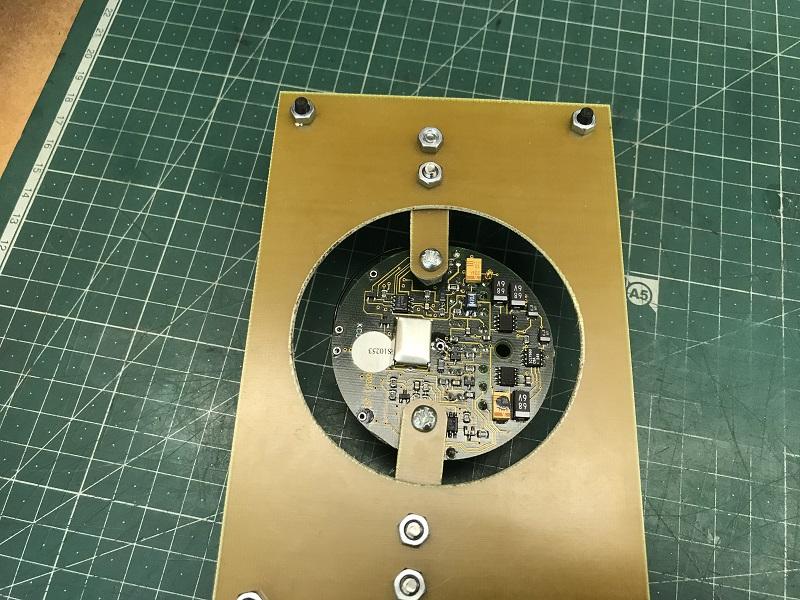

« Reply #401 on: September 14, 2018, 09:01:53 AM »
I made up a mounting jig to stop the PCB skidding all over the desk when testing !

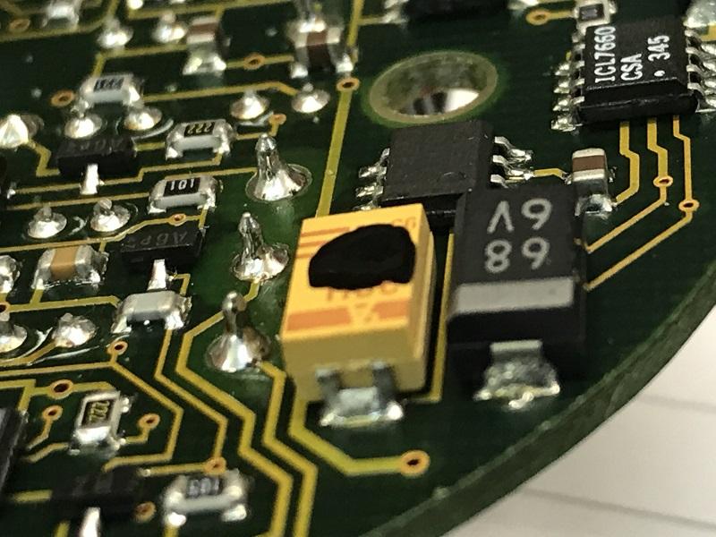

  • Posts: 9071
« Reply #403 on: September 16, 2018, 07:30:38 AM »
OK so the problem is to try and work out which component or components is drawing too much current from the negative rail, and dragging it down from -5v to -3.5 volts.
I hit on the idea of looking at the board with my infra red thermometer - now it's by no means easy to be sure exactly where it is pointing, but looking at each integrated circuit the hottest was the ICL7660 - not surprising as we know it's probably over loaded. (I think that it can supply  about 20 mA) - it was running at about 39 degrees whereas the other ICs are at about 26-28.
But scanning the board in general one of the capacitors was running at over 40 degrees - is this our trouble maker? It's the 68 uF / 6 volt one next to the famous one with the paint blob and is the one used by the ICL7600 to do the voltage inversion.
It's position on the PCB and (relatively) large size allowed me to remove it with a fine tipped soldering iron and substitute an axial one for testing.
. . .so what was the result, nothing, zilch, nowt  - voltage remains at -3.5  :bang:
Never mind, it was a good idea. Carefully put the SMD capacitor back and scratch your head a bit more  :scratch:
Now if this was a conventional sized board with DIL I/C's I'd carefully lift the -VE rail input legs on the I/C's one by one and monitor the voltage on the negative rail to see who's causing problems - not really possible at this scale.
Another technique is to construct a probe with two very sharp tips close together but insulated from each other, and with it connected to a sensitive millivolt meter, probe the PCB tracks leading to the supply pins in question. The tracks have a finite (but very low) resistance so a small voltage is developed across the probes that is proportional to current. Brilliant in theory but not too good at this scale as you can't really get at the PCB tracks.
. . . a bit stumped at this stage  :scratch: :scratch:

Offline PK
  • Posts: 369
« Reply #416 on: September 28, 2018, 06:50:51 AM »
So the first thing you do when someone says: "Can you take a look at this for me, it's doing X,Y, and Z",  is fire it up and check that its actually behaving that way and there are no other obvious faults.
[youtube]nAOIn5LwKaw[/youtube]
Next we took a look at the negative voltage reg. It is used to generate -5V for the amplifiers and comparitors under that shield.
It looks like the 6.8uF cap on the screen is the output capacitor for this reg. It isn't, it's a 68uF cap a bit further away. This was removed and replaced but the voltage was still low.
The reg chip was removed and replaced, and the voltage dropped a bit lower to 2.7V!  I guess they don't make 'em like they used to.
I lifted the output pin and connected a small cap to ground and the voltage shot up to 4.9V So it's probably something overloading the reg.
Out came the thermal camera (and yes, I forgot to snap a pic) and one chip in particular was running quite a lot hotter than the others. An LM833 audio amp.  Now this may still be a red herring, as audio amps sometimes run hot, and often drive low impedance loads... In any case, it was asked to leave the premises and we now have a -4.7V rail.
I think we'll just order every chip on the board. There's no unobtanium in this thing...
Oh, and if all this talk of ripping components off expensive PCB's generates anxiety. Don't worry, it's not my PCB.. :thumbup:

  • Posts: 9071
« Reply #419 on: September 28, 2018, 07:23:54 AM »
Yikes PK  :bugeye:
. . . but progress - good stuff. Look at the smd transistor that has an arrow scratched pointing at it on the semi-circular trace that the can sits on - that's the one that looked to be s/c collector base, but it could be the op amp it's connected to which is an LM833
That's an impressive magnifying set up that you have there  :thumbup:

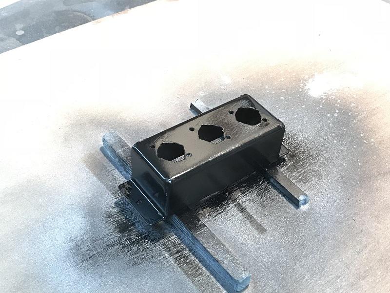

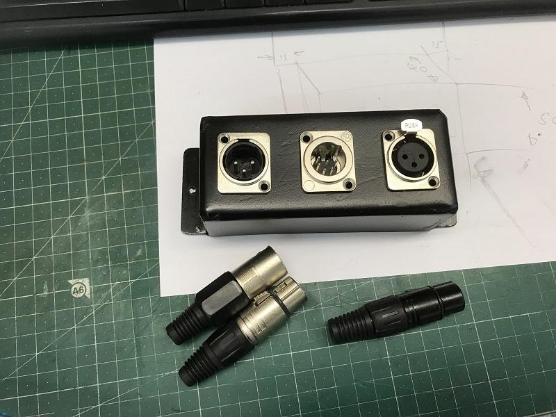

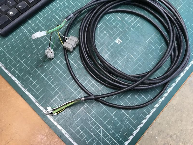

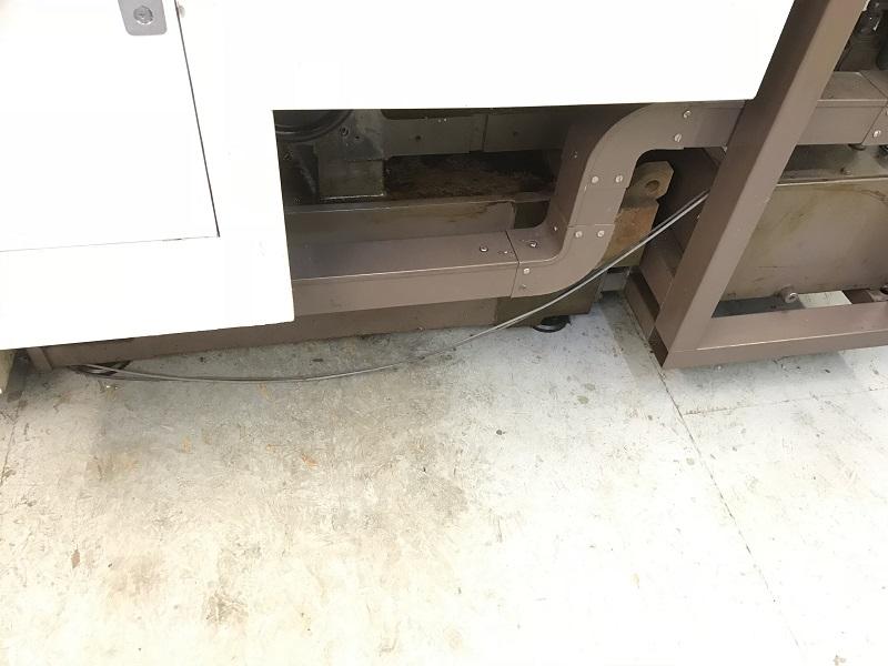

  • Posts: 9071
« Reply #422 on: October 02, 2018, 03:17:57 PM »

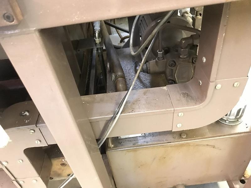

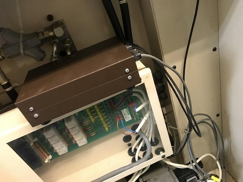

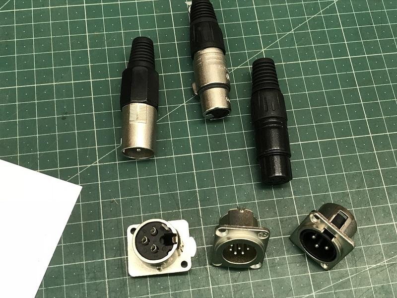

In anticipation of PK working miracles with the Renishaw Probe electronics, I decided that it was time to plan a re-do of it's wiring. As I think I've previously mentioned, it seems to be a field upgrade with the necessary wiring just draped any old place that they could get it. The MI-12 interface unit is hard wired in, and just sitting on a shelf.
I wanted to get the wiring in existing trunking while the lathe cabinet sides are off, and wire the MI-12 interface via plugs and sockets. It needs a 24 volt supply from the main I/O supply in the rear cabinet (2 wire plus screen), an output to the appropriate card in the Siemens 820T controller (again 2 wire plus screen) and a multi-core to the OMM that PK has on the other side of the world (5 wire plus screen)
I chose XLR style connectors as I already had two of the three, arranging that the 3 pole ones were opposite gender to prevent them being able to be confused.
Initially I'd intended to mount them on a bit of the trunking in the cabinet where the MI-12 sits, but then decided that it would actually be easier to mount them in a separate box which then could be fixed to the trunking as an independent item.
So, first let's see the problem
« Last Edit: October 02, 2018, 04:00:20 PM by awemawson »

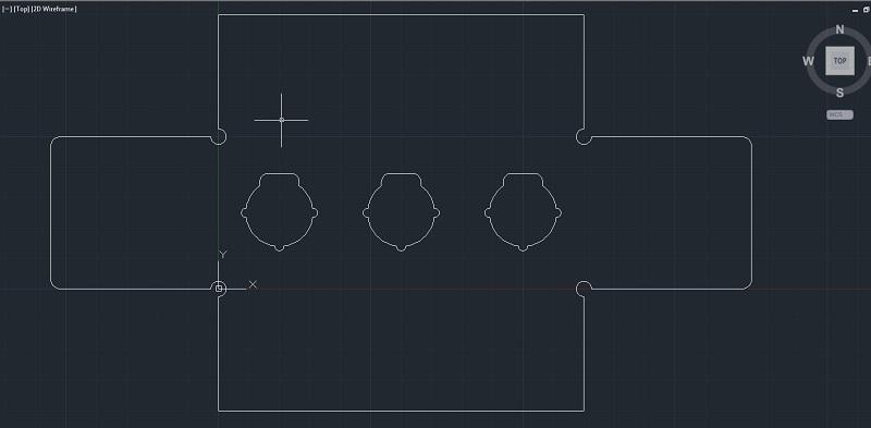

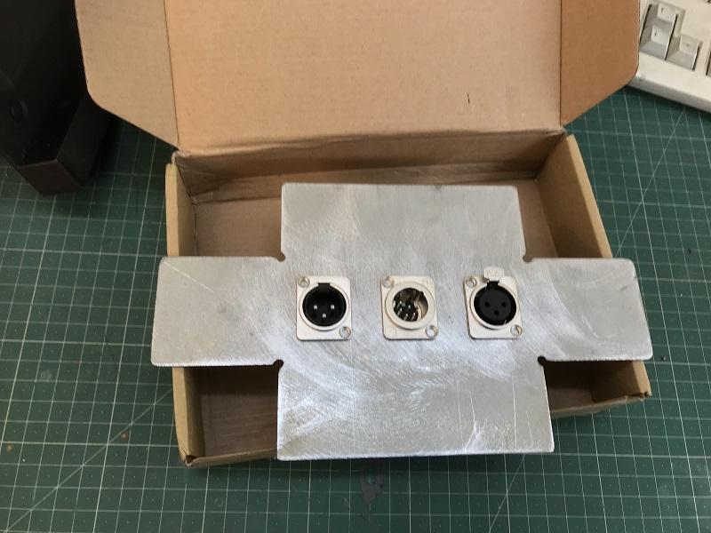

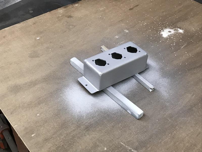

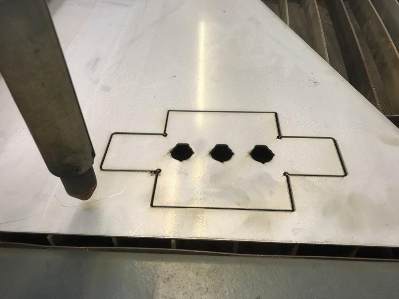

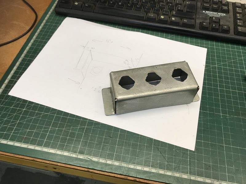

  • Posts: 9071
« Reply #423 on: October 02, 2018, 03:25:24 PM »

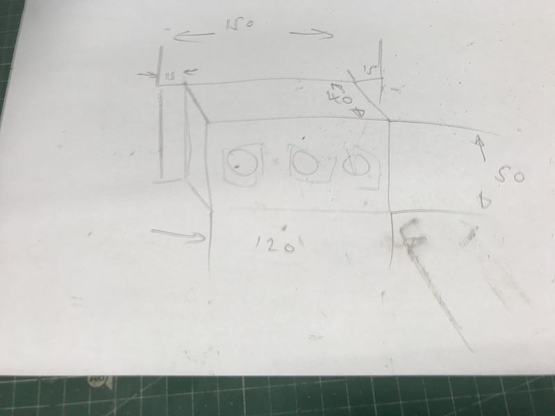

So a quick pencil sketch, rapidly followed by an Autocad drawing whose DWG file was processed by SheetCAM to give me a CNC-Plasma ready file to cut.
I used 2 mm plate, in retrospect I think that this was a bit OTT, and 1.5 mm would have been a better choice as it would have bent more crisply in this small size, but it's come out OK
Having cleaned up the cut profile with a sanding disk, and made sure that the connectors fitted their odd shaped holes, I then bent it up, and soldered the corners. After a bit of a clean up it got a coat of zinc rich paint followed by a coat of satin black.
So it's now all ready to fit - I will probably run new cables rather than disturb the old at this point, as when the OMM returns I don't want the uncertainty of replacement wiring muddying the waters when it comes to testing - anyway the existing stuff is a bit mangled in places (although intact)

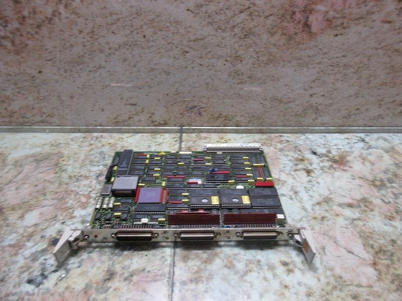

« Reply #424 on: October 04, 2018, 11:24:11 AM »
Well a bit of progress today. A couple of weeks ago a CPU card for the Sinumerik 820T  controller popped up on eBay in the USA at an attractive price - usually people ask silly money for them - whether they sell or not is another matter!
Anyway this one was just about affordable, and it was from a dealer that I'd actually bought parts from before when I was breathing life back into the Traub lathe. Why do you need another CPU card? Well probably I don't and won't, but if I do you can guarantee the only ones will be priced in telephone numbers ! The real reason though was that there is just a faint possibility that the M19 / M20 spindle orientation issue could be CPU based, after all it not only is running the code and handling the interrupts, but also has some of the RAM on board. So as a diagnostic aid, and then ultimately as a shelf spare it was worth it.
So today (having paid the VAT etc on line yesterday) Parcelforce in the shape of Adrian our local man, delivered it. With no more ado I pulled out the original CPU card, put in the new and fired up the machine - ah well no - she's NOT firing up. Oh blast - dead on arrival - never mind - Paypals' 'pay after arrival' has it's uses I thought.
Original CPU card re-installed - oh HECK - shes's not firing up - it's blown something up.  :bang:
No, calm down chum, there's RAM on the card, is that part of the battery backed parameter stuff? Sure enough pressing the magic 'Eye' key on the controller when powering up got me into the re-load 'Initial Clear' mode - perhaps it's NOT D.O.A. after all. So new CPU put back in, and again into the 'Initial Clear mode by pressing the Eye key, and I started the long winded rigmarole of reloading all the back up files.
I'd just got to a critical stage when the wife needed urgent help - sheep issues - (there are always sheep issues!) - one with 'fly strike' - one limping - loads of carrying hurdles about, penning up sheep and getting thoroughly filthy - actually it was a nasty fly strike occasioned by a partially torn off horn and consequent blood on a Jacobs lamb and did need urgent treatment.
OK - wash the maggots off my hands and get lunch  :bugeye: (ham omelette) then back to the re-loading of the controller. All went OK, all functions work except of course the M19 /M20 spindle orientation. It was a pretty faint hope, but at least the CPU card has been eliminated and now I have a shelf spare.
