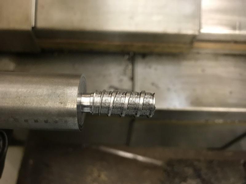

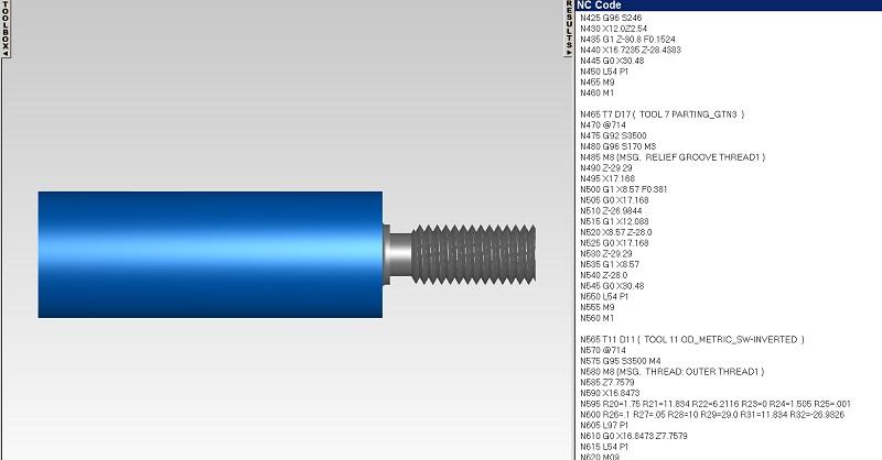

Although when I set the machine to cut a thread 'in the air' it appeared to be cutting correctly, now I've been brave enough to cut metal (and actually mount a threading tip, and measure it's offsets, it is obvious that all is NOT well. It looks to me as though the spindle rotation is not synchronised to the Z travel. Presumably the controller should wait for a reference point in the rotation before firing off the Z movement whereas the two look to be asynchronous to me.
I'd not be a bit surprised to eventually find that this is tied to the M19 spindle orientation problem that I'm having. Diagnostically it might just be a blessing in disguise, but then it might just be a pain in the neck  :lol:
This is supposed to be an M12 x 1.75 mm pitch thread !

« Reply #359 on: September 06, 2018, 03:14:09 PM »
Is it supposed to be a  LH thread?
Online awemawson
  • Posts: 9071
« Reply #360 on: September 06, 2018, 03:51:05 PM »
Nope !
On the simulation it is distinctly Right Handed  :scratch:
If you notice, the Z travel must be accelerating cutting from the chuck outwards as revealed by the increasing 'thread' spacing

OK I finally think that I've gone MAD  :bugeye:
Someone please check my logic here:
A/ The program is cutting a normal right handed thread of 1.75 mm pitch, using an INVERTED tool located BEHIND the work and the spindle running
     CLOCKWISE viewed from BEHIND the chuck
B/ This is exactly akin to a normal manual lathe configuration if you imagine the tool swinging round the work 180 degrees to be located in the normal
     manual position in front of the work. Of course this movement has also cancelled the inversion of the tool.
C/ So as with a manual lathe, a right handed thread is cut TOWARDS the chuck, the tool withdrawing on the return cycle
So why, dear forum members, please tell me (to preserve my sanity!) is the tool engaged in the work on the travel AWAY from the chuck, and disengaged on the travel TOWARDS the chuck.
I closely monitored the threading progress, watching the controllers display of 'feed rate' - now when threading it is using 'G95 feed per rev' and the display shows 1.75R ie 1.75 mm per rev BUT it's showing this on the travel TOWARDS the chuck when the tool is DISENGAGED, and about 1000 mm per rev on the travel AWAY from the chuck when the tool is ENGAGED  :bang:
So basically the tool X movement is reversed in this situation - but travelling to the beginning of the threading cycle it gets to the right place so is not reversed.
. . . argh . . .I need a coffee  :coffee: :coffee: :coffee:

I've seen this..... oh bugger, where have I seen this?.... I vaguely remember a discussion about threading with rear toolposts in the days of turbocnc...
If I'm right then it's a CAM thing....Is there an option in your CAM package for front or rear toolposts?
How does X work on your machine? not inverted?....
Maybe a different canned cycle or a parameter for rear posts in a machine controller able to cope with different machine configurations?

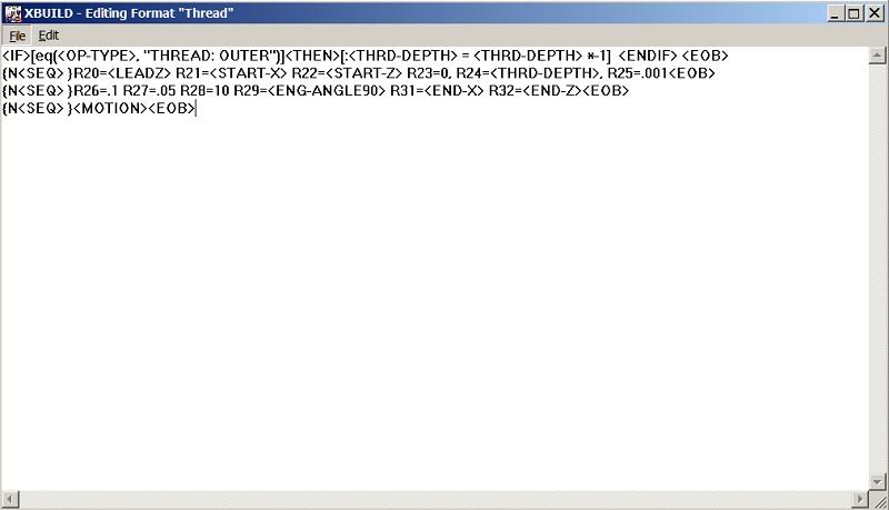

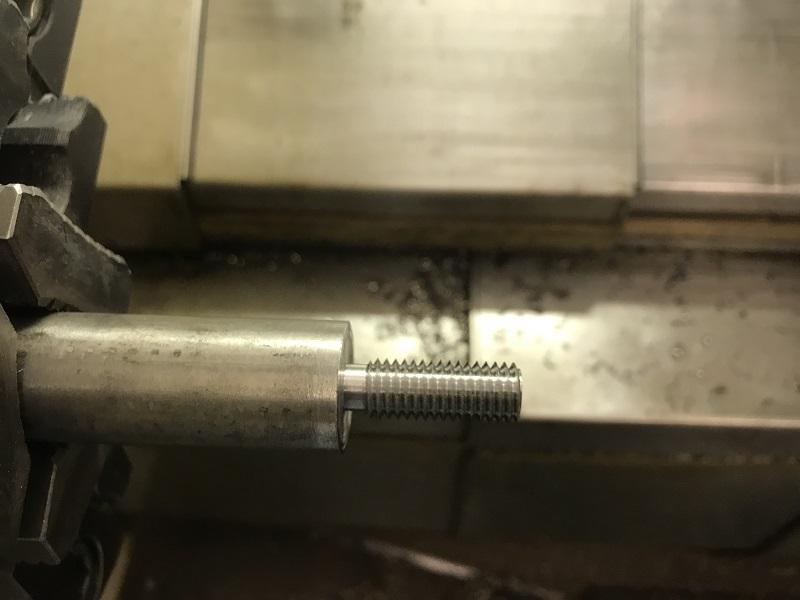

SOLVED  :clap:
The post processor is producing a positive depth of thread not a negative one. I have manually altered the produced program shoving a minus sign in and produced a decent thread.
I've not  worked out yet why the PP is doing this - it might think it's doing an internal thread - I'll investigate after lunch

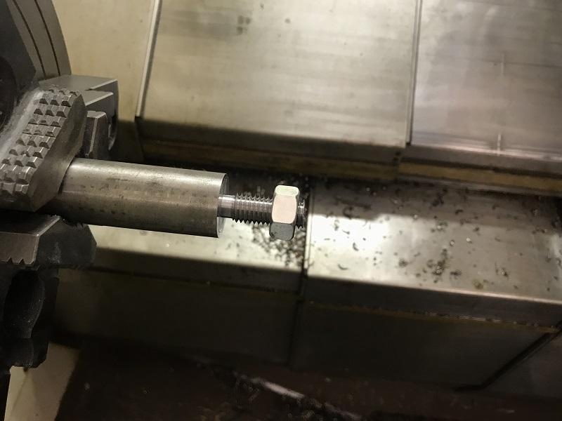

No Russ I don't think that is the case - remember that your frame of reference has rotated. Minus X travel is into the work piece in each case. In all cases the work piece diameter decreases as the tool approaches the axis of rotation.
So the test piece passes the 'will a nut fit' test with flying colours, and also the repeatability test.
As for altering the post processor, when the cycle for threading is generated, the PP doesn't know if it is threading internally (so positive thread depth) or externally (so negative thread depth) and I can't logically derive which case is in operation from the parameters passed from the program. You can't even enter a negative depth of thread where you define the feature, as it slaps your wrist!
One comfort from all this is I'm more than ever convinced that the M19 spindle Orientation issue has to be a software / enabling bit, as this threading is using spindle orientation at a great rate of knots quite satisfactorily.

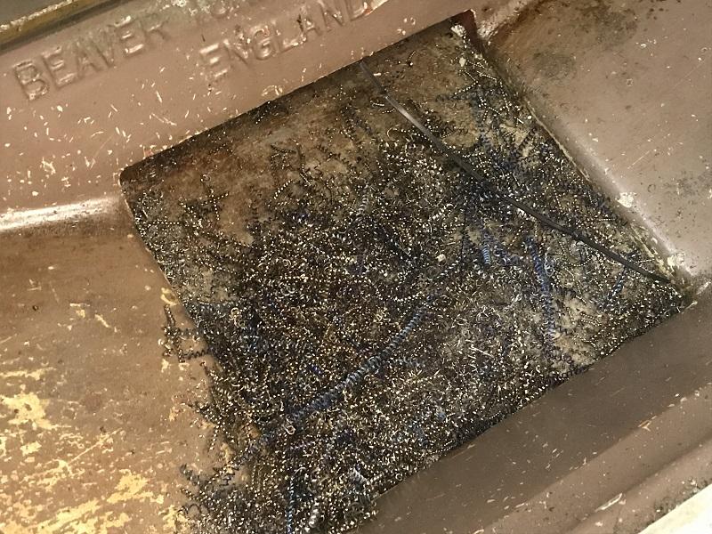

All this testing is producing masses of swarf - I need to get the covers back asap not only to contain it, but also to allow me to use coolant.

After much digging about in the inner workings of the FeatureCAM Post Processor I managed to prove that the program was outputting an 'absolute'  depth of thread rather than a 'signed' value as required by the Sinumerik 820T control. But I also realised that actually I could determine if when the threading cycle was entered it was an internal thread (requiring a positive depth), or an external thread (requiring a negative depth) by testing an internal variable called <OP-TYPE> that I discovered.
After finding that, it was a simple matter of multiplying the thread depth <THRD-DEPTH> by -1 for external threads, and the problem was solved. Dead easy in retrospect, but it took a while !
