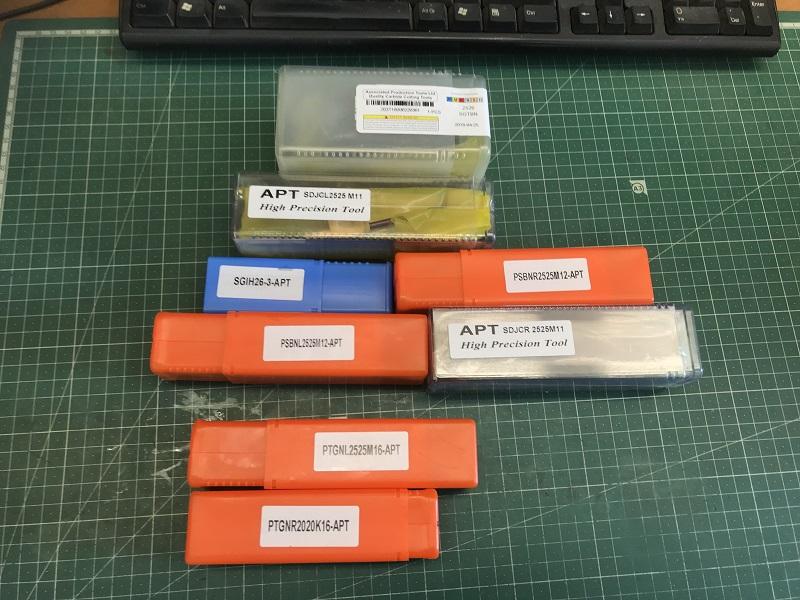

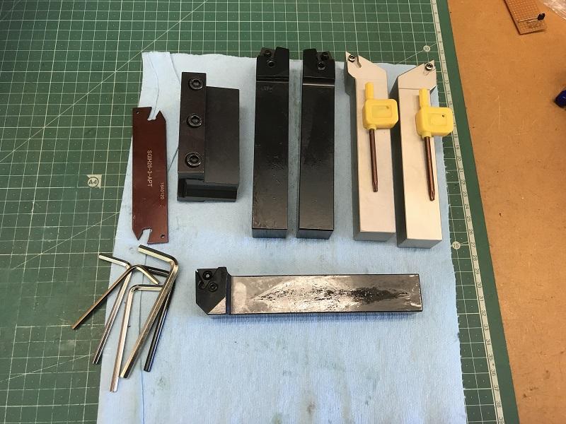

The another delivery of Tooling arrived from APT. I thought that I'd ordered a left and a right handed version of tooling for TNMG1604 (triangular) inserts, for SNMG1204 (square) inserts, and for DCMT11T3 (diamond) inserts, but it seems that I cocked the order up and the right handed TNMG one was infact for a 20 mm square shank  :bang: Never mind it'll go on the Colchester Master and I've re-ordered the correct item

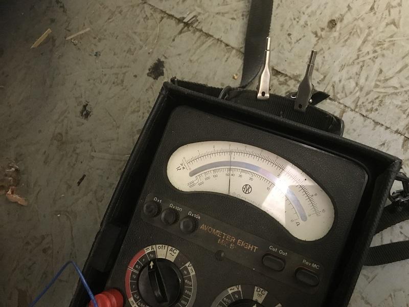

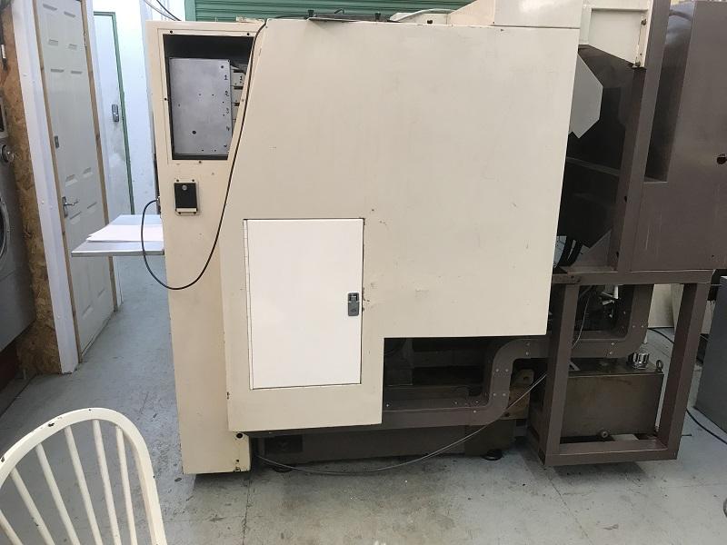

I've been having trouble with the tail stock. It is clamped to the bed by spring loaded clamps biased in the 'clamped' direction, and un-clamped by two small hydraulic cylinders. M51 comand clamps it, and M52 unclamps it. In addition there is a pressure switch on the hydraulics that reports the clamped state back to the controller.
The actual tail stock barrel is advanced hydraulically by an M11 command, and retracted with an M12. Despite me issuing an M51 command, the controller got all upset reporting that the tail stock was unclamped, and faulted out if I issued an M11. Fairly obviously something to do with the pressure switch, and eventually traced to intermittent contacts. Almost certainly due to the machine sitting unused for many years

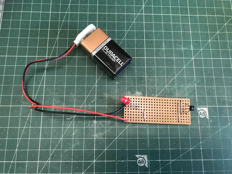

Now it's a sealed unit, so no physical cleaning or squirting contact cleaner was possible. Remembering back to my days with relay logic, most are arranged that the contacts rub a little as they open and close to remove any oxide that forms, and the 'wetting' voltage and current are important to keep the contacts low resistance.
OK maybe I can increase the wetting current - I daren't increase the voltage much as I don't know the contacts ratings. A quick test with the AVO showed me the controller input circuit was passing a mere 15 mA when the contacts decided to close.
Now I had already written a little diddy program that clamped and unclamped the tail stock every second in an attempt to clean the pressure switch contacts, things had improved but about one in 35 closures was unsuccessful.
Time to roll out the big guns - I wired the contacts to my trusty current limited lab power supply, set the volts to 30 and the current limiting to 250 mA and ran the program. Initially still problems but after about 20 seconds - hey we have reliable contacts - this rather off the wall method actually works :ddb:
Lab supply put to bed, contacts returned to the controller to play with, and let the little program run again, which it did faultlessly  :clap:

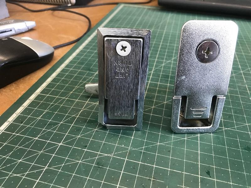

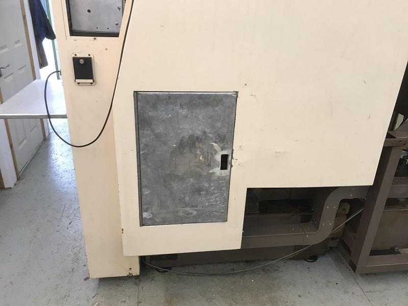

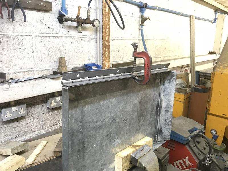

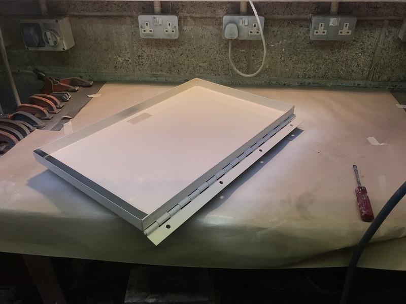

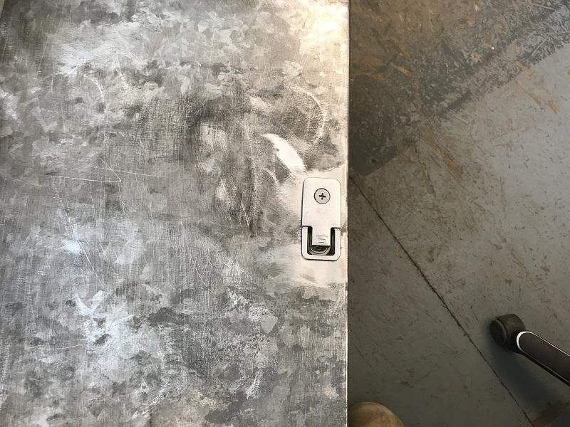

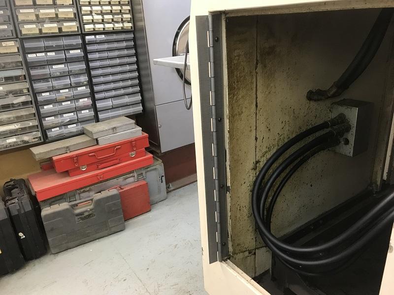

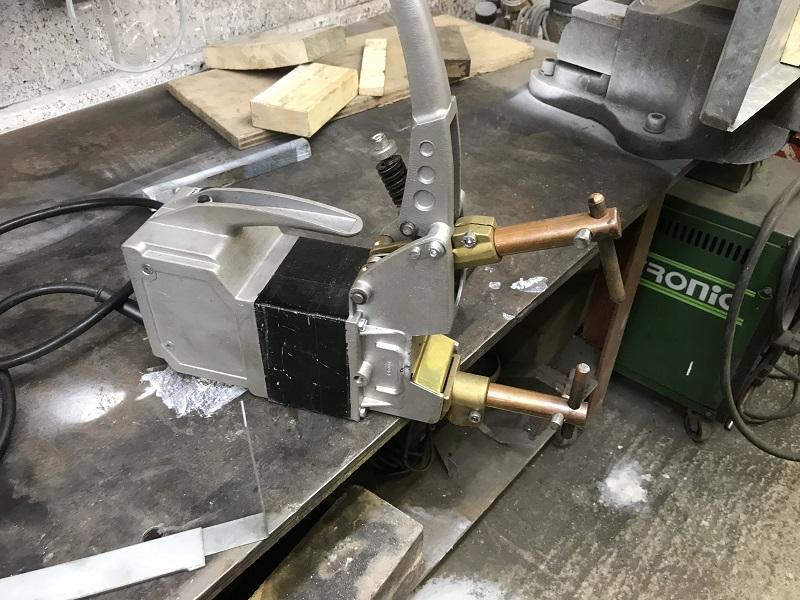

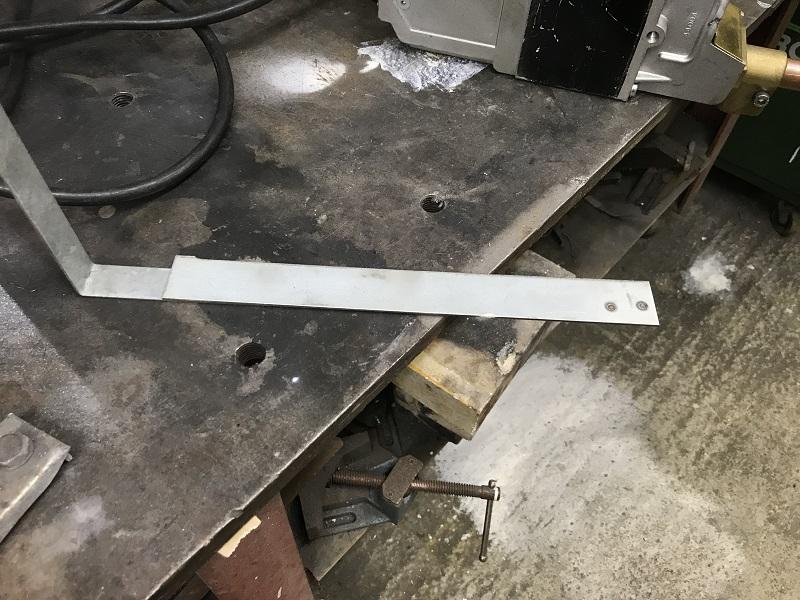

At last today the heavy duty piano hinge arrived for the Tail stock Door, so a suitable length was cut off, I picked up the four tapped M6 holes in he door frame and drilled matching 6 mm ones in one leaf of the hinge. When I'd checked that they aligned OK, I opened the hinge holes to 8.5 mm to get latitude for adjustment when the door is swung.
After a test fitting of hinge and door balanced together in the frame, I then spot welded the un-drilled leaf of the hinge to the door, gave it all a good clean up with IPA, and sprayed the inside RAL9001 to match the machine.

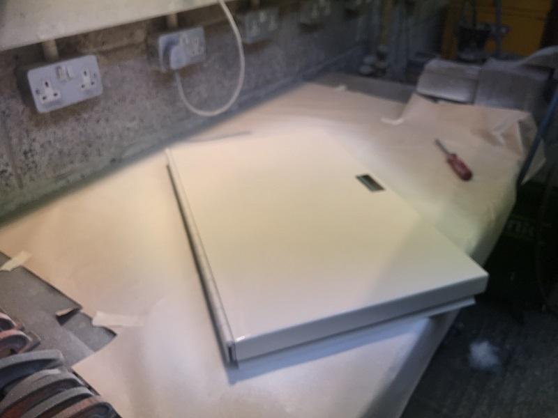

The weather is distinctly cooler and it's raining today, so although the paint was 'touch dry' after an hour I left it a couple of hours more before inverting it to spray the outside.
The Postman brought the replacement lathe tool that I had wrongly ordered as a 20 mm shank rather than the 25 mm that I'd intended - so when I'm brave I can start tooling up.

So to restore my sanity I've swung the Tail stock Door now it's paint is a bit harder. Paint is a bit lighter than the original, but will have to do.

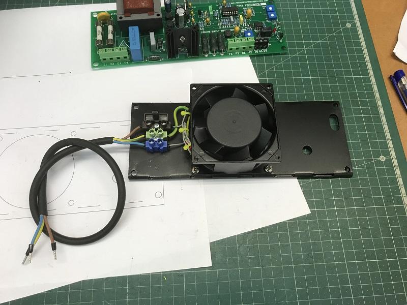

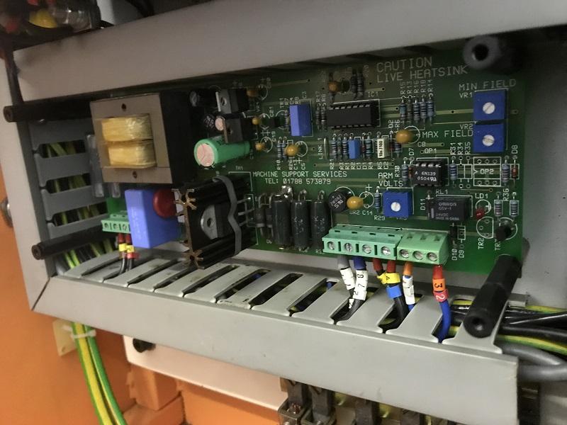

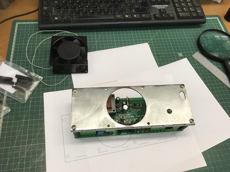

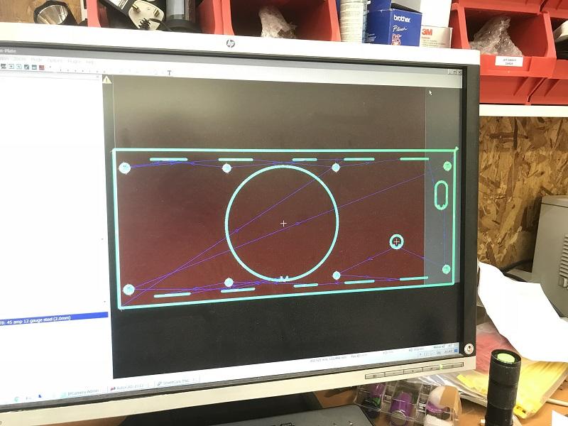

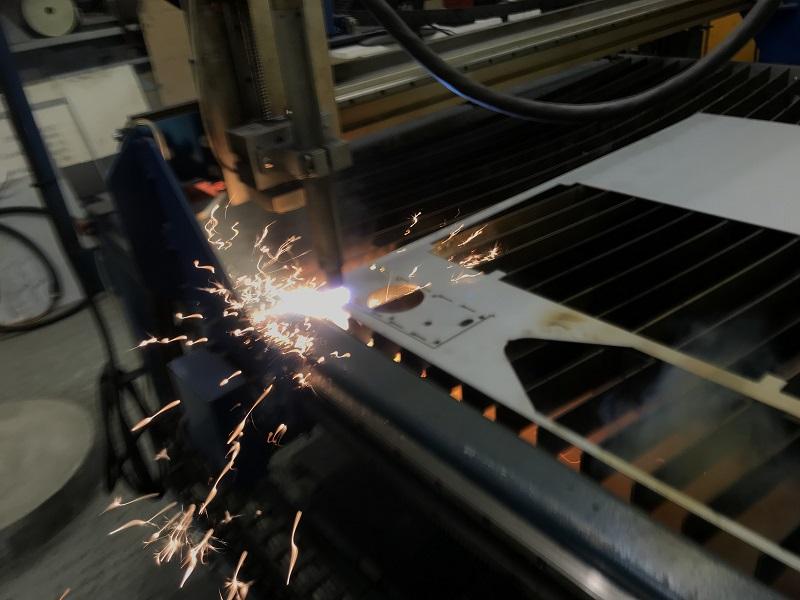

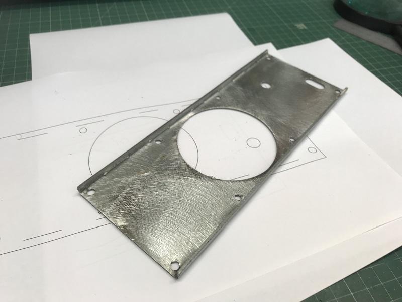

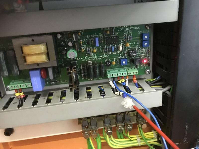

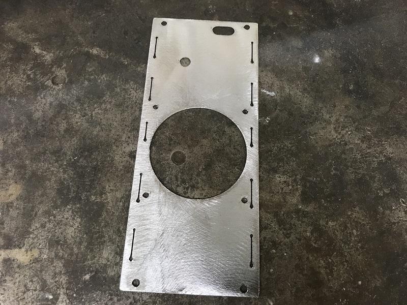

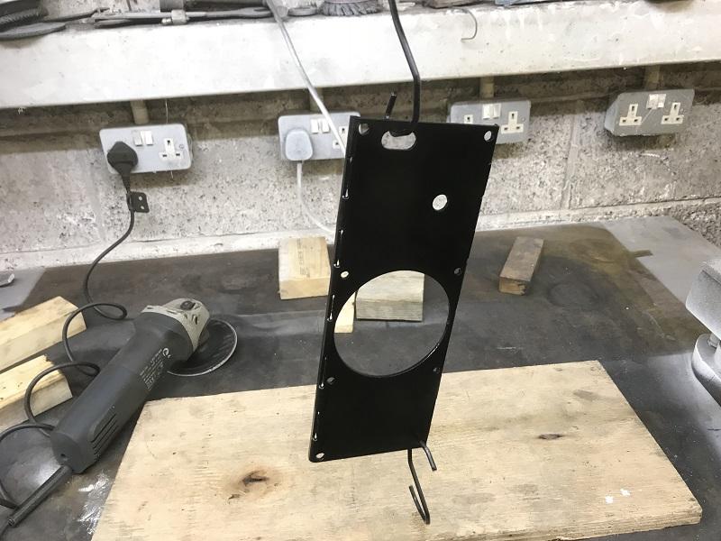

I decided that at least I could easily solve the issue with the FXM-3 Field Coil DC Drive Card overheating by adding a fan - actually easier than making a larger, but remotely mounted heat sink, which was option 2. The heat sink is up at 415 volts so needs to be away from fingers!
240 volt 80 mm axial ball bearing fan ordered from RSComponents along with some M4 nylon stand off pillars arrived this morning while I was pushing earth about with the JCB803. This evening I drew up a simple mounting plate in AutoCAD which via SheetCAM was ported to the CNC Plasma table and cut out of 2 mm steel plate, edges bent up to form a flange for rigidity, and a test assembly performed.
All looks good, so it got a coat of Satin Black from a rattle can, and I'll probably fit it tomorrow if time permits.
I praise the day I rescued that CNC Plasma Table - oh boy does it make this sort of thing easy  :clap:

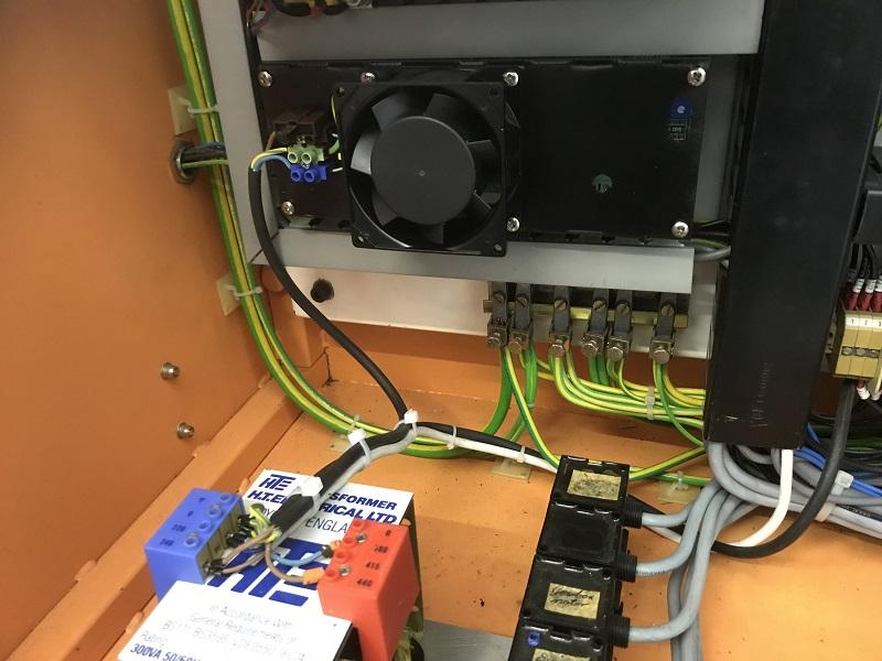

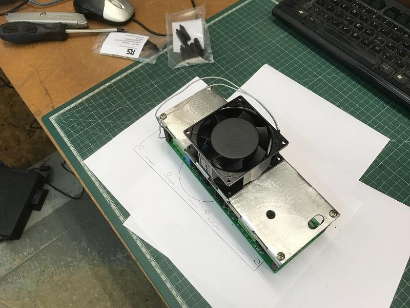

So having picked up a load of grass seed from the merchant early this morning, I was able to get on and fit the fan.
First I completed the assembly, incorporating a fused terminal block, then I re-set the field current back up to 3 amps. This involves intercepting the FXM-3's output and inserting an Avo. Pot duly tweaked. Then I replaced the original card mounting screws with the nylon pillars and wired it up.
All very straightforward. I can't now point my I/R thermometer at the Thyristor heat sink, but from the flow of air over it I'm sure that it's fine  :scratch:

So Andrew is the cooling fan on the FXM-3 a part fix or can you run the motor at full current now..? I've never seen one of Mikes boards but looks very similar to the standard issue FXM-3..are there any advantages using Mikes newer board?
« Reply #298 on: August 15, 2018, 01:04:59 PM »
Mike told me it was designed for a maximum of 3.5 amps, so it is on the limit with the size of motor in this beast. But he also told me that of the boards he made, he only had transformer failures, never the thyristor. So having re-set it at 3 amps it's still on the conservative side of the spec, but I far prefer electronic to run cooler than hotter!
The redesigned board is simplified, has only one transformer, and uses a relay to indicate 'OK' rather than semiconductors. I've had the comment from someone else who repaired Beavers that the new cards were more reliable than the original.
