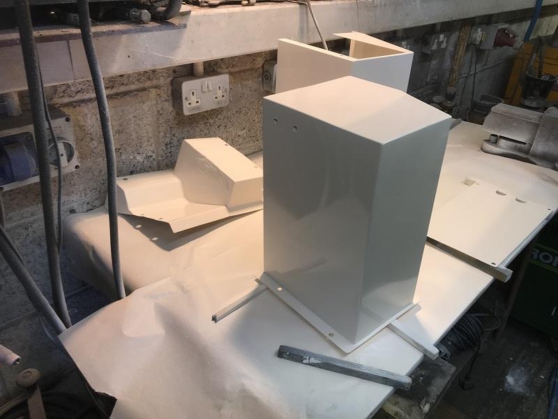

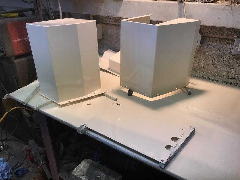

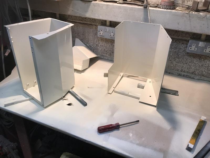

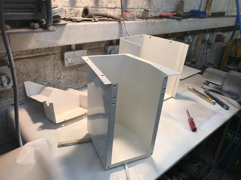

Overnight the paint had hardened sufficiently to flat down the blemishes and when it was delivered spray the inside and undersides with the RAL9001 creamy colour, which seems to be quite a good match to the original - just looks cleaner !

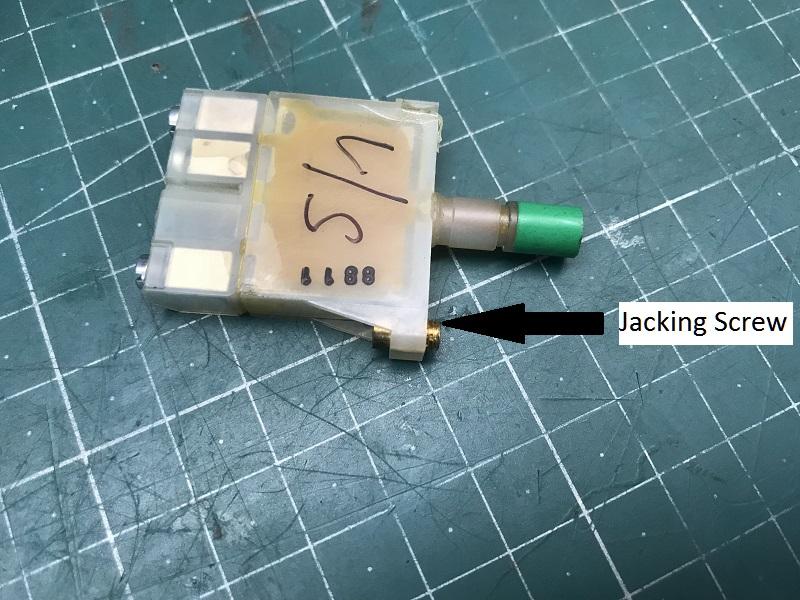

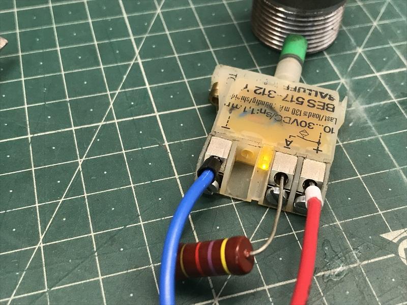

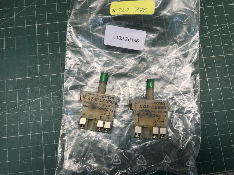

Then despite the replacement proximity switches having arrived from Germany I earned some brownie points taking the wife to Rye for a coffee and look at a water sports place she wanted to investigate for grand child entertainment.
By the time we returned the paint had dried sufficiently for me to turn the bits over and spray the tops and outsides (Who said I'd calculated that  :lol:  ) and before supper I was able to re-assemble the replacement proximity switch into the four way block and test all four ways.
I'll give the tinwork one more coat on the outsides tomorrow as this paint is going on at only 1.5 thou per coat according to my film thickness meter.
This version of the switch has a nifty tell tale yellow LED inbuilt - if the other had they don't work any more ! One feature that I hadn't appreciated was that the mounting screw goes co-axially through a jacking screw, used to align the front faces of the individual elements to the housing.
Then it was a case re-fitting the four way block (I set the gap to 0.5 mm as the proximity sensors range is 0.0 to 1.1 mm) and of re-threading the cables up the ducting, re-making the connections and giving it a soak test changing tools and moving about. At the time of typing it's been running 20 minutes, so early days - fingers crossed.

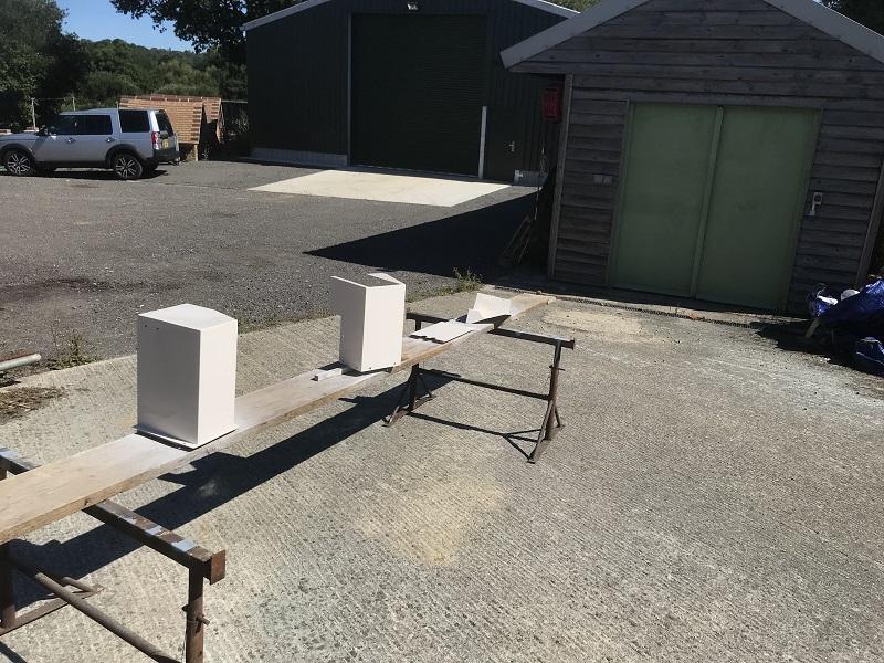

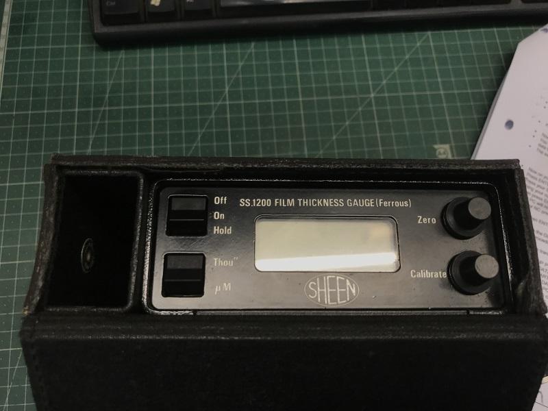

What film thickness meter are you using. I presume you are  using wet paint, not powder coat.
Jerry
  • Posts: 9071
« Reply #252 on: August 02, 2018, 07:30:06 AM »
Jerry, it's a rather nice device made by Sheen that I must have bought yonks ago. I'm ashamed to say that when I dug it out of the cupboard the 9 volt battery was dated 2004 - I always scratch a date on batteries in equipment when I install them - fortunately this one hadn't burst and actually was still measuring 8.5 volts, but obviously I changed it.
Yes it's a wet paint system. I gave the items their final outside top coat this morning out in the sunshine as it was a relatively still day.

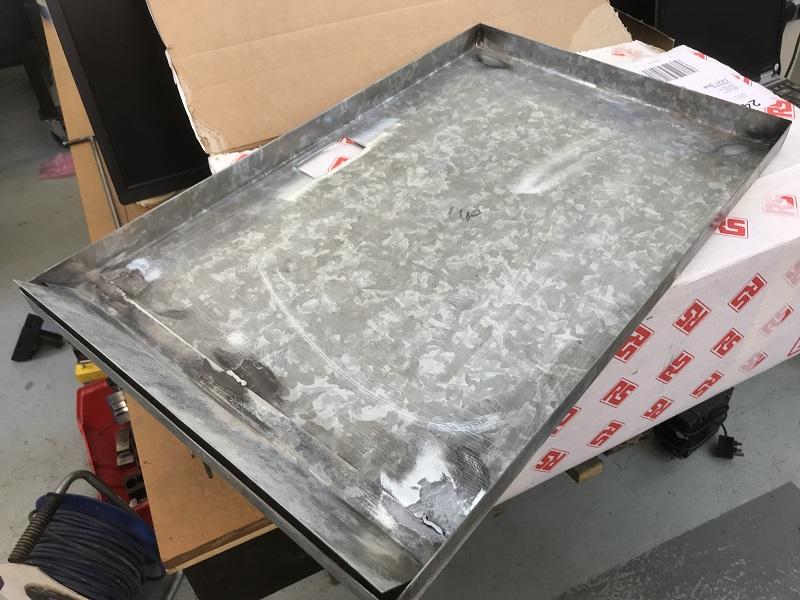

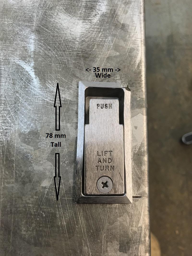

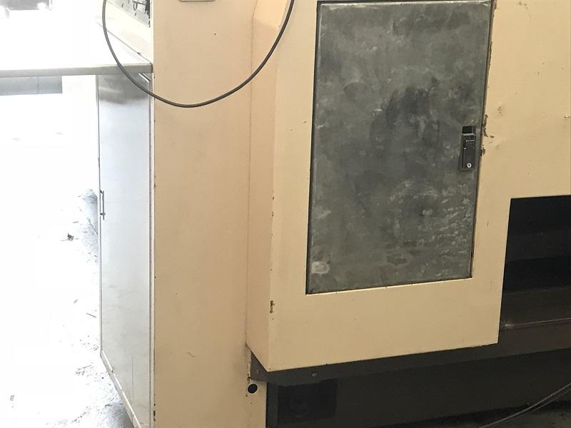

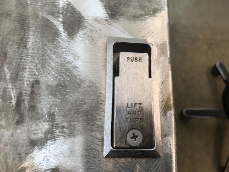

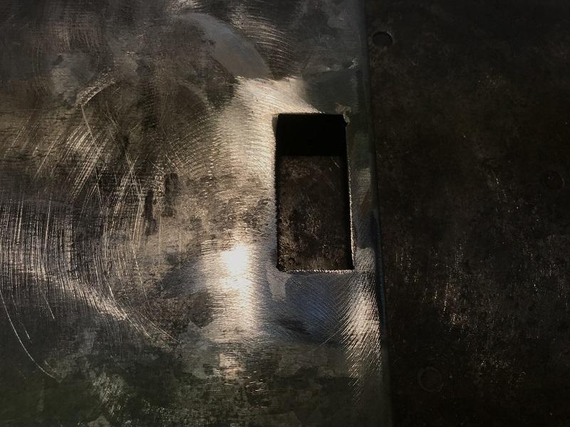

Then I went to more physical things for a bit of sanity. The door on the tail stock end that gives access to the tails stock handle has obviously had an 'issue' at some time, in that the tin work around it's opening was a bit bent, and the original door is missing. However someone has started to make a replacement, bent up from galvanised plate, with welded corners.
It's a bit of a rattly fit, the opening for the catch has been cut rather roughly, and it's been left somewhere damp, and not been painted. So the welds were heavily rusted. I attacked it with a rotary wire brush and sanding disk and it's slightly better now. The galvanising had gone all white and furry! I can't paint it until the piano hinge that I've ordered arrives - it'll need packing out side to side involving drilling holes, and that's best done before painting.

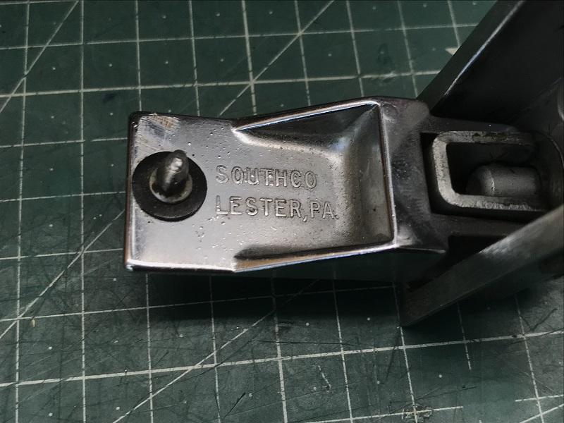

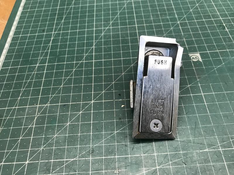

The catch - a Push and Turn from 'Southco, Lester, PA' must have suffered in the original accident, as it's body was badly squashed and a bit broken off one corner. They are still available, but it looks like this size (35 mm x 78 mm) has been discontinued. 21 x 45, 40 x 85, and 57 x 141 no problem - but not this one  :bang:
A bit of judicious bending got most of the squash out, but this is thin Mazac so is just waiting to break - it'll have to do !

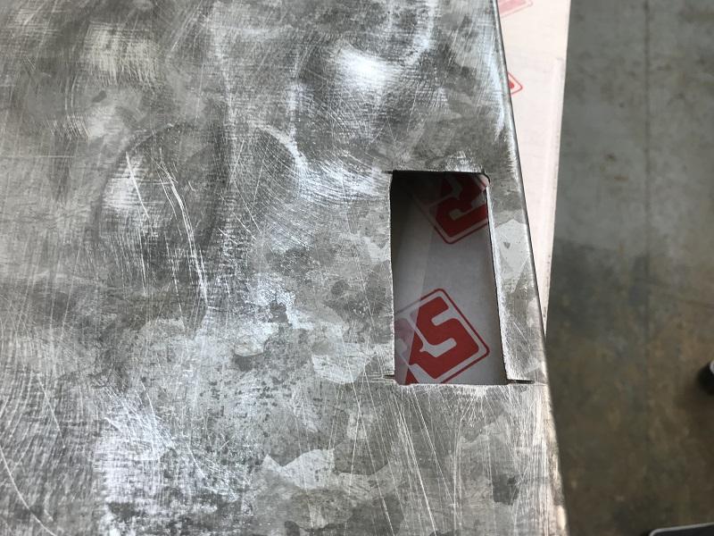

I decided to have another go at the cut out for the catch on the Tail stock Door. Remembering how well lead free solder works with galvanising I soldered up the 'over cuts' where he'd been a bit reckless with his cutting disk, then flatted it down with a sanding disk.
Now at least the remaining blemishes are hidden by the rim of the catch
