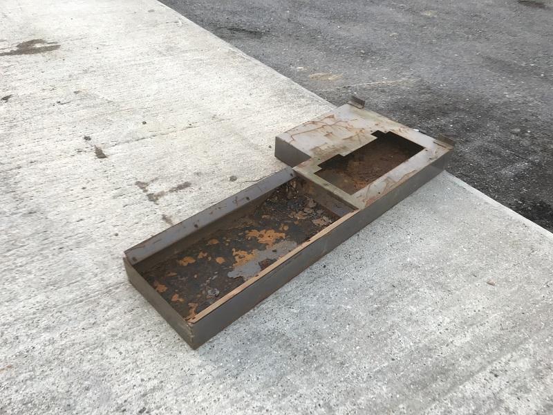

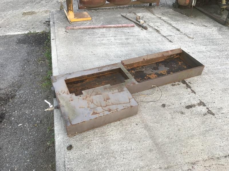

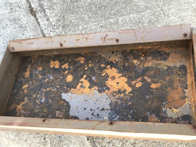

This is the coolant tank that slides under the machine and catches coolant from above. A pipe to a self priming pump sucks it back up and squirts it about at a great rate of knots.
Previous owner had left it outside to rust so it needs grit blasting and then spraying. Suggestions please for a suitable oil proof paint that will stand total immersion  for long periods.

TSuggestions please for a suitable oil proof paint that will stand total immersion  for long periods.
POR15 gas tank sealer maybe?  I used some of their rust paint on a rusty Ford floor pan & it did very well.  Dries glass-hard & seems to be very inert.  I would think their gas tank sealer would be even better.
Milton in Tennesee
Offline WeldingRod
  • Posts: 401
« Reply #81 on: June 18, 2018, 08:37:51 PM »
Truck bed liner.  Make sure they heat it before applying.  My father in law made a mobile steel pool lined with the stuff 10+ years ago.  Still going strong!

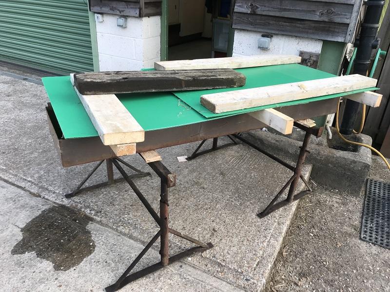

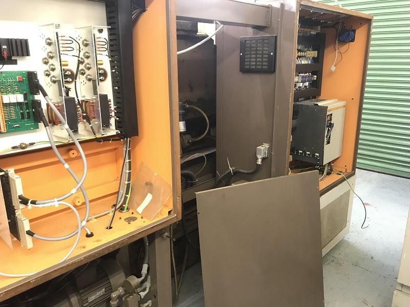

I realised that getting the coolant tank where it needs to be might be a bit of an issue, as the workshop is a bit cramped now (!) so I made up a bit of wood to act as an analogue of the tank  - much easier and lighter to manipulate - and in fact there is no problem.

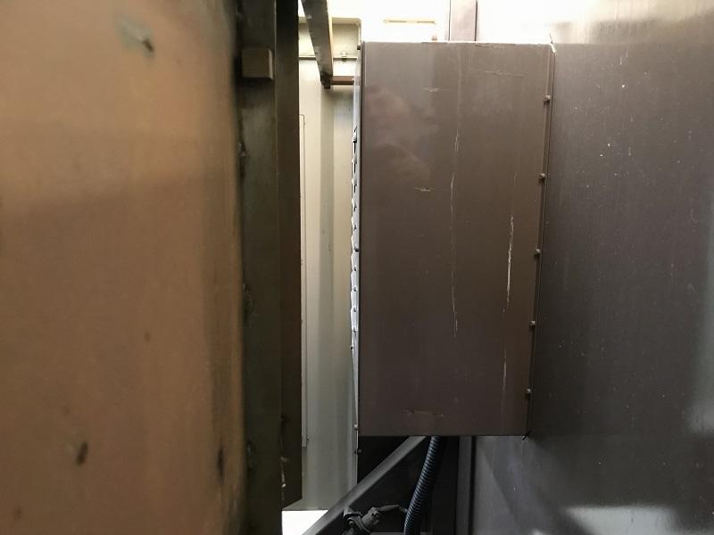

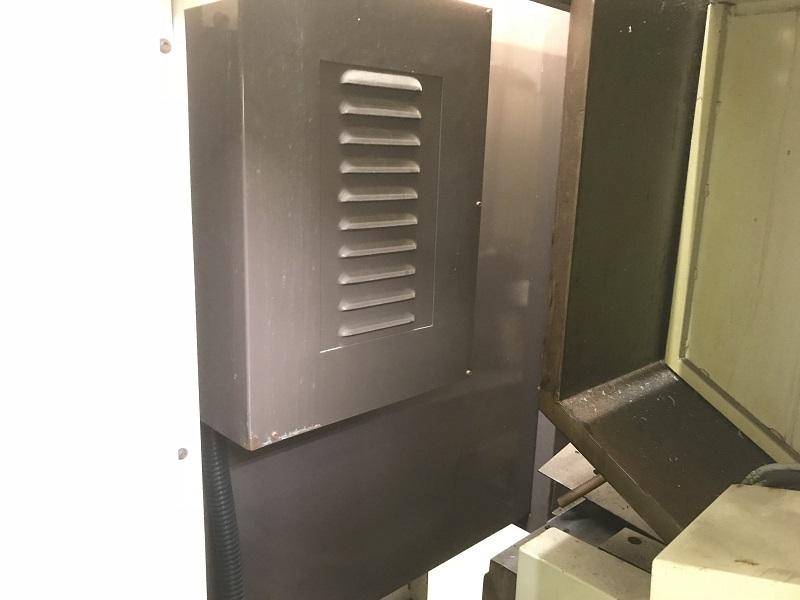

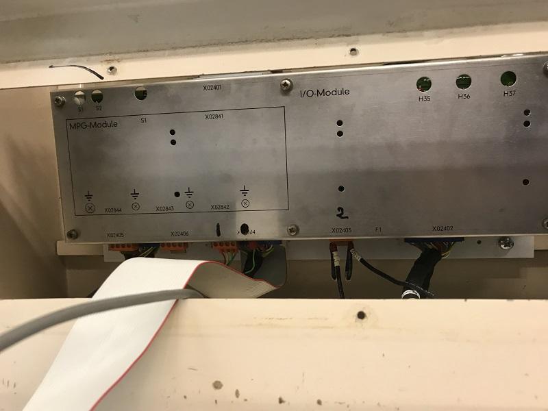

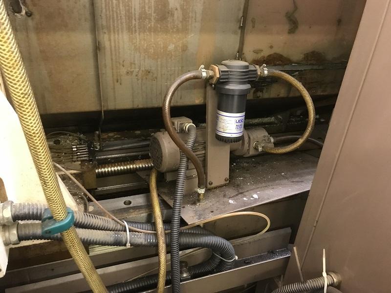

But crawling on hands and knees to see if there was enough vertical clearance to put the tank on rollers (there may be) I made a DISCOVERY . There is a further big panel that can be removed at the back of the lathe (it's about 1 metre square) that I had previously missed. Taking it off it revealed that the original top of the coolant tank has been stuffed in there along with the coolant pick up and pump - just as well I found it before anything starts moving as the pipes are laying on the Z ballscrew. BTW the Z servo motor is HUGE !
Being able to get my head in the back of the machine here has let me have a better look at a mystery louvred metal box fixed on the rear of the axis drive amplifier cabinet. It's 15" wide x 9" deep  x 20" tall, has a single umbilical cord of Adaptaflex trunking going into it and absolutely no markings what so ever. I suspect that it houses a transformer or maybe from the shape several transformers  :scratch: Perhaps I'll be able to open it up sometime.

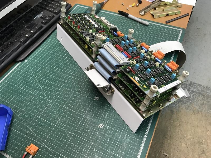

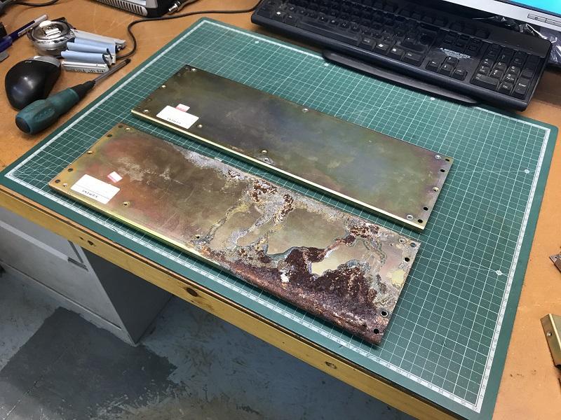

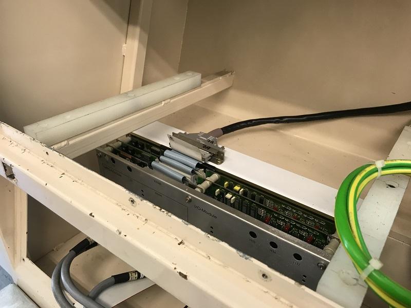

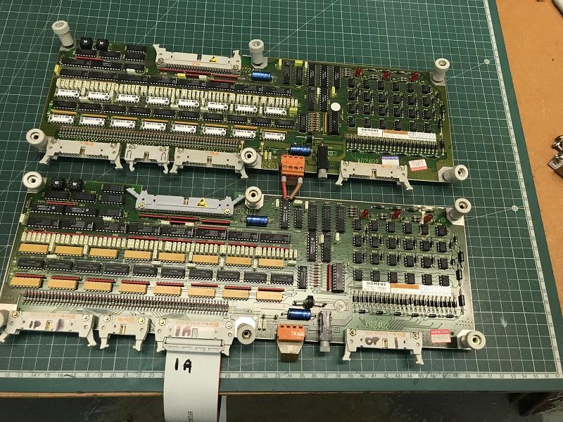

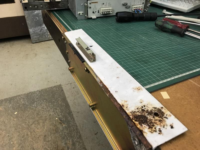

The nice man from UPS (Jock) came in after lunch with a parcel from Germany containing the replacement I/O card, Sheradised mounting plate and Umbilical cord that connects the Sinumerik 820T controller to the remote I/O unit. All second hand but looking in excellent condition
  • Posts: 9072
« Reply #85 on: June 19, 2018, 11:24:03 AM »
So with no more ado I marked up the new items with the arbitrary numbers I had put on the old as I removed them, checked the jumper settings on the card and started re-assembling the I/O sub assembly.
It looks slightly better than it did  :ddb:
  • Posts: 9072
« Reply #86 on: June 19, 2018, 11:29:18 AM »

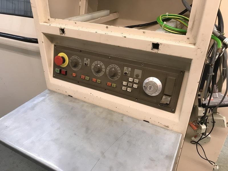

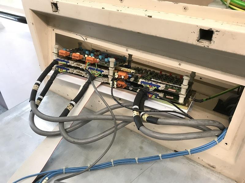

Then when I escaped from some neighbours who had dropped in for tea (excuse - I need to feed the pigs !) I was able to start putting that mad octopus tangle of cables back hopefully where they came from and re-fit the I/O sub-assembly from whence it came.
Apart from bally inaccessible screws it went well. I could then start re-wiring the Control Panel ready for re-fitting

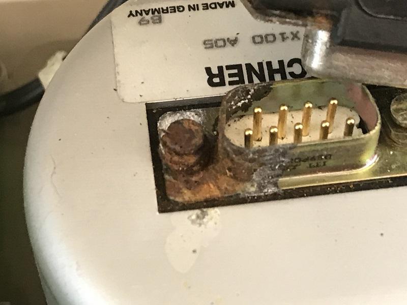

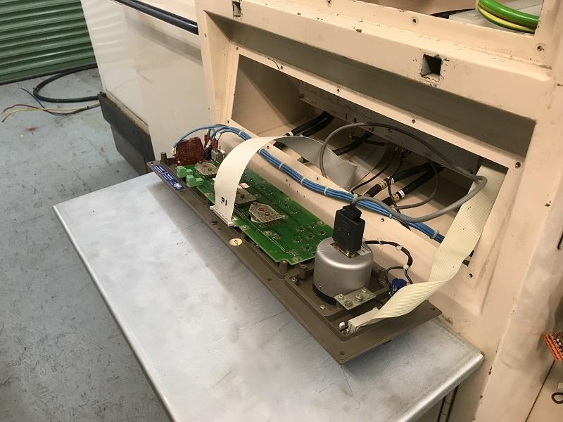

Now the corrosive fluid managed to put a drip or two on the 9 pin 'D-Type' plug and socket for the MPG Encoder - I've opened up the cable mounted socket and there was not much there to clean out - mainly just external - I've not opened the Euchner Encoder - I'll leave well alone unless it proves not to work when finally I get everything back together.
I've put the Control Panel back in place, but only with three screws - pushing my luck I suspect to 'assume' all is well in there

Just goes to show you that something that looks on the outside to be a very nicely kept machine can hide a whole host of problems.
Is all that damage from one little failed battery Andrew or is there another source for the corrosion?
  • Posts: 9072
« Reply #89 on: June 19, 2018, 03:31:10 PM »
Just one 8 ampere hour 3.6 volt Lithium Thionyl Chloride  primary battery Pete, but left for best part of ten years to  ooze and rot. :bugeye:

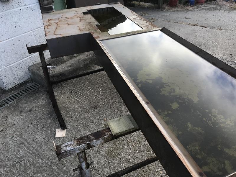

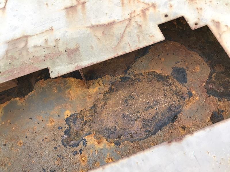

So as I'm going to have to wait a week or so for the Interface card and it's RAM Daughter Board to show up I thought that I might as well set the Coolant Tank up de-rusting with citric acid.
First I gave it a good thumping and scraping to shift as much loose rust as possible. Tipping out the loose made quite a pile. Then I blew it out with an airline, and set it up on 'builders trestles' strategically close to a drain and very carefully levelled it.
Then came bucket after bucket of hot citric acid, filling it until there was a meniscus visible so that hopefully the underside of the top surface will be wetted as well.
At least this has shown that there are no pin holes (YET!)
Covers over it over night to stop any wild life drinking it and dying  :bugeye:
No doubt it's going to take quite some time to have it's beneficial effect, meanwhile I can try and decide on a paint treatment that is affordable (large tank this!) and effective.
POR15 would be nice as would Glyptal but either would bankrupt me. The other suggestion has been marine quality two pack epoxy paint
« Reply #90 on: June 19, 2018, 04:09:25 PM »
Two pack car paint stands up to a lot nowadays and is available everywhere .
