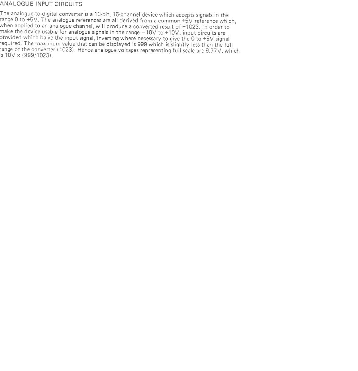

« Reply #552 on: November 05, 2018, 06:21:34 PM »
Sounds like there's a deadband set in the Mentor.
I'm assuming you can view the AD value on the Mentor some how going by that bit text?

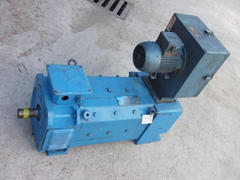

I do wonder if possibly there is something wrong with the motor field coils, as people in the know commented that they thought that the 23 ohms I'm measuring is rather low.
It is an enormous lump of iron to remove so I hope I don't have to go there ! It looks like this one on eBay but although the power rating is the same, the excitation and running voltages are different

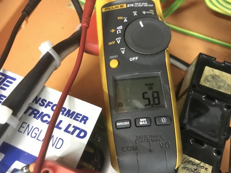

Well the usual running round in circles and chasing my tail has produced results.

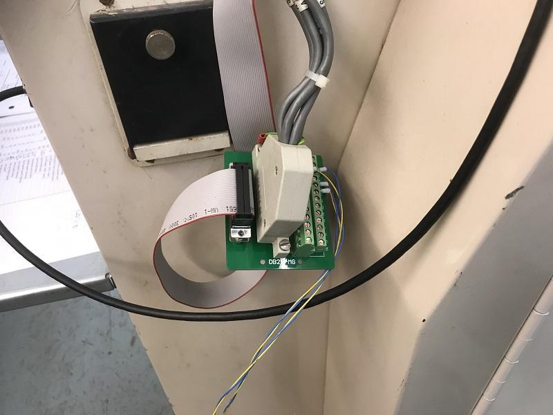

Firstly I wired up a break out box to allow me safely to connect to the Servo Enable and Analogue signals for the DC Spindle servo system. As the X & Z axis signals and also those I wanted to hook into were all on the same 25 pin 'sub D type' the break out board was necessary to stop the X & Z servos slamming all over the place as I probed.
This allowed me to 'scope the signals and observe that servo action ceases at close to but not at set point - why ? Also the signal to noise ratio was pretty dire - for the small error signals down at the small increments involved ( about 45 mV) the noise was of the same magnitude. Some but not all this noise was being picked up on the twisted pair wires I was using and had a 165 uSec periodicy.

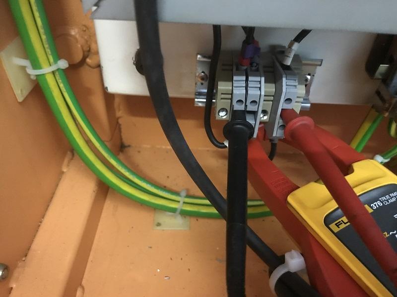

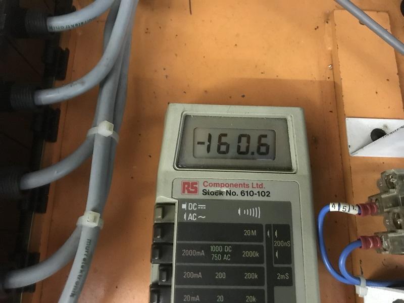

Then I turned my attention to the issue of the drive to the field coils. Plate on the motor says it wants 170 volts but I've never managed to achieve that without other problems ensuing. One big issue was not being able to measure current and voltage simultaneously and also have the fan mounted on the FXM-3 supply.
So I've added a DIN rail and brought the field coil connection out and via it, it such a way that they are both accessible  and also there is a loop that I can get my clamp ammeter round. As an aside it has been suggested that the clamp ammeter, although being a true RMS one, won't show a correct current due to the chopped thyristor nature of the current wave form. Well I've disproved this, as it EXACTLY corresponds to my AVO 8 Mk 6 when both are measuring at the same time.
This also allowed me to see the 'field weakening' characteristics of the FXM-3 - to achieve high speeds the field current is drastically reduced over about 1500 rpm
So with the field set to 5.8 amps and resulting in 160.5 volts the motor characteristics were definitely different, but still it would not turn at the desired 5 RPM. Incidentally, this is 5 RPM at the spindle, the motor at this spindle speed in low gear needs to turn at about 22.5 rpm due to the 3.2:1 gear box, and belt ratios.
. . .why, oh why oh why ? A question that has had me racking my brain for months.

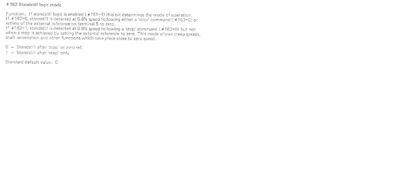

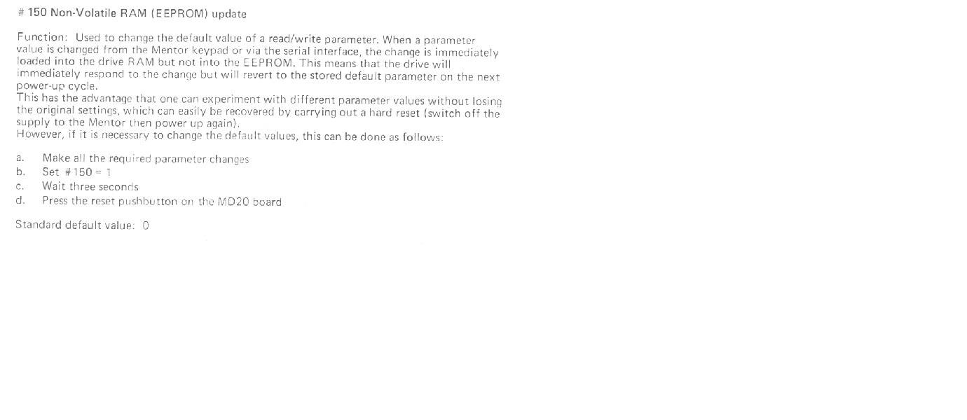

So I decided to read the Mentor-1 DC spindle drive manual from end to end leaving no commas and full stops unmolested  :bugeye:
. . . and guess what - I found that there was a parameter (#161) to 'Enable Standstill Logic' which if the speed is very low, backs off the thyristor firing angle all the way to prevent creep. BUT there was also a parameter (#162) that if #161 was set allowed creep speeds for shaft orientation well I never.
So quickly setting this parameter to '1' guess what - M19 works   :ddb: :ddb: :ddb: :ddb:
Now it's not all plain sailing, as, although there is a method of saving the new parameter values to EEPROM, try as I may it isn't working, and the parameter reverts to it's old value on a power down / up cycle.
...BUT M19 IS WORKING  :clap: :clap:

« Reply #574 on: November 13, 2018, 07:58:38 AM »
And now the new parameters are saved  :ddb:
Turns out BOTH security codes need entering despite the flag saying one of them hasn't been set  :scratch: Anyway, they are saved, AND I narrowed the location down to its finest setting of 1/11 th degree and sure enough it servo / homes in on it with the accuracy asked for.
