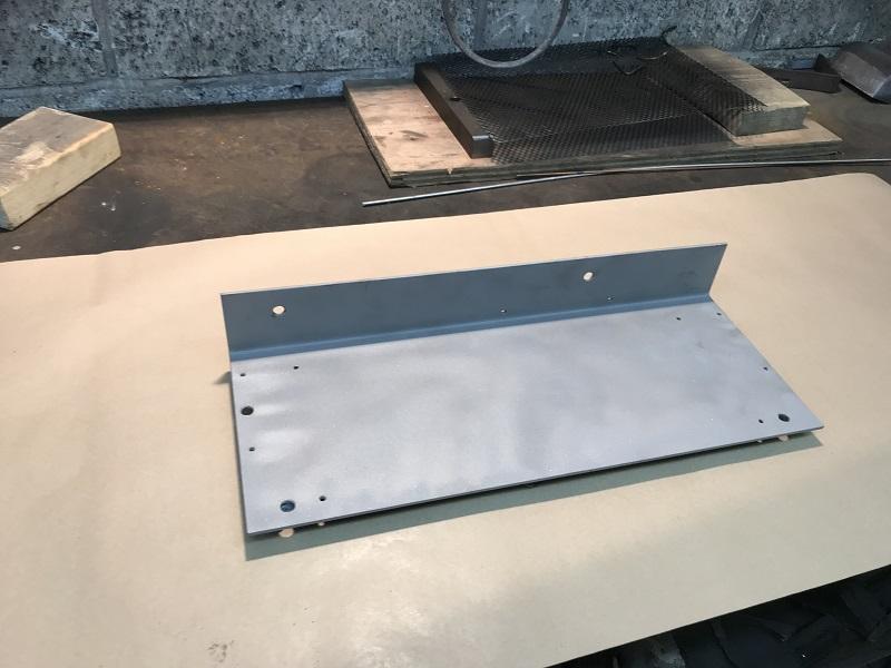

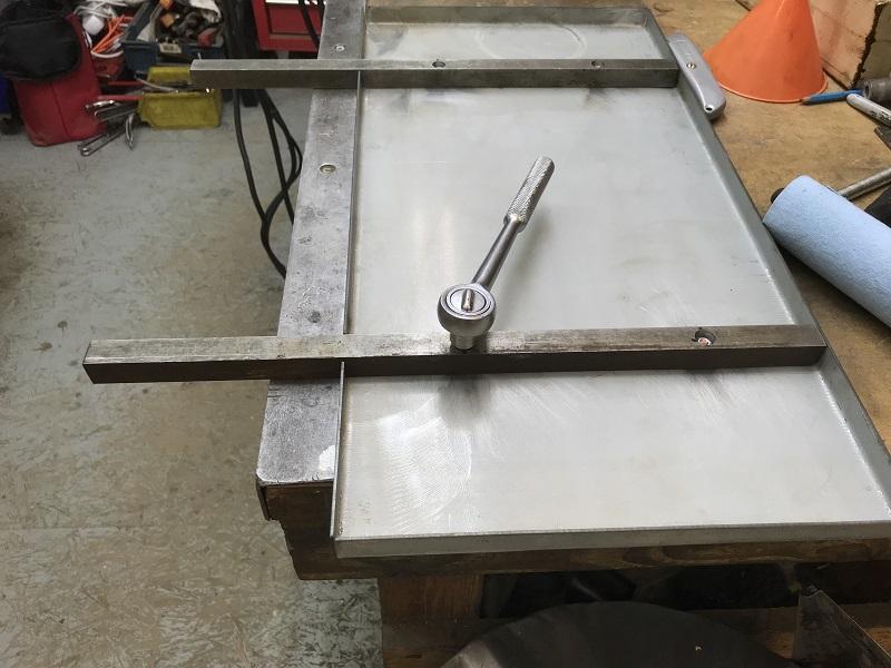

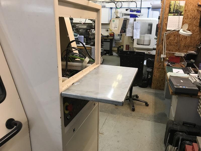

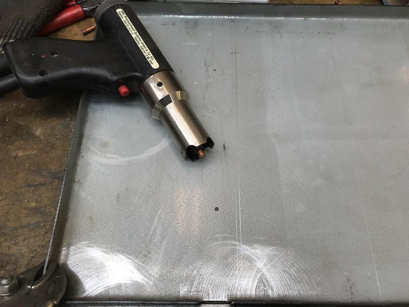

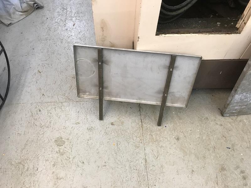

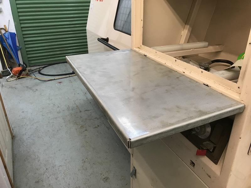

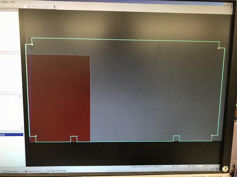

We have company for lunch today so no real play time having done the animals, but I did manage to draw up a sheet metal 'Shelf' in Autocad to replace that bit of aluminium that I'd previously balanced on the bars.
Drawn in Autocad, saved as a .DXF, imported to SheetCAM, ported to MACH3 and cut out of 2 mm Zintec steel on the CNC Plasma Table  then bent on the Edwards Box & Pan folder- the Plasma table certainly makes this sort of thing so much easier.
It sits nicely but some how I want to bolt it to the bars, so when they are withdrawn it stays as a single unit, but I want to preserve the undrilled top surface - might need to break out my stud welder and see how accurately I can place studs  - I can see it will be useful for paper work at the monitor when it's original purpose of removing and replacing the controller is done with  :thumbup:

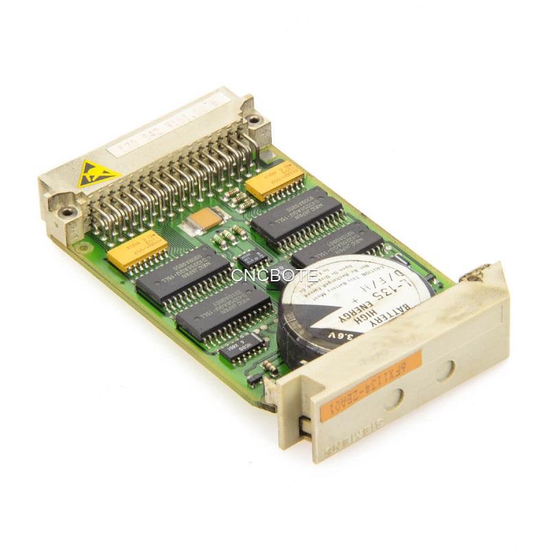

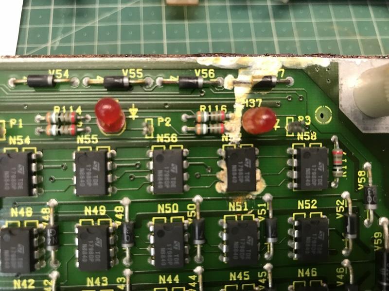

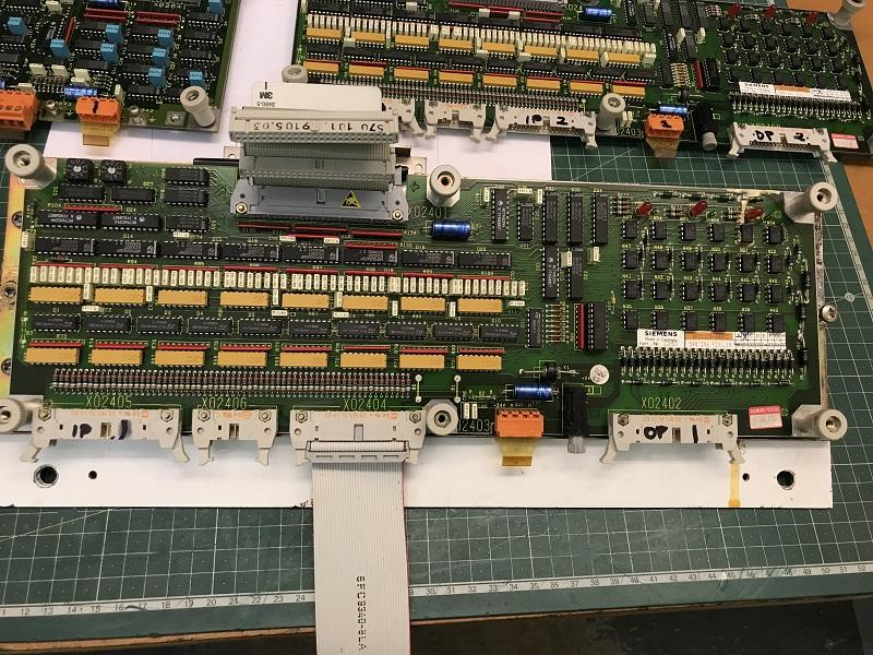

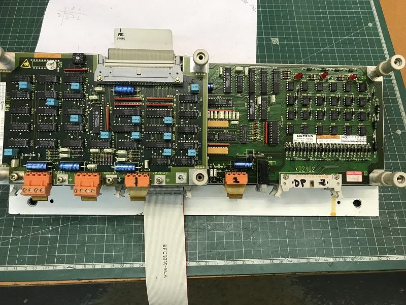

Glad to say after a bit of negotiating I've come to a settlement with the German Siemens Sinumerik Card Flogger, and Card-B (my name) and it's daughter memory card are on the way to me - cheeky chappie is charging two set of (expensive) carriage but I bet they arrive in the same box !
It wasn't cheap, but I reckon a better solution than trying to clean up the originals - however I will keep them and perhaps have a go in the future.
Still need to clean up the I/O crate (not got it out yet!) and also try and get the rust off the main controller crate. I may try masking it and using my 'spot sand blaster'

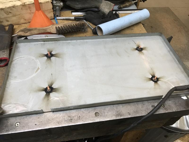

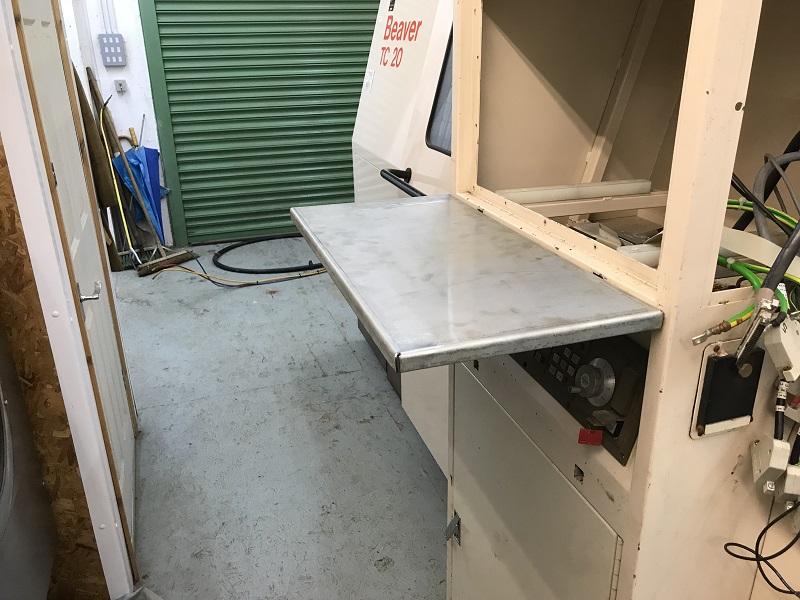

« Reply #54 on: June 14, 2018, 03:20:36 PM »

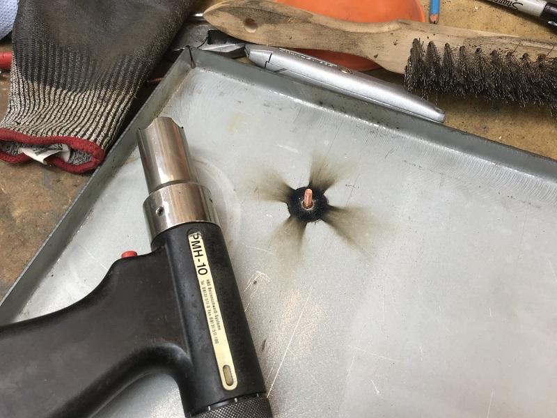

So I got a little time this evening when guests had departed to fix the shelf and bars together. I drilled the bars 6 mm and counter-bored them 1/2" so that nothing sticks downwards under the bar to catch you out, and a hex socket will fit in the recess.
Then mounting the shelf and wiggling it into the centre of its movement latitude I marked though the holes with a Sharpie, and then gave the marks a decent sized centre pop.

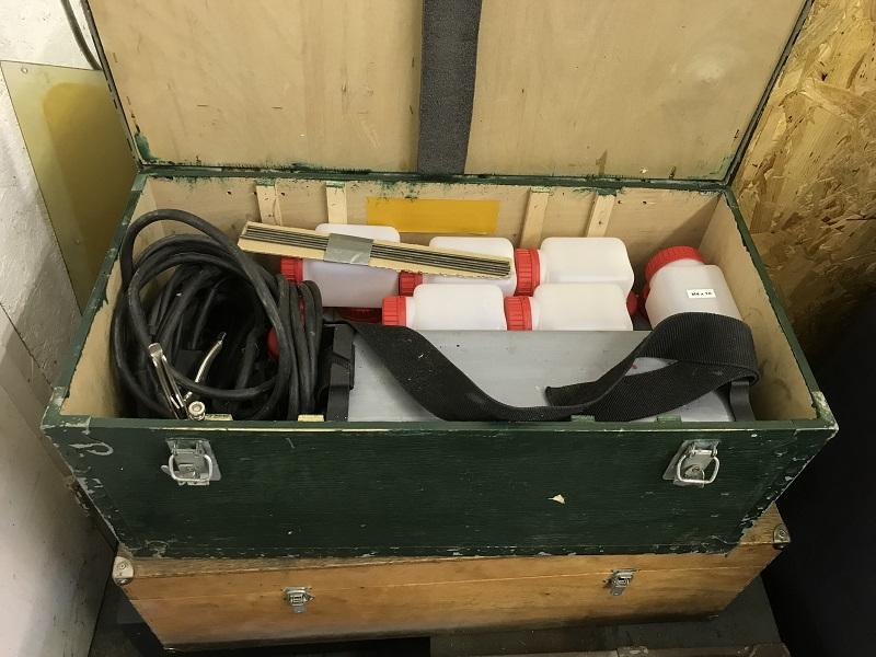

Digging out my Stud Welder (*) I did a few test firings to prove my settings then  I located the pip in the M5 x 18 mm studs I was using in the centre pops and fixed four studs. Amazingly they fitted the bars, and being 18 mm they don't protrude below the 3/4" bars.
. . . so objective achieved - an unblemished upper surface and the bars and shelf now together as a unit  :thumbup:
The Stud Welder can go back to bed for another long sleep  :ddb:

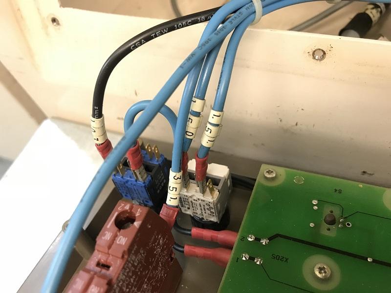

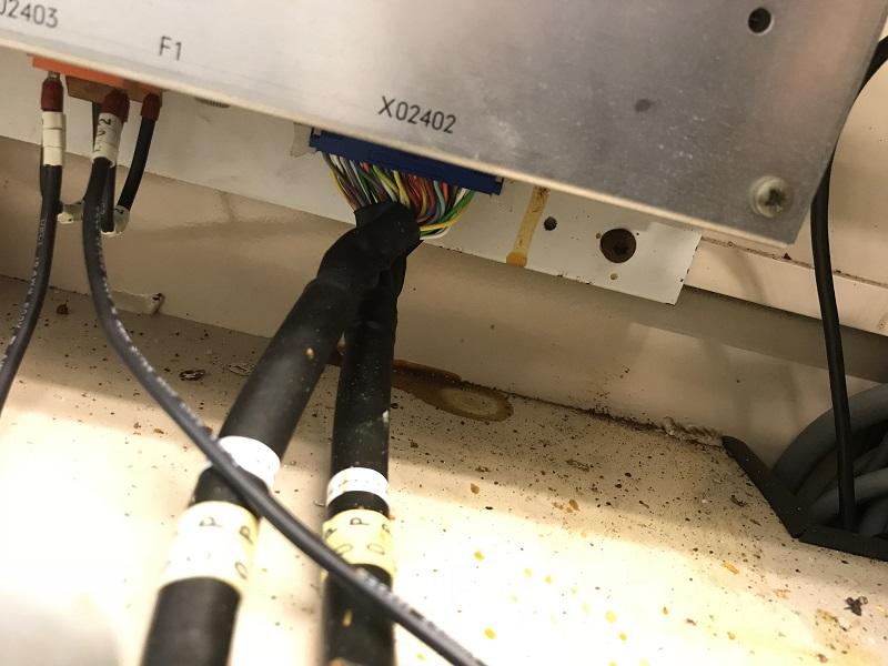

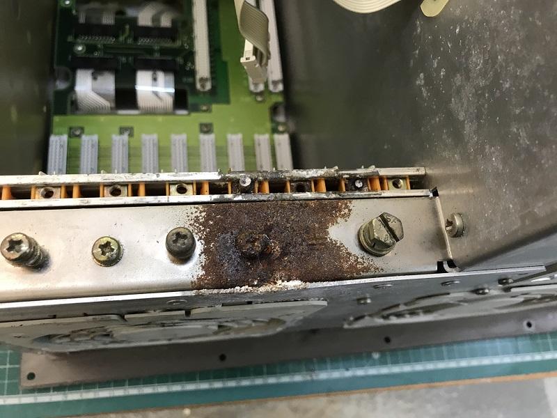

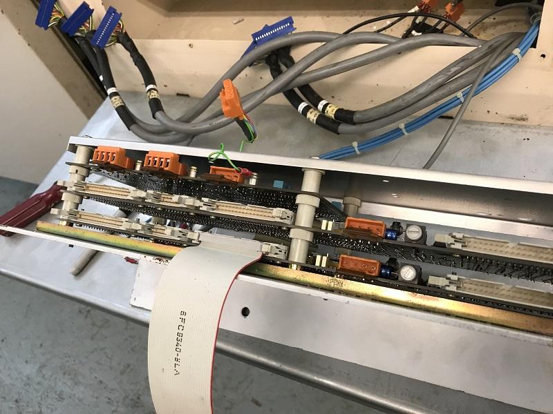

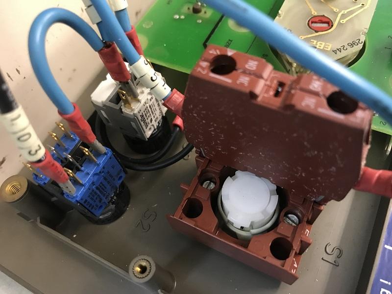

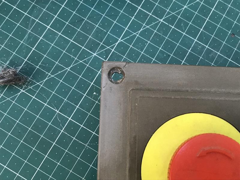

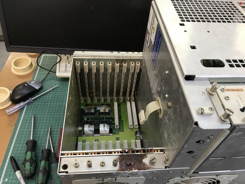

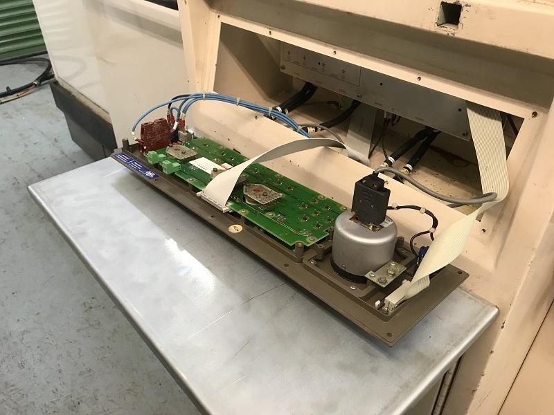

Today's task: Get the Input / Output crate out and find how extensive the damage is.
Access a bit tricky - have to go through where the Manual Control Panel mounts - so that has to be removed first. I twisted the cable ident labels so hopefully I can see them in my pictures and get them back in the correct places  :ddb:
I took many more pictures of the wiring but they are BORING !
« Last Edit: June 15, 2018, 07:52:43 AM by awemawson »

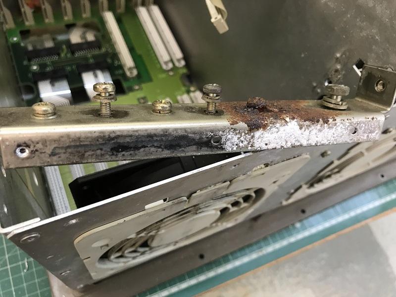

  • Posts: 9072
« Reply #56 on: June 15, 2018, 07:34:06 AM »

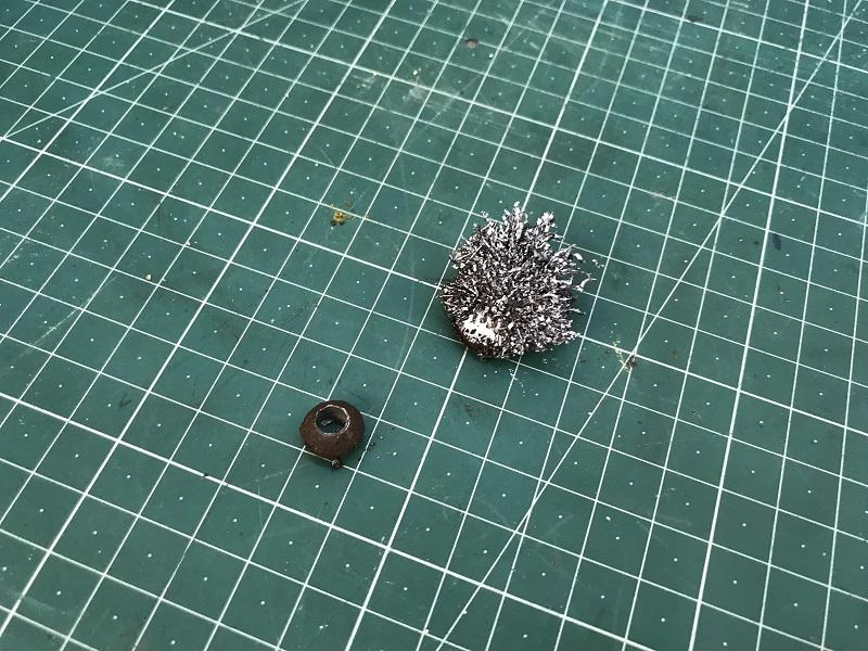

Now with the panel out of the way I can reach in and unscrew the four mounting screws for an L shaped mounting bracket obviously made by Beaver rather than Siemens - it's the white bit.
Usual thing - three screws no problem, but the fourth was rusted solid. A candidate for drilling as the bit it goes into won't take heavy hammering. Placing a rare earth magnet next to it to catch the swarf I drilled it out, constantly checking drill depth as if this blind hole were extended too far it would go into the tailstock end inners of the machine that will be awash with coolant (hopefully some time!)
  • Posts: 9072
« Reply #57 on: June 15, 2018, 07:38:34 AM »

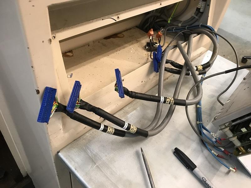

Then it was a case of disconnection of the cable forms but labelling them up first. All came off nicely except one that had a screen earth on a screw tag that was inaccessible without removing the top cover - time to drill a hole I think  :lol:

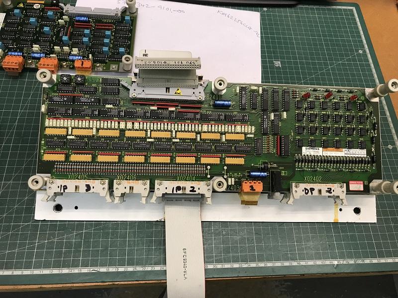

  • Posts: 9072
« Reply #58 on: June 15, 2018, 07:44:25 AM »

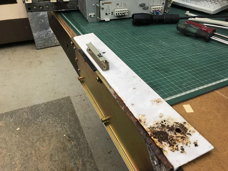

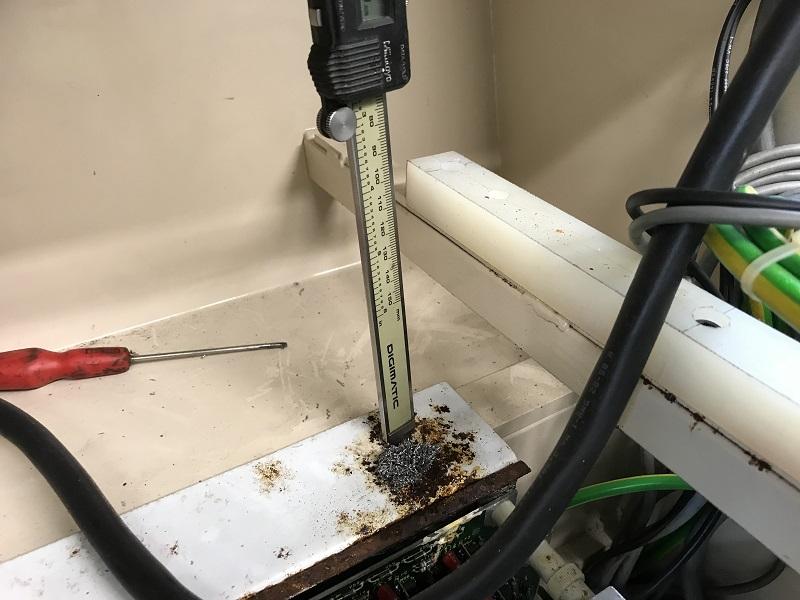

So now I can put the I/O unit on the desk and dismantle it to see how extensive the damage is and identify the card part numbers.
Now actually the physical damage is not too bad to the inner IO card - I'm sure it could be recovered, but finding one on the ubiquitous eBay for only £35 including postage it seems silly not to replace rather than try a repair

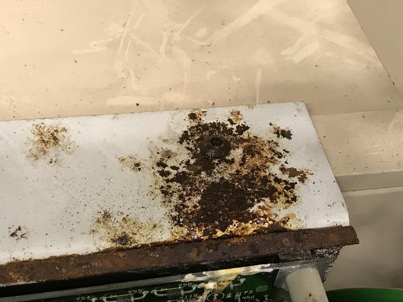

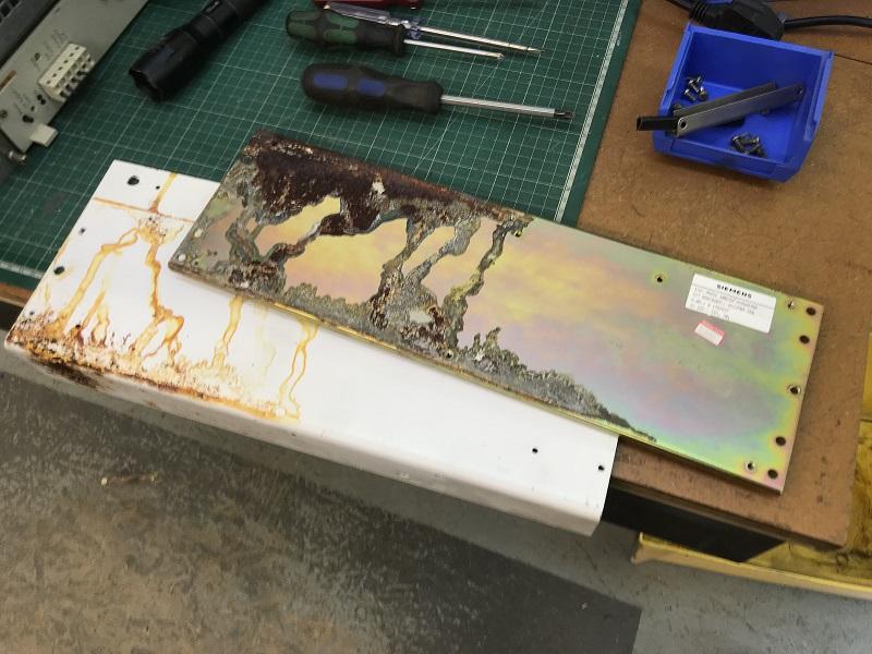

  • Posts: 9072

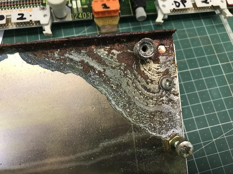

« Reply #59 on: June 15, 2018, 07:51:04 AM »

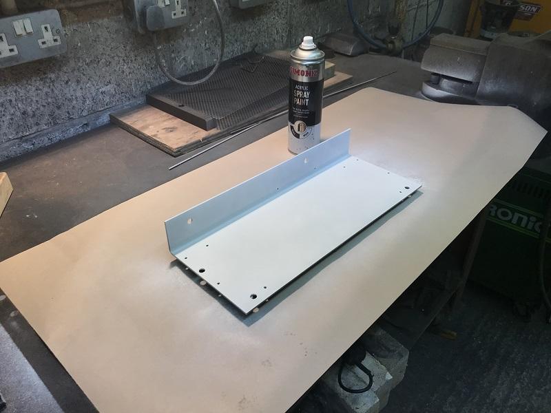

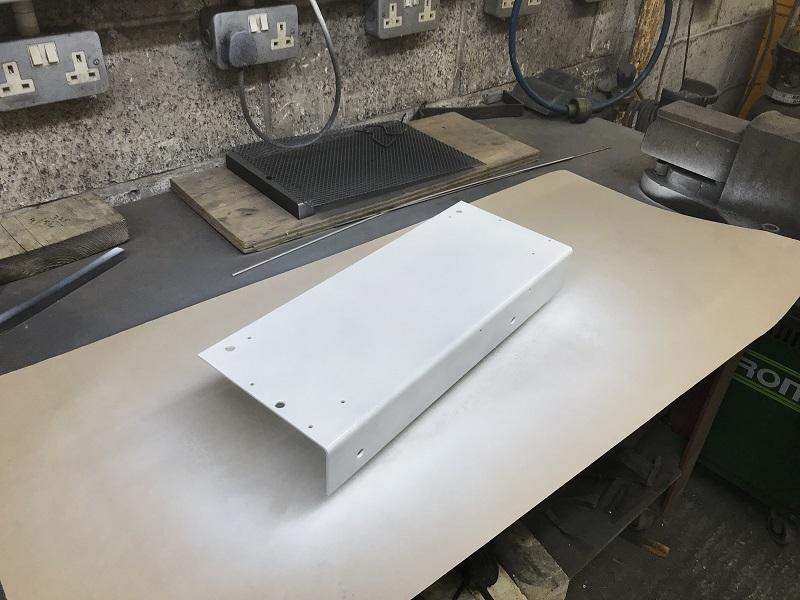

But the corrosion damage to the metal work was actually worse than I thought. No issue, it can all be  grit blasted and painted and will be fine . .
 . . .EXCEPT . . the fellow on ebay flogging the I/O card had another offering of the sheradised metal panel AND the umbilical cord with connectors both ends, that was so badly corroded at the controller end - so an excellent result (if all the cards work!)
I grit blasted the Beaver made white panel and have re-sprayed it to await the other bits to fix to it.

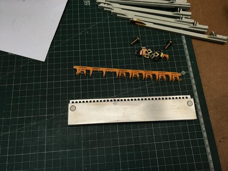

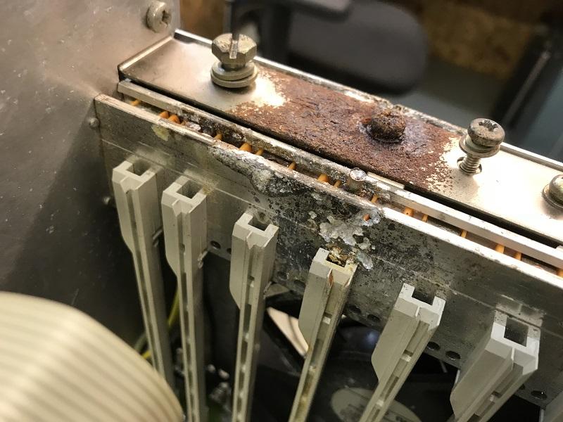

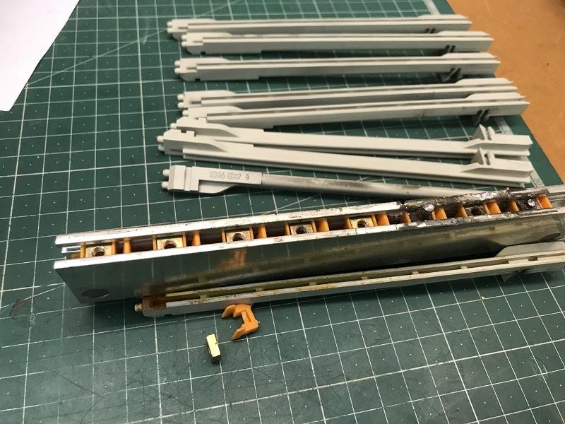

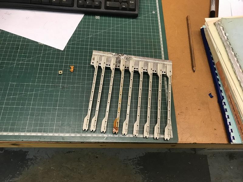

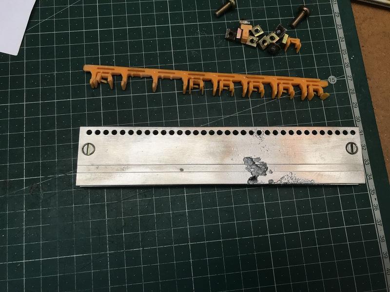

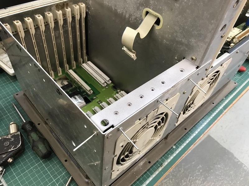

Until the bits arrive there will be little more progress but this afternoon I've re-glued the corner of the Control Panel that was broken (not me gov!) and started sorting the corrosion on the card cage.
The rusty retainer with a sheared bolt in it I was able to remove by drilling out four pop rivets - then it could be grit blasted, the sheared screw drilled out and the hole re-tapped, and then the lot got a light coat of zinc spray before being re-rivetted. Note how I insert ALL the rivets before setting any to ensure that the location stays OK
The card guide bar, which is alloy, is more of a problem and I think I'll need to source a replacement. There are two sheared off screws in the square nuts that are supposed to slide in the extrusion - but they don't. The plastic of the guides themselves is very brittle and two have broken retainer pegs, and the bar itself is badly corroded.

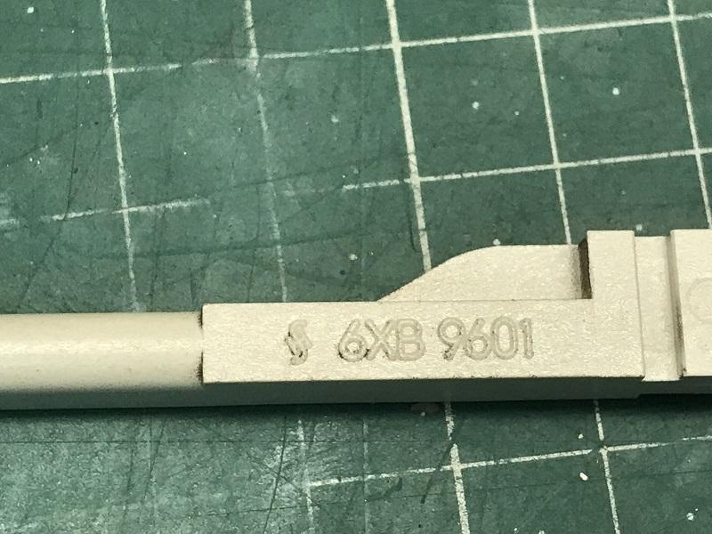

Do any on you recognise the rack system to help sourcing a bit of extrusion and some guides - there is a logo in the molding of the guides, I recognize it but cannot recall who's  it is - can YOU help ??
  • Posts: 9072
« Reply #62 on: June 15, 2018, 12:25:02 PM »
DOH - it's Siemens  :lol: :lol: :lol:

« Reply #63 on: June 15, 2018, 12:45:09 PM »
On reflection, although I'd prefer to replace the extrusion, as a fall back , and if I can bully the current captive nuts out and down the extrusion, all I need do having cleaned it up, is make a length of tapped flat bar to slide in. 7.5 mm x  3 mm tapped every 20 mm  nine times. There are two unused card slots, so I can steal their guides to replace the ones with broken retainers.
. . . now where is my 7.5 mm x 3 mm flat bar stored  :scratch:

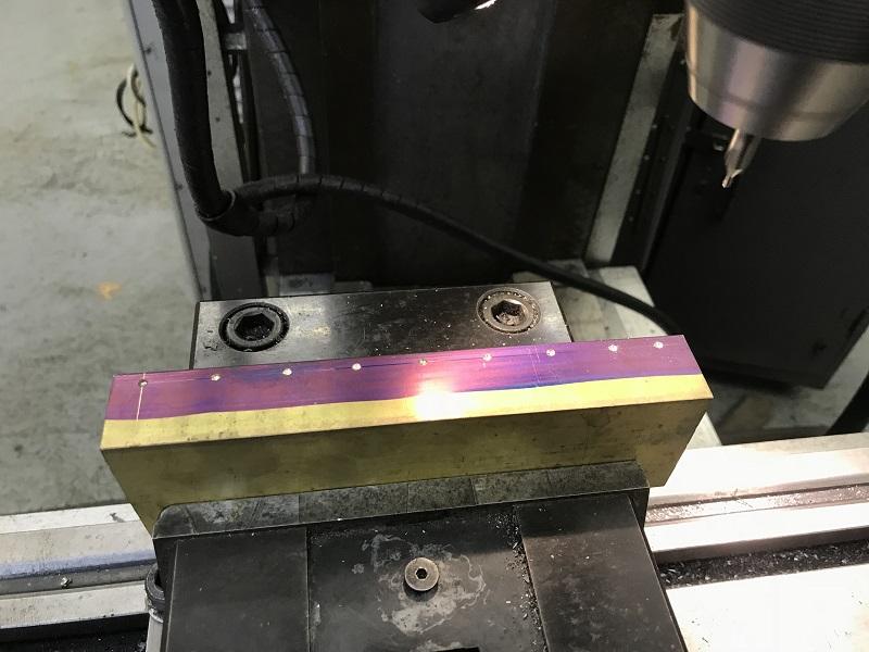

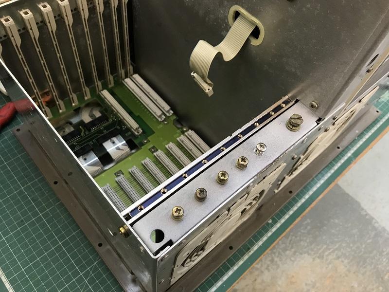

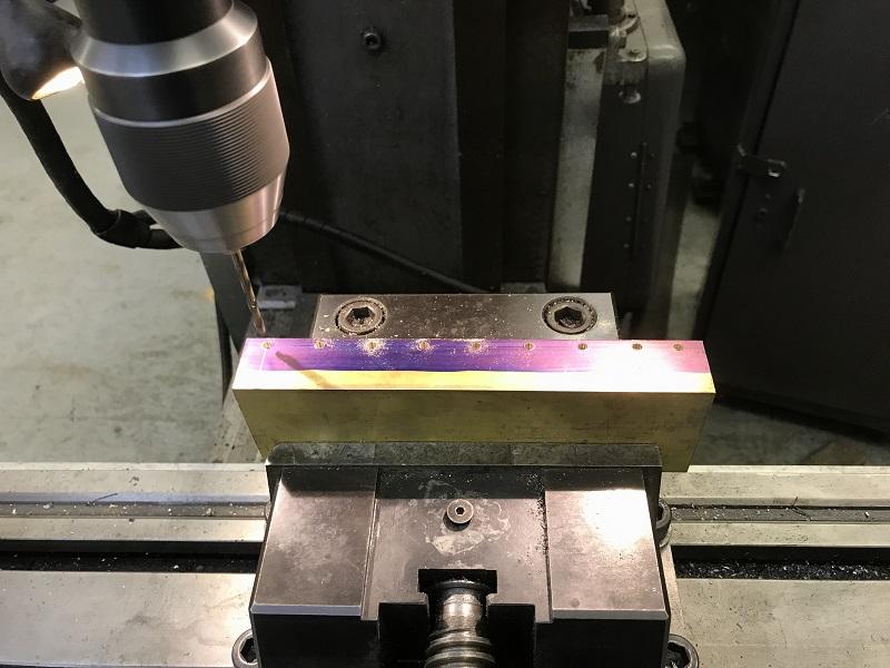

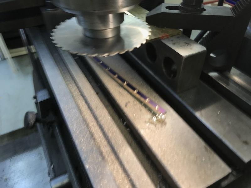

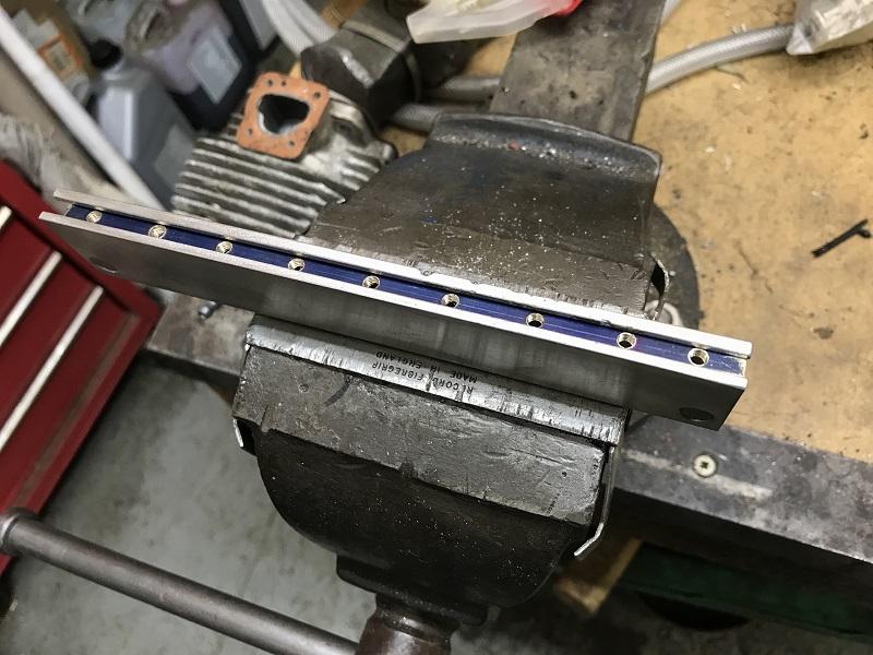

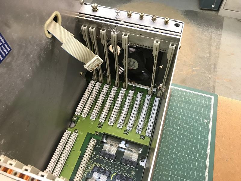

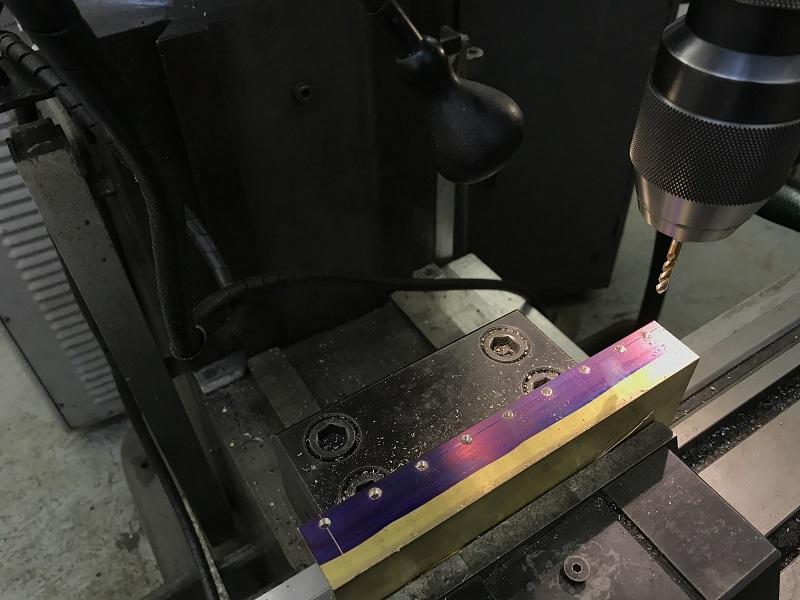

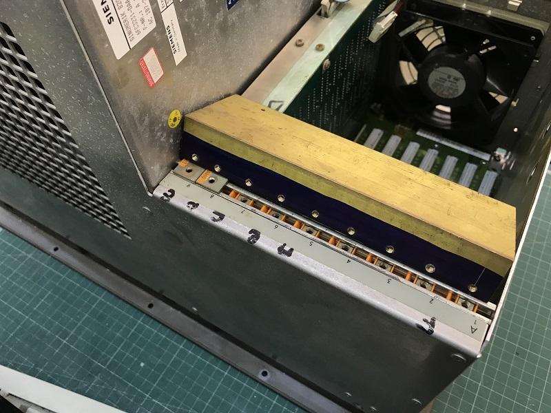

I was determined today to try and clean up the bar extrusion and see if I could remove the corroded nuts and make a tapped bar to slide in in  their place. It turns out that the orange plastic bit is one continuous bit rather than one per nut as I had thought. A bit of brutality got it and the nuts out, and I attacked the extrusion with a file followed by a wire wheel.
There is a big chunk dissolved away by the leaking battery, but it's not affecting the functionality and actually it cleaned up pretty well. I hunted around in my scrap brass box and the only suitable thickness that I had was one leg of a bit of angle that was barely long enough -but you use what you have. Being angle made holding it for drilling and tapping easier than had it been already a correct sized strip.

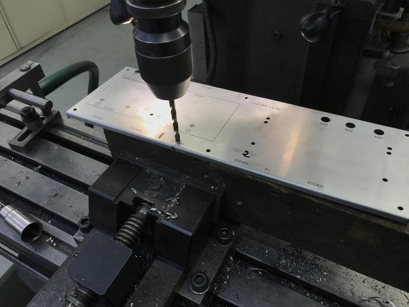

So this got  marked up, centre drilled, tapping drilled and tapped M4 under power
The hole spacing is 20 mm EXCEPT for the one at the far end which is 15 mm - this nearly tripped me up, but luckily I spotted it just at the last moment. Anyway - offer it up for a reality check - yes it looks about right  :thumbup:
  • Posts: 9072
« Reply #70 on: June 16, 2018, 06:55:22 AM »

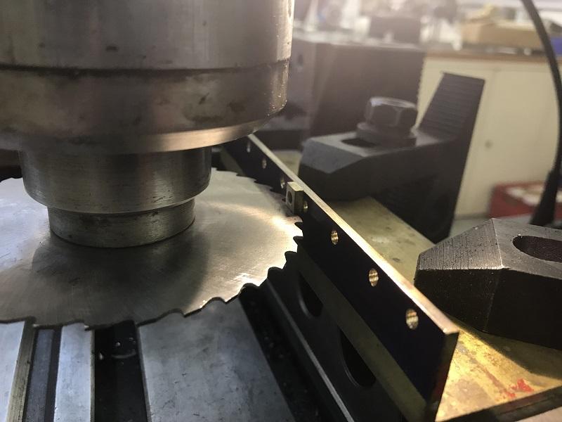

Then to slit it off the parent angle - I never like using slitting saws, but this went OK, but I made sure it was a very rigid set up. Setting the height of the saw blade I cheated and offered up one of the original square nuts - made life so much easier.
This was followed by a bit of a clean up, then I slid it into the extrusion and re-mounted the extrusion to the card cage.
PCB Guides:  Two were beyond use, their location pins having broken off when they came out, BUT three slots in the cage are not used, so the obvious solution is to steal their guides  :clap:
Popped the required guides into the relevant places, and did a trial insertion of the cards which went well and everything fits nicely.
(I couldn't bring myself to put the card with the leaking battery back !)
So now cosmetically it all looks a lot better than it did - look at the last picture to see how it was

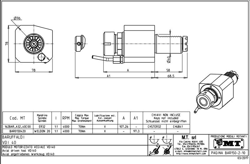

I've investigated the possibility of 'Powered Tooling' being mounted in the tool turret, and sure enough the facility is there - the selected tool gets lined up and has a simple 8 segment dog clutch on the rear of the VDI40 mounting spigot, that engages with it's opposite number on the tool drive

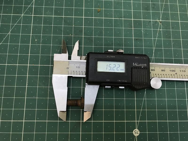

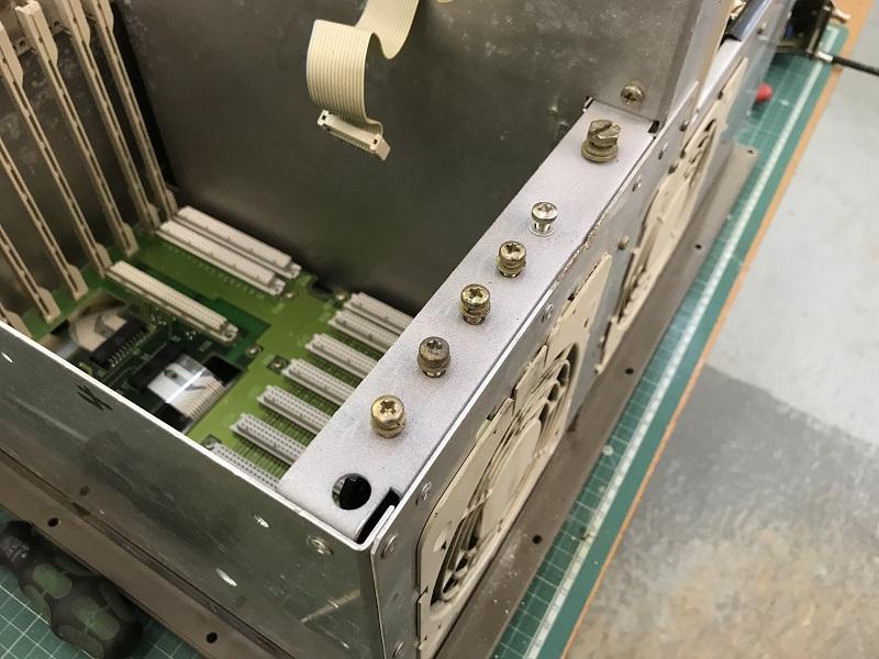

Then I turned my attention to some of the card retaining screws that had sheared off. They are M4 but have an extended outer part with a hand grip, and a turned down section to retain them in the card. Drilling tapping and Loctiting replaced the sheered threads.
