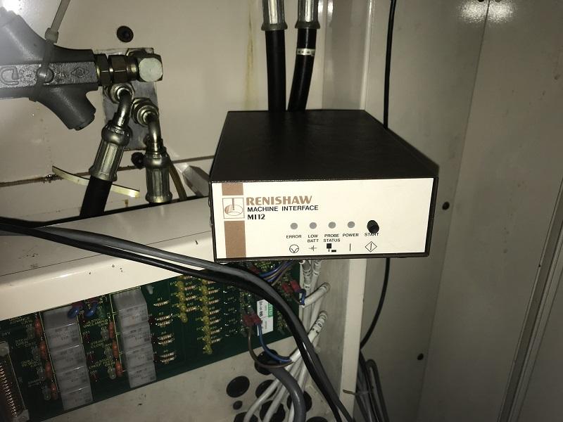

I spent some more time today trying to investigate why I can't get the Renishaw optically coupled probing system working.
It consists of four elements:
An MI12 'Machine Interface' - (A box that talks to the Siemens control and the OMM )
An OMM (Optical Module Machine - machine mounted infra red sender receiver )
An LT02 (Tool Turret mounted infra red sender receiver)

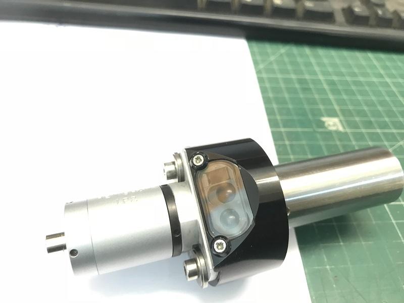

An LP2 that mounts on the LT02 (a sensitive switch operated by a probe touch)
What is supposed to happen, is that the MI12 tells the OMM to 'wake up' the LT02 as it has an internal battery that needs preserving. Once awake, if the ruby probe tip trips the LP2 switch element, the LT02 transmits a signal to the OMM,  which passes it to the MI12, which gives a signal to the Siemens controller that we are in contact.

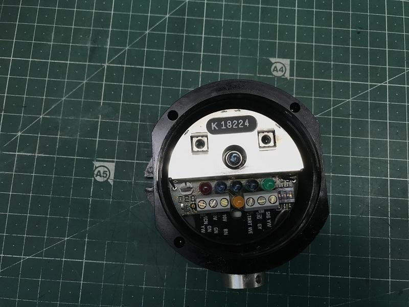

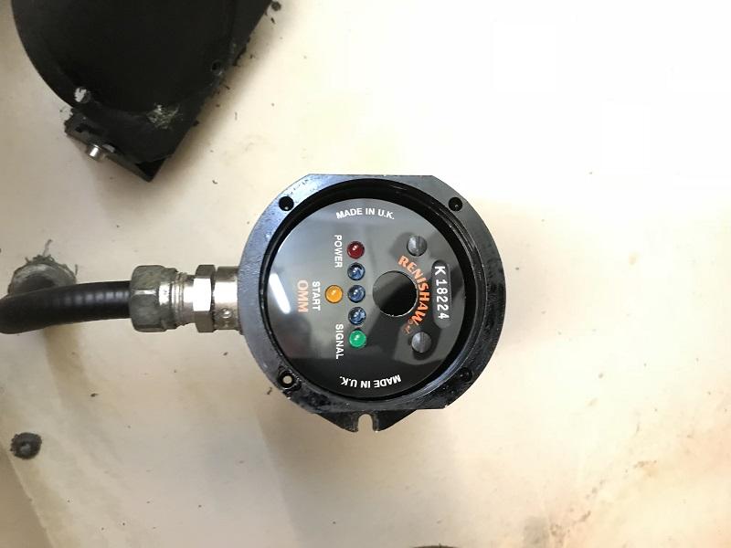

« Reply #389 on: September 10, 2018, 04:24:08 PM »
Now from previous work I had proved that the OMM is transmitting an IR 'wake up' signal, comprising a 250 millisecond burst of 125 uSec period pulses every second. I did this by cobbling together my own IR receiver.
Now there was no apparent response from an LT02 held in range and triggered. So maybe the LT02 is faulty, or maybe the OMM is not receiving ?

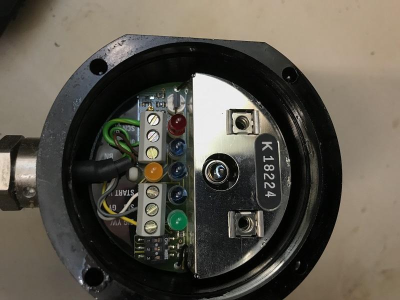

So today's task was to dismount the OMM and have a look at it's electronics and see if I could glean any further information. Not the easiest thing to get at, being behind the machine sliding door, but just possible.
The wires are pretty delicate and extremely short making the job an utter joy !
First the outside glass cover has to come off, and a shroud, giving access to the wiring terminals. To get a bit more space to move, I took the OMM off it's mounting bracket.
« Last Edit: September 10, 2018, 04:49:16 PM by awemawson »

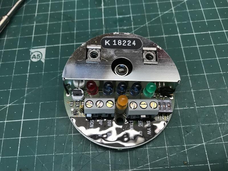

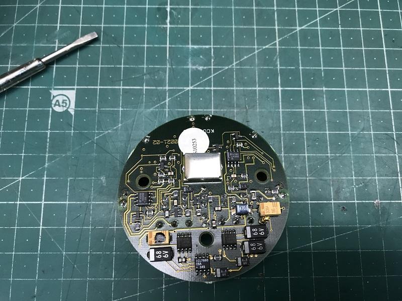

« Reply #390 on: September 10, 2018, 04:47:26 PM »

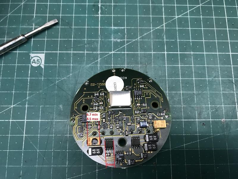

So the next job was to remove the electronics and power them up on the bench. The MI12 supplies 10 volts to the OMM so that's what I gave it. To my surprise although the power LED came on, the Yellow 'wake up' LED didn't. (it had in the machine) Investigating further showed me that the 1 second / 250 millisecond / 125 microsecond bursts were actually formed in the MI12 - the OMM just passes them on as IR - (this fact becomes relevant later)
Now what I wanted to do was prove that the IR receiver part of the OMM was (or was not) working. Using a remote control from an LED Floodlight, I clamped one button 'pressed' , arranged it to point at the OMM IR sensor, and poked about in the circuitry with my 'scope probe. Now much of the electronics near the IR sensor is covered by screening cans that are not easy to remove, and it's all a bit tiny being surface mount. However I did find responses to the IR signals that I was sending, so the IR diode must be working.
I then went to the other end of the electronics, where a DS8921M differential line driver talks to the MI12 - no output, and also no input. Now between where I found the response, and this chip, there is more hidden circuitry that I can't get at. But  I don't think that there is anything sophisticated enough to be decoding signals, just buffering and level shifting. This is where the relevance of that wake up signal comes in. If the designer put the clever bit of the wake up signal back in the MI12 unit, he probably did the same for the touch received signal (maybe !!!!)
On the board are two miniature LM7805 5 volt regulators (that are working) and an ICL7660 switching voltage converter that is producing a -3.5 volt negative rail, but I have no idea if this the the 'right' voltage of course.
So in conclusion, it's inconclusive  :bang: The IR diode is working but I still don't know if the OMM or the LT02 is the actual fault !
Really I need to find another machine equipped with this system and wave my LT02 at it's OMM!!
In the end I put it all back together and took the dogs for a walk !

« Reply #391 on: September 10, 2018, 05:37:21 PM »
The ICL7660 is a switched capacitor circuit, it's commonly used to produce a negative rail for op amps. The output voltage should be a negative mirror of the input voltage, so measure pin 8 vs pin 5 (with pin 3 as your reference) the voltage on 5 should be the negative equivalent of pin 8.... If it's not then you have a cap or over current problem.
PK

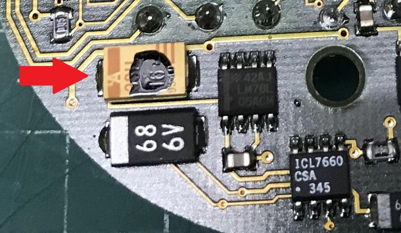

« Reply #392 on: September 10, 2018, 05:56:43 PM »
Thanks for that PK.
Your response has prompted me to look very closely at the photos I took at the time.
I've spotted what looks to me to be an exploded surface mount capacitor - if it's the same as others on the board it should be 33uF at 16 volts - certainly  doesn't look healthy
Of course it's all back together now  :bang:

« Reply #393 on: September 10, 2018, 10:08:28 PM »
Yeah, that looks like the bulk cap for the input to the 7805, look for ripple on the little output ceramic in that picture.
Anything more than a few hundred mV is bad.

« Reply #395 on: September 11, 2018, 09:34:51 AM »
IMO, input caps for regulators tend to blow when they see voltage spikes, so I wouldn't be too concerned about root cause..... Just replace it and trust in Jesus......

The cabling for this device is ridiculous. The MI12 sits in the hydraulic cupboard under the controller where there is a 24 volt supply, but the MI12 takes it's 24 volts from a cabinet at the diagonally opposite (rear) corner, with the cable draping all over the place and passing through ungrometed holes. The MI12 to OMM cable goes round three sides of the machine to join front right to front left, with the same draping cables. When it's working (if?) there will be a re-routing exercise.
It was obviously an 'upgrade on site' and of course although I have all the panels off at the moment, the chap who installed this didn't, so it's easy to be critical unjustly.  :scratch:

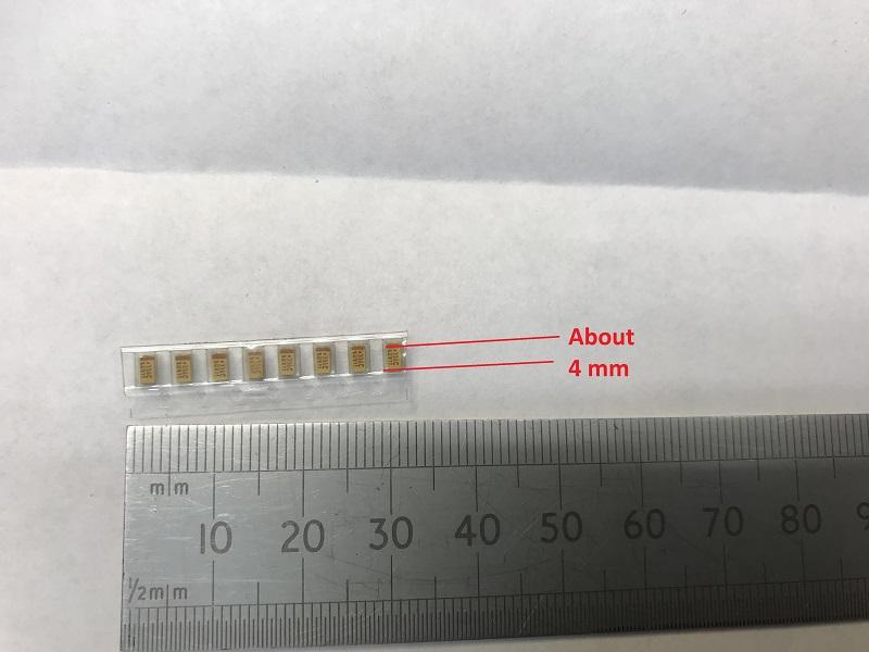

« Reply #397 on: September 13, 2018, 05:53:33 AM »
The ordered SMD capacitor arrived by post this morning, so I braced myself for some VERY tiny soldering. But when I opened the envelope I thought - 'by heck those ARE small'
So rather than dis-mount the OMM and find that I'd cocked up the order I thought I'd try and scale the size from the photographs knowing the size of an 8 pin SOIC IC (which was in the same frame)
Turns out these 33 uF caps need to be between 6.7 and 8.5 mm long, whereas the ones I ordered are only 4 mm long  :bang:
Never mind, better to find out now rather than when the thing is in bits on the desk stopping everything else while waiting for parts. So another order sent off, and this time (plonker before didn't!) I checked the physical size - 7.3 mm long in this case - should arrive tomorrow
. . . hey ho . . onwards and upwards

« Reply #398 on: September 13, 2018, 08:30:38 AM »
If the voltage rating is adequate, then just solder them in. 7805's aren't particular about input  caps.
« Reply #399 on: September 13, 2018, 08:58:51 AM »
PK at that scale I don't fancy putting in wire extensions - it's about the limit of my soldering dexterity to get them off and on, never mind extra floating bits of wire  :lol:
(Although I do have a hot blower as part of my de-soldering iron I suspect I'll just use a very fine tip for this capacitor)
