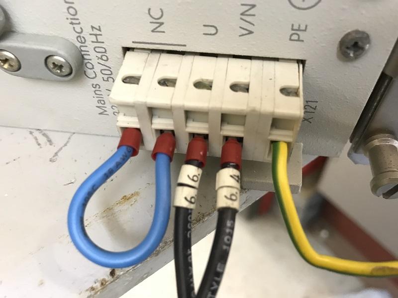

Look out for capacitor filter arrays that are centre tapped to ground, but if it has been stood in a damp shed for a few months, it may just be moisture, good luck with it Andrew. A new saga begins!
  • Posts: 9072
« Reply #26 on: June 12, 2018, 02:28:35 PM »
I'm rather hoping that the earth leakage is tied in with the controller not showing life - maybe it's internal PSU. Going over to have a gander shortly when my supper has settled  :thumbup:

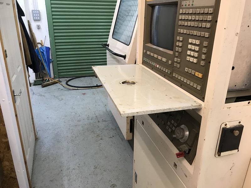

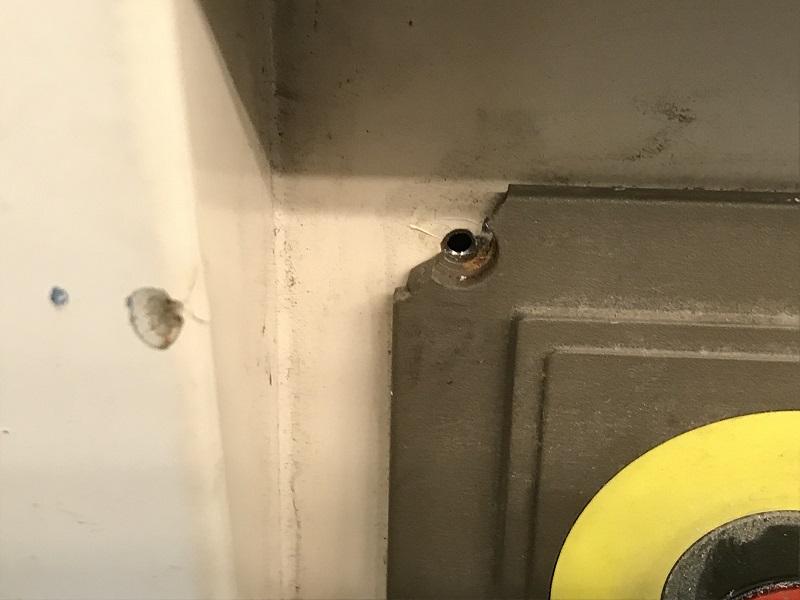

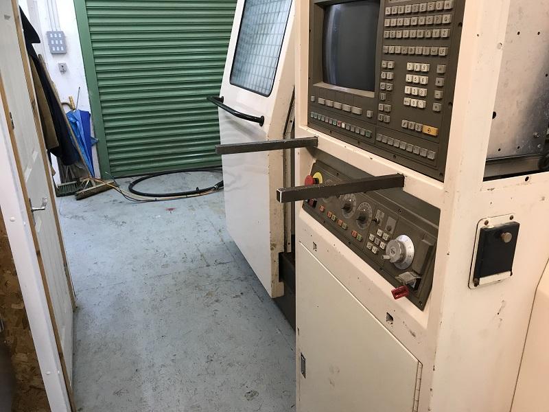

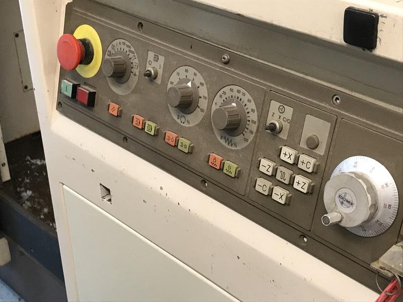

So back to it, objective being to get to the back of the controller. It's in a pretty well totally sealed box apart from the Operators Panel (below) and a filtered vent hole to the right.
I started by removing all the numerous screws retaining the Operators Panel, and noticing that one corner is broken but all bits there for later gluing. Having pulled the panel forward revealing the expected backs of switches, cables etc I noticed a small wet patch of brown liquid that obviously had come from above. There is only the control above and no way water falling on top of the machine could get to here as it is a solid box. Burst Capacitor or Battery I'm thinking at this point.
OK put the panel back and attack the Controller. Removing all it's screws there is no away it will pull out.

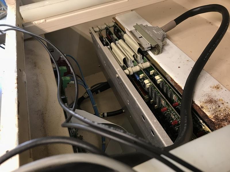

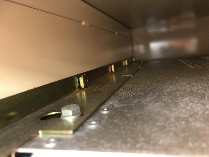

To get better visibility I removed the filter from the vent and shone a torch in revealing  a niffty bracket along the top of the controller stopping it sliding forward.
It was at this point I dropped the torch inside and no way could I get my fingers to it  :bang:

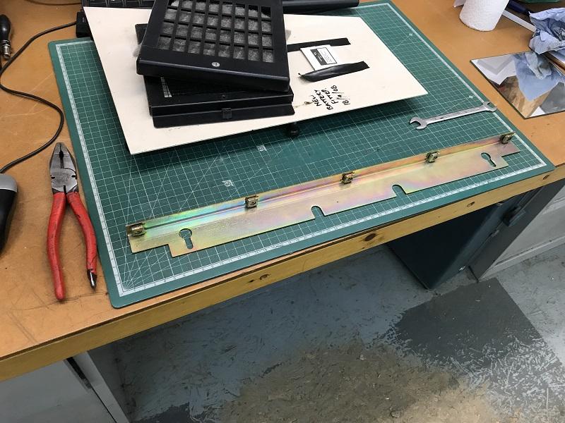

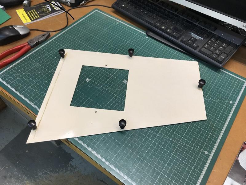

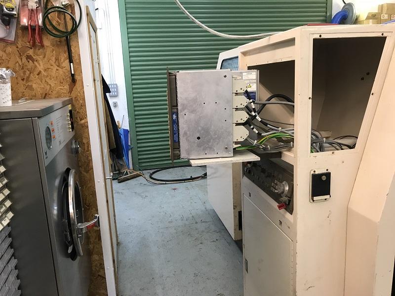

However feeling about inside as far as I could reach I discovered some Bakelite knurled headed screw knobs holding the surrounding panel in place. They were far too tight for hand unscrewing, and gripping them with pliers took some major contortions but they all came off in the end allowing me to unscrew the panel, get my hand in further to rescue the torch, and also see that the square holes under the controller were obviously intended to support a temporary shelf to pull the controller onto.
I cut some 3/4" square bar to make two supports for a bit  of surplus aluminium plate as a shelf, and reached in and was able to unscrew the retaining bracket

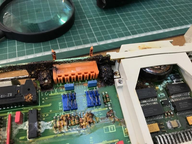

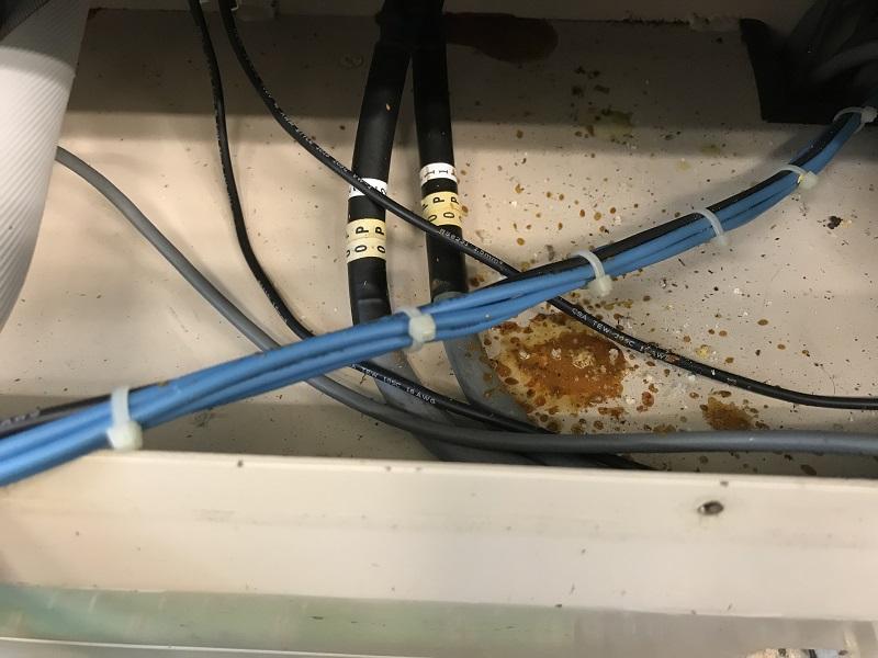

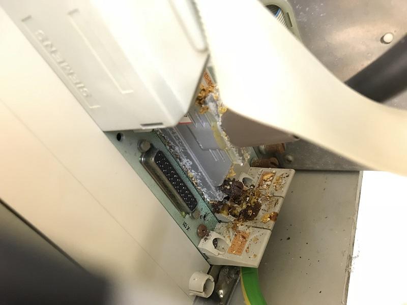

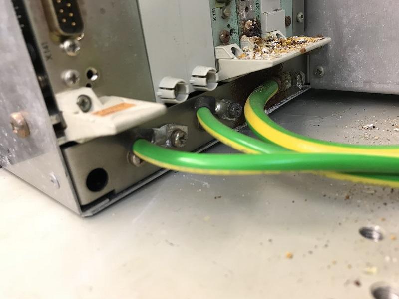

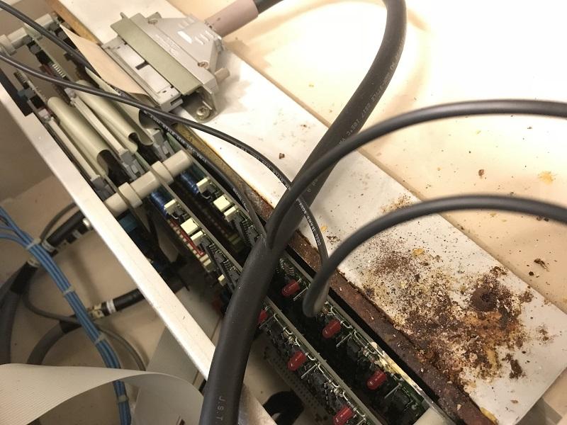

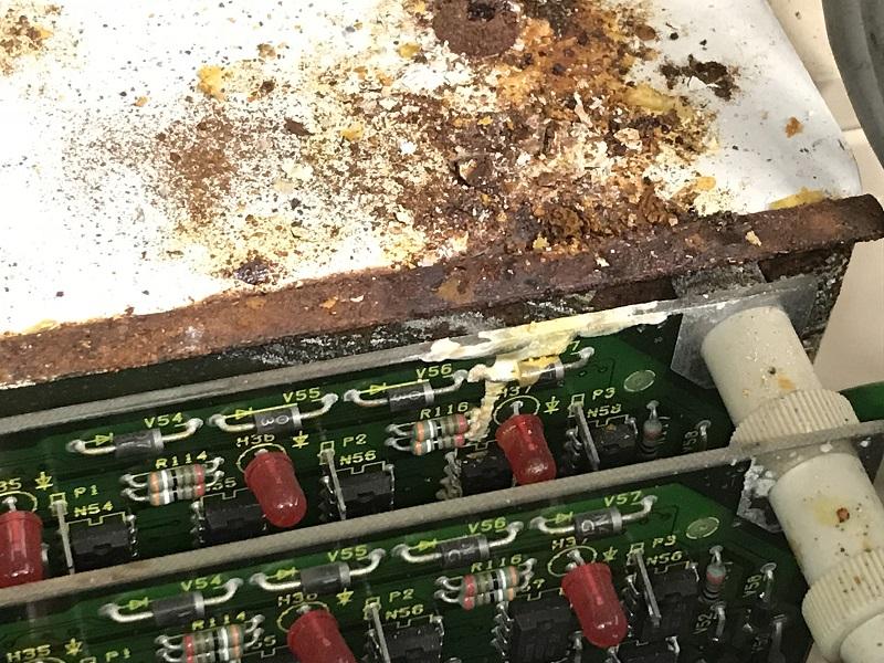

So at last the rear of the Controller is revealed, but so is a lot more corrosion, and absolutely no sign of the back up battery  :scratch:
I'm sure the horrors MUST have been caused by a leaking battery, but I cannot at the moment see it, OR it's holder - very strange.

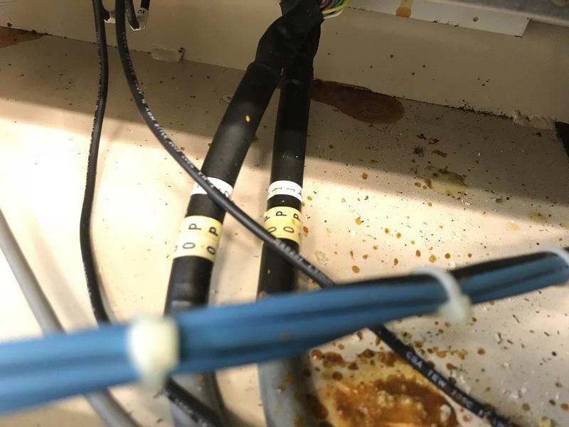

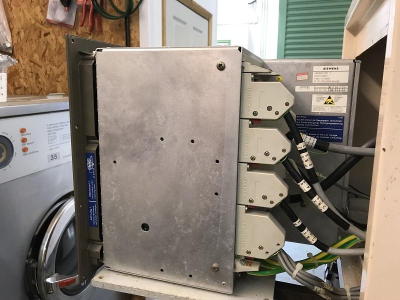

Progress report:
This mornings objective - get the controller out of the machine and find where the battery is / was.

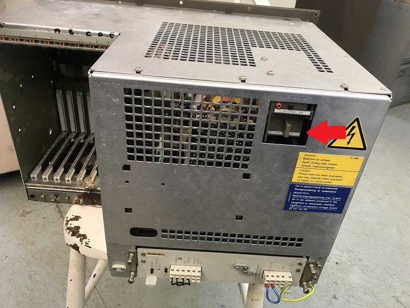

I went round arbitrarily labelling cables and their associated sockets so that I stand some chance of getting it back as it was , then it was a case of unscrewing socket retainers pulling cables off and withdrawing the controller. Some of the badly corroded fixings on cable shell sheared off not surprisingly.
(many of these pictures are for record purposes so perhaps a bit boring - sorry :scratch:)

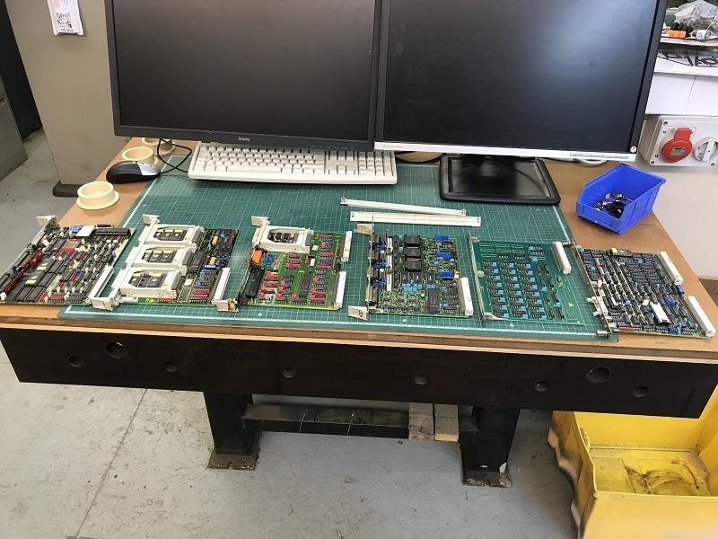

  • Posts: 9072
« Reply #33 on: June 13, 2018, 06:02:25 AM »

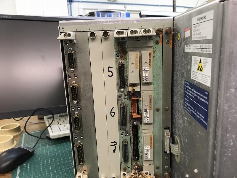

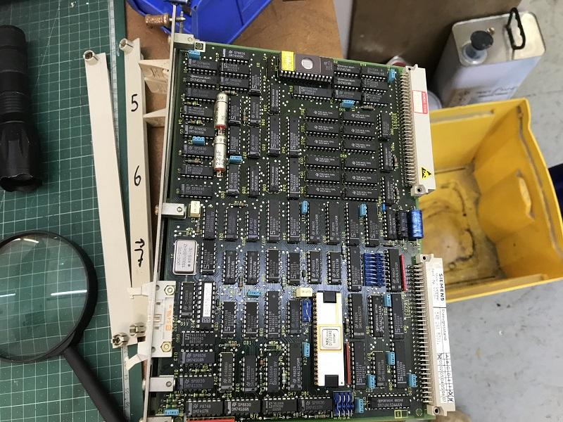

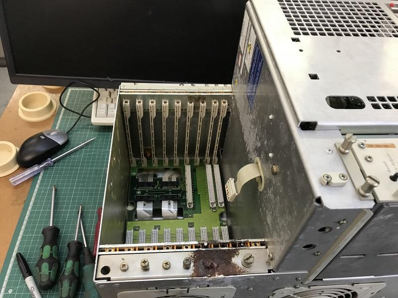

So with the controller on the bench I attempted to remove all the cards from the card cage - again in places the corrosion defeated screwdrivers and some screws had to be drilled out.
But finally all cards were removed from the card cage - quite a bit of electronics here  :bugeye:

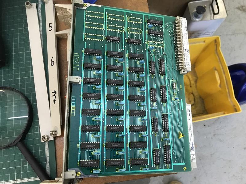

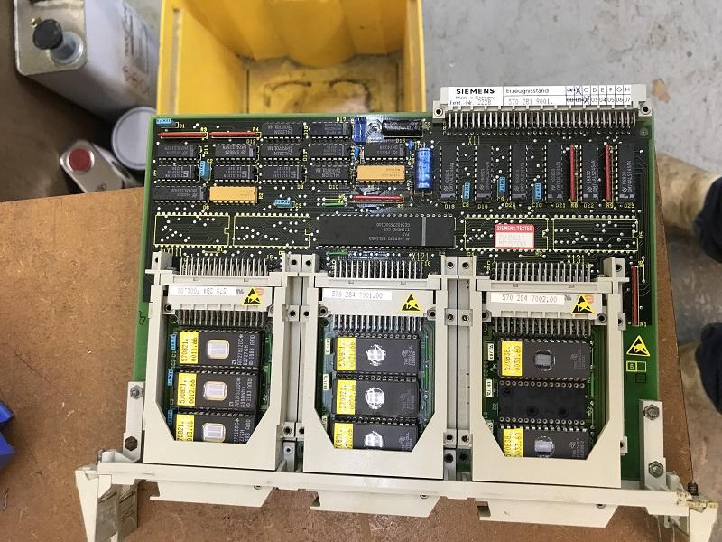

  • Posts: 9072
« Reply #34 on: June 13, 2018, 06:15:21 AM »

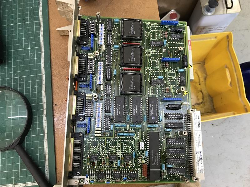

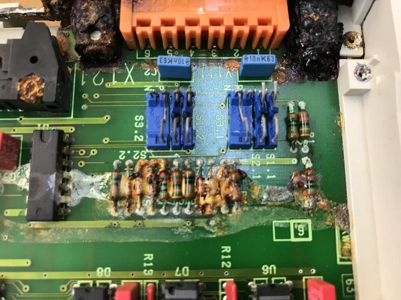

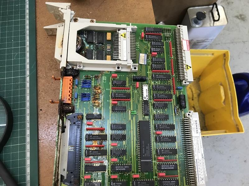

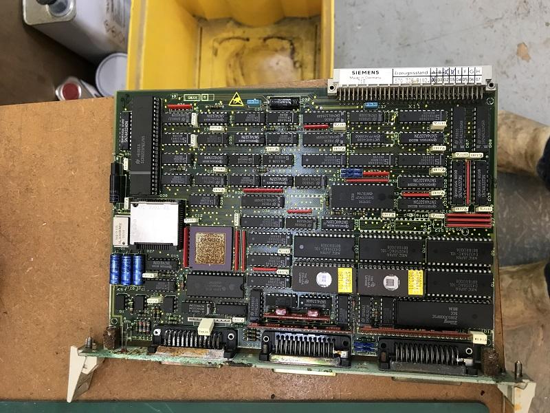

Now Card-B would appear to be the root cause of all this corrosion.
It holds a plug in sub-module with the culprit battery backing up four 32k x 8 bit static rams. The battery has swollen, presumably burst, and dribbled it's contents down this card. Also on this card is the interface to the Probe, the MPG module and the I/O module
It is possible that this card and sub-module are recoverable, but it would be highly desirable to replace them . Apart from the 48 pin big i/c which I assume to be a custom LSI, all the other i/c's are standard LSTTL from the 7400 range
  • Posts: 9072

"Card B" = 570 212 9202.10
Sub Module with the RAM & Battery = 570 342 9101.00

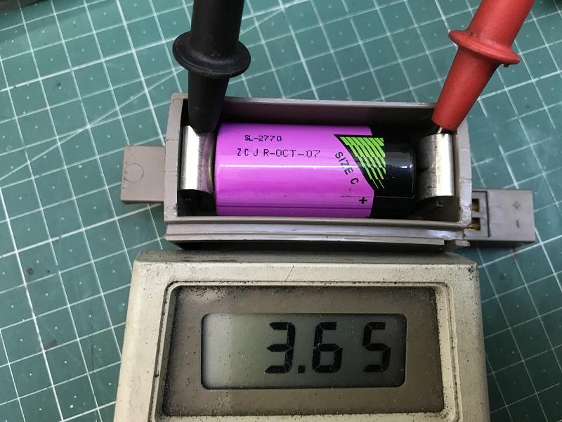

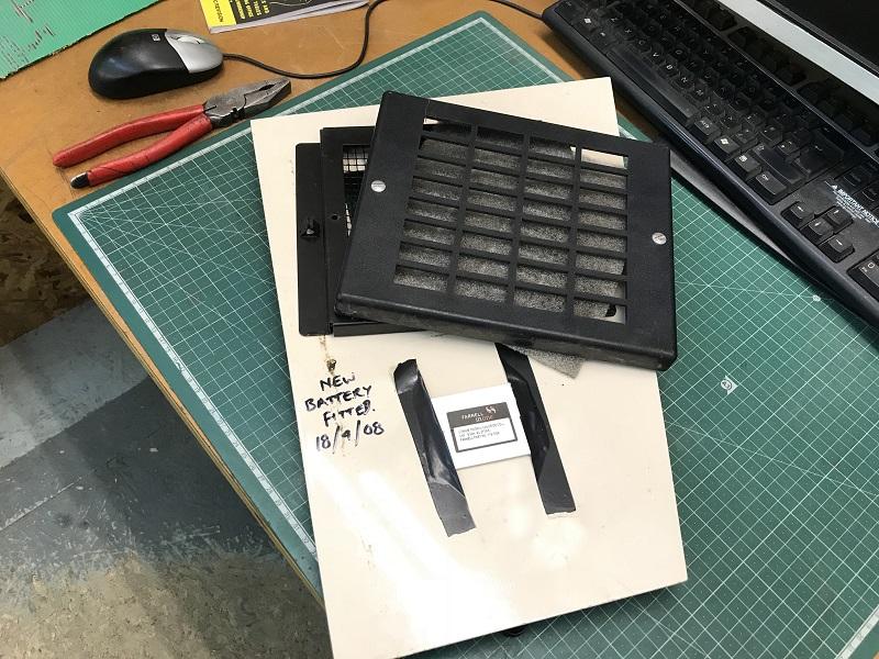

  • Posts: 9072
« Reply #37 on: June 13, 2018, 10:15:54 AM »

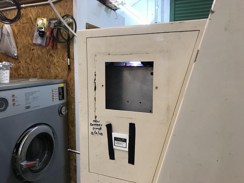

Well Pete, the sticker says that the battery was changed  18/09/08 so best part of ten years ago . . but which battery are they referring to . . the other one mounted in a sliding drawer over the CRT unplugged reads  3.65 but drops to 0.15 volts when plugged in according to it's monitor points, but they don't seem to go directly to the battery - four wires leading away from the tray into the depths of the controller. To get that (good until 2007!) battery to drop to 0.15 volts I have to load it with 2.2 ohms so obviously those wires are going somewhere else !
Progress report - that badly corroded Card-B - I've manage to source one in Germany for a modest £50 including postage, but not the little sub module yet. I can find very similar ones that have some components missing from the board. I suspect that as the controller evolved they went away from battery back up and went to NV Ram, altering that little board to suit
I have powered up the Power Supply and the 5 volt line at least is working - it provides +5 volts and and +/- 15 volts but I can't find a convenient point to monitor the +/- 15. I took a chance and plugged all the cards back other than Card-B and the PSU held up , there was static on the monitor screen and the one LED on the cards illuminated

Yes quite feasible. The problem comes if the electrolyte from the battery has destroyed any of the copper traces.
I suspect if I were brave, a good wash in hot water might dissolve a lot of it, and where rust has been washed down a card, a light brushing of citric acid to remove the Fe2O3, but I'm not sure what effect it would have on the tinning on the ic's legs. It also rather depends what's been washed under a chip. Some of the devices are surface mount so no gap but stuff will have crept into the tiny space that must be there.
