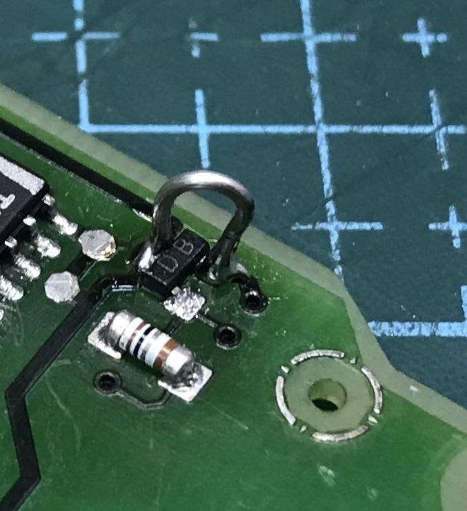

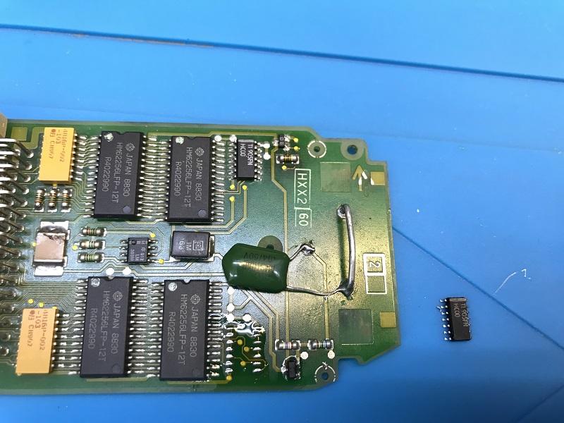

Some more progress. I've linked out the faulty transistor from Collector to Emitter to allow me to carry on testing. This transistor is involved in the switching to / from battery back up so in this mode I can do without it!
This has let me prove that A12 inhibits all Chip selects when low, and the other four control lines (B13, B14, C13, C14 ) provide Chip Select for each individual Ram chip.
All a bit odd, but workable.
The picture of the link across the SMD transistor emphasise how small SMDs are - that huge hoop of billet is actually the lead from a tiny 1/8 watt resistor  :clap:

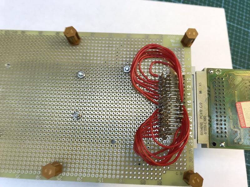

« Reply #1228 on: September 07, 2021, 05:08:52 AM »

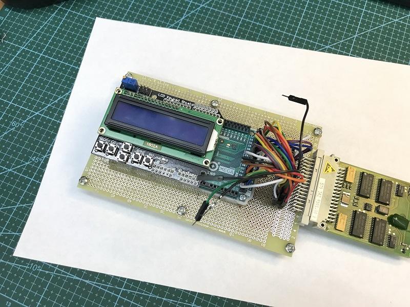

The bread board having arrived has let me think a bit more about the physical side of further testing, or rather  oscilloscope probing of the board under test. As most components are SMD's, unlike through hole devices you need to be able to probe both sides of the PCB. This dictates that either I stand the board vertically (which makes getting at it a pain) or have the board connector hanging off one end of the breadboard.
I've chosen the later method but this has persuaded me to incorporate header pins to connect to the Arduino rather than as I had previously intended - using directly soldered flying leads. My drawer of rows of header pins is a bit on the low side so an order has been placed with RS.

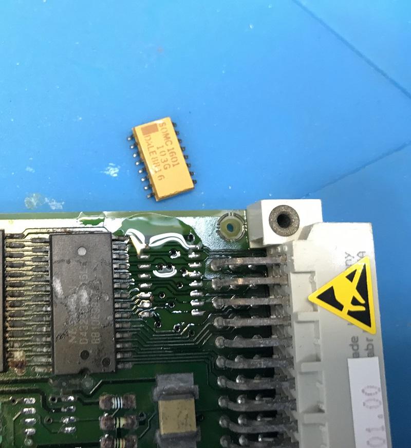

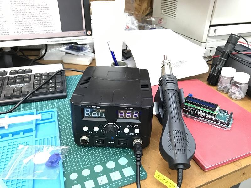

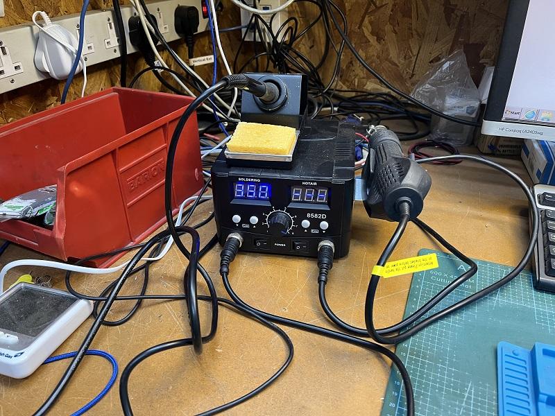

My 'Hot Air Re-work Station' arrived by post today. I have to say that I am impressed with what you get for your money. (£36.67 plus post - total £44) and it seems quite well made. My photo doesn't show it but a temperature controlled soldering iron is included in the kit that plugs into the base unit.
A bit busy today but I had to try it out. I removed a resistor pack from the original RAM card that got dissolved, and it seems that the pack is in good enough condition to re-fit if needed, so a good result for a first effort.
I need to research what temperatures to use - the solder melts below 200 deg C but most on line sources say use 250 which is what I did. But what temperature can IC's stand and still survive?

I got a  bit more time this afternoon, so decided to remove at least one of the suspect 74HC00D SMD chips to find why A12 wasn't floating 'high' as expected.
So - first chip out and I powered up and A12 is still 'misbehaving' - so then I took the second chip out as A12 connects to two gate inputs on both chips. Argh - A12 STILL misbehaving  :bang:
OK what's going on here  :scratch: Well it turns out that the termination of these five control lines is not a simple 10k pull up to 5 volts,  but also a 10 k pull down to 0 volts.
All five control lines pull up to 5 logic high and down to logic low with a 1K5 resistor so it's all been a none problem - how very familiar !
OK something else learnt, AND practice using the SMD hot air gizmo. I decided to re-install the two chips and darn me they have survived the exercise and still work!
But I MUST sort out physical connections to this board - pushing female jumper leads onto the edge connector is very unsatisfactory - I must knuckle down and solder up the bread board that I now have.
Still - happy that I can not only remove SMD chips but also put them back and they still work  :clap:

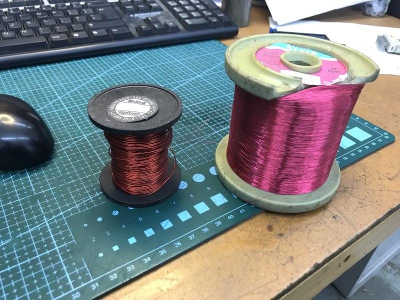

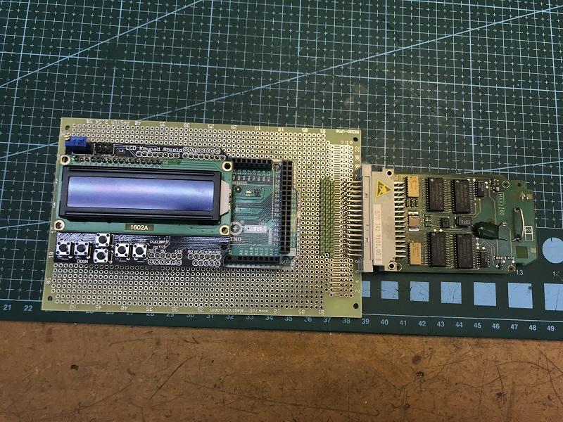

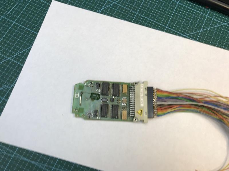

So why haven'i I done the breadboard yet?
Well I've been waiting for inspiration to get over a little 'problem-ette' - the bread board designer certainly laid it out to take a DIN41612 three row 48 pin socket, but only the outer 'A & C' rows of pins are brought out to the body of the board - row 'B', the centre one, is all on it's ownsome lonesome and will need jumpers, which cannot be on the component side if the socket is to sit correctly.
OK it's only 16 links - 32 soldered joints - but I've been trying to work out ways round it ! Years back I'd do links like this in 'self fluxing' enamelled copper 'magnet wire' where a good hot soldering iron would volatilise the insulation, but I'm not sure if I have any left - time to go hunting in the wire stash  :lol:
The plan is to have the Arduino fixed to the breadboard as you may well have gathered from the picture.
 . . . I'm off wire hunting . . .

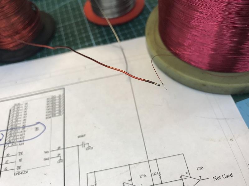

« Reply #1234 on: September 08, 2021, 12:41:50 PM »
Well it seems that I have :thumbup:
Buried in a dusty box I found two rolls of self fluxing wire - one rather too thin and the other rather too thick - oh well 'it'll do'
Iron needed cranking up to 475 degrees C to effectively remove the enamel, but it DOES work !
More experimentation later I think

I assume you are using leaded solder? That melts at a lower temperature but either way, the reflow temperature profile is often given in datasheets these days. The actual reflow part of the process is typically around 230-250C for 45-90 seconds or so for lead free solder. Pretty much everything made these days is SMT, so all compts are designed to tolerate those temps without degrading.

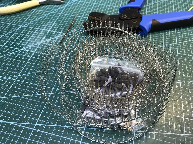

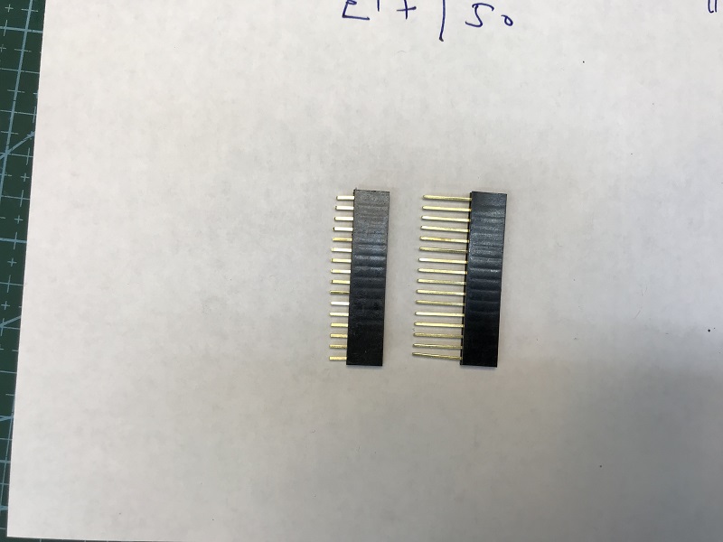

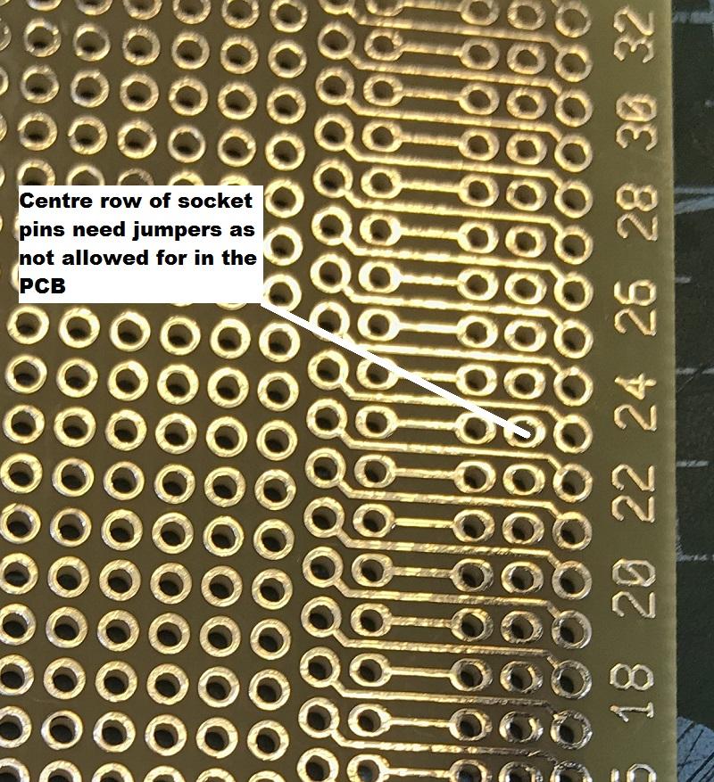

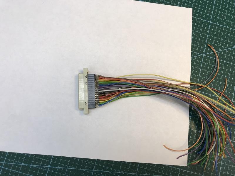

As expected, soldering jumpers to the centre row (B) of the DIN4161 connector was a nightmare. Poking a soldering iron down between the pins inevitably scorched the  insulation of previously soldered wires. I thought perhaps I could use PTFE insulated wire - I have some the right size, but frankly I've never been able to satisfactorily strip the insulation neatly and to correct length - it always ends up a mess.
Then I thought, if I can find a crimp version of the connector, I can put it on pigtails off the board and solve the issue. Sure enough, Harting part number 09230483217 is the right part - but it's on a ten week lead time from all the normal UK suppliers so that rules that out!
OK the socket that I have has solder tails intended for a PCB, BUT 16 way female socket headers fit them rather nicely - three of those and I have a hopefully working solution. Solder the three headers individually thus making the 'middle row' a none issue, push them on the back of the socket and hang the socket off the board on a short umbilical cable This also makes inverting the board for test far easier.
But as the female jumper leads that I've been using with the Arduino were themselves rather unreliable - falling off at a mere touch, a better breadboard solution was also called for. I've found one with screw terminals AND header sockets so this may be the best of both worlds.
. . . . we'll see when it arrives !

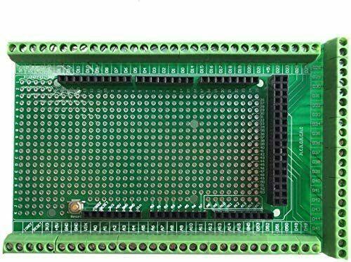

« Reply #1237 on: September 13, 2021, 09:41:52 AM »

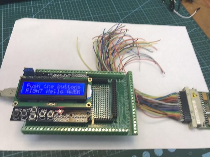

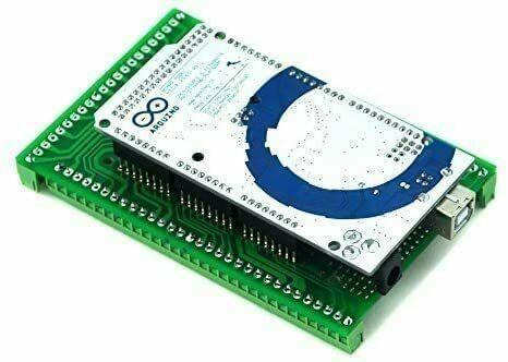

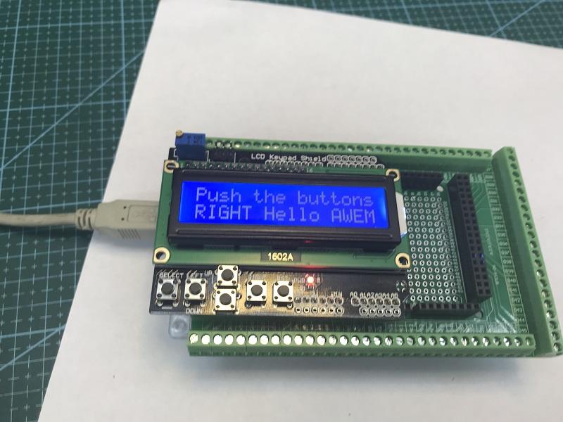

The new breadboard with screwed terminals arrived today. Very confusing when you buy from eBay and an item is delivered by Amazon in Amazon packing !
I must say that I'm impressed by the build quality and it looks like it will meet my needs. I'm now waiting for a delivery from RS of '0.7 mm Boot Lace Ferrules' that will plug into the existing female push fit sockets AND go in the screw terminals (keeping my options open). I do have 1 mm boot lace ferrules but although they fit the screw terminals they are no good for the push fit ones./
. . . . getting there slowly - one tiny step at a time  :thumbup:

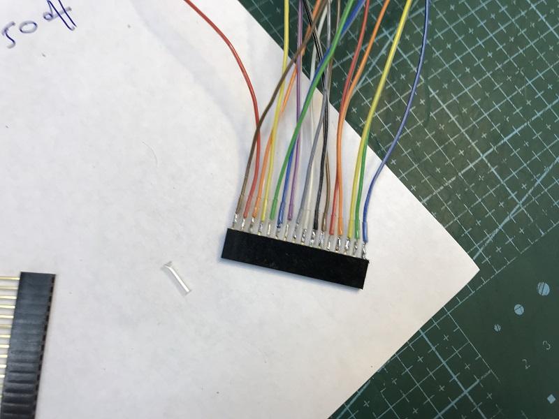

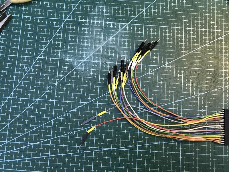

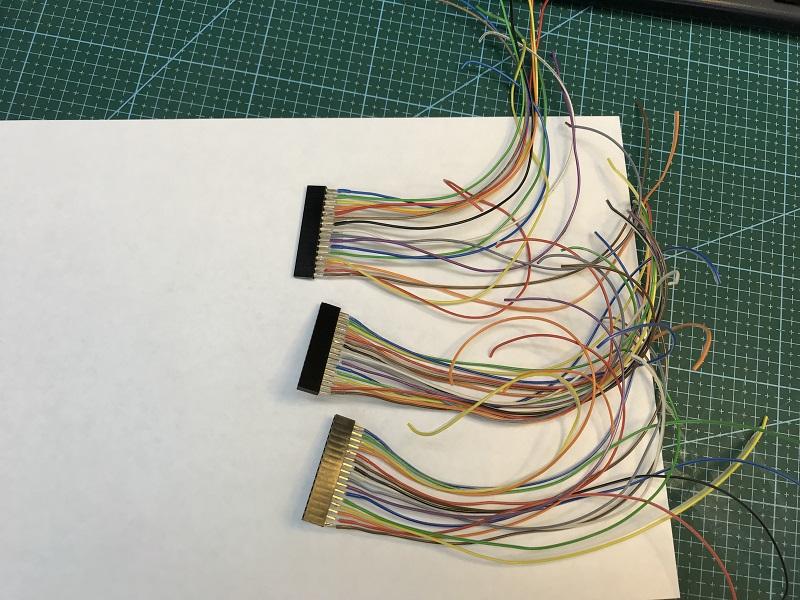

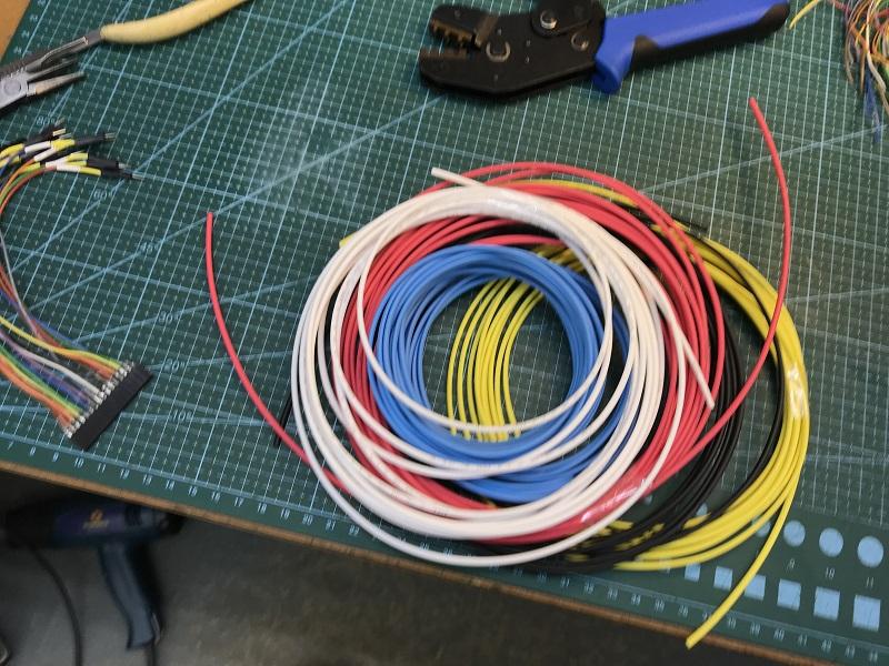

Things have been a little slow on this project - RS Components let me down on the bootlace ferrules that I'd ordered. Unusually for them they arrived a few days late and when they came they were not the same spec as described in the catalogue. I needed ones with an O/D of between 0.65 and 0.8 mm. There were two types catalogued with O/D 's of  0.7 and 0.75 respectively so I had ordered some of each. When they arrived they were 1.05 and 1.1 O/D. I/D had been specified by cable size and they had entered the I/D as the O/D in mm. They were gracious enough to acknowledge their error and the engineer even went to the trouble to confirm that it was only this size were mis-described. No big deal but it's cost me a few days when I could be getting on with things !
So I've reverted to 'Dupont' pins - which I don't particularly like as they are a bit fragile, but needs must, and of course this incurred a further few days of delivery delay.
OK we are where we are ! So today the coloured heat shrink arrived allowing me to code up the 48 wires. There are three banks of 16 wires, cabled in correctly colour coded wire, but being 1 to 16 each bank has two 1's 2's .... 6's. So each bank needs a sleeve to indicate which it is (A=Yellow, B=Red, C=Blue) and in each case wires 11 to 16 have a white sleeve to differentiate them from 1-6. This may seem pedantic, but believe me without this detail things rapidly get very confusing when fault finding !

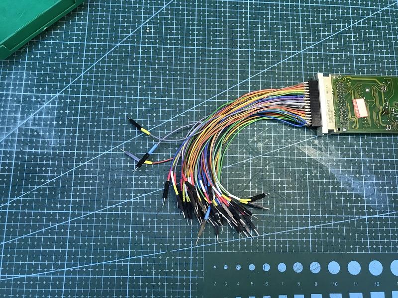

So this morning I have done the wires and crimps of 'Bank A' and I'll give my eyes a rest until a bit later to stop me going cross eyed !

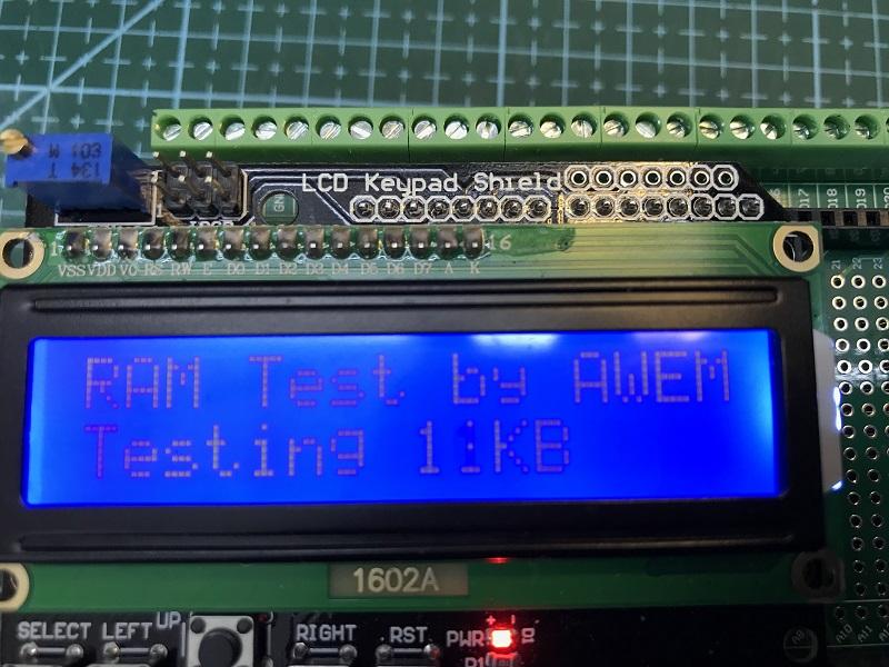

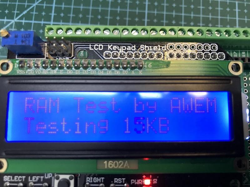

Meanwhile the programming of the test program has been progressing but isn't yet finished.

« Reply #1241 on: September 20, 2021, 11:01:50 AM »
So I got the remaining rows 'B' & 'C' crimped and sleeved so now at last perhaps I can get down to proper testing!

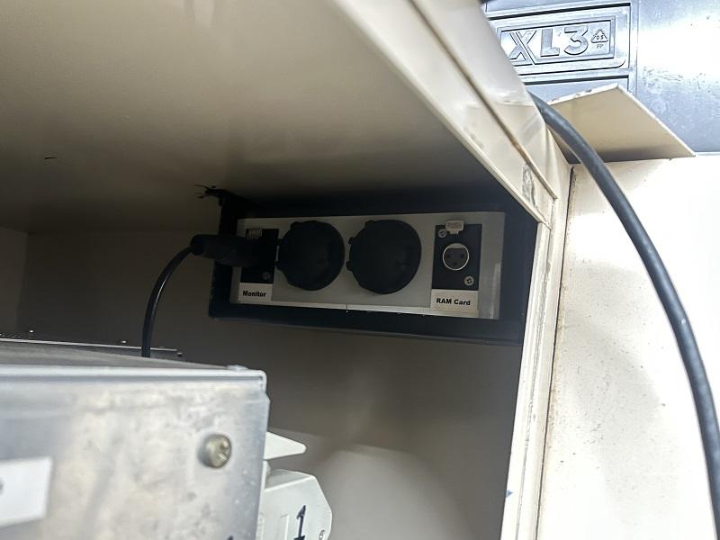

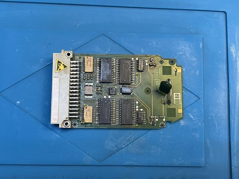

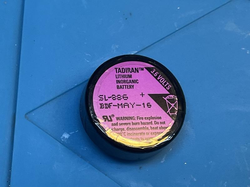

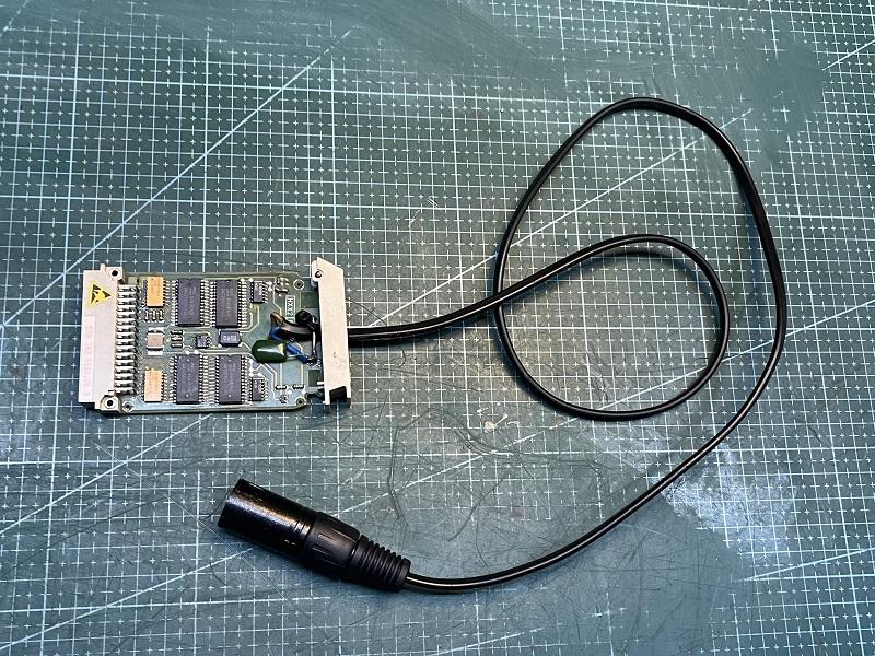

Revival of an old thread - but at last I've got round to doing something that's been on my list for well over a year.

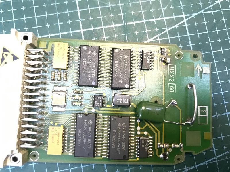

You may recall that the original demise of this machine was due to the lithium 'Tadiran' on PCB RAM back up battery having let out its juices and dissolving much of the Siemens CNC controller, so when I got it all working I mounted a remote battery in a leak proof case away from the electronics. This worked well but a few months (years maybe?) later we had an electrical storm IIRC that took out the little ram card that the battery had been mounted on.
This card backs up many setting and parameters of the machine and is vital to it's operation. However they are rare as hens teeth and come in several incompatible versions. I eventually found one that 'almost worked' - every thing was fine EXCEPT for a look up table that is stored on this card that translates error numbers to plain (ish!) English. Load sequence worked but errors still show as numbers not text. I spent weeks reverse engineering the RAM card - and manually proved that all the addressing and other peripheral logic on the card was fine - but what about the RAM chips themselves - was one faulty.
I then spent several fruitless weeks trying to make a RAM tester using an Arduino but never got a good setup, and the bits have been om my desk in the workshop for well over a year - glowering and nagging me.

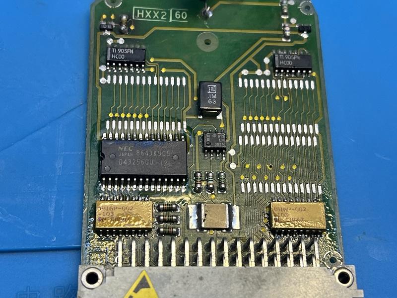

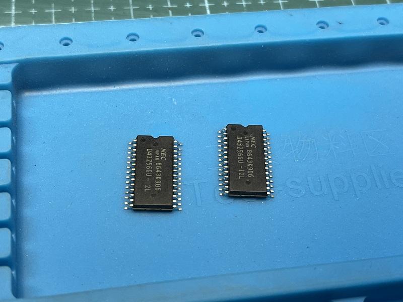

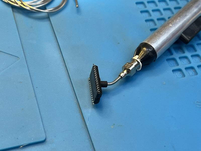

Well I decided - hang it, source the RAM chips and change them ! They are four 28 pin surface mount NEC D43256GU-12L  -I found a source of the chips - bought myself a cheap SMD rework station and . . . .bottled it ! My eyesight was never good and with anno dominae isn't getting better.
However today I braced myself and made a determined effort using a bench magnifying lens.
To remove the original chips I used loads of flux and Quick-Chip ultra low melting point solder. Strange stuff - extremely brittle and stays molten for a long time allowing the old  bits to be removed. However due to this brittleness it is important to remove ALL of it before soldering in the replacements. I used normal Solderwick again with loads of flux, then cleaned up the mess with IPA.
Much watching of YouTube videos told me the virtues of 'drag soldering' - never heard of it before - but essentially you anchor the chip at opposite corners by conventional soldering with a very fine tip iron - then load the tip with excess of solder and drag it across the remaining pis, where the excess of flux and surface tension pulls the solder into the places that it's needed. Amazingly the process seems to work - I had a couple of solder bridges but they were cleared fairly easily.
So after a lot of flux clean up I re-assembled the RAM card with it's retaining handle and umbilical cord, and now I need to find the time / courage to try it in the machine. Lengthy re-load procedure so not today.
Still I overcame the SMD soldering issue and fears  :thumbup:

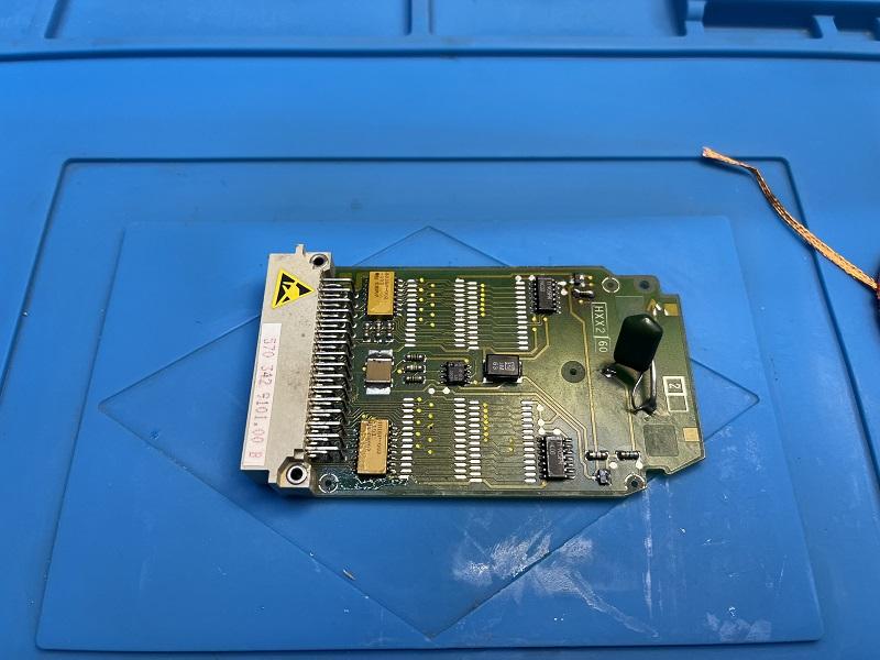

« Reply #1246 on: July 09, 2023, 07:58:38 AM »
Well that was a fruitless exercise  :(
Initially I steamed up my copy of DNC4U intending to talk to the lathe and check its comms as I've not used it for some months. The program said "What Interface?" - my Startech USB to 4 port serial box that's been working for years was only showing two of it's four serial ports and thus the Beaver wasn't connected.
Much faffing about with USB cables USB hubs UPS power sources - PC re-booting and yes at last it found the remaining ports that even still had the correct settings.
OK find a directory with the correct back up to re-load, unplug the RAM card with integral battery, plug in the one where I've changed the RAM chips and not surprisingly it comes up wanting reloading. First step is to power the control down bring it back up pressing the "Eye Key" which is used to get into the set up side of the control. Well it won't come up at all - blank screen - zilch.
Revert to RAM card with integral battery - up she comes and all is well
Try two more times with my 're-chipped' ram - same symptoms - argh we are no better off than we were but at least no worse.
Could be faulty RAMS or more likely forgeries - oh well, slink off and lick your wounds  :bang:

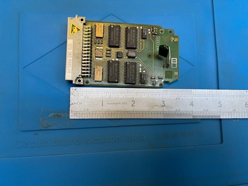

The frustration is Phil, I have a perfectly good 6FX1134-2BA01 128K RAM card in the system, but it has the onboard battery, and it was one of these batteries that caused all the issues in the first place.
I don't want to unsolder its battery and connect it to the remote battery until I have a working spare, as if I can't reload it the lathe will be unable to function.
I've fired off an email to a repair company to see what astronomical fee they'd ask to either supply or fix - we'll see what happens !
