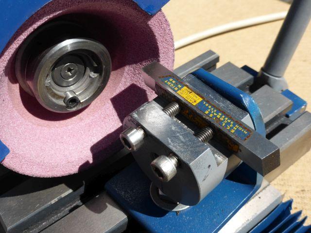

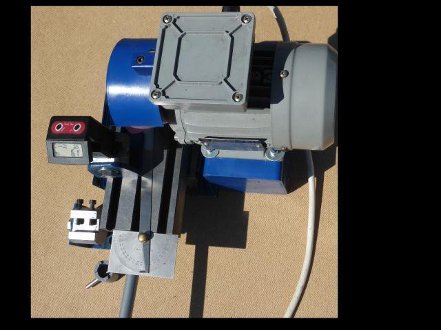

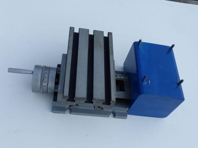

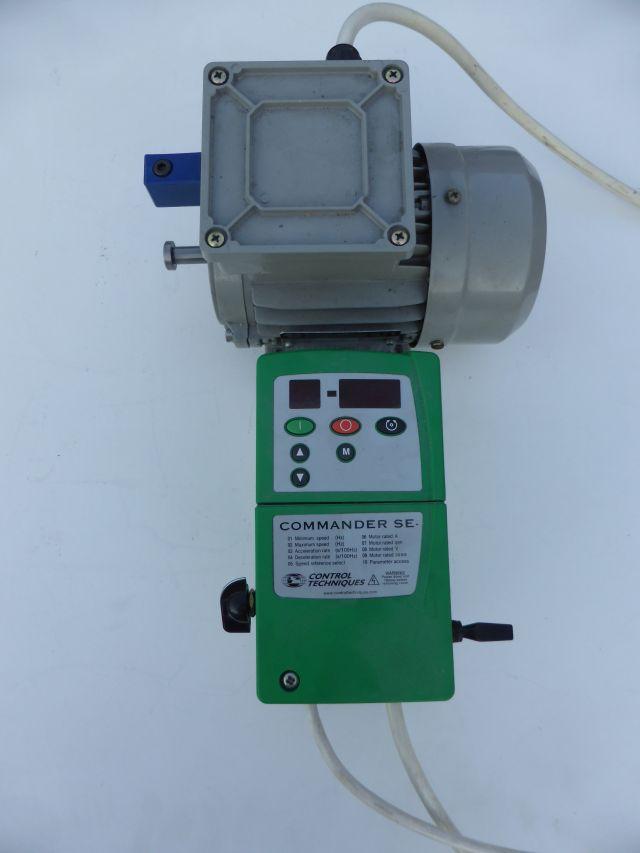

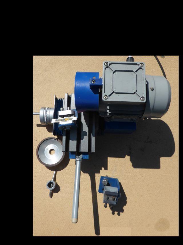

As promised here is my lathe tool grinder. A compound table was part of the deal when I ordered my lathe but I had never used it. The lathe was single phase, so I converted it to three phase using a VFD. The VFD was a bargain and I got a further discount for buying two. The hunt was then on for a small, 0.25Kw, totally enclosed, 2,700 rpm motor. Luckily a local supplier had one at a good price.
The motor support was made from a short piece of RHS (square tube 0.125 wall) with end plates welded in. The compound was held to this tube with 4 M8 screws. Not wishing to have the lead screw on the long axis, I made up a lever attachment, which makes the grinder  easier to use. To keep the dust off the cross slide I made up two bellows from acetate sheet. Not an easy thing to do, had to get some tips from Utube! However, they spray painted up OK.
I am happy with the end result. The VFD means I can run the motor at the correct speed for both the grinding wheel and the diamond cup wheel.
Ian

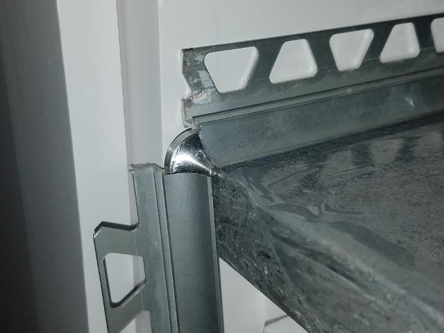

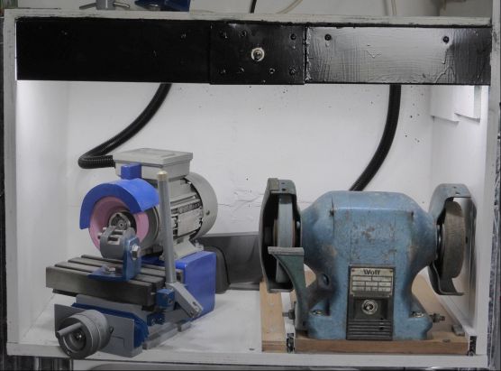

Decided to make a dedicated grinding "cupboard". The venerable Wolf double ended grinder is mounted on a pair of drawer slides so that I can pull it out and lock it in position when polishing on the right hand side (Beartex wheel). Slides are cheap enough to replace if the dust ruins them.
At the back is a fishtail from my Vax vacuum to keep the dust flow away from me.

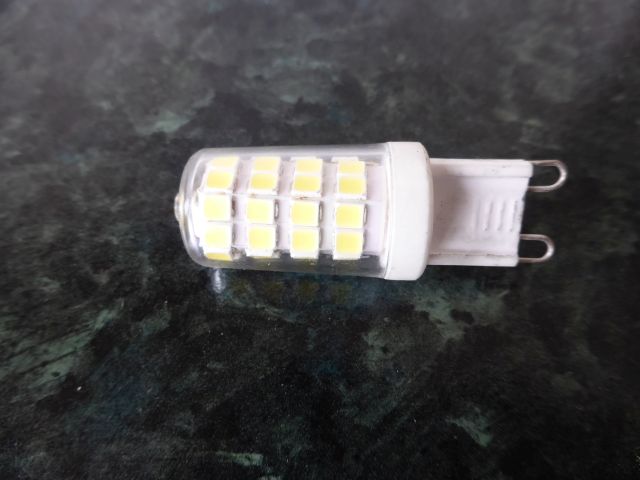

Lighting is provided by four LEDs - G9 base 240 volt 5W 340 lm. Plenty of almost shadowless light (and ideal for extracting miniscule brass splinters!).

dvbyvt, that looks handy. How do you lock the grinder in position?
(ps. smaller photo would help -- 800 pixels across max is suggested for this forum -- I can only see a bit at a time while scrolling)

The grinder is locked with a wooden peg going through the slide mounting into the base. I only has to resist grinding an polishing pressure.

Is there any problem with vibration when it's extended out on the drawer slides?

Vibration is not a problem. It might be if the wheels were unbalanced,

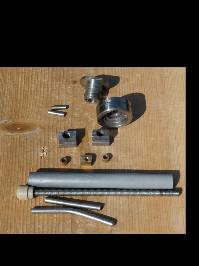

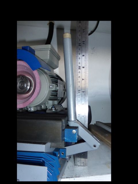

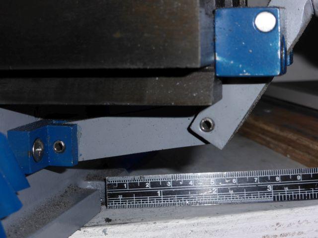

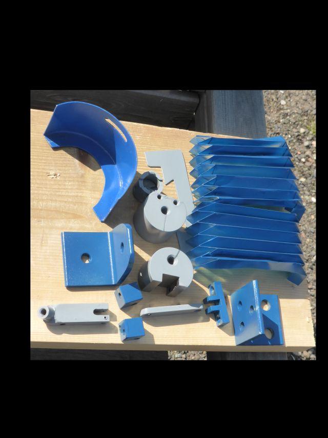

Say Ian, if you're still watching this thread could you please show how your cross-feed handle moves the table?  I'm a little dense sometimes.  I've looked at your parts pictures several times but the linkage movement escapes me. :doh:
Milton in Tennesee
Offline dvbydt
  • Posts: 83
Re: Little lathe tool grinder.
« Reply #26 on: October 02, 2018, 04:03:37 AM »
I will reply but I am away this week. I will take a picture for you when I return.
The grinder is still working well.
Ian
Offline dvbydt
  • Posts: 83
« Reply #27 on: October 10, 2018, 09:46:08 AM »
Back again - do these give the information you requested?
Ian
Offline DICKEYBIRD
  • Posts: 229
  • Collierville, TN ya'll
« Reply #28 on: October 10, 2018, 10:25:53 AM »
Click...the sound of the light bulb switching on above my head!  Very clear, thanks Ian! :beer:
