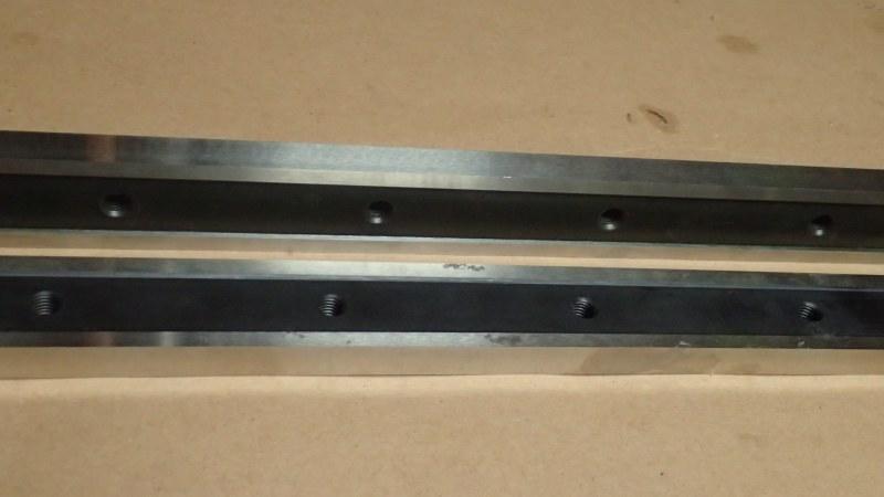

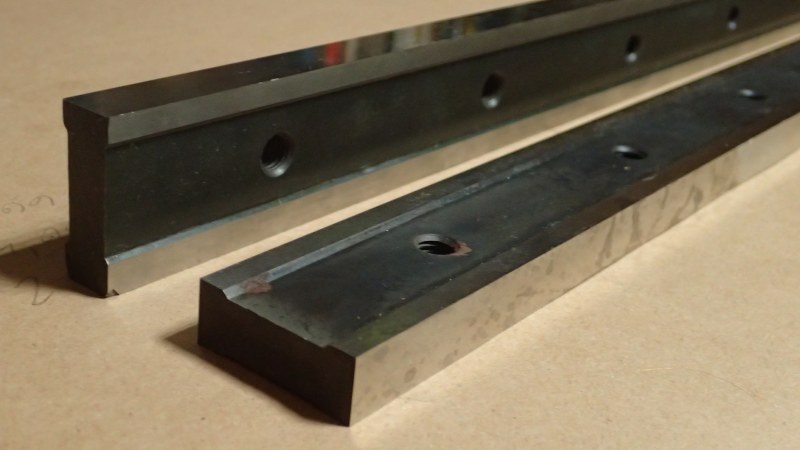

Have been googling some sheet metal tools and it looks like most of tools have been made DIY, but can't really find too much material on self made sheet metal cutters.
While cleaning, I found two pieces of pretty hard steel 12 mm thick and about 32 mm tall, threaded holes on the middle.
Could these be from sheet metal cutter?
Re: Thin sheetmetal folding, bending cutting.
« Reply #12 on: May 12, 2018, 03:33:42 AM »
They don't look like it to me! First of all, they are straight and secondly, they are symmetrical, my experience of shear blades is that they have one cutting edge.

« Reply #14 on: May 12, 2018, 03:25:22 PM »
They look like parallels to me check them for straightness , at that size they won't have been cheap .
« Reply #15 on: May 12, 2018, 04:15:09 PM »
I bought tmen 2:nd hand as parallels, one is pretty straight, other is wavy about 0,01 mm. Seller said they used them for setups on the mill.
Now I'm looking at them and they have threaded holes on the middle and look remarkably much like blades on swing beam sheet metal cuters. I have been googling.
