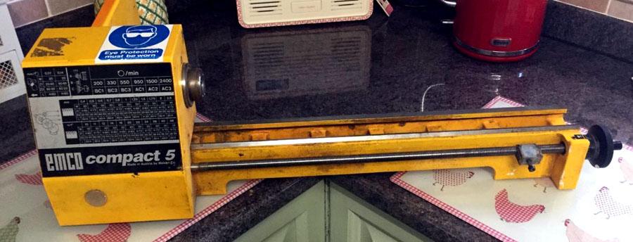

I decided that I needed a small lathe to make small parts as my Loughborough lathe has a slow top speed. I was thinking of something around 50mm centre height. Then on my daily scan through Ebay I came across an Emco Compact 5 lathe, just the bed, headstock, spindle and leadscrew at a good price, I offered 2/3rds their price and they accepted.
I already had in my possession an unidentified piece of equipment, hardly any use, that had two slides that could be modified to suit.

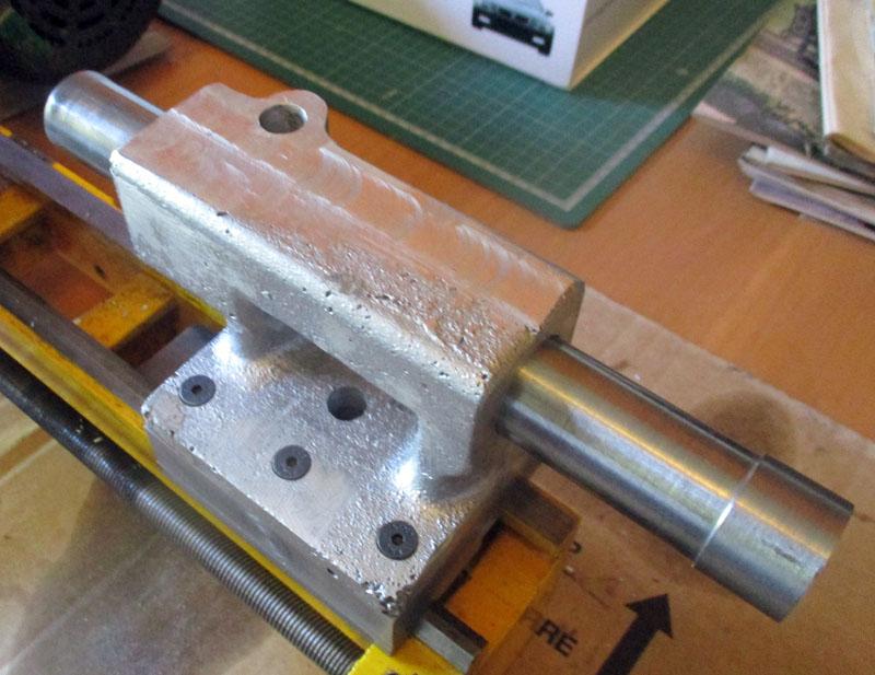

The next was to cast an aluminium tailstock that mounts on a steel sub-base. Hole through the centre if roughly drilled, undersize, for machining in situ to achieve alignment.

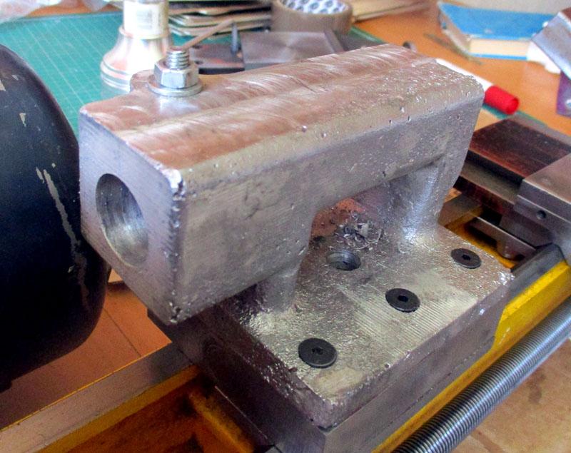

To machine the tailstock bore I made a temporary tailstock and a between centres boring bar. This bar is a bit on the thin size but it had to be that size to fit through the bore.

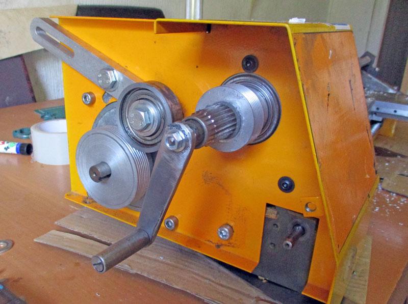

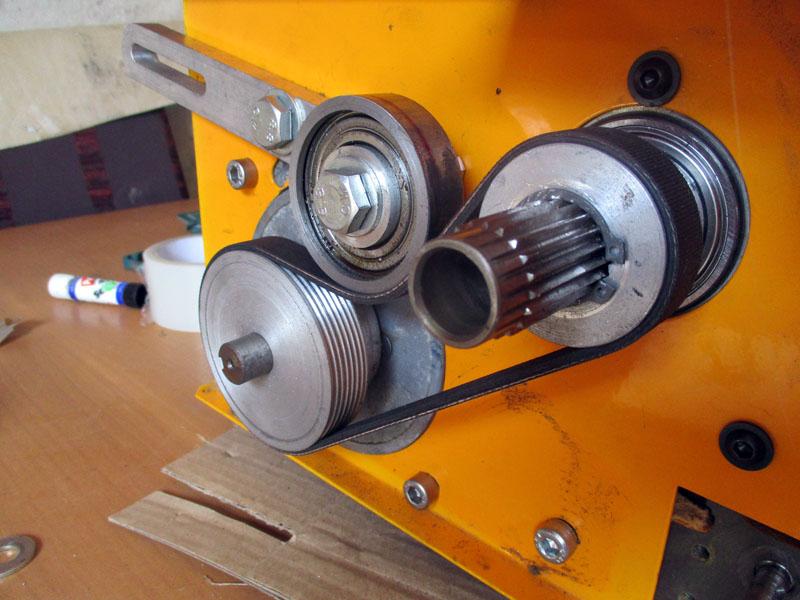

The motor that I shall be using is a 180volt 1/2HP DC motor that I have with a speed controller. Thus doing away with the necessity of shifting belts to change speed. (I have already used one of these motors and controllers on my milling machine and I know that it will be good.)
I am using poly V belts for the drive as they run quietly without slipping.
I have fitted new bearings to the spindle and I used one of the old ones to make an idler pulley to tension the belt.

As I have not yet wired up the motor and wanted to get on with boring the tailstock I made a handle to fit the spindle bore expecting it to take a long time but it has not been too bad. I have just taken a rest after approx. 45 minutes work. I am on the final cut with just a spring cut to go.

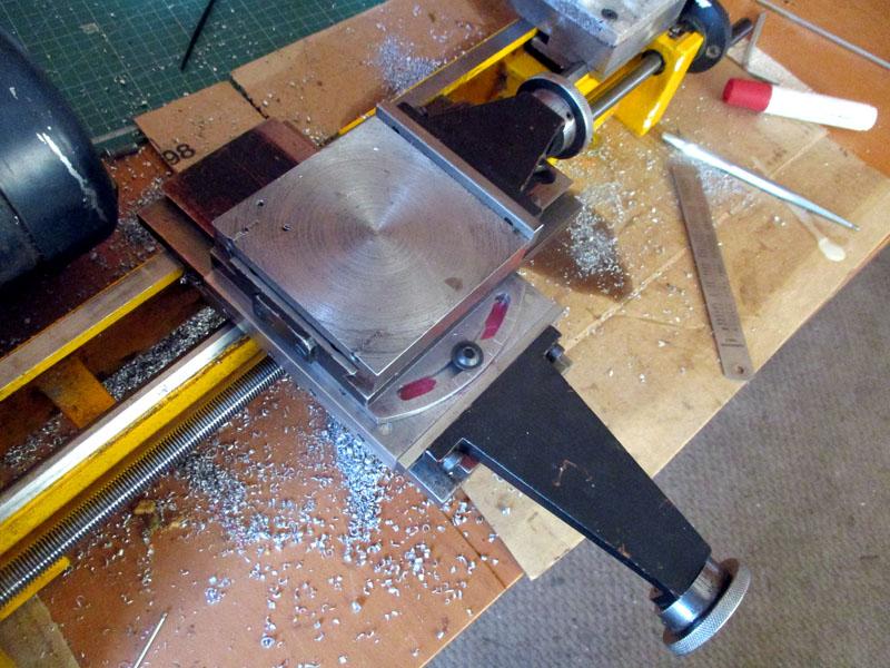

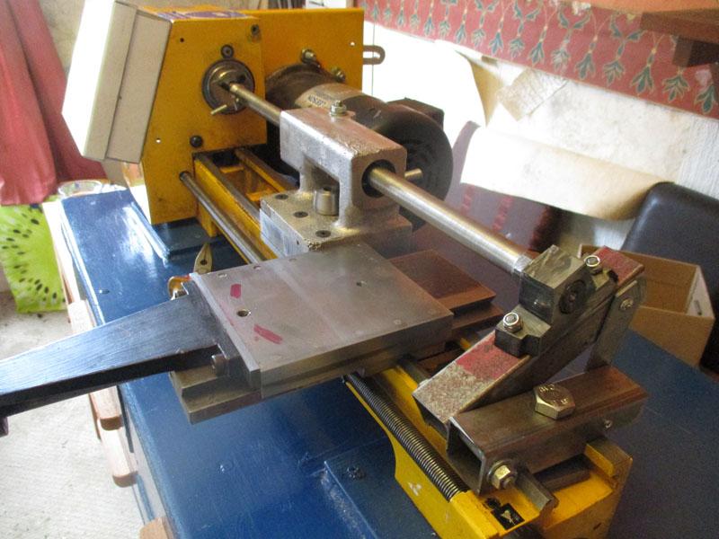

Here is the lathe saddle showing the cross slide and top slide. The top slide can be swivelled for turning tapers. It is not terribly convenient to do as I have to retract the topslide half way to expose the central locking screw but it did enable me to keep the size down.
Also due to the design of the slides the handles move with the slide which accounts for the long overhang of the cross slide handle. It won't affect the use but it does stick out a bit.

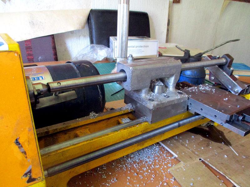

Yesterday I made the tailstock ram. The only material that I had was a piece of 1 1/2" Dia steel. This had to be turned down to 25.7mm (that was what the tailstock bore turned out at) and drilled right through. It weighed less than a third of the original weight by the time I had finished.
I drilled it first and then mounted it between centres to turn the outside. I was delighted to find that over its 220mm length I could not measure any variation in the diameter! It slides silkily smooth in the tailstock.
Today I am going to bore the front end MT2, that should be fun.
Just in case anyone wonders why I have made it so long, I intend having a lever operated tailstock as I understand that it gives a more delicate feel when using small drills. Is that others experience?

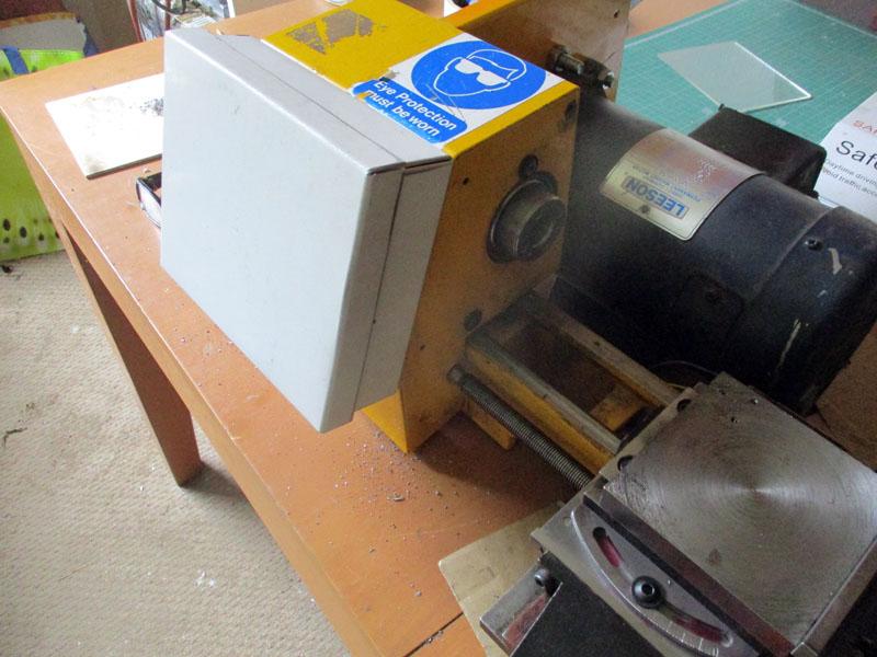

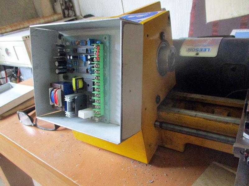

Latest job was to make the box to contain the speed controller. I don't have any equipment for sheet metal work so I used my angle grinder to cut out the 2mm sheet aluminium and to score grooves for bending. It turned out very well for me, even the lid fits!
There is enough room for the circuit board the on/off switch and the speed control knob, it should look quite smart.

Speed control board looks like one of those Chinese jobs from ebay?

« Reply #13 on: May 13, 2018, 06:57:53 AM »
It's one of two that I got from you. The other is working very nicely on my milling machine with an identical motor.

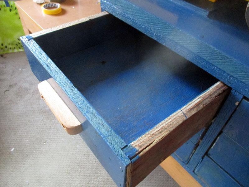

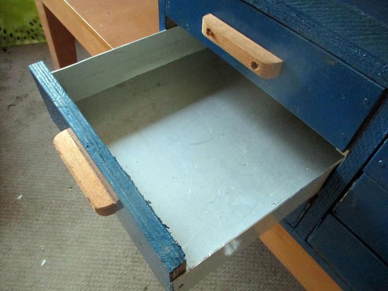

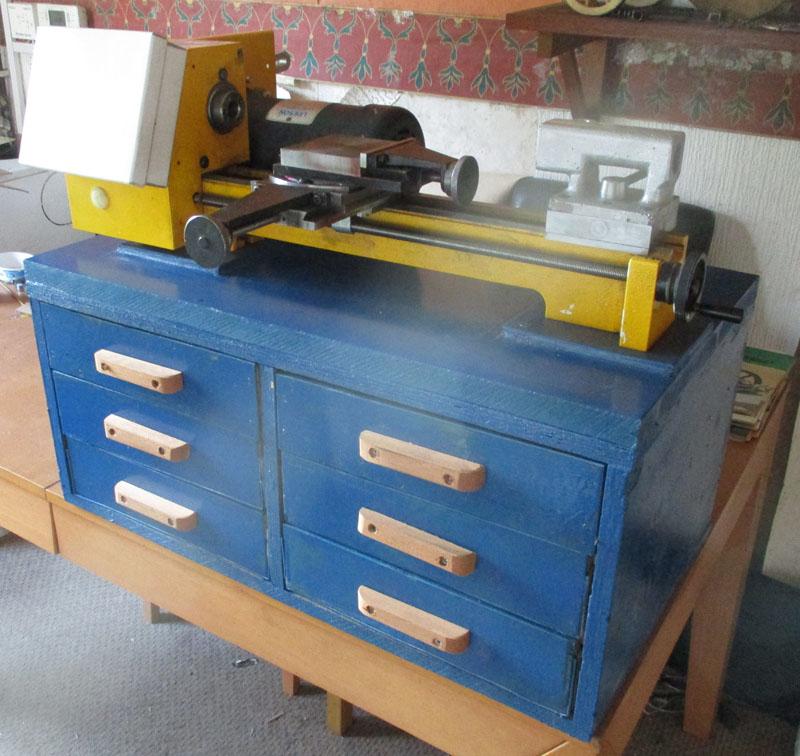

Whilst my main lathe is out of action I have been working in wood. This little lathe is very small and this would mean that I would have to bend over to use it. I decided to make a chest of drawers to raise it up to a comfortable working height and to provide storage.
I was lucky to be given some 20mm plywood so I made the carcase and two drawers. The other four drawers were a problem as the plywood had run out and I didn't want to buy more when scrounging would do. I managed to acquire a panel from some sort of industrial boiler that was made from 2mm aluminium. I used this to make the sides and bottom of the drawers, I had already made the fronts and backs of the drawers from the plywood.
I have ended up with a very heavy and very sturdy stand for the lathe at no cost.  It is not beautiful but it does the job!

I am thinking ahead. Screw cutting, I had originally thought that it would be good to build an electronically controlled leadscrew. Then I realised how many complications are brought into that.
My latest idea is to use timing belts and pulleys. I don't want to make an unlimited range of threads. Maybe just a few to start with, .5,.75, 1mm. If there is a need for a special thread later on I can purchase the needed pulleys. I like the idea that it would be very quiet running rather than gears that rattle. Is this a practical approach? Has anybody tried it? Surely it would be accurate enough, it is used for timing camshafts on car engines.

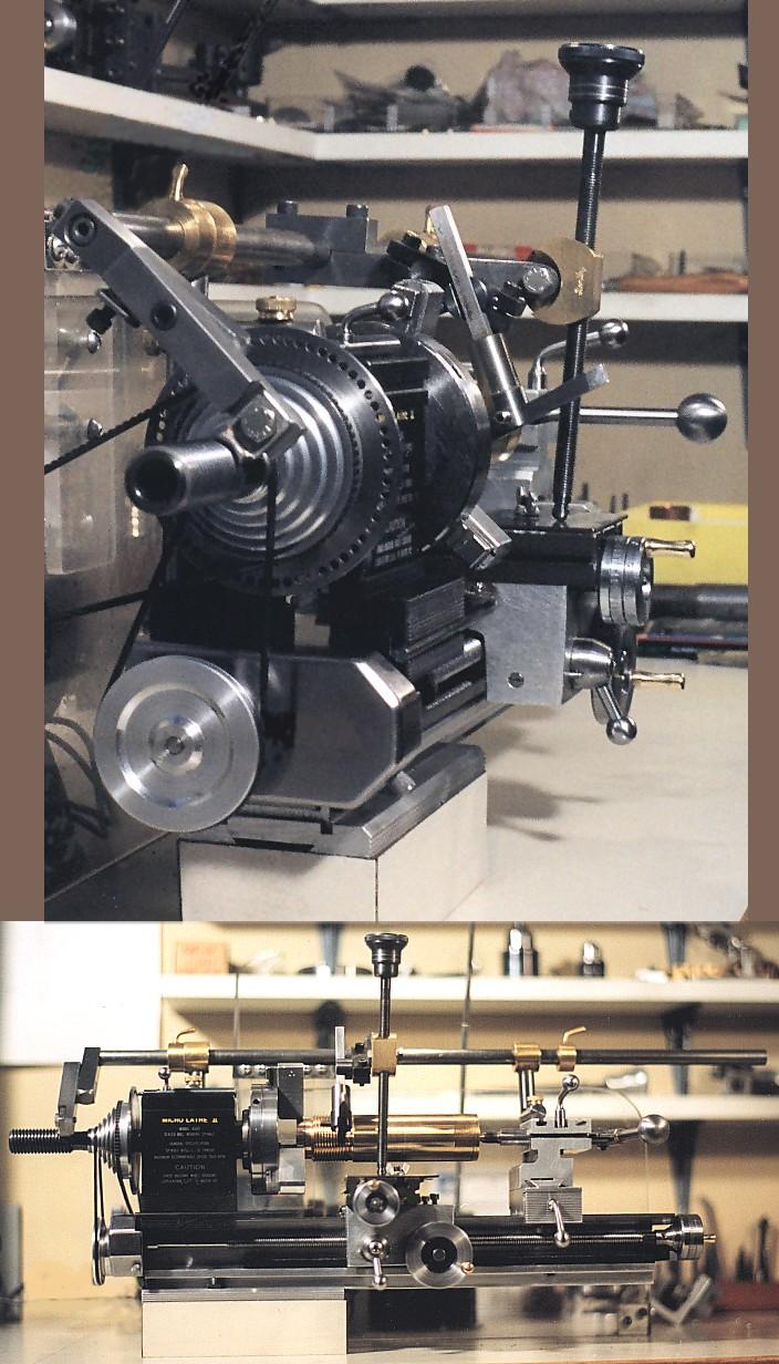

A threading system I've often thought about for a small lathe is the "master thread" type of spindle attachment.Basically you attach a threaded piece to the pulley end of the spindle, arrange a follower in it. Like an old style gramophone needle. That follower is on a rod that extends out to the carriage, and pushes it along (it is disengaged from the leadscrew). So whatever pitch thread the "master' has is duplicated on the work.
 I think they were used on the Unimat lathes. I've seen a fancier version on a larger lathe, and kept the picture for years -- don't remember where I got it from.....see below.

Timing Pulley type:
Norman, Knaell made a commercial set of toothed pulley types for the Taig lathe. Doesn't seem to be around any more, but pics of it still can be found and will maybe help you figure out a similar system.
Go here and click on the picture links:
http://www.cartertools.com/minimech.html
Thread Copying Type:
Deciphering the photo above that I attached -- it consists of:
1.) A long steel push rod that passes through a bushing on top of the headstock and one on top of the tailstock.
2.) Brass collar stops on that push rod at headstock and tailstock to limit its movement to the length of the "master screw" when resetting it.
3.) A follower toothed arm that sets in the master screw.
4.) A lathe tool holder attached to the pushrod.
5.) An adjustable vertical steel rod that serves as a rest and support on the topslide. I see a wingnut on the topslidethat retains a smooth plate. The end of the vertical rod slides along that plate with the topslide stationary, I believe. I think this rod sets the depth of cut. Not sure how pressure is applied to the lathe tool, but maybe it's just the weight of the attachment.
That's pretty much it.
Master screws could be made up on another lathe, and in some cases could be made from commercial threaded rod for the larger common sizes.

I have been given a tailstock ram for a Myford lathe (thank you so much Kayzed1) that is slightly larger than the one that I was making. Which meant that I had to bore out my tailstock casting to fit. As I am rotating the lathe by hand it took a long time, especially where the split cotter is situated. That took a bit of effort to turn the mandrel as the cotter is steel and the tailstock is aluminium.
Anyway, it is done and I didn't go oversize as I had feared. All I need to do now is to hone the hole to make it a perfect fit.
Here is my boring set up, I've shown it before but this is from the other end and shows my temporary tailstock. I used the saddle to push the tailstock along. Steve, (VTsteam) will recognise the method as it is how Dave Gingery showed to do it to build his lathe.
