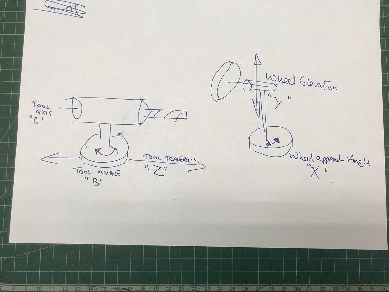

For several years I've had the idea in the back of my mind to try and build / evolve / develop a CNC controlled Tool and Cutter Grinder. Indeed I've kept my eye open for suitable scrapped kit to act as a basis, but never actually  done anything about it.
Commercial machines control five or even six axis simultaneously, and 5 or 6 axis controllers are like hens teeth unless you are prepared to dip your toe in the EMC / Unix pot.
In an idle moment forced on me by the weather today I started doodling on paper, and it dawned on me that probably only two, or just maybe three axis need to move at the same time.
On the following doodle I can see that Wheel Elevation axis 'Y' and Wheel Approach Angle 'X' in most cases can be moved to a desired position for a particular operation, and then full control exercised over Tool Axis 'C' Tool Angle 'B' and Tool Traverse 'Z' reducing the needs of the CNC controller immensely. For instance a special 'M' code could be written to switch the three axis controller between group C,B,Z and group X,Y providing the mechanics and electronics maintained the axis in location after the switch over.
No doubt the programming would be 'interesting' and require many cups of coffee but the possibilities are endless. For instance, a sensor to scan the inserted tool, identify how many flutes, what helix angle etc to automate regrinding. Pipe dreams perhaps, but entirely possible I think.
. . . comments from you worthy gentlemen please . .  :med:

From  many years in engineering, it is a lot cheaper and less frustrating, just to buy a new end mill. Regrinding the ends to get a sharp corner back is a fairly easy, straightforward job on a decent manual tool an cutter grinder with an indexer. Grinding the flutes is a whole new ballgame and if you can find an easy way to do this you will certainly be making a worthwhile contribution to our particular addiction!
If it helps, I am currently trying to build a simple tool grinder from an XY table - there will be no Z. Thinking about your proposal for the flutes  (I have some CNC knowledge), you will only(!) need to know - 1 an accurate zero. 2 number of flutes. 3 primary and secondary flute angles. 4 helix angle. 4 is usually to a standard. Using a flute finger as a rest was the manual way of virtually ignoring the problem. So on my simple machine when you solve all the stepper driver programming problems, a simple(!) stepper driven indexer would be relatively easy to add.

You could do it with 3 stepper axes .... or even two, and an adjustment for depth of cut on the wheel. Controllers are like $20 on Ebay.

Hi Pekka, conceptually, take a lathe bed, add a  headstock and stepper driven spindle.
Add a carriage, leadscrew, and tailstock.
Drive the leadscrew with a stepper.
Add a grinder on a cross slide and way (and/or vertical way)  and ordinary grindstone, with axis parallel to the lathe bed.
You can either adjust its distance by hand wheel, or stepper drive it.
Total: two or three cnc driven axes. Lots of refinements possible, but in general, that's the concept.
As for the complexities of angles, helices, etc.for side dressing end mills .....in my opinion, that's what spreadsheet calculators do quite easily.
