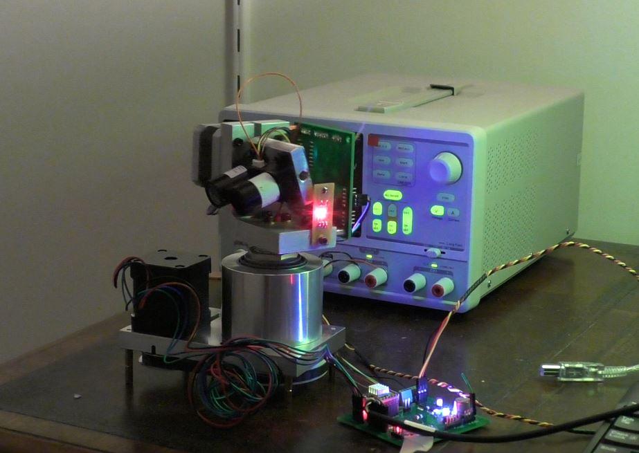

Here is a picture of the scanner

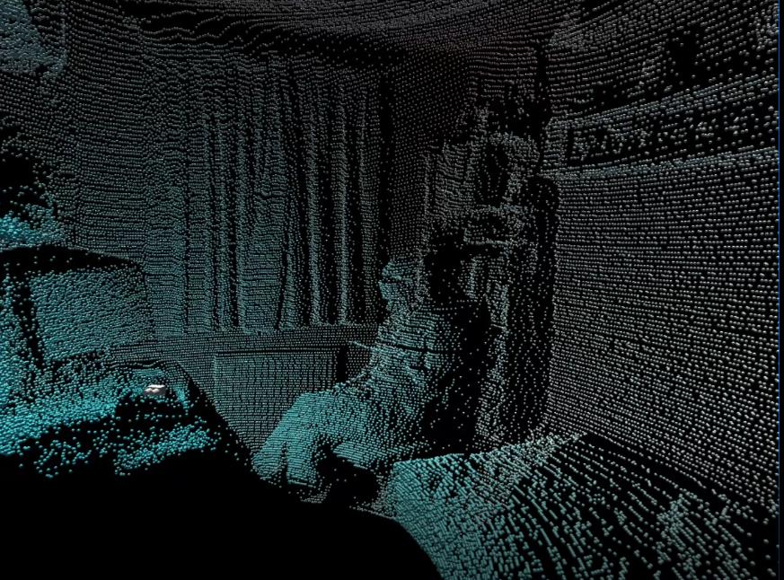

Here is picture the scanner has built up.  Take a look at the YouTube link above for a  rendered video where I move through the captured 3D world.

Very nice David, what level of precision are you getting in the point cloud ?
I wish this had been available years ago, modelling marine interiors for refit you had to be a contortionist surveyor, using a single laser measure, and it took hours.  How fast are the scans ?

Hi Joules
I’ve used the Garmin Light V3 module, and the data sheet claims update rates up to 650 Hz with the trade-off between accuracy and speed.
I’ve not done much experimentation with configuration parameters, but out of the box I think I was getting about 120 points per second with a flutter of around  plus\minus 3 cm on a wall 2 m away. In terms of scan speed, it’s really whatever you want, with the compromise between resolution and capture time.
