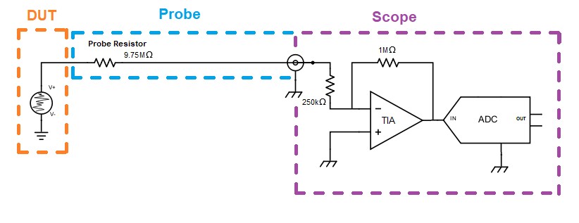

Esko, does you TEK has then TIA input?
https://www.tek.com/sites/default/files/2018-03/FAQ_Passive-probe_Image4.jpg
Some stuff I don't understand well:
https://de.tek.com/support/faqs/why-isnt-tpp1000-%28tektronix-passive-probe-1ghz%29-compatible-my-scope

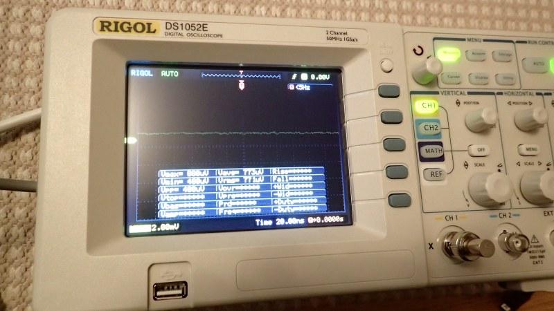

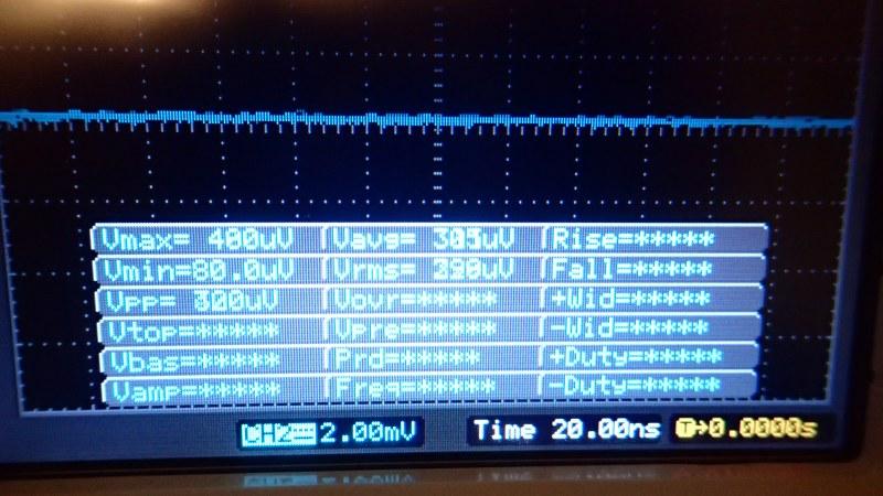

Can you measure your scope input noise? I'm interested noise figure un terminated and terminated with blank cap or 50 Ω terminator. I'm particularry interested about 50 Ω input noise.
I checked my scope (DS1052E) one input at the time input BNC open and then blanked with 50 ohm terminator. Noise figure was pretty good, constant and low. My scope does not go down from 2 mv/div and there noise looks pretty good.
