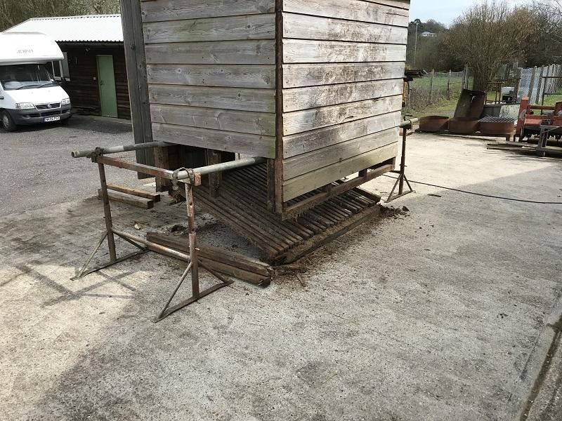

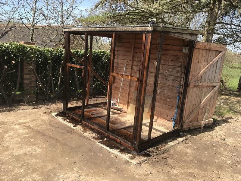

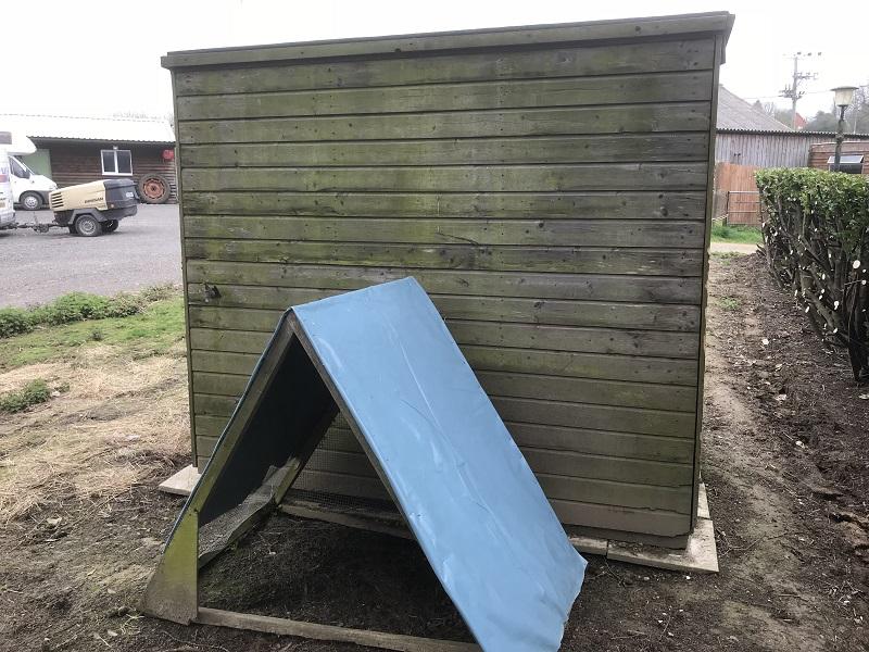

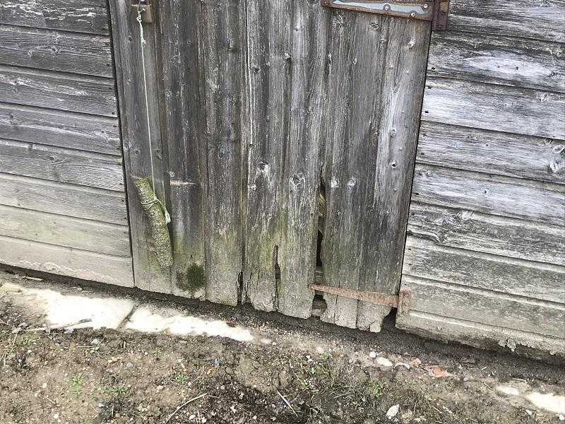

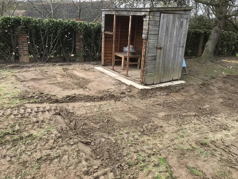

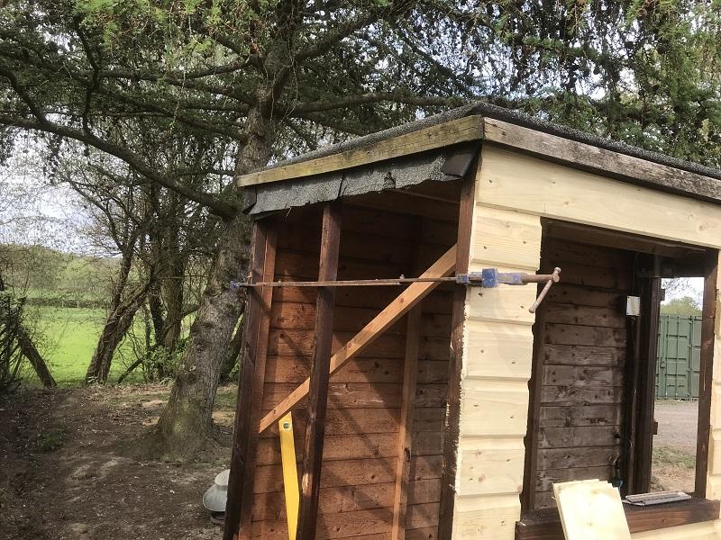

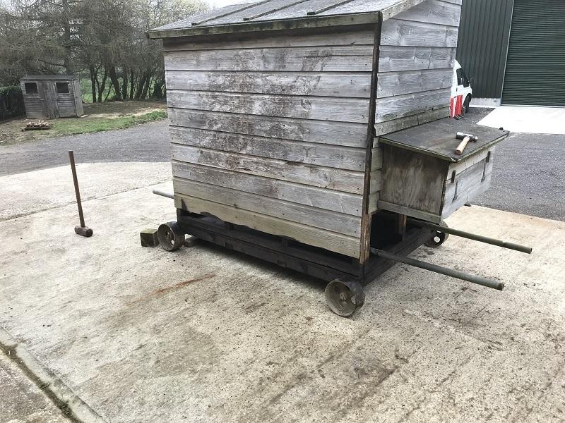

This is not a project I wanted - in fact I've resisted it until the domestic pressure has got too great  :zap:
A chicken shed - with a design not entirely practical. The idea I think was that having it on wheels, and with a slatted floor, it could be moved rather than having to muck it out, and the chicken poo would fall through the slats.
In practise this didn't work well at all - the poo sat on the slats, but far more seriously the badgers grabbed chicken legs from below and bit their feet off. Not nice to find in the morning and certainly not nice for the chicken  :bang:
So some years ago I put galvanised sheeting over the slats. But slowly and surely, like all these things it rotted from the bottom being close to wet earth, and no doubt the rats helped the process by gnawing away as well.

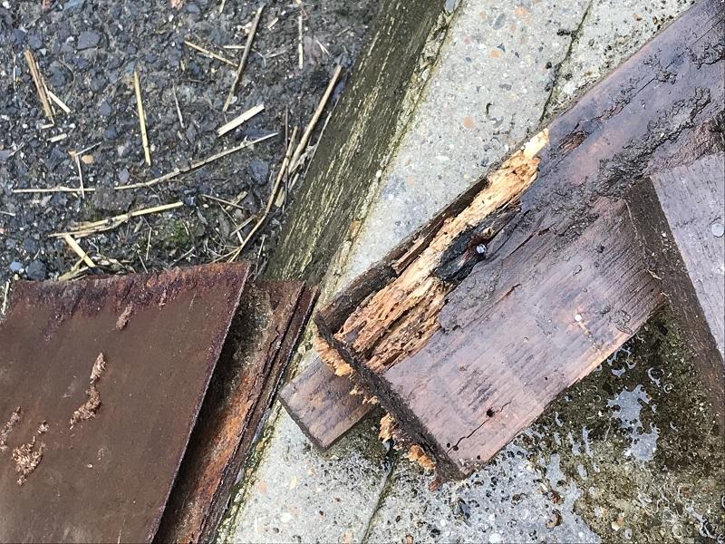

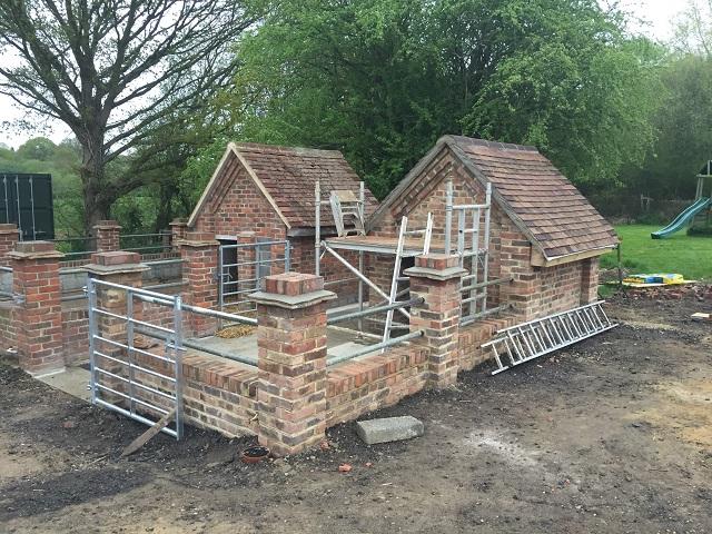

My offered (and favourite) solution was to lay a slab of concrete and build a brick chicken shed along the lines of my Pig Palaces, but this didn't meet with approval despite the fact it would be virtually maintenance free for decades to come. (Apparently we have too much brick work about the place  :bang:)
So having previously prepared the ground for a masonry construction, I'm now having to try and make a Silk Purse out of this Sows Ear of a shed.

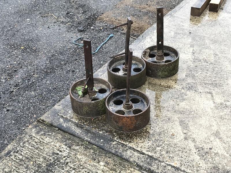

It's fragile as the base is rotten. The wheels have fallen off the rotten timbers of the base and SOMEHOW it needs lifting two foot off the ground and suspended so the the base on which it was built and the slatted floor can be cut away and replaced. I ended up nailing some re-inforcing timbers across the narrow side internally knocking a plank off at each end, and threading scaffold poles through which I could then jack up onto 'builders band stands'
It would be SO much better to dowse it in a gallon of paraffin and toss a match in  :scratch:

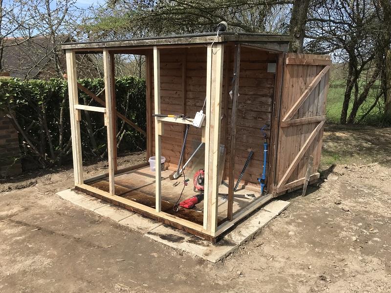

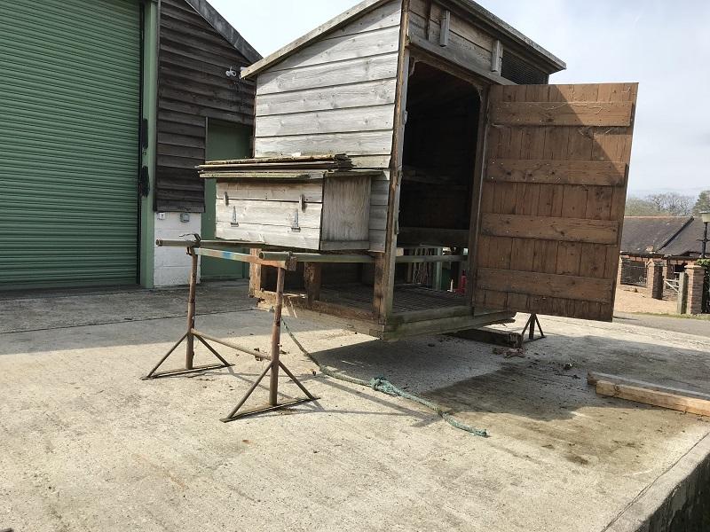

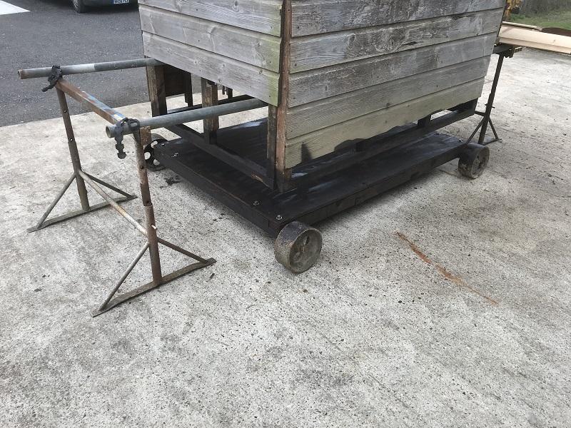

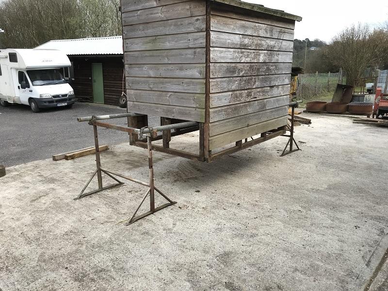

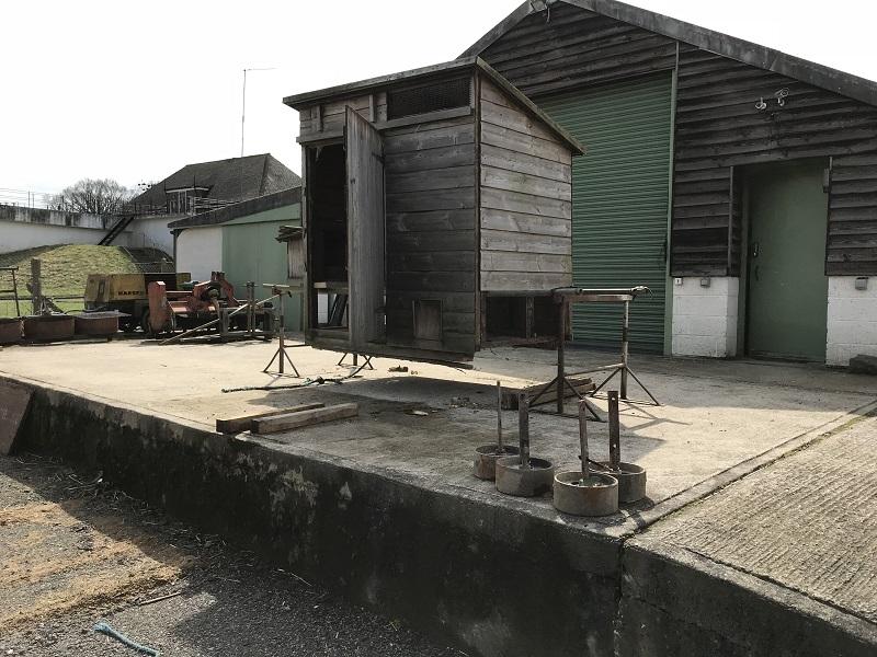

So it was about this stage I started taking photos - so we start when I've got it up on the band stands (one of which is in an extremely dodgy state itself and is going to need repair)
« Last Edit: April 11, 2018, 03:52:55 PM by awemawson »

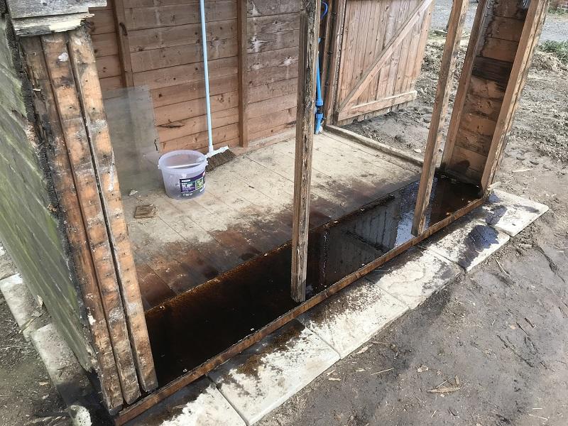

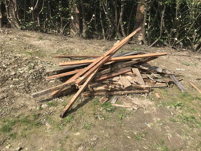

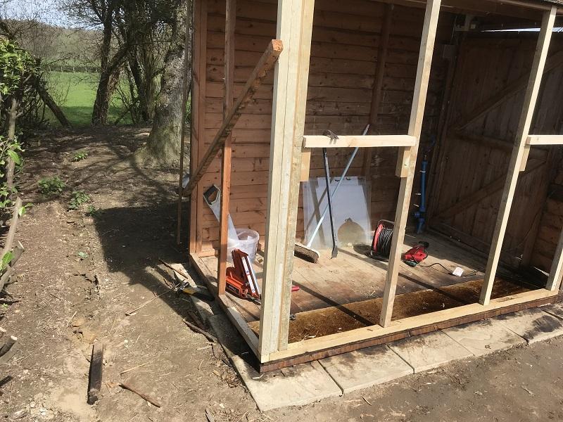

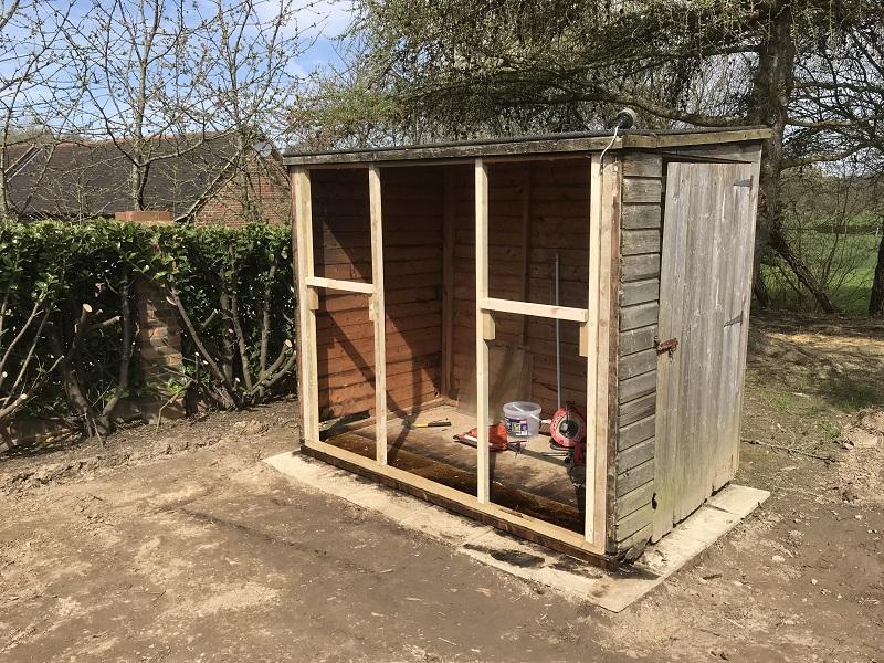

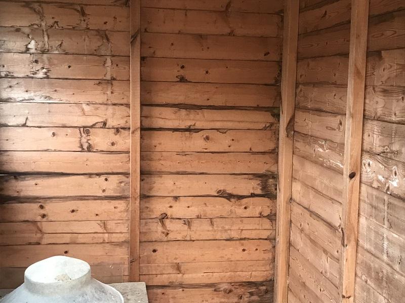

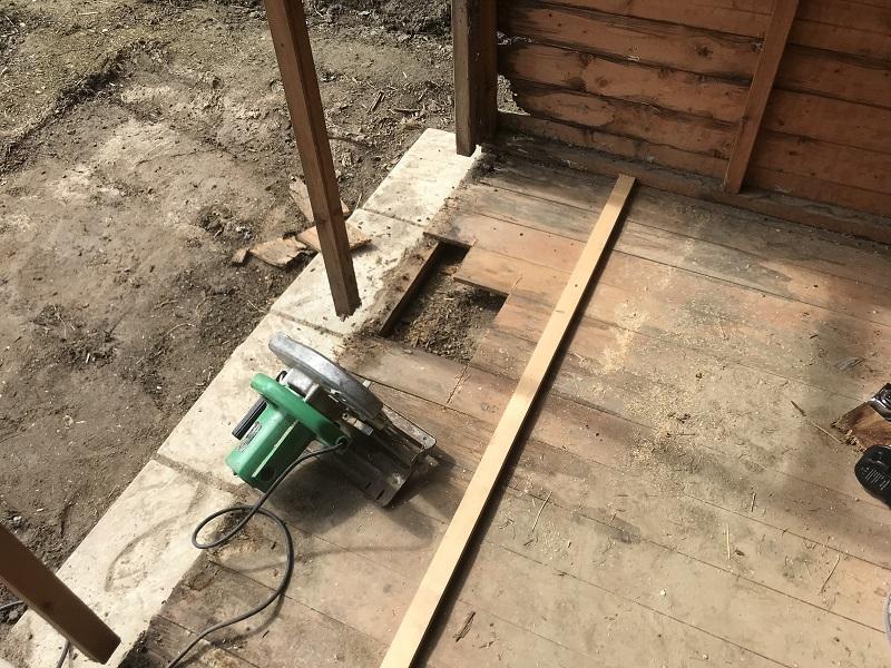

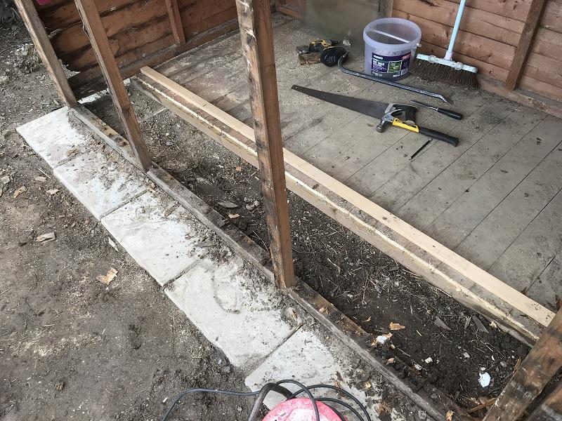

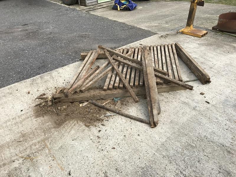

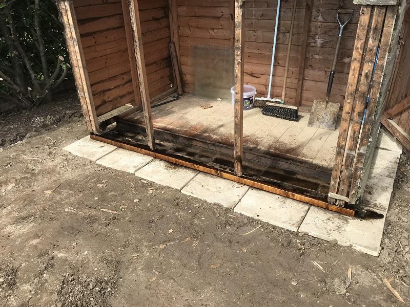

So the next step (quick before it ALL collapses) remove the three lower planks to give access to the base to perform butchery on it's fixings. Hopefully I can match the shiplap timbers when it all goes back together - it looks to be a fairly standard 6" profile.
Then out comes the reciprocating saw - one of those rarely used tools that in this case was indispensable - cutting through screws between two timber baulks. At this stage the slatted floor fell out along with other bits of the structure that I wanted to retain  :bang: Never mind, they nailed back ok !
« Last Edit: April 08, 2018, 06:36:26 AM by awemawson »

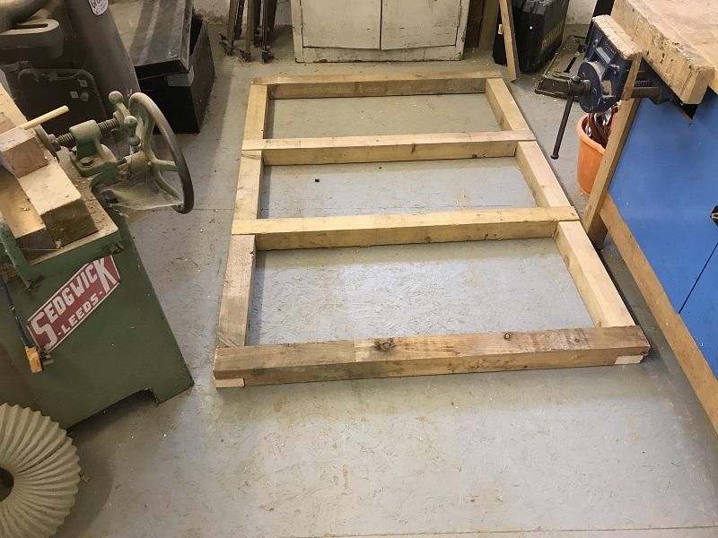

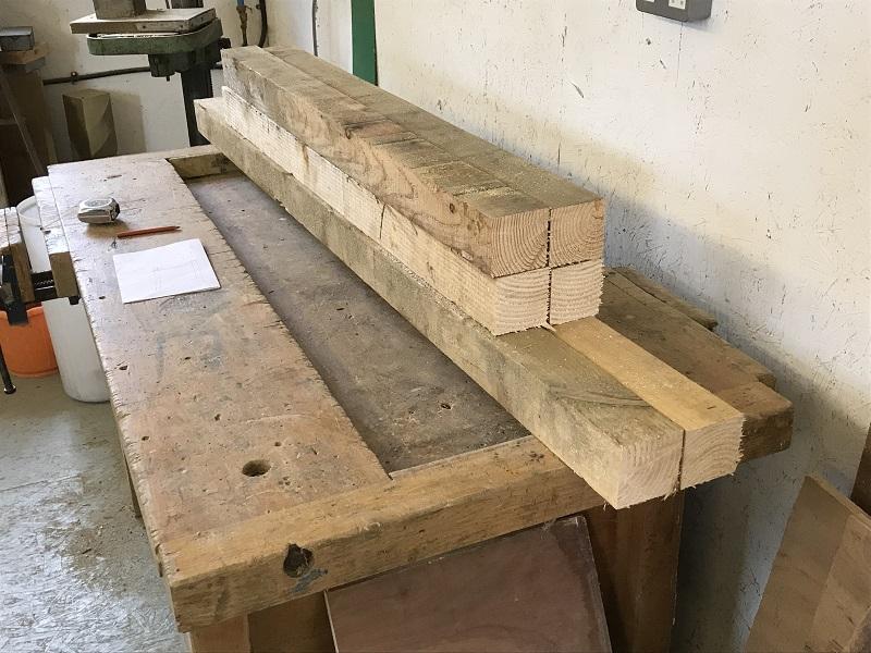

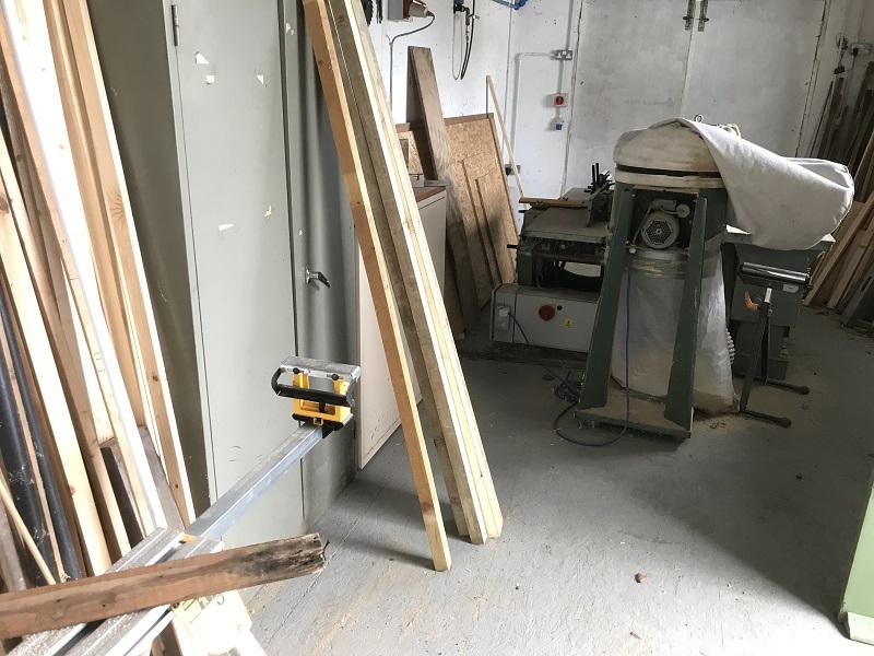

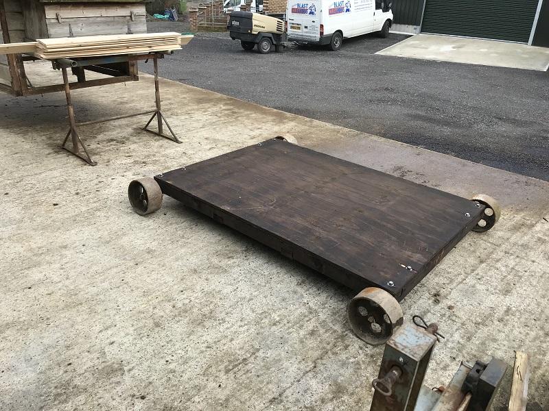

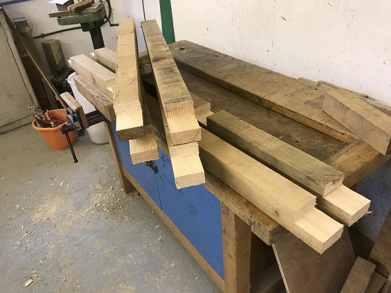

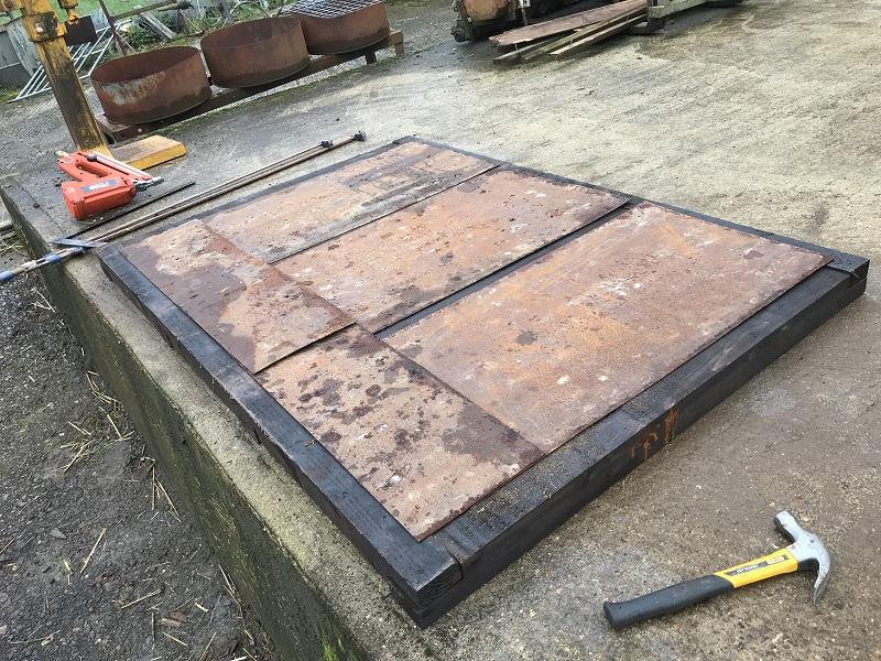

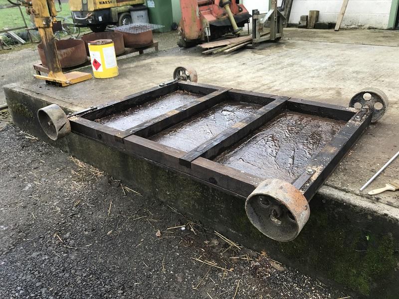

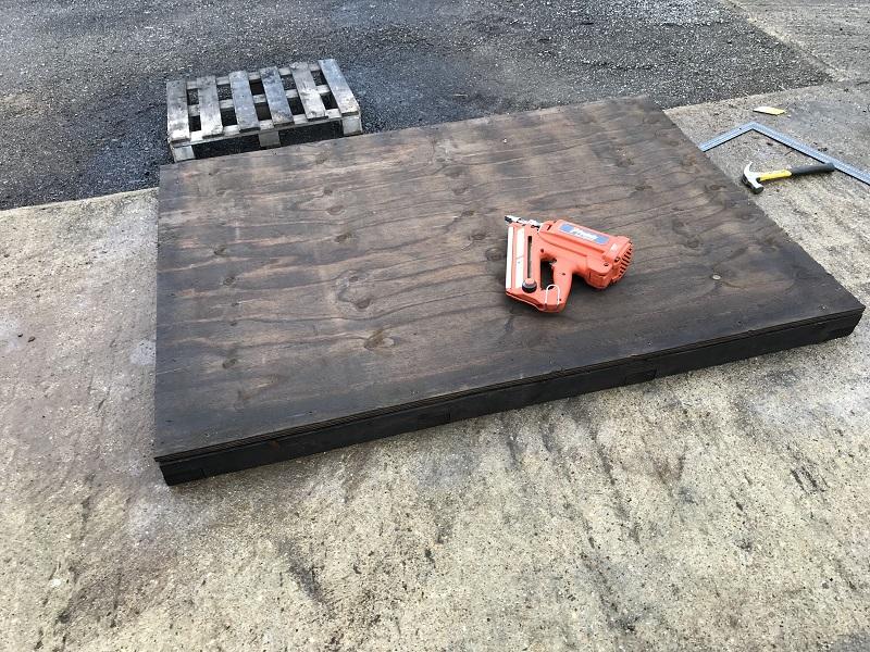

Next step - make a new base and floor - solid floor this time from 18 mm shuttering ply with the steel sheets I'd previously fitted fixed below to give the rats a head-ache.
Now it just so happens I have a pile of nominally 3"x 3" rough sawn timber that had arrived as cribbing for the steel work for the tractor shed - it's a bit irregular in sizing but none of the base will show. It is of course pretty poor quality soft stuff, but it should last if given a good soaking in genuine Creosote.
So Saturday afternoon I cut it to size - I've decided to add two cross braces that weren't part of the original design making four lengths for the short side and two for the long side in a ladder format.
Had to curtail activity at that point as was due at a friends 80th birthday celebrations.
Then this morning, despite a slight hang over and a very late night (well actually early morning!) I cut all the halving joints and made a trial lay out on the woodwork shop floor.
I need to order up some genuine Creosote before I can do much more - I have 'Creosote Substitute' which is OK for fences but no use for stuff that sits on the ground.

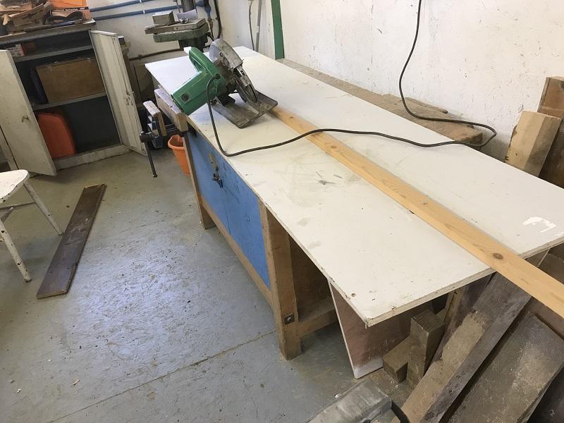

Re: Rebuilding A Grotty Chicken Shed
« Reply #6 on: April 09, 2018, 04:28:24 AM »
Hi there, Andrew,
There's something quietly satisfying about your photo showing the real carpentry bench.  I bet you can chop out mortices on that without it flexing more than an odd micron or two!
« Reply #7 on: April 09, 2018, 08:28:37 AM »

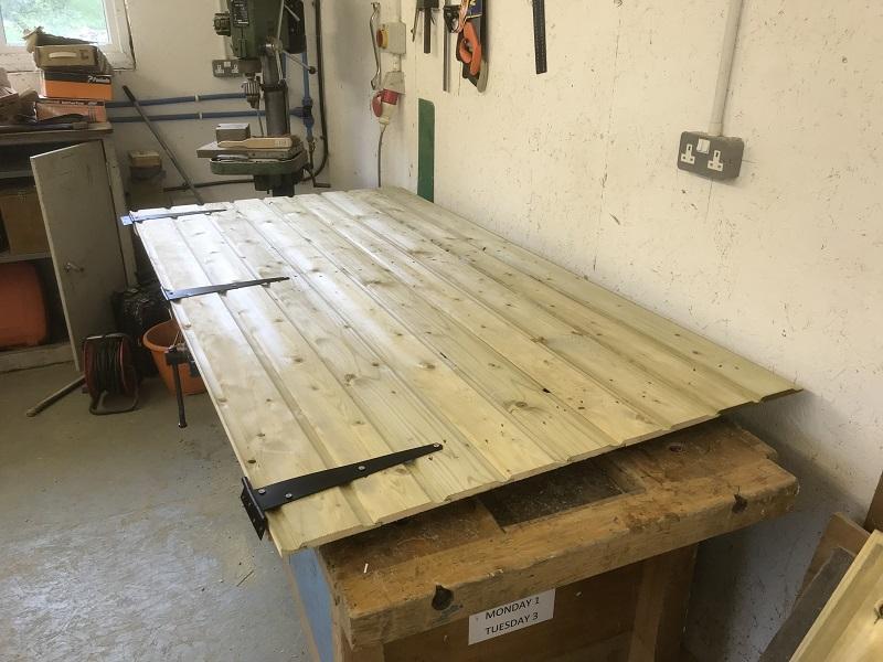

Yes Pete, genuine Ex School workshop complete with chewing gum stuck under the top  :lol:

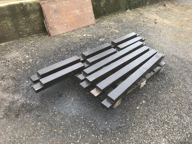

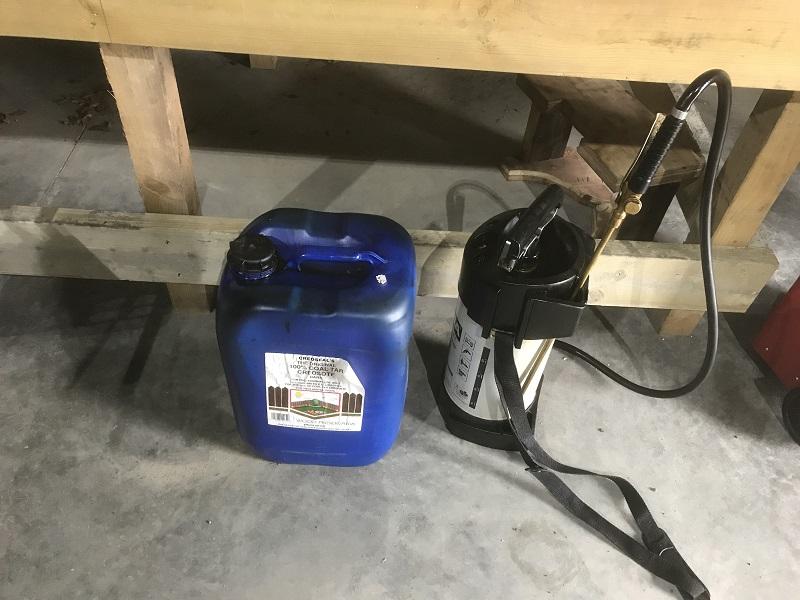

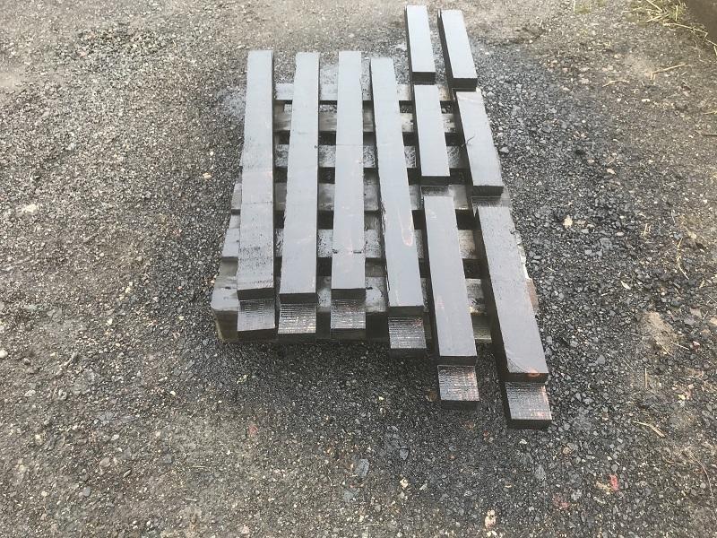

So today's job - get some Creosote ordered. Much to my surprise my local farm supply place was no more expensive than ordering it on line - usually they are a good 25% if not more, more expensive. So a quick trip to Rye (20 mile round trip) produced a 25 litre drum (£58 inc VAT) and back home to put it on.
I'd intended to up end the timbers and soak the end grain in a bucket, but the sheer volume made that impractical so I dug out my sprayer. This is the type that you see road gangs spraying tar emulsion to seal the edges of new work. 5 Litre tank and a hand pump like a garden sprayer on steroids.
OK empty the 'Creosote Substitute' that was in it, fill with the genuine stuff, and off we go . .. until it blocks  :bang:  A bit of 'back flushing' with an airline unblocked it and off we go . . . until it blocks. Obviously some junk in the tank. Never mind, press on, get the job finished then sort it out.
Creosote back into it's drum, a litre of red diesel in the tank, much bubbling and spurting as the airline did it's stuff and we are good to go. Pump it up, suddenly no resistance to the pump, piston has come off the plunger  :bang:
Simple pull apart, and re-assemble and I 'think' it's ok for next time. Simple 5 minute job turns into a couple of hours and a major clean up - still it's done and will take a couple of days for it to soak in and dry.

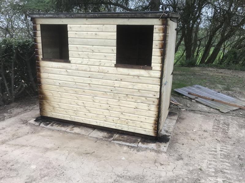

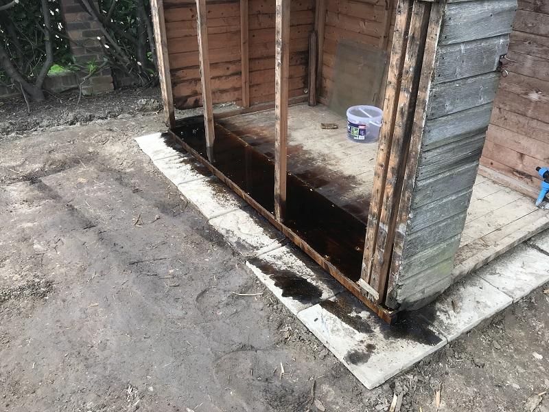

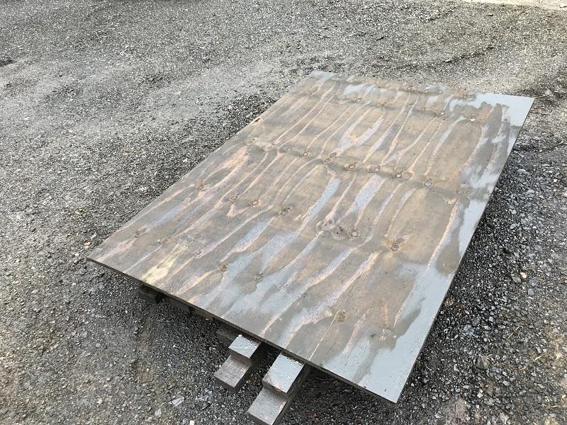

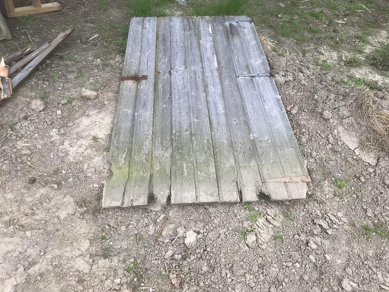

I took the opportunity of having an early visitor to help me lug out the 8x4 sheet of shuttering ply and cut it to size for the floor. So much easier with two of you!
Then a quick spray with creosote - except again it proved to be far from quick as the sprayer blocked AGAIN  :ddb:

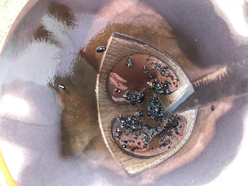

This time I was determined to get to the bottom of the problem. Total dis-assembly of the tank, hose and fittings, a really thorough clean out and internal inspection with a torch, then a test using red diesel.
I thought I was being a bit anal using a cellulose paint spraying filter funnel to fill her up - no issues with the red diesel but just look at what was in the Creosote. No wonder it kept getting clogged, and simply avoided by filling through a filter, but it never occurred to me that the stuff would have so much in the way of contaminants.
This sprayer has given me issues over several years and now I know why - filter what you are spraying  :ddb:

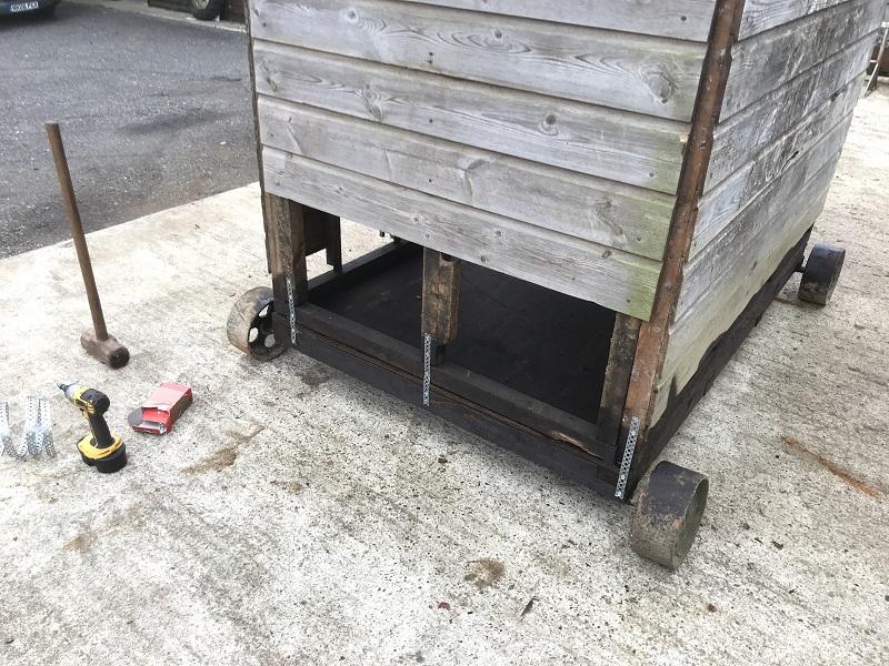

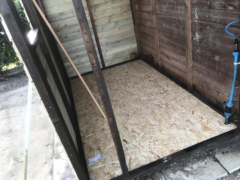

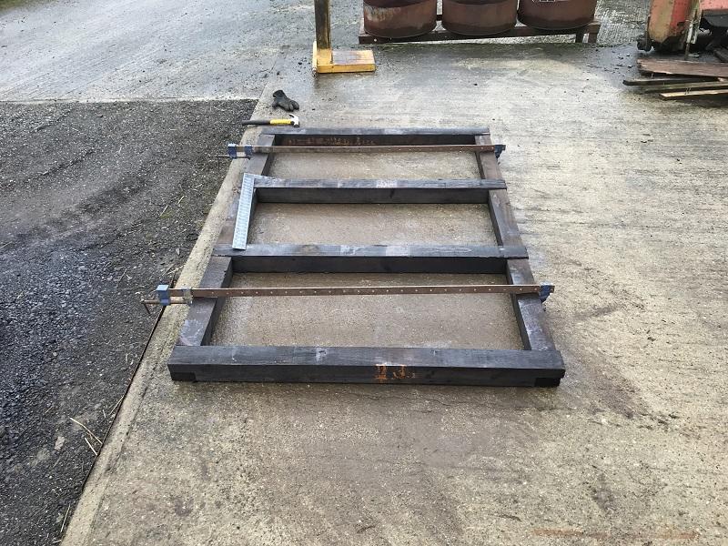

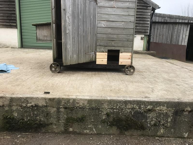

The Creosote had pretty well dried / soaked in so time to put the floor together. A bit like an Ikea kit but with Paslode Nails  :ddb:
Went pretty well, but it's a heavy lump to lug about - particularly when I had it invert it. The floor is a sandwich of the 3" x 3" framework, the rusty steel anti rat barrier, and the 18 mm shuttering ply. Having knocked the loose rust off the sheets of steel I slavered them with Shell Ensis which will slow down the rusting. I just hope that the rats don't like eating it !

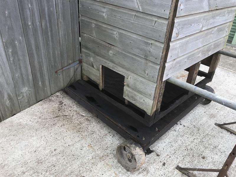

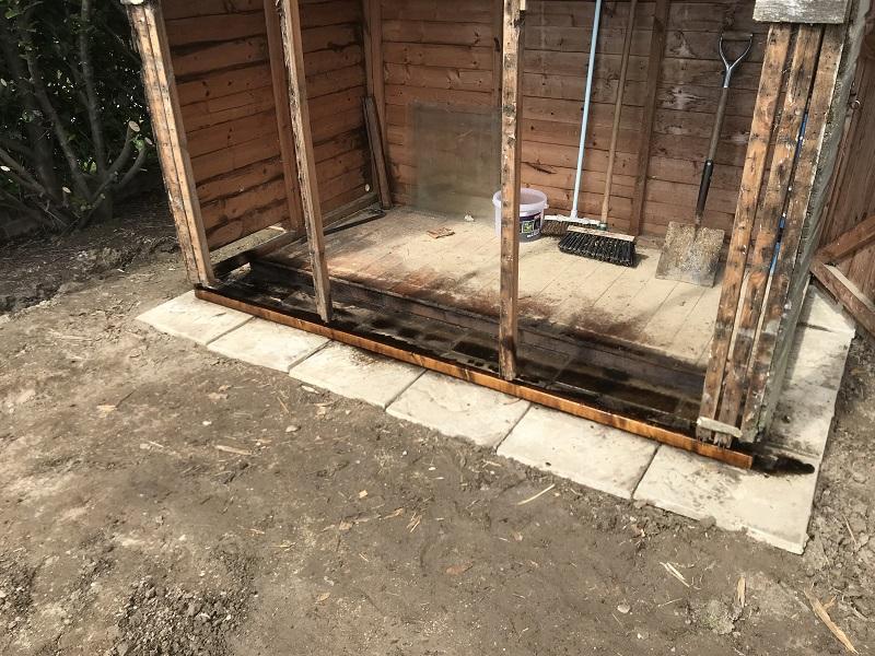

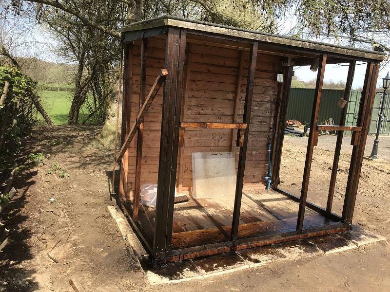

At long last SWMBO got round to vac'ing out the cobwebs etc from inside the shed (well it IS hers!!) - i even let her use my workshop vac  :clap:
This meant I could apply Creosote to the underside of the raised frame so it is coated before lowering. I pushed the wheeled floor under to catch as many drips as possible.
Tomorrow I should be able to unite floor and shed and start replacing the removed planking.
« Reply #25 on: April 13, 2018, 08:28:06 AM »

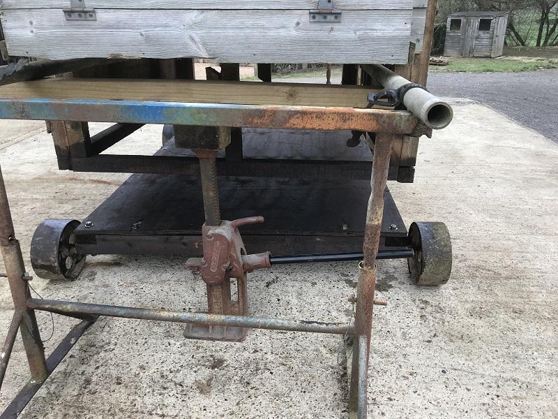

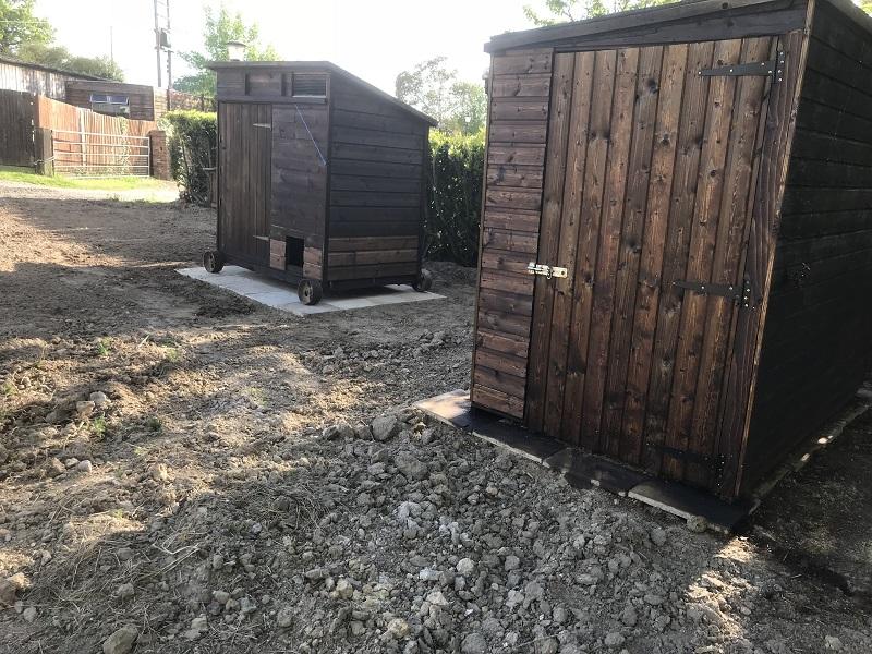

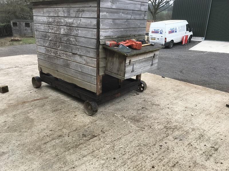

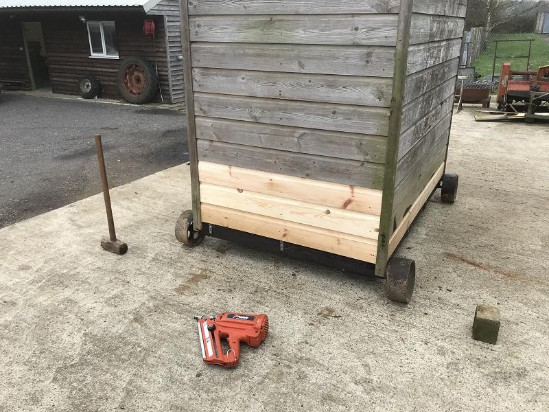

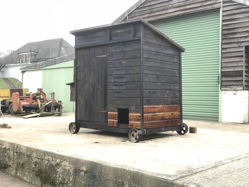

Time has come to reunite the base and upper works - but how? Well a handy Railway Axle Jack gave me a hand bringing it down in stages. Slightly tricky balancing act but I got away with it  :ddb:
« Reply #26 on: April 13, 2018, 08:33:33 AM »

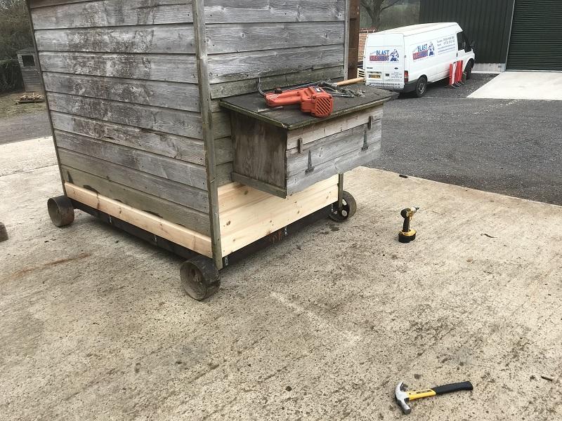

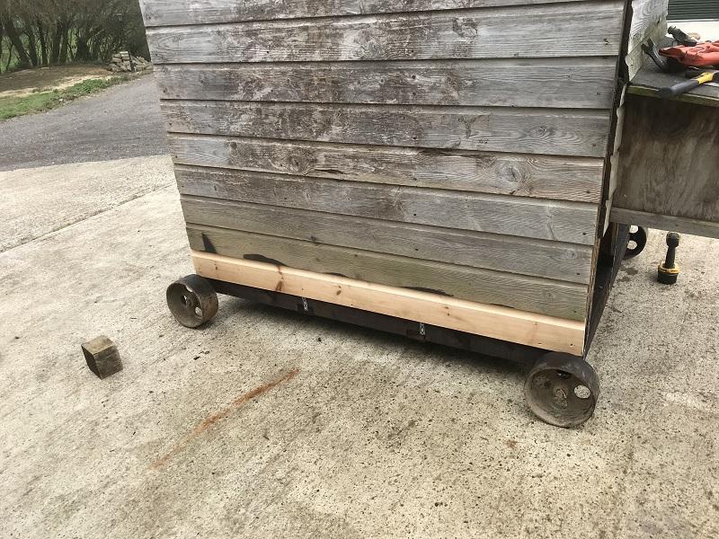

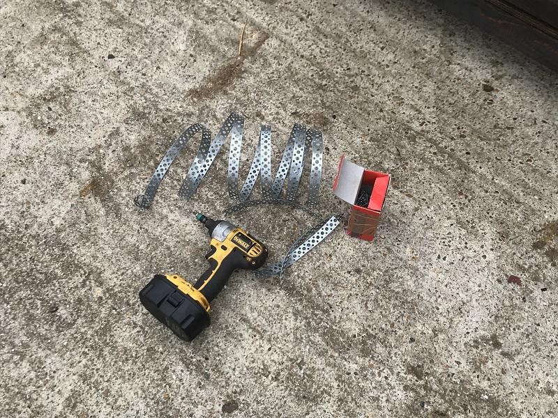

OK we got away with that, so now fix the two together. Simple 90 mm Paslode nails, but also i thought it prudent to put some 'builders banding' between to two for a bit of tensile strength.
Then it was just a case of sawing planks to length and nailing them on and going round with the creosote spray both inside and out. That should get rid of any lingering Red Mite :clap:

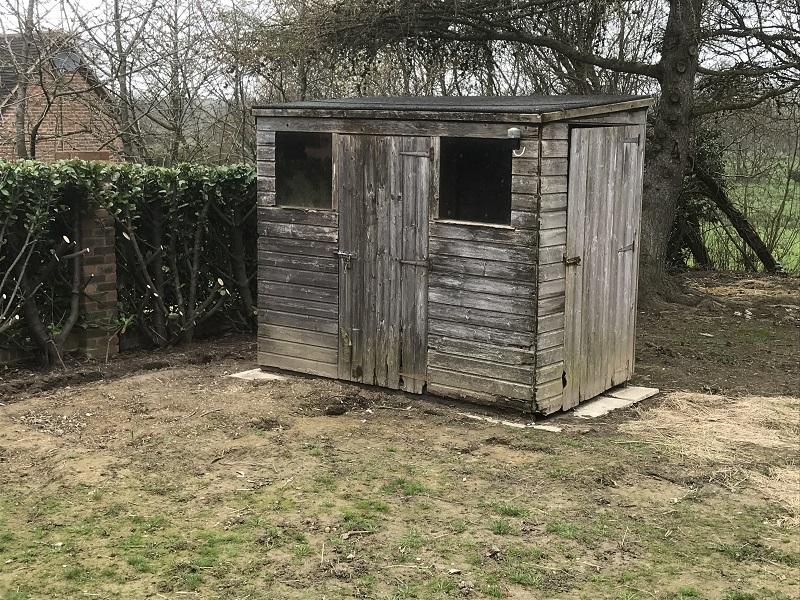

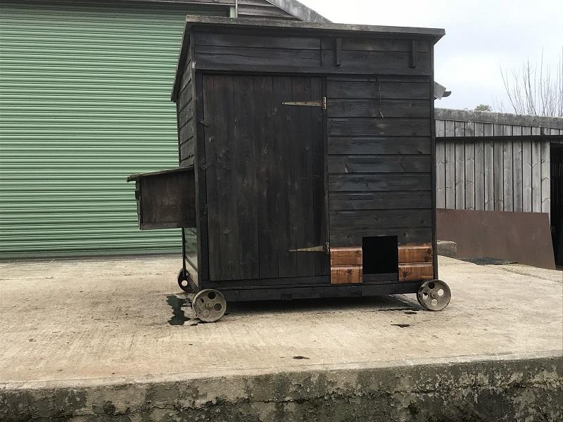

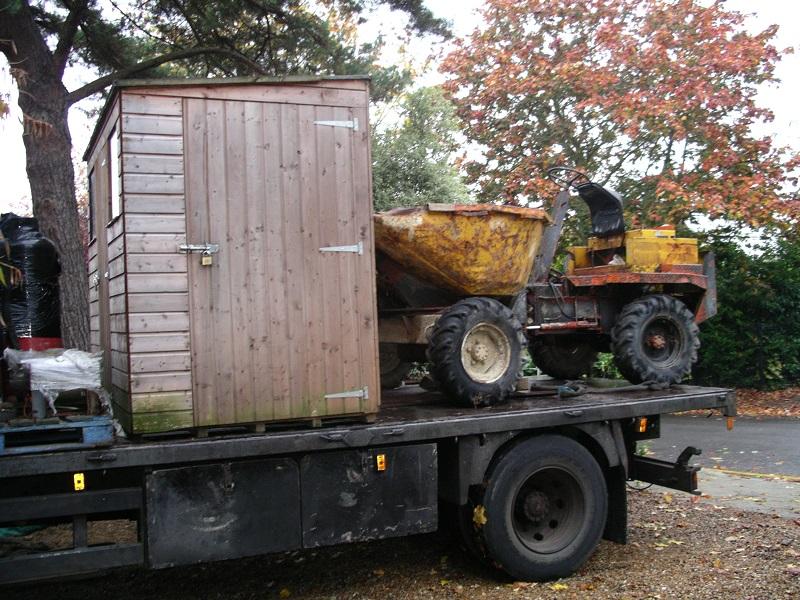

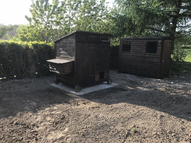

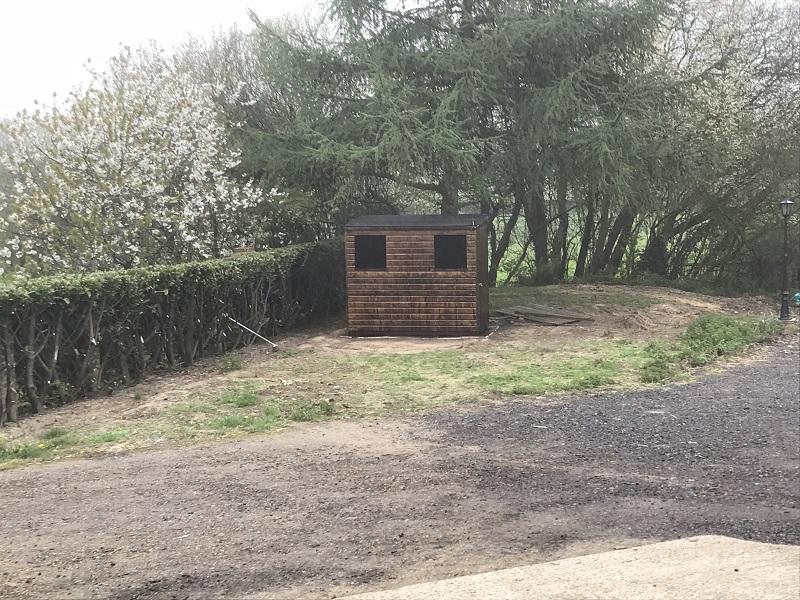

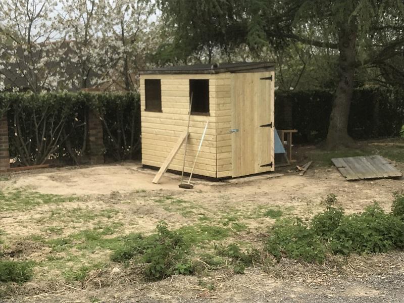

So was it all worth the effort - well in my opinion no - I still think it should have been burnt - but . . . . . . .  :bang:

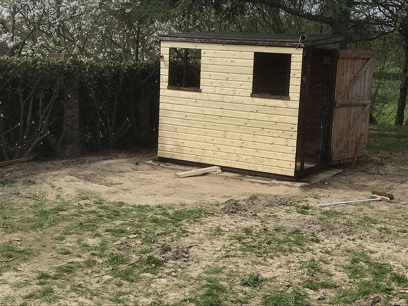

And of course now there is Chicken Shed #2 waiting in the wings expecting sorting  :( :( :( :(  :bang: :bang:

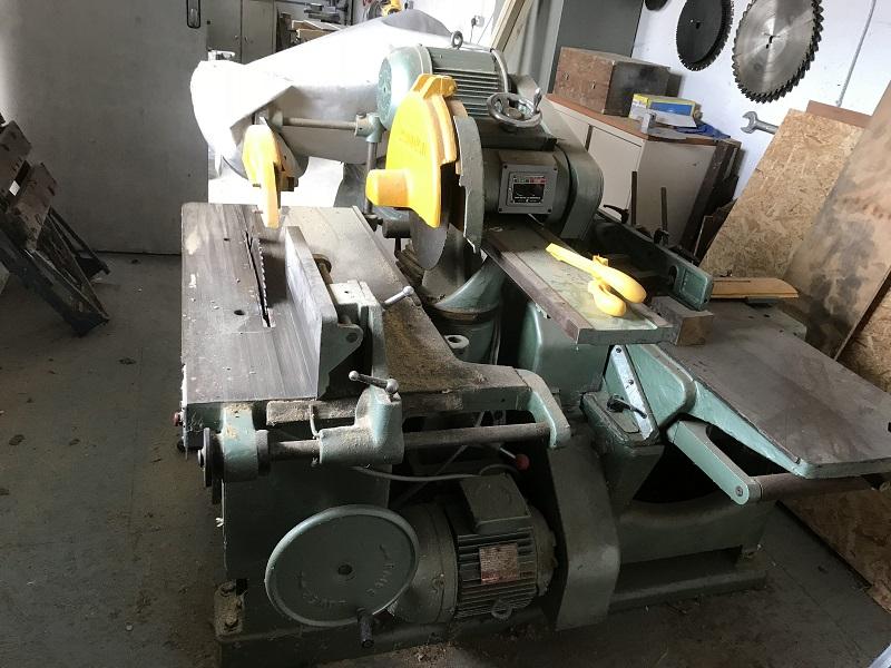

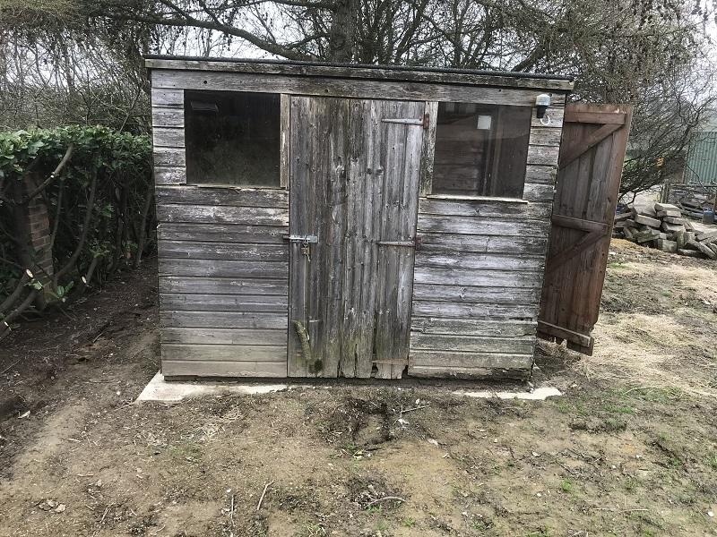

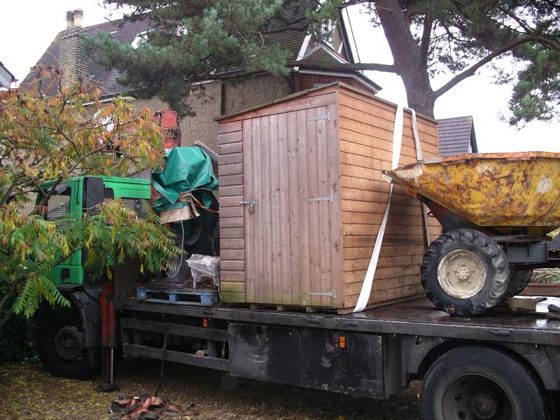

This shed I had made possibly 20 years ago to house my first 'male menopause event' the purchase and restoration of a 1952 Sunbeam S8 motor-cycle. Reliving my youth as I had one when I was a late teenager.
I found some pictures of it when we moved house to here back in 2007 - it's certainly deteriorated since then
(It's snuggling between my Thwaites 2 ton dumper truck and a Blacksmiths Power Hammer  :lol:)
« Last Edit: April 13, 2018, 09:34:57 AM by awemawson »

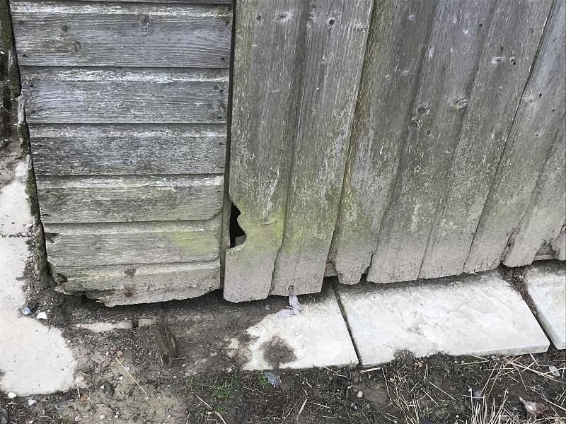

« Reply #28 on: April 13, 2018, 08:49:06 AM »

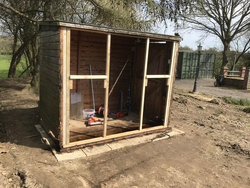

So how it it now 11 years on from the move, when it wasn't new then. Answer pretty grotty and rat eaten.
It has two doors and I plan to eliminate the one in the longer side, and re-plank at least three sides. The side away from the sun has survived quite well. The frame isn't in too bad a state, and as long as the nails pull out of the frame without making too much damage it 'should' be relatively straight forward. Famous last words  :bugeye:

After the odd distraction of lambs being born I thought that I'd better get on and remove some of the rotten planking and see how bad it really is - it's BAD  :bang:
The side with windows that I've started stripping not only gets all the weather, but it turns out that the ground surface has built up above the flagstones so the sole plate under it is utterly rotten - not entirely surprising. Although I intend to overlay the floor with 18mm OSB3 the ends of the planks of the original floor on this side are also rotten - I will cut then away to the next bearer and slip a piece of waterproof ply of the same thickness where the planks were.
I'll replace most of the framing on this side - I could just splice in a foot at the bottom, but it's far easier to replace the entire length. So I steamed up my Dominion Super Elliot combination wood worker and produced some lengths of 50 mm square to match the original.
Lastly I got out the JCB 803 and pulled the earth back to below the level of the flag stones - it's all going to be raked over with my landrake on the JCB eventually and reseeded, but this at least will keep water out of the new work.
I'll have to re-frame this side before I removed any more cladding or it will all collapse  :bugeye:

So I steamed up my Dominion Super Elliot combination wood worker....
Jumpin' Jehoshaphat Andrew, is there no man-cave toy you don't have?  :bugeye:

Now ALL today's toys (Digger, Dumper (out of shot), Dominion Woodworker) have been subjects of pretty fundamental rebuilds on Mad Modder and all were bought in a shoddy state so I reckon I EARNED them  :lol:

Time to sort out those rotten floor planks. Strategy: cut off the ends back to the next bearer, insert a well creosoted plywood section, then when the rest of the shed is finished over-cover all the floor with 18mm OSB3
I had an off-cut of ply that proved to be 1/8" too thick but it got pressed into service (literally with a sledge hammer!)
So, firstly cut a bit of floor to check the board thickness
Then fix a batten to act as a guide for the circular saw
Slice off the rotten bits
Cut plywood to size
Slaver creosote everywhere (including on me !)
Nail down the ply with the Paslode gun.
It ALMOST worked like that  :lol:
Firstly the 13A socket in the shed wasn't working - quick bit of diagnosis found the socket itself was too corroded. Replace socket
Then the outer bearer was mainly ok but one end was soft - slice out another one on the Dominion saw bench
Other than that it went OK - the ply was a tight (1/8" interference!) fit but the sledge hammer sorted that!
Now at least there is a firm base to place the rest of the front framework that I'm replacing

« Reply #42 on: April 17, 2018, 09:39:14 AM »
Major amount done today - in fact apart from the door and three planks on the rear, I >think< the demolition is finished  :ddb:
I need the delivery of the new cladding (Monday) before I can make another door, and I don't want to bash around on the back to remove the lower cladding until the front is clad, as it's all getting a bit wobbly  :bugeye:
So I started rebuilding the front framework, most of the timber for which I had cut the other day. Bit of cogitation over exactly how the glazing fits but I think it's correct (hoping to re-use the original glass)  It all went pretty smoothly.
With the front secured I could then work on replacing both corner posts, which structurally are part of the end panel and door panel - on the end I spliced in a bit of the bottom bearer, but probably should have replaced the full length. I learnt my lesson on the door end and replaced the whole lower member. I put a temporary cross brace on the rear to retain some semblance of rectangularity.
Then the obligatory spray with creosote on the new works which was fine until the wind suddenly gusted and I got a face full - couldn't see a thing as my glasses were covered  :bang: Oh well I needed a shower anyway !

« Reply #45 on: April 23, 2018, 01:04:13 PM »
Today the cladding arrived, and I managed to get the front (window side) and rear clad. The rear needed a bit of size adjustment as it was not square.
Then the new floor went down
« Reply #46 on: April 24, 2018, 12:47:00 PM »
So after an exhausting day the shed is finished except for refitting the glass in the windows - thank goodness  :thumbup:

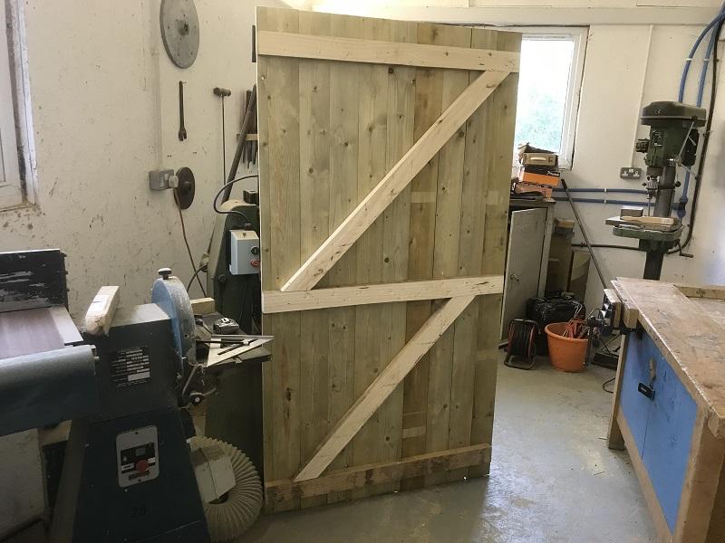

I started by fitting a panel of oiled hardboard to the small panel next to the door - the objective being to stiffen up this end of the shed. The majority of this end is door so the whole structure tends to rack. But this panel is only 12" wide - just putting the shiplap on it wouldn't be stiff enough. So hardboard followed by shiplap on top. Seems to have worked  :ddb:
Then I needed to make the door. Frankly I've been putting this off - it's bigger than my woodworking bench so difficult to keep it flat. But it occurred to me - put the old door on the bench and use it as a template - simples  :ddb:
Having hung the door the sky started to darken, need to get it all creosoted before the rain starts and the new wood get wet. I cut some 3/4" corner trims, gave the end grain of the ship lap a good dose of Creosote, then fitted the trims and sprayed the outside of the shed. It then started raining - never mind I'm now inside spraying that !
I now just need to remount the various electrical fittings and put the glass back in the windows and I can then get on resurrecting the Portakabin  :thumbup:

So this morning, early doors, I glazed the windows, re-fitted the external dusk to dawn sensor, sorted out the internal fluorescent light, it's switch and a twin 13A outlet, and handed the shed back to the customer  -  ( SWMBO ) - finished at last  :thumbup:
. . . .  and I never want to see another chicken shed in my lifetime  :bugeye:

Nope - it never had a drop of preservative of any kind since the day it was born - poor neglected thing !
It's actually not for housing chicken but rather their feed and it's operation and maintenance for the last 11 years has been on the Distaff  side of the melee  :clap:
Only recently when things have got out of hand I ripped out the rotten fence posts, burnt one chicken house (Hooray!!), rebuilt the silly one on wheels, now rebuilt the feed shed, and no doubt I'll be preparing for re-seeding, fencing, laying paths.  :bang:

Time to put the first chicken shed back in the chicken run, but first needed to level a spot and lay some flagstones to keep it's feet dry. (Been waiting for a replacement fuel sedimenter bowl for the JCB which came this morning)
Had to shift the shed off the hard standing outside the workshop, as the custom curved roof sheets for the Portakabin are threatened to be delivered on Monday
Halfway through Gary phoned up saying he had 20 tons of superb top soil to dispose of - so that was a bit of a diversion !
Anyway - done now - just needs fencing

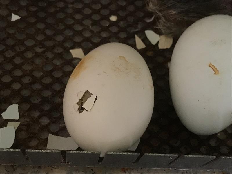

A friend gave us a motley collection of fertile chicken eggs, she keeps exotics and they are odd greens and blues. They've been in the incubator for a while now, and the first chick started pecking its way out yesterday.
In my experience somehow you seem to get 75% cockerels from a clutch of eggs ! We will buy a load of 'point of lay' chicken when the run has been fenced.
« Reply #58 on: May 11, 2018, 10:08:55 AM »
So this morning revealed four hatched chicks and another on the way out. At the time of writing we have six. :thumbup:
