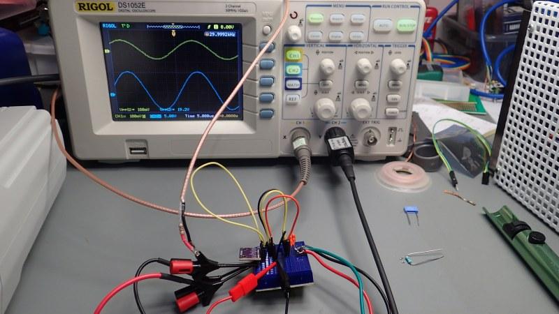

Got two of these small amplifier carrier boards to play with.
 AD8221AR-Precision-Instrumentation-Amplifier-Module-CMRR-DC-Gain-Amplifier-W6H5
There are may of them available. No information, circuit diagram or anything ....other than picture. Spec is the op.amp. not the circuit.
https://www.ebay.co.uk/itm/AD8221AR-Precision-Instrumentation-Amplifier-Module-CMRR-DC-Gain-Amplifier-W6H5/282709943202?epid=2274335088&hash=item41d2d363a2:g:TYYAAOSwETJZ8vjw

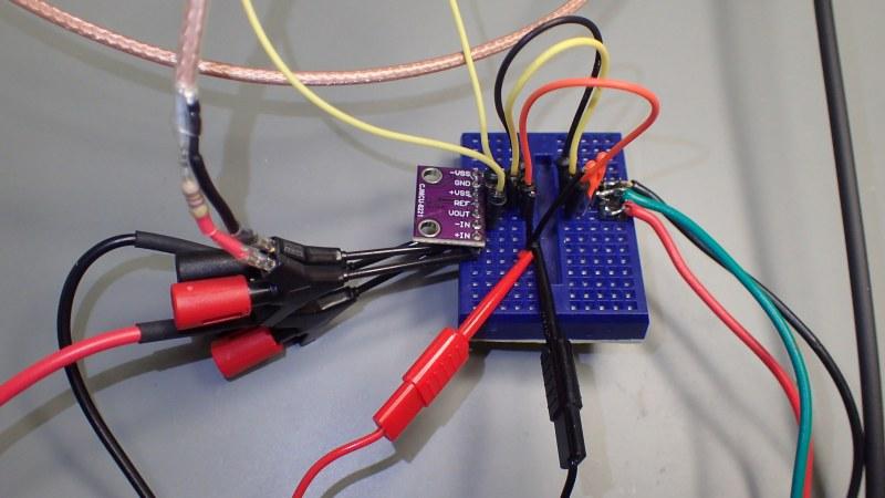

However, the circuit is simple to track and pins are clearly marked.
It is pretty much like RF-rejection circuit from the data sheet or this one:
Excluding common input capacitor (no C2) and only single bypass capacitors on power lines. RG is 499R i.e. G=100.
Input filter is on pretty low frequency.
Thinking of removing filtering capacitors and RG. Would like to test it without filtering and G=1 to see actual income on nominal max. frequency.

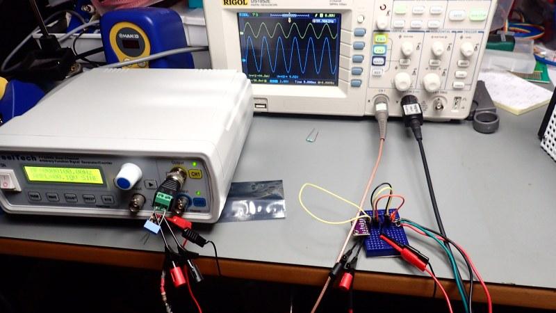

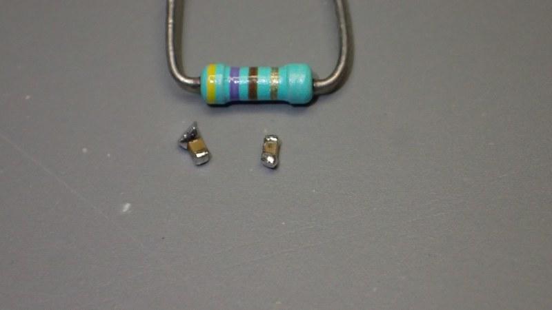

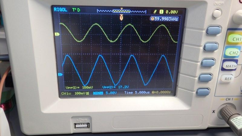

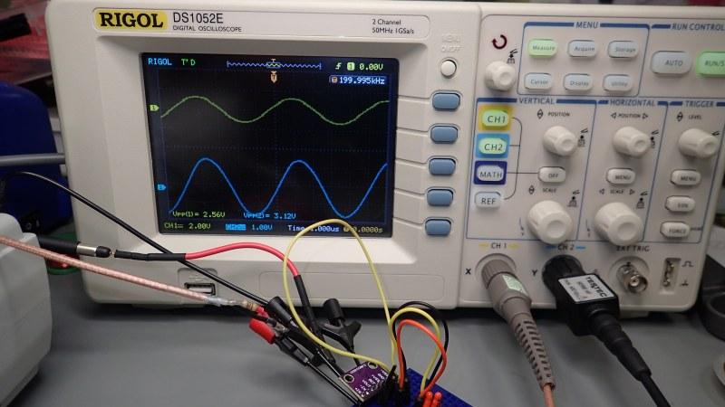

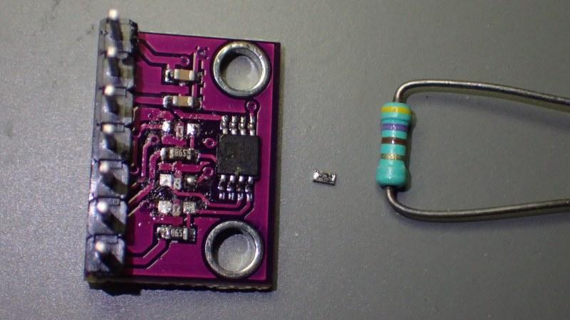

Unsoldered two very small filtering capasitors off. Now 20kHz comes trough clean at G100.
Somewhere 50-60kHz sinusoidal input signal turns to triangle wave.
On first picture the two small blobs are removed capasitors. 1/8w resistor is for scale only.

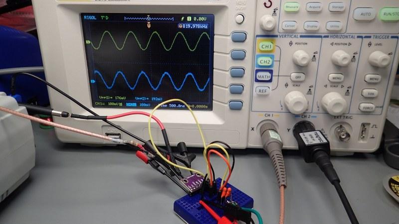

Removed the RG-resistor to set amplification to 1. This will allow me to check input/output range at diferent frequences. Whole to faster with the boar than trying to understand all that information on datasheet. It is all there, but there is so much details and stuff I should remember or have learnt that it could be notes or isobar diagram.
