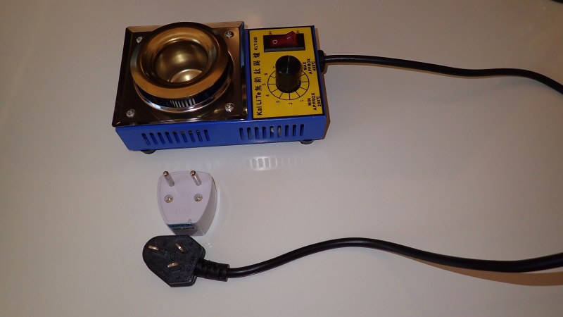

« Reply #11 on: April 24, 2018, 01:59:45 PM »
Anyways, I order one cheap 38 mm dia model.
Solder pot appeared today. Crusty chinesesium, but price was righ. Came with an australian? three prong cable and two prong adapter that does not fit into socket, neither to cable :lol: Some adpter.
Anyways, it feels like need to check inside before powering up, change the cable and check grounding/insulation resistance.
Second thing: Which solder for pot? No rosin for sure, but would auto body 30% Tin, 70% Lead bar stuff work?

Re: Soldering iron for wires/connectors and soldering pot - worth of it?
« Reply #17 on: April 29, 2018, 05:25:52 PM »
Checked the solder pot. To my surprice it sort of works. It has thyristor sontroller, no temperature regulator. Power switch cuts only one line, itäs not double pole switch. Changed the cable and trimmed the wire ends short. Some connectors look a bit close call.
I sort of works....200C position produces 38C and 2/3 postion melts 40/60 solder slowly.
I also got 240 VAC 80W iron that has massive tip, it helps to solder and tin wires at ease.
