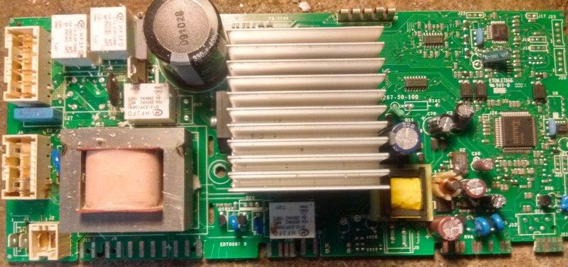

« Reply #3 on: March 27, 2018, 08:55:10 AM »
Thanks for those thoughts.  It hadn't occurred to me that they might be 3 phase - although now Russ has suggested it it seems obvious.
I have got the controller boards but I'm sure I couldn't work out what's they're doing or how to influence it.
I've looked at the motor connections as John suggested and there are five wires.  Two of them are connected to a speed sensor on the end of the motor and the other three show 6.5 ohms between any pair - confirming I think that they're 3 phase motors.
I'm attaching pictures of the controller boards.  They are slightly different but the motors are identical.  Both boards have six large 3 lead components under the big heatsink and one has a big rectifier on the heatsink too.  The transformer looks to be part of the output but I haven't checked the board traces or the wiring loom to confirm that.
I'm guessing that somewhere on the board something is turning the big transistors on and off to produce 3 phase. :scratch: :scratch:

If you have saved the wiring harness as well, you need to isolate the wiring between the motor and the speed control board. You will find that there is forward, reverse and variable speed available. It all depends on whether there is a wiring diagram available, and the type of programmer the machine uses. Early machines were rotary mechanical types, later ones are all digital, and a bit more complex. By a process of deduction, and some VERY CAREFUL experimentation, it should be possible to see where the feeds need to go to produce forward, reverse, and probably a couple of spin speeds, or even infinitely available spin. Time to learn some basic electrickery!

One of the interesting things is the motor speed sensor - interesting because the speed of a 3 phase motor should be fixed by the frequency - so there is presumably some feedback - possible for acceleration.  I think that makes hacking the original drive boards extremely difficult - well beyond me anyway. :scratch: :(
It would probably be easier to reproduce the output stage of the drive board and control it with a microcontroller.  It might be possible to buy an off the shelf drive.

And with feedback provided to the drive, there are less assumptions about what the motor is doing.  Better control is possible than without feedback.

I would think that these are very useful motors indeed. If you were to buy a low-cost VFD (like a Teco or Huanyang), you would be able to control everything you wanted to in order to use it for a spindle drive with a very wide range of speeds. These washing machines run at very low speed when washing and at high speed when spin-drying.
The sensor is probably too difficult to integrate into the arrangement, but as mentioned, it is less necessary than in a washing machine. There they are used to recognise uneven load distribution and stop the drum at a particular position to let the washing fall into a new more balanced distribution. I've watched our washing machine do that and was amazed at how that was done.
And yes, you can adjust the maximum output voltage on VFDs. See if you can find out the maximum motor current for these motors and you would be able use them for spindle drives of some sort - drill press, lathe, mill etc with very good speed adjustment.
