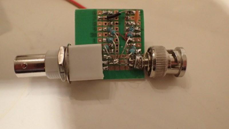

Dead bug construction that is.
Needed something to check short 50 ohm coax cables/terminations.
Found this TDR article and build it semi dead bug style. Stripped out all the extras I did not need: One capacitor, no extra provisions for other output impedance than 50 ohm.

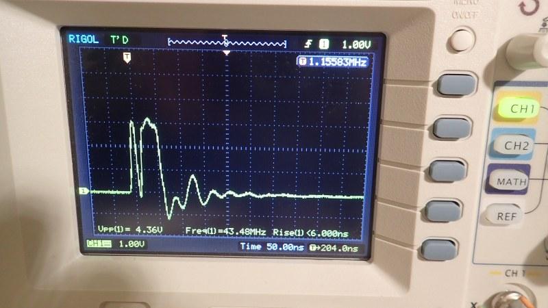

 I had a bit too small capacitor, it oscilated funny ---think 65 MHz and sort of sine, but not that sure - scope is 50 MHz and pretty sure signal folded. Soldered next size up and then is works.
I think it needs a metal box.
Also I'm considering a different circuit, the pulse could be shorter and sharper.
http://support.fccps.cz/download/adv/frr/Reflectoprobe/reflectoprobe.html
Last picture with one metre of coax, T-connector and 50 ohm terminator. Needs a bit more work.

I know that my scope is a bit slow for this one, but have to try and see if I can produce a pulse that will yield to response I can use.

Little tweaks, had problem with ringing. Turned out to be insufficient decoupling and the IC GND-pin had weak ground.

I had some serious ringing on the output, I could see the effect on the board IC supply pins. Tried adding more bypass capacitors and the result would change, but not improve. Changed the PSU from 5V SMPSU to linear supply and it did nothing, but I could estimate how pow hungry the circuit was.
After some more measurement I finally figured that the decoupling was a problem. Needed thigter routing for power wires (specially the IC GND pin had a large swing) and some more decoupling. Maybe if it were build with SMD:s and had a proper decoupling capacitor near IC, there were not problem at all.
